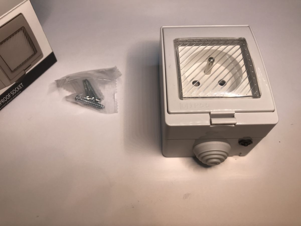

    Contents of the kit, as you can see we also get the mounting screws:
    ATLO-S1IP5-TUYA outdoor electrical socket with mounting screws in a plastic bag.

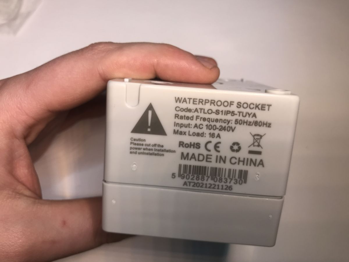

    Markings:
    Close-up of the back side of the ATLO-S1IP5-TUYA waterproof socket housing with technical data and markings. .

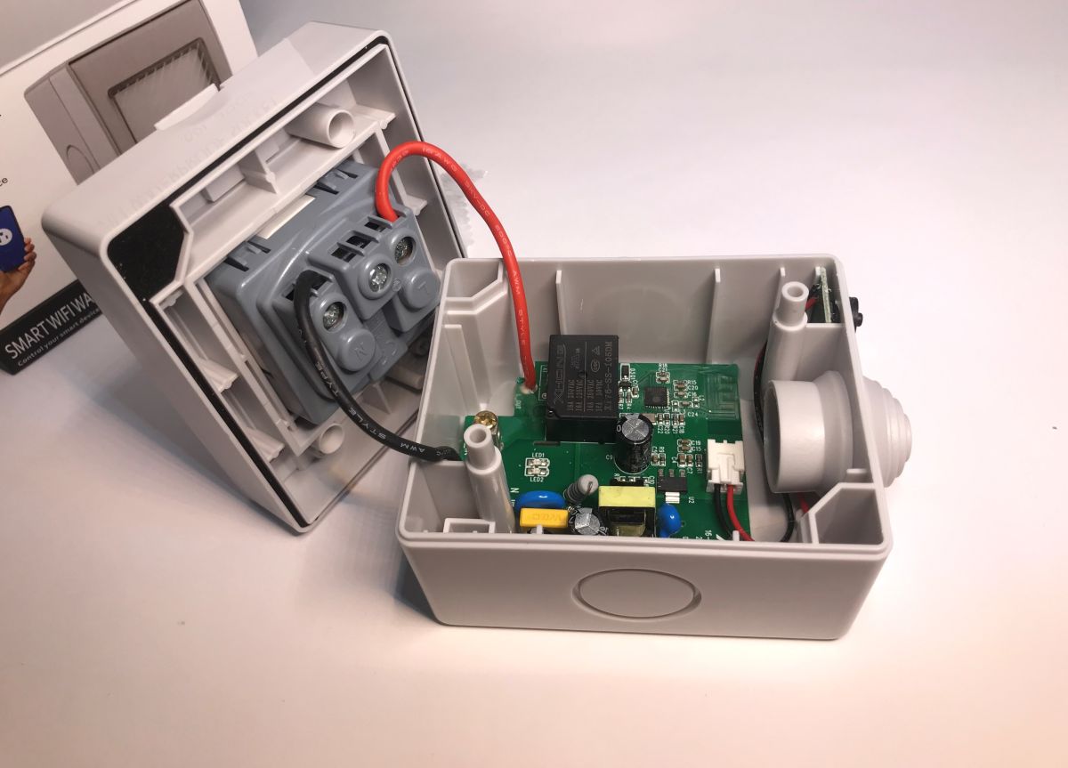

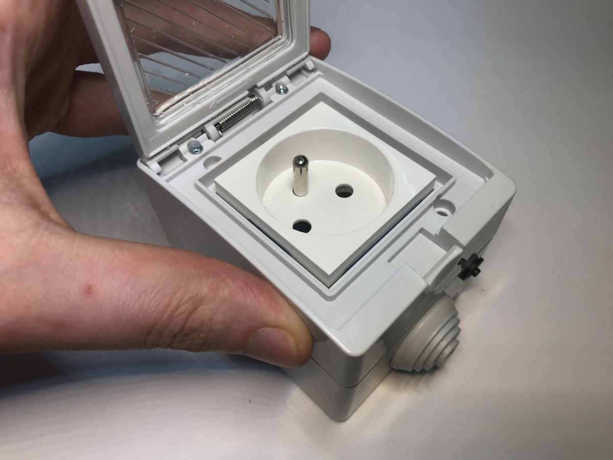

    However, I'm interested in the inside of the product, so it's time to unscrew the front panel:
    Close-up of a hand opening the lid of an outdoor French-type electrical socket. .

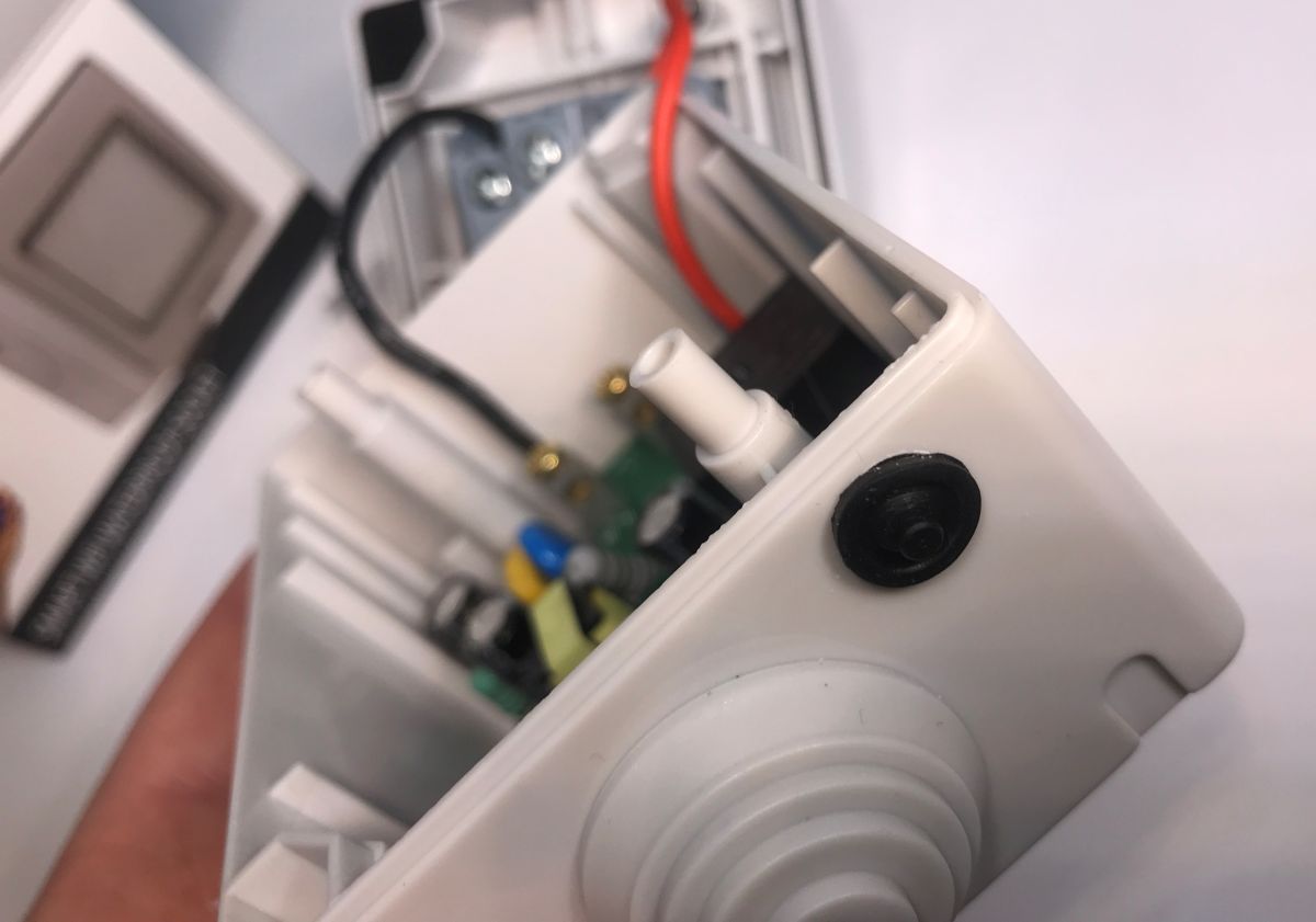

    Indeed, the manufacturer has made a basic effort to make this socket a little more resistant to moisture. Both plastic parts are protected by a rubber seal:
    Opened enclosure of an outdoor WiFi socket ATLO-S1IP5-TUYA with visible internal electronics. .
    The button from vaping and emergency switching is also protected.
    Interior of the ATLO-S1IP5-TUYA socket showing rubber gaskets and internal mounting elements. .
    The PCB itself, on the other hand, is ... glued onto something that looks like hot glue.
    Inside of a disassembled electrical socket with visible PCB and wiring. .

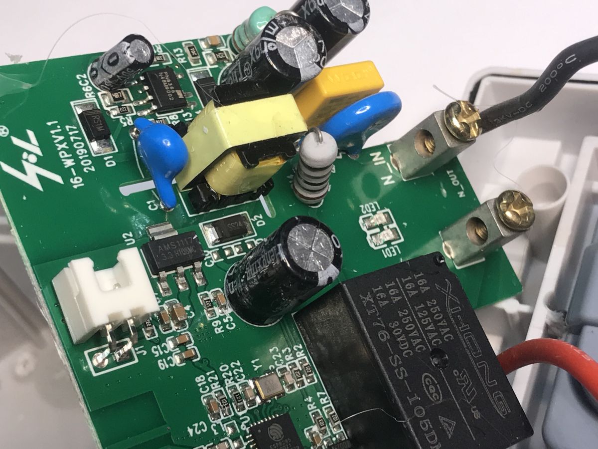

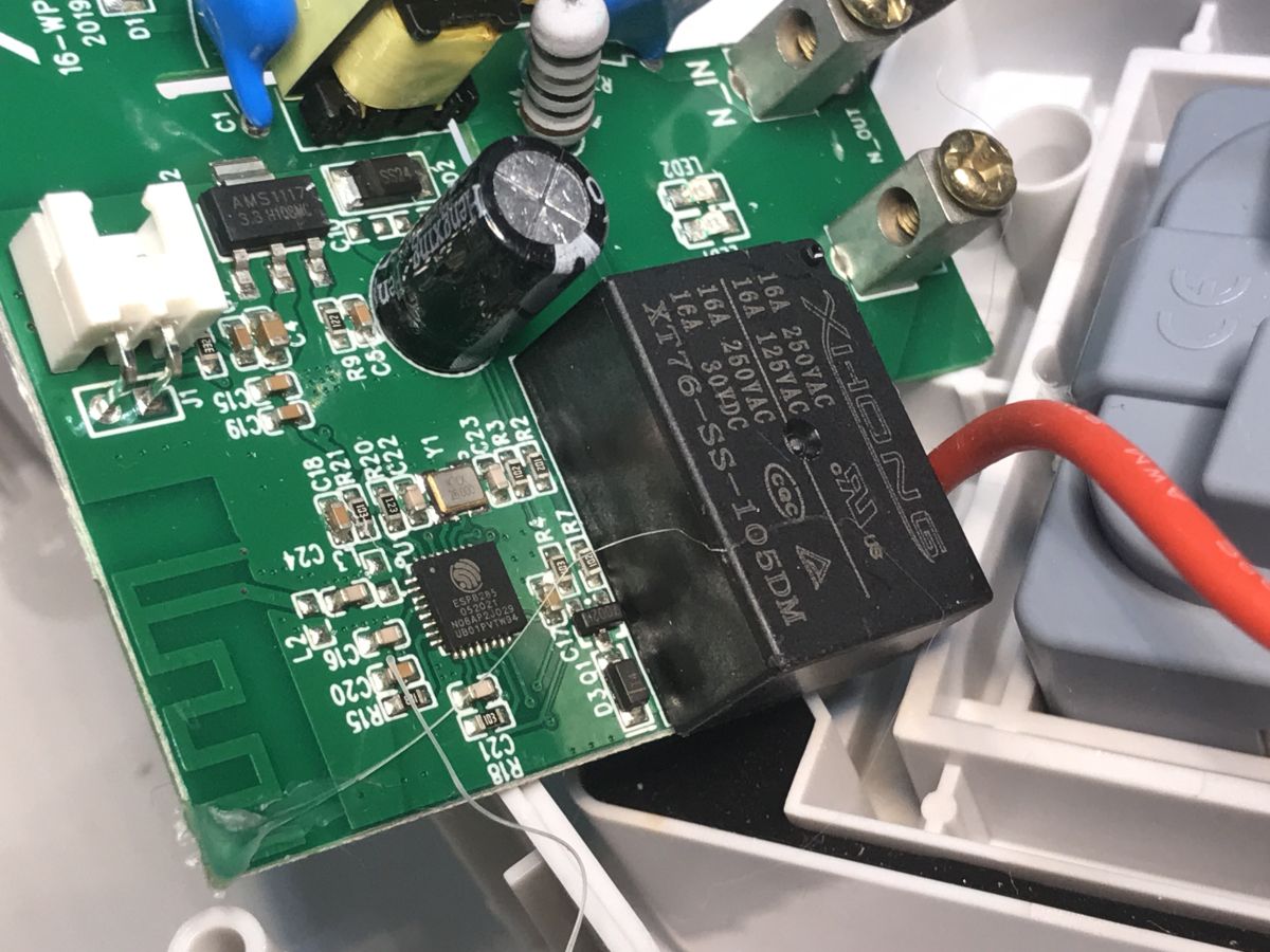

    On the board is an ESP8266, or more accurately an ESP8285 - that is, an ESP with 2MB flash memory built in. No external bone is needed. Nor is it here in the form of a module such as the TYWE3S, for example, but the whole thing is on one board.
    Close-up of a PCB from an ATLO-S1IP5-TUYA outdoor socket, showing the ESP8285 chip and XHONG relay. .

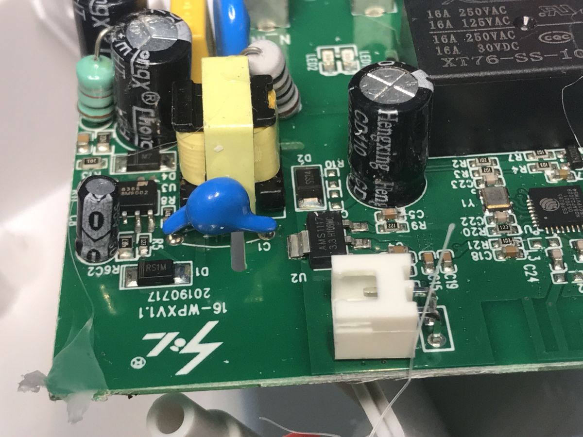

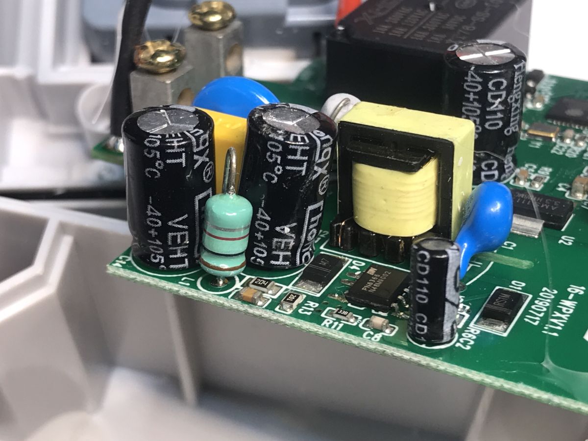

    On the same board we also have the power supply section, which is a small flyback power supply. However, there is no non-isolated step-down converter here as in other similar products.
    The inside of a circuit board with electronic components and connection terminals of the ATLO-S1IP5-TUYA socket. .
    I am all too surprised that the circuit appears to be quite complete. There is a varistor, a filter on the input, a fuse, a Y-capacitor. This is often omitted in cheap products.
    Close-up of the ATLO-S1IP5-TUYA outlet PCB, showing capacitors, relay, ESP8285 chip, and board markings. Close-up of the ATLO-S1IP5-TUYA socket power supply PCB, showing capacitors, SMD components, and a transformer. Close-up of electronic components on a PCB from a WiFi socket, including capacitors, a resistor, and a transformer. .

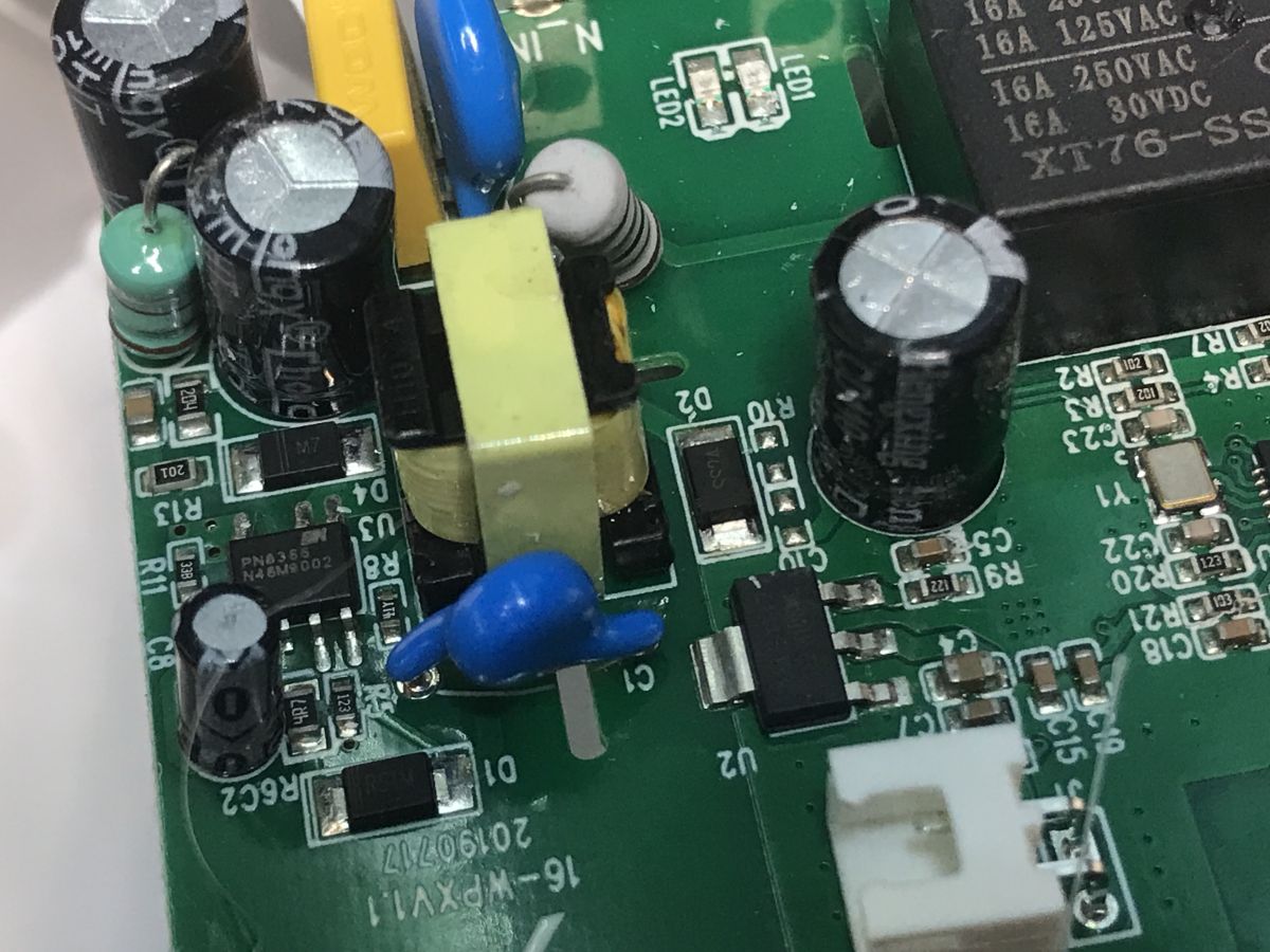

    PCB designation: 20190717 Probably the date of the project...

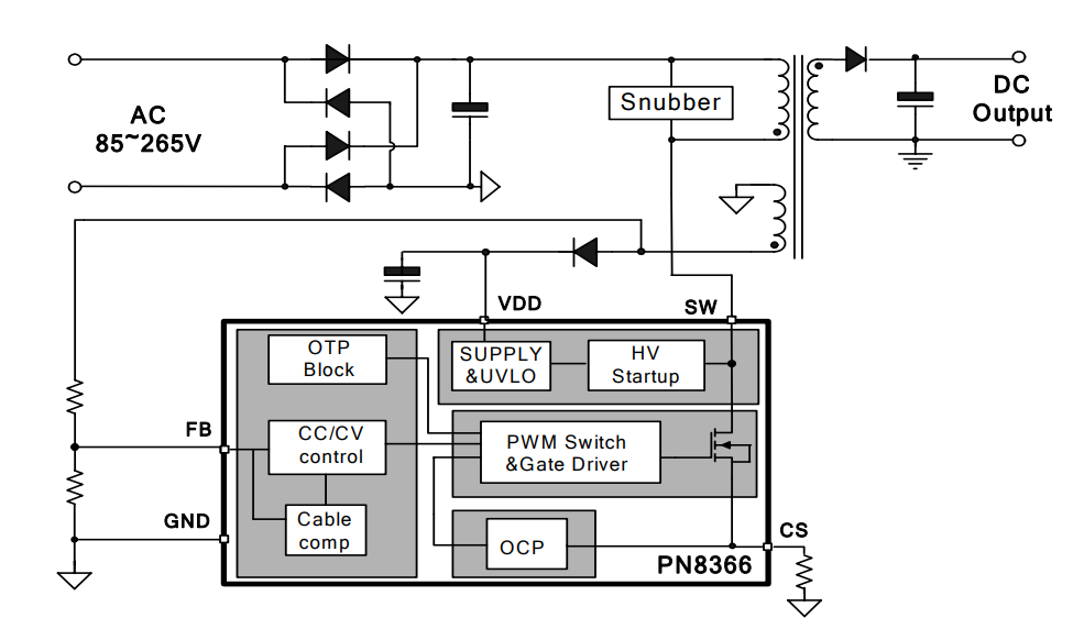

    I see there a PN8366, inverter controller with integrated MOSFET transistor.
    Block diagram of a flyback power supply using the PN8366 IC for low-voltage DC output from AC input. .
    There is also an AMS1117-3.3V on the output, it provides 3.3V for the ESP.

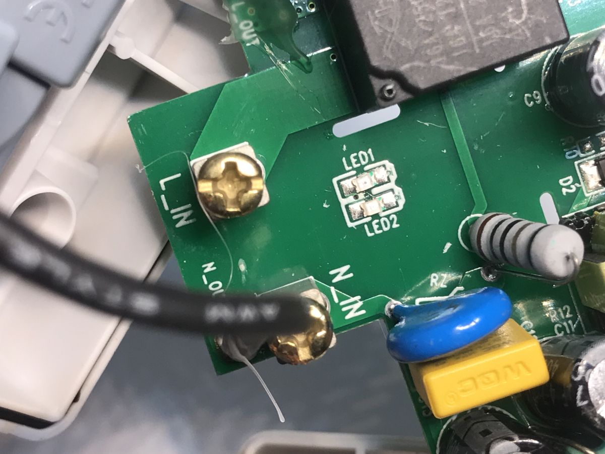

    The product, as usual, only cuts off one wire (the phase, if you connect it correctly):
    Close-up of the ATLO-S1IP5-TUYA socket’s PCB showing L_IN and N_IN labels, two screws, and visible electronic components. .

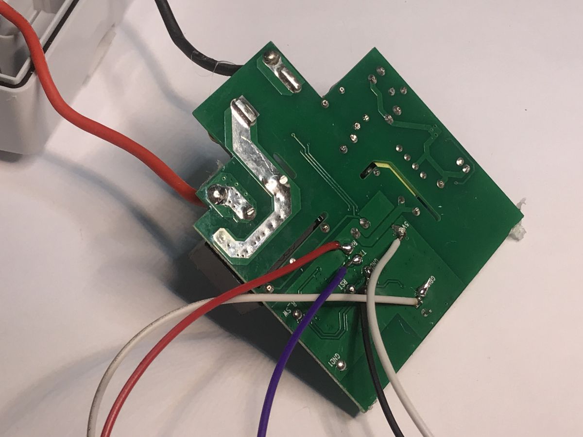

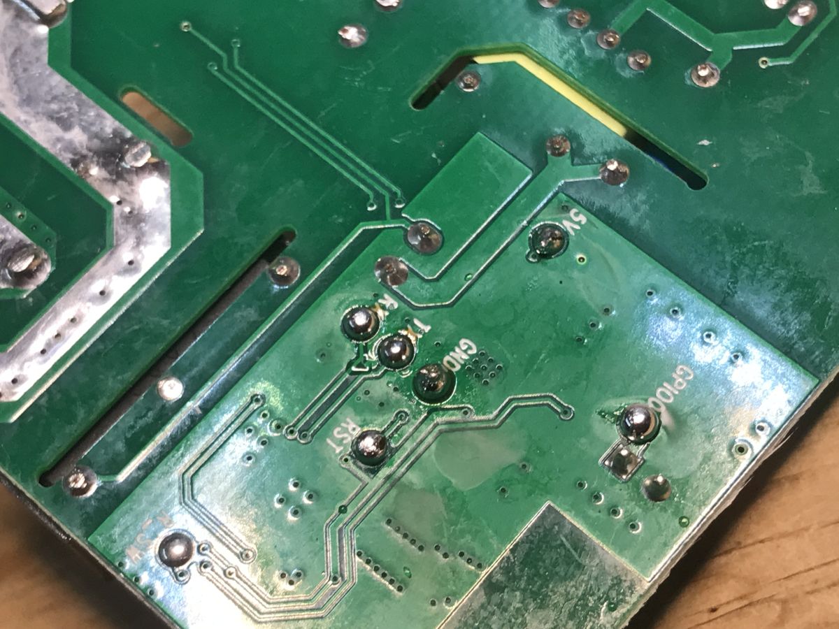

    On the bottom of the PCB there are only pads for programming:
    Close-up of a PCB with pin labels: GPIO0, GND, RST, RX, TX, 5V, GND1, R_SW. .
    I will now proceed to change the firmware . I perform the process according to my old topic:
    SmartLife switch - test, interior and programming light switch on WiFi .

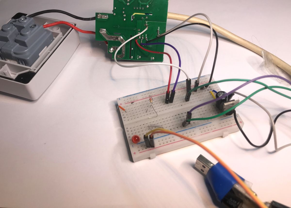

    I always apply flux and whiten the pads first, then connect my USB to UART converter with an additional 3.3V LDO:
    Bottom side of ATLO-S1IP5-TUYA WiFi socket PCB showing programming pads labeled GND, 5V, RST, RX, TX, and GPIO0. A PCB with attached wires, visible traces, and soldered connections on a green circuit board. Breadboard with connected jumper wires and LED, next to an opened electrical socket with exposed PCB and wiring. .
    Tip: GPIO0 here is on the button, so basically you don't need to solder this signal, just RX/TX/mass/power. You can hold the button while the power is connected to start flashing mode.

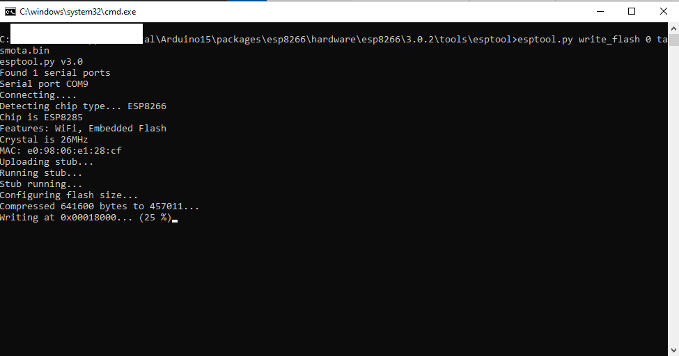

    Command to upload Tasmota:
    esptool.py write_flash 0 tasmota.bin
    Black Windows console screen showing messages about flashing Tasmota firmware to an ESP8285 via esptool.py, with visible writing progress. .

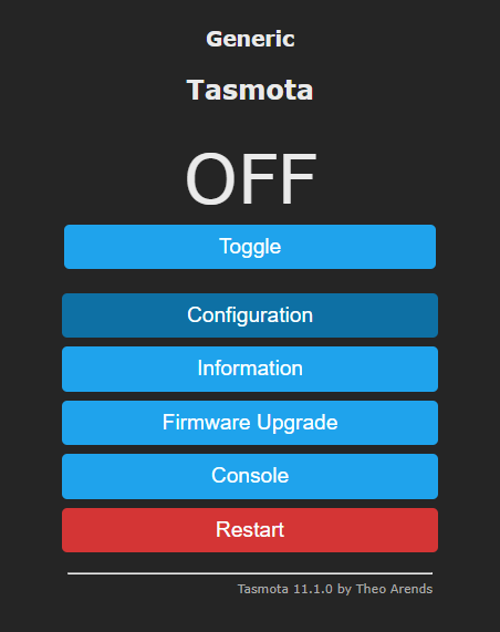

    After disconnecting GPIO0 from ground and rebooting the Tasmota starts:
    Main Tasmota user interface screen with function buttons for device control.

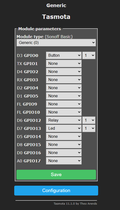

    Configuration:
    Screenshot of Tasmota interface showing module settings and GPIO pin mapping. .
