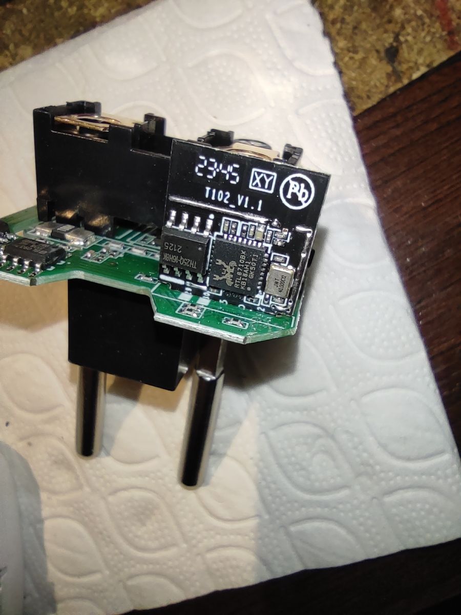

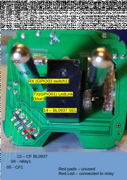

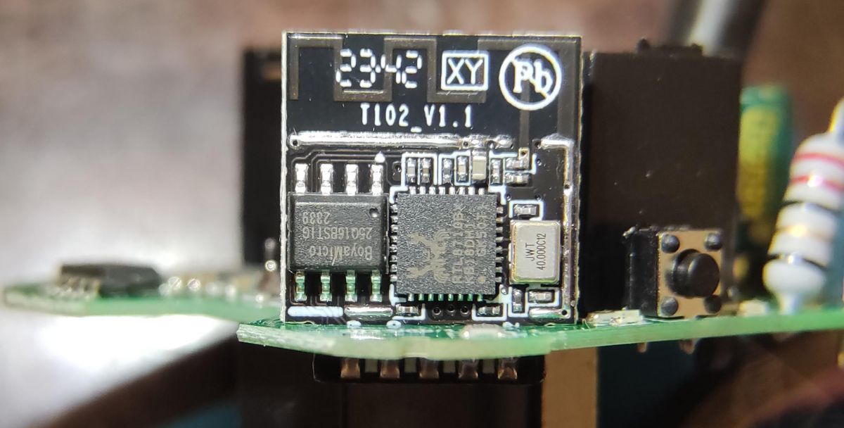

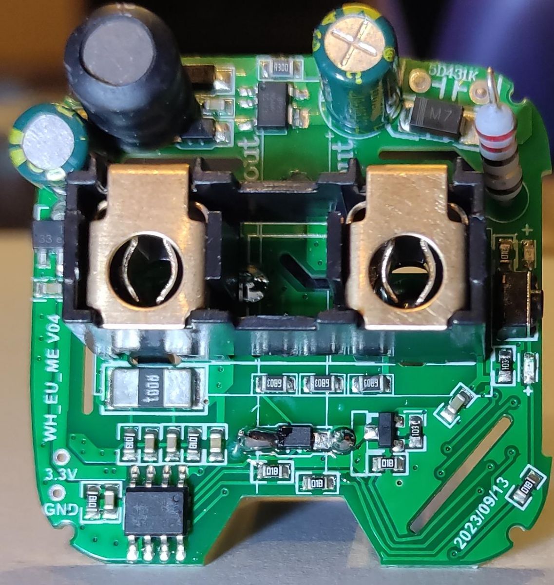

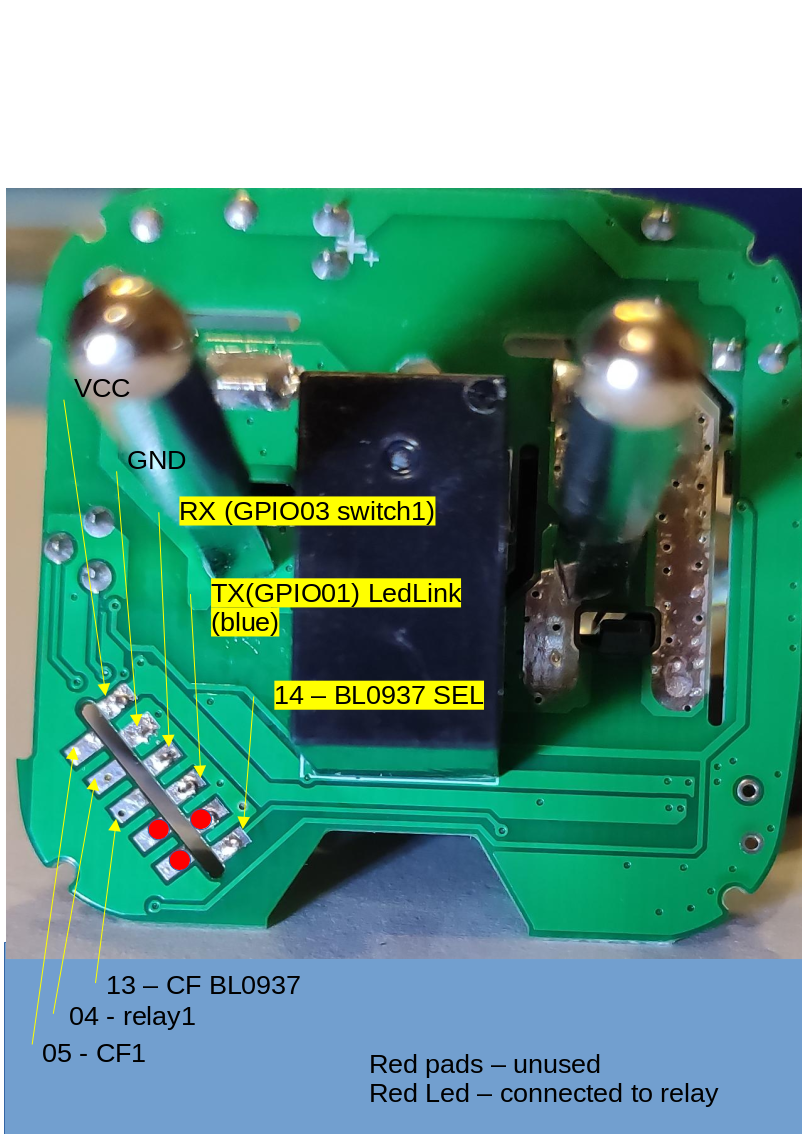

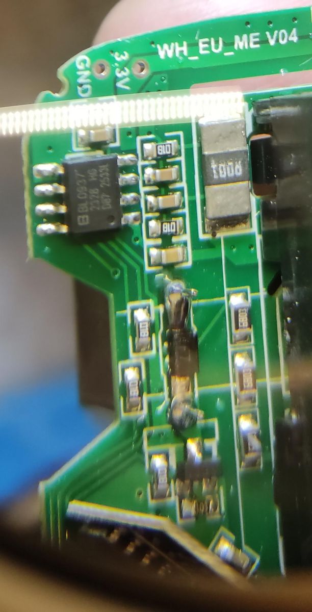

    I bought a smart socket took apart and there a set of RTL8710BX and BL0937
    I transplanted to ESP-02S and threw Tasmote.
    For the moment everything works. Maybe someone will find it useful.

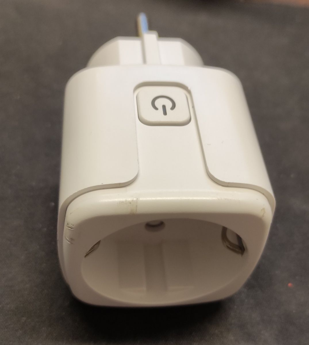

    Plug-in some "noname" ( QNCX from Digitaling Store)
    Date on the board: 2023/09/13 , so quite fresh
    PN on board:WH_EU_ME V04
    White smart plug adapter with a power button on top.
    Plate
    View of a printed circuit board with electronic components, production date 2023/09/13. Close-up of a printed circuit board with electronic components such as contacts and traces. Close-up of an electronic module on a circuit board with markings T102 V1.1 and visible integrated circuits. Close-up of a printed circuit board with a module labeled WH_EU_ME V04 and electronic components.

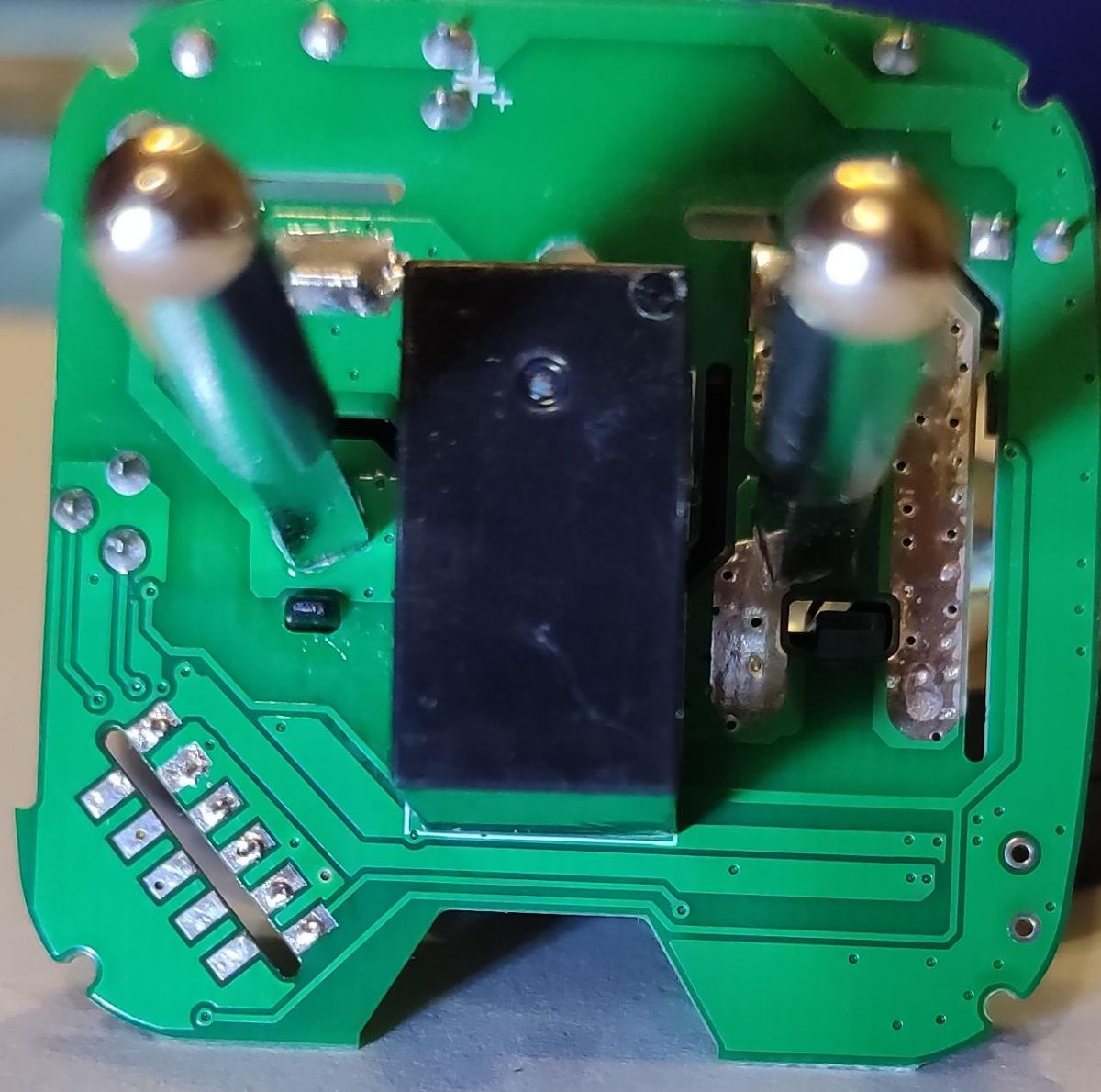

    Description of pads
    Close-up of a circuit board in a smart socket with labeled components and connections.

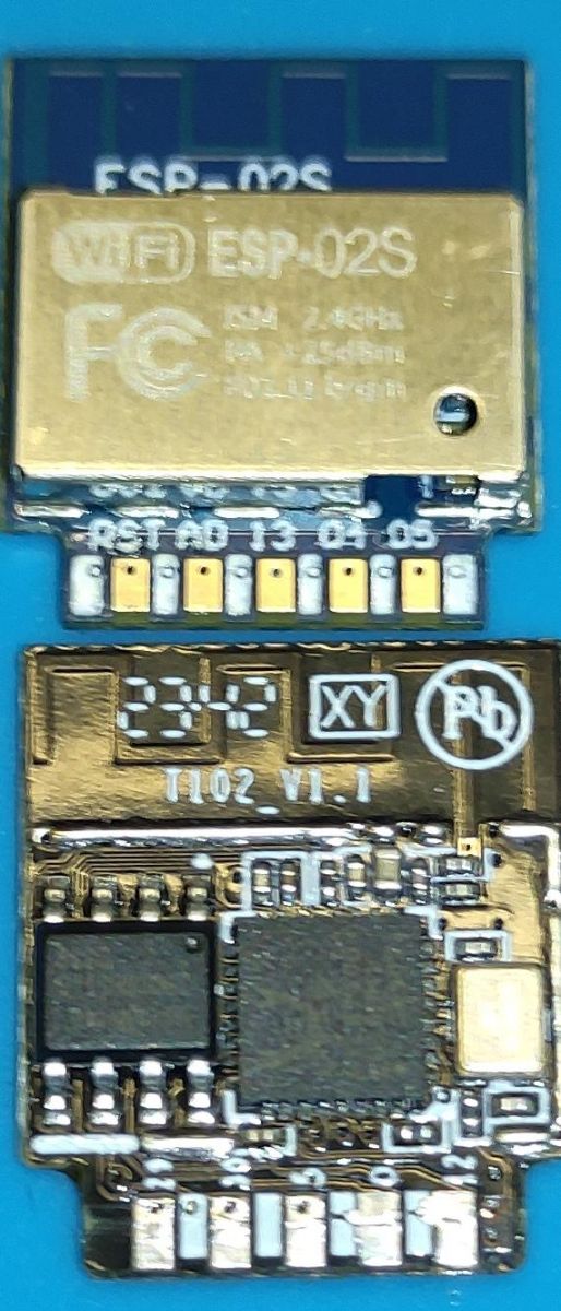

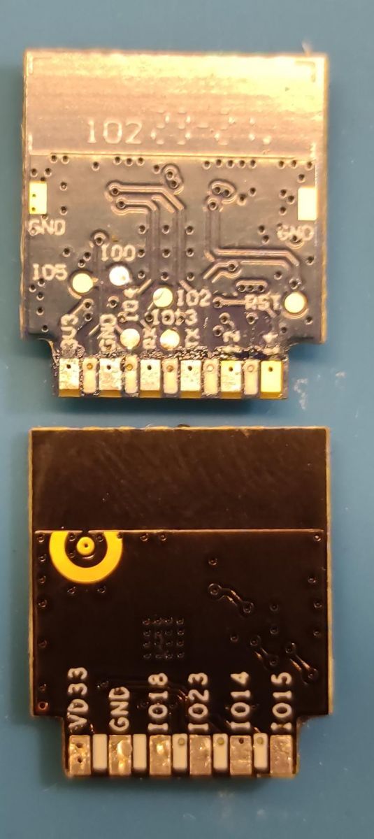

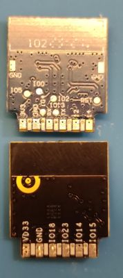

    comparison of RTL and ESP modules
    Comparison of ESP-02S module and another electronic board on a blue background. Comparison of RTL8710BX and ESP-02S PCB modules on a blue background.
    Mapping pins on modules
    |ESP-02S    |   RTL8710BX | Tasmota       |
    |   RST     |    29       |               |
    |   AD      |    30       |               |
    |   13      |    5        |  BL0937 CF    |
    |   04      |    0        |  relay1       |
    |   05      |    12       |  HLWBL CF1    |
    ---- druga strona -------------------------
    |    3V3    |    3V3      |               |
    |    GND    |    GND      |               |
    | RX(GPIO3) |    IO18     |  Switch1      |
    | TX(GPIO1) |    IO23     |  ledlink      |
    |    12     |    IO14     |               |
    |    14     |    IO15     |  HLWBL SEL_i  |

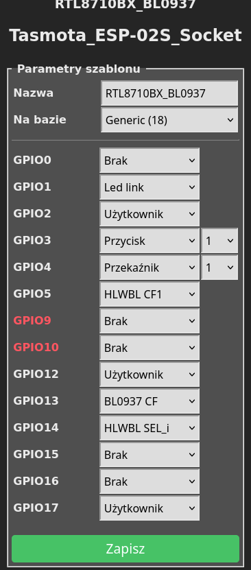

    Template Tasmota:
    Tasmota Template: {"NAME":"RTL8710BX_BL0937","GPIO":[0,544,1,32,224,2656,0,0,1,2720,2624,0,0,1],"FLAG":0,"BASE":18}

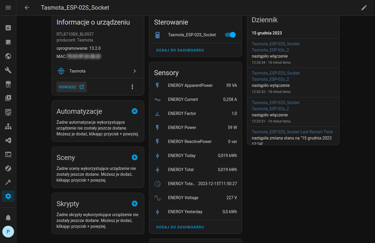

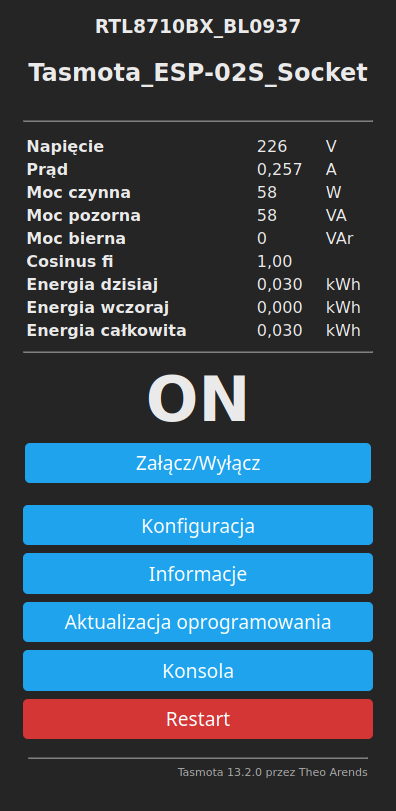

    Screens of Tasmota and HA
    Screenshot of Tasmota settings for a smart socket Tasmota interface menu for a smart socket with energy consumption meter. Tasmota interface on ESP-02S smart socket device.
    Template Tasmota.

  • 20A and 16A variants use different pin mappings
    #6 20920326
    przemsi_ele
    Posts: 62
    Rate: 15
    >>20902057
    I got two of these 20A, one with BK7231N and one with RTL8710BX
    what distinguishes them:
    20A version with energy measurement:
    - two LEDs are blue
    - pcb with RTL or BK chip is soldered perpendicular to the edge of the motherboard
    16A version with energy measurement:
    - one LED red the other blue
    - pcb with RTL or BK chip is soldered at an angle between the edges of the motherboard
    pin configuration different, previously given for 16A version with measurement, under 20A with measurement:
    Power Monitor 20A
    |   RST     |    29       |  ----------   |
    |   AD      |    30       |  ----------   |
    |   13      |    5        |  ledlink      |
    |   04      |    0        |  BL0937 CF    |
    |    3V3    |    3V3      |   VCC         |
    |    GND    |    GND      |   GND         |
    | TX(GPIO1) |    IO23     |  ----------   |
    |    12     |    IO14     |  HLWBL SEL_i  |
    |    14     |    IO15     |  relay1       |
    Power Monitor 16A
    |   RST     |    29       |               |
    |   AD      |    30       |               |
    |   04      |    0        |  relay1       |
    |    3V3    |    3V3      |               |
    |    GND    |    GND      |               |
    |    12     |    IO14     |               |
    tasmota template: {"NAME":"RTL8710BX_BL0937_20A","GPIO":[0,0,0,32,2720,2656,0,0,2624,544,224,0,0,1],"FLAG":0,"BASE":18}
