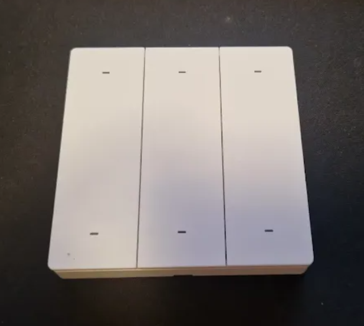

Sonoff R5 Scene Controller is a battery-powered 6-gang remote wall switch featuring three different button events (click, double or hold). It is usually paired with Sonoff Gateway, but here we will show you how you can pair it with ESP32 Tasmota device and use it with Home Assistant to create custom automations.
Sonoff R5 Scene Controller features physical button (tactile switches), so it may be preferred by some users over the solutions based on touch buttons.
So, I assume that you have at least one R5 switch. You don't need the Sonoff gateway for this guide.
Just make sure that your R5 has required batteries, as it runs on two CR2032.
Then, you will need ESP32 device. Even a tiny board like ESP32-S3 Super Mini USB Type-C will work well.

The same approach can be used for other buttons, just use names like Button2, Button3, etc. Similarly, you can use event names like "double" or "hold".
The same way can be used to connect multiple R5 buttons to single ESP, just set different aliases:
That's how you can connect multiple R5 buttons to Home Assistant via ESP32. Of course, you can also use any other MQTT server and just process published data there, even with Node-Red. For more information about eWeLink Tasmota support, see Flobul/Tasmota-eWeLinkRemote readme:
