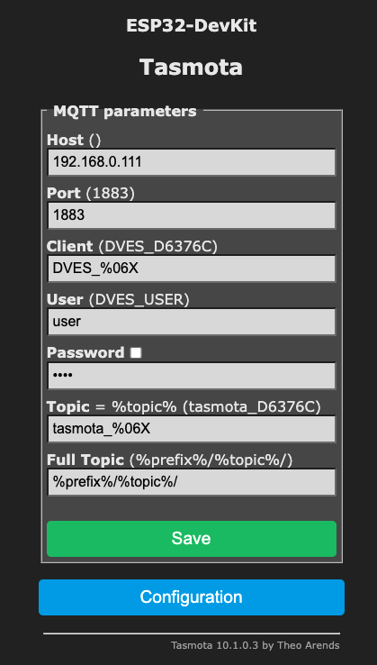

    Has anyone had to deal with the Tasmota soft and can explain to me how to configure the MQTT server? When I try to connect to any client for some unknown reason it rejects my connection.
    The IP address where the ESP32 is running is: 192.168.0.111
    I entered the following data in the MQTT tab and saved:
    Host: 192.168.0.111
    Login: user
    Password: 12345
    And here's the first strange thing I noticed - even though I entered a 5-character password (12345) the "Password" field suggests that the password is 4 characters (4 asterisks).
    When I try to connect to the server from Home Assistant using the data I entered I get the error: "Failed to connect".

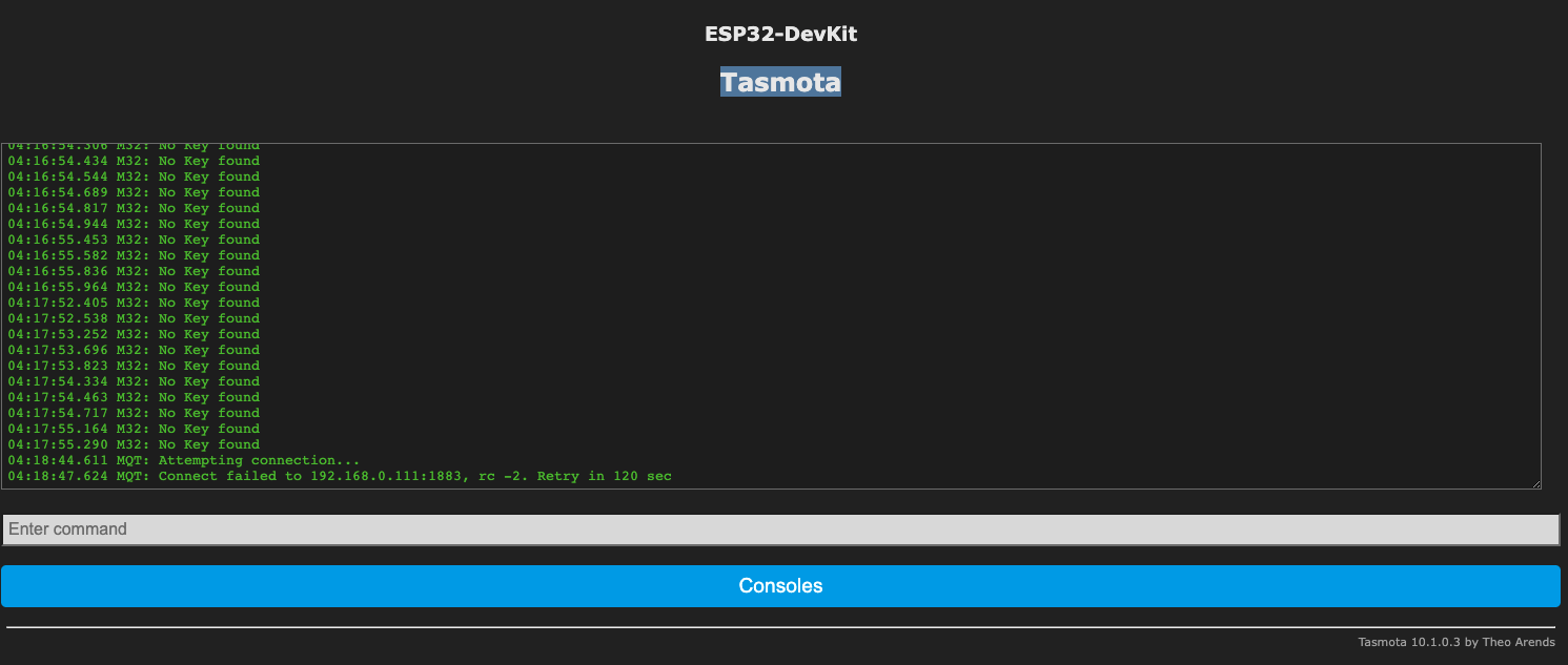

    An attempt to connect with the MQTT Explorer program ends similarly.
    In the Configure Other tab: "MQTT enable" - enabled.
    A failed connection attempt is also noted in the console.

    Hello, the fact that Tasmota suggests a 4 character password is normal.
    The Home Assistant IP should be entered as the Host and not the ESP IP.

    #3 19787217
    008
    Posts: 61
