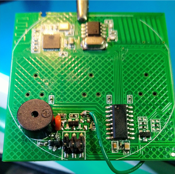

    I am also interested. I have one DS-101 installed and another one handy.
    Wall switches are getting interesting as well. I recently discovered some interesting ESP8285 wall switches also. One particular device had some extra provision in the PCB for a buzzer circuit. I managed to solder the buzzer components and hookup to a free IO. I am testing the MQTT controlled buzzer in the wall switch these days. I want to use it as a status indicator for my Solar Inverter data ie. when it switches to battery mode etc.
    Since most wall switches have pluggable DC PCBs there is plenty of modificatons that can be done as long as you stick to the current supply capacity of the main PCB.

    Posts: 14755
    Rate: 12879
    The board you have shown is a WiFi + RF combo. The buzzer is used to indicate the pairing. The RF is seamlessly connected with buttons controller so ESP (Tasmota) is not "aware" about RF presence. The MCU simulates button presses when you touch a button on RF remote.
    Yes but the device that I got (or rather I ordered few more after this discovery) had the RF circuitry and the RF chip but not the buzzer. The buzzer circuit has an open collector transistor driver which is connected to the button controller on the right hand side. The transistor driver circuit and the buzzer were missing from the PCB. The picture shows a single gang switch so tracks provisioned for the other two touch switches were available closely. The green wire is going to the other side of the PCB as I added two Pixel LEDs as additional indicators.
