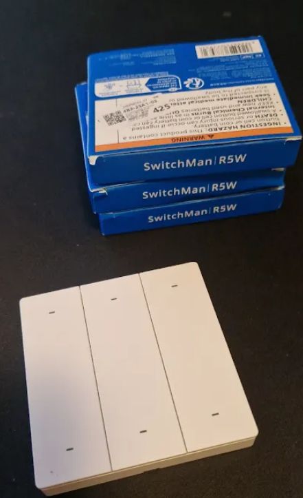

    Sonoff R5 Scene Controller is a battery-powered 6-gang remote wall switch featuring three different button events (click, double or hold). It is usually paired with Sonoff Gateway, but here we will show you how you can pair it with ESP32 Tasmota device and use it with Home Assistant to create custom automations.
    How to connect Sonoff R5 Bluetooth Remote to Home Assitant via ESP32 Tasmota Bluetooth Gateway?
    Sonoff R5 Scene Controller features physical button (tactile switches), so it may be preferred by some users over the solutions based on touch buttons.

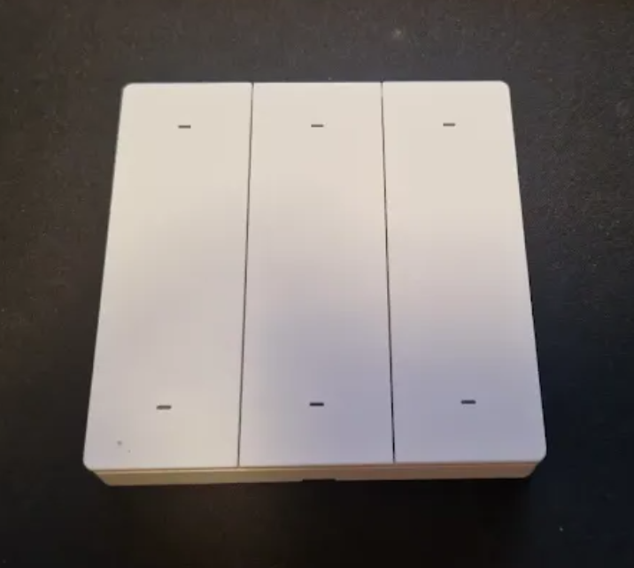

    So, I assume that you have at least one R5 switch. You don't need the Sonoff gateway for this guide.

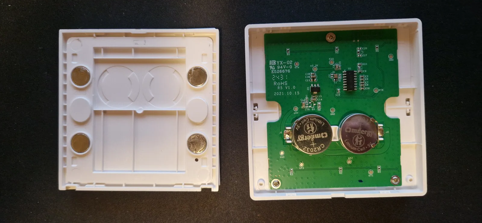

    Just make sure that your R5 has required batteries, as it runs on two CR2032.

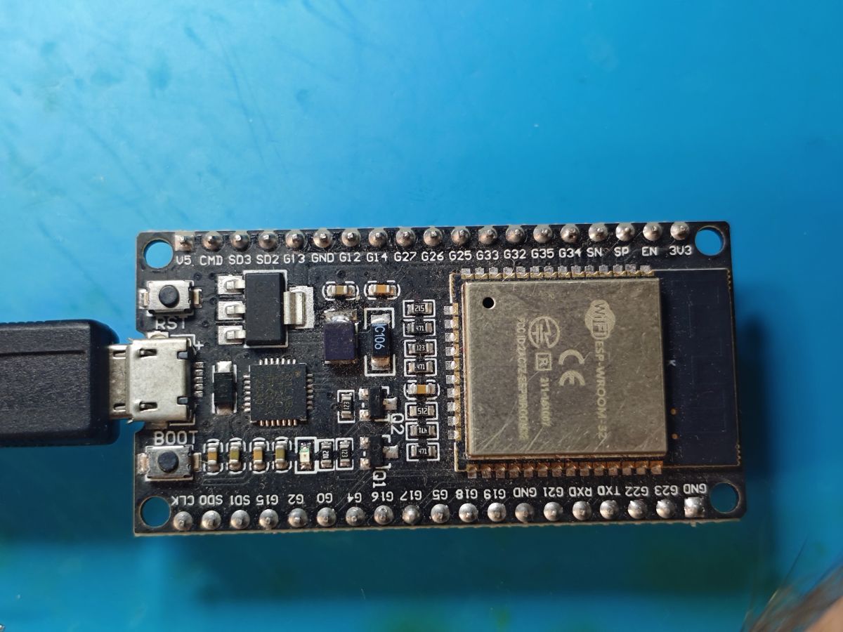

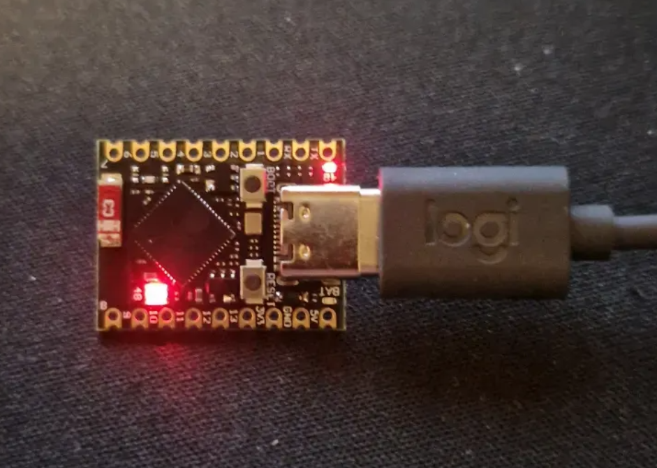

    Then, you will need ESP32 device. Even a tiny board like ESP32-S3 Super Mini USB Type-C will work well.

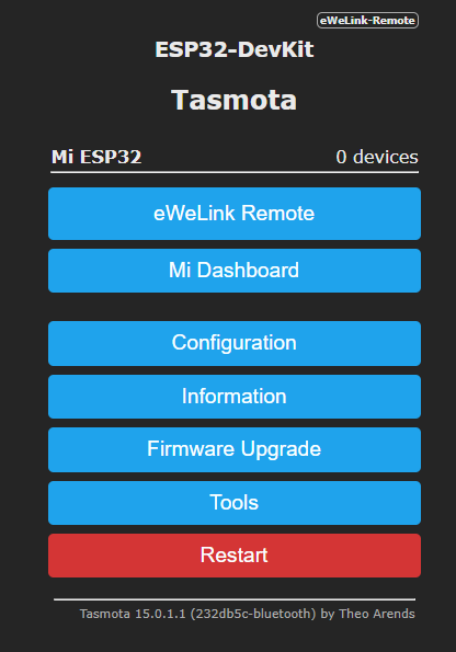

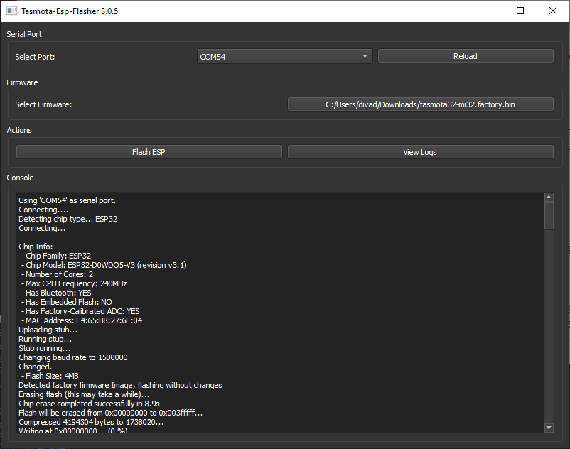

    Flash it with Tasmota Mi32-bluetooth version (file ends with *-mi32.bin) - https://github.com/Jason2866/Tasmota-specials/tree/firmware/firmware/tasmota32/other
    Choose Tasmota matching your ESP - there are multiple ESP32 versions, C3, S3, etc. Use esptool or Tasmota online installer, or any other flasher of your choice.
    Once Tasmota is running and connected to your WiFi, run in Tasmota console:
    SetOption115 1

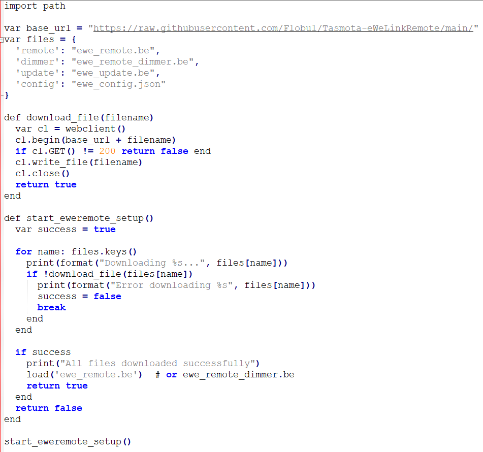

    This will enable BLE. Then, in Tasmota Berry scripting console, paste this to auto load scripts:
    code is shown below as image and also present in attachment - removed due to spam filter

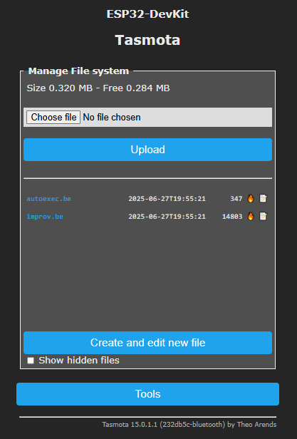

    This will fetch required scripts from Github. Remember, it requires internet access!

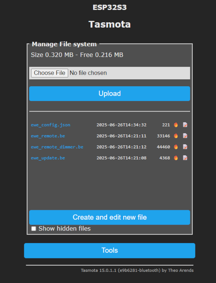

    Check the console output and once completed under Manage File system check if the needed files are present:

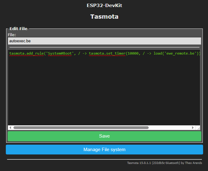

    Click on create and edit new file, name it autoexec.be and paste this line in:

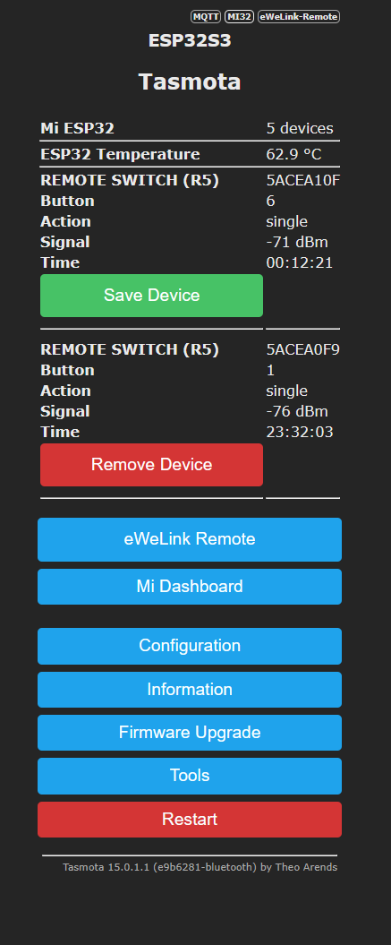

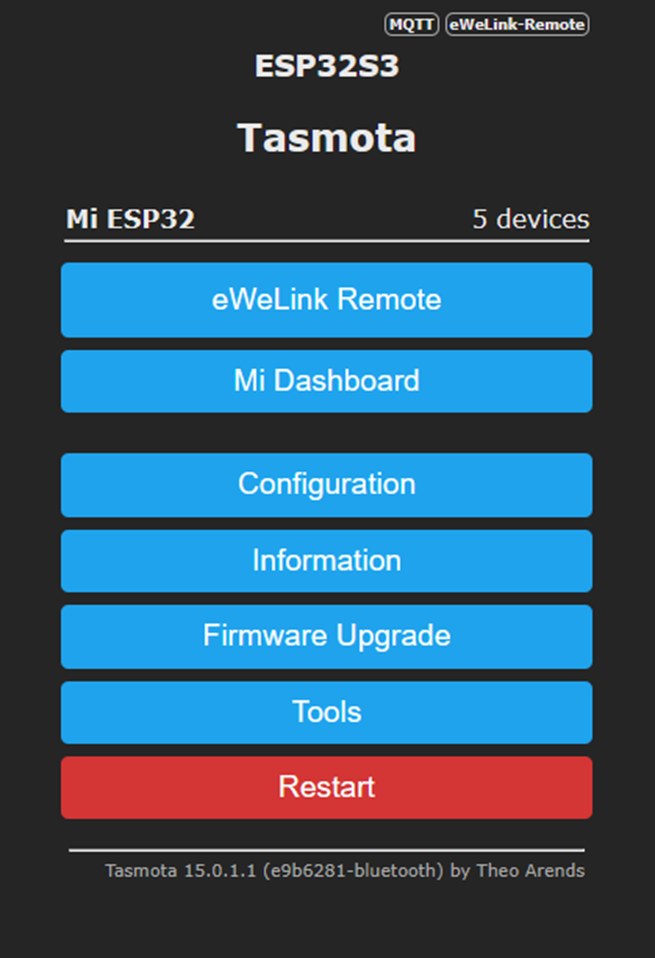

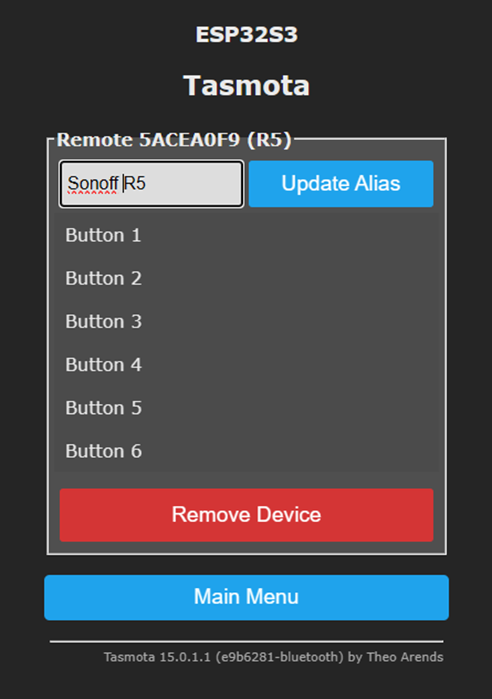

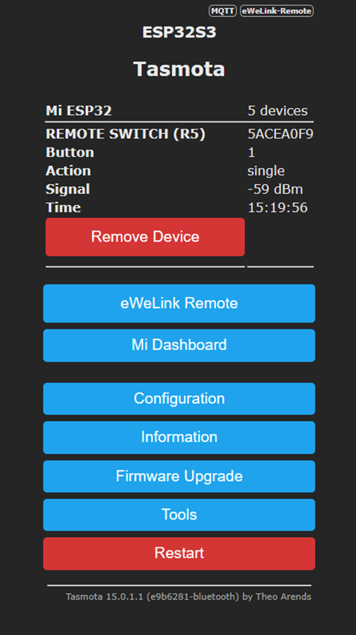

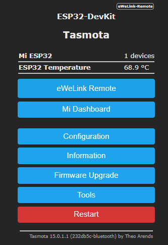

    Device should restart and you will get a new button on tasmota device home page:

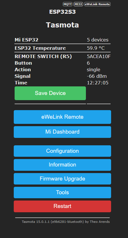

    Now click a button on your Sonoff device it should appear above and click Save Device:
    Once device is saved if you click on the eWeLink Remote button you can set up Alias name which will be important once you start integration into HA.
    Name the device something recognizable (Sonoff R5 in my case):

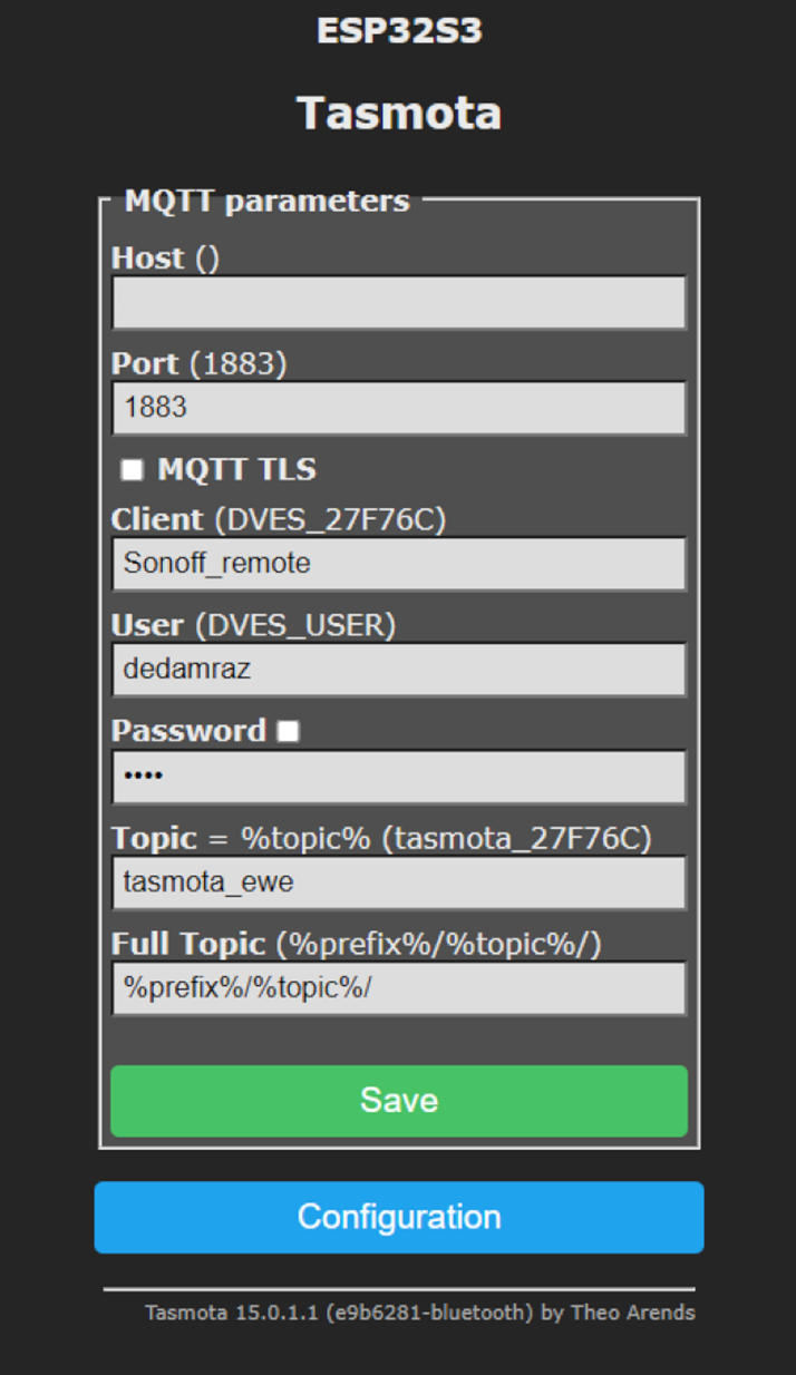

    Configure MQTT with the data of your choosing, just like you usually do with Tasmota:
    Device will reboot and connect to your HA, or should say MQTT running on HA.

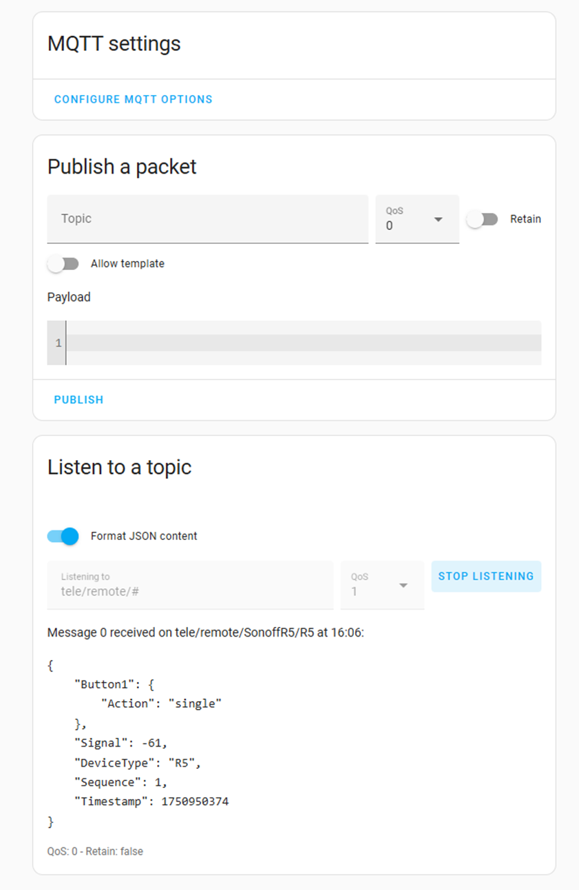

    Now we can test out HA MQTT setup, go into MQTT and click configure, under Listen to topic type:
    /tele/remote/#
    and start listening, press a button on your device, and you should see your device come up:
    Each button event (click, double click or hold) is published via ESP32 to Home Assistant.

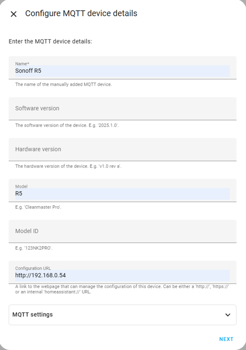

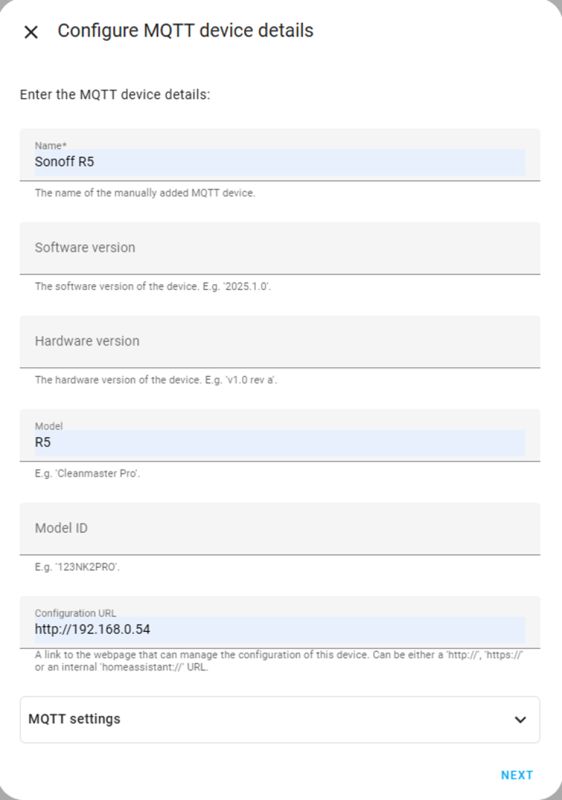

    Almost there, go back in your browser and while still in MQTT, click on the 3 dots on the side of core-mosquito integration entry and select Add MQTT Device.
    Name your device, give it a model and configuration URL (http://<tasmota_device_IP>)

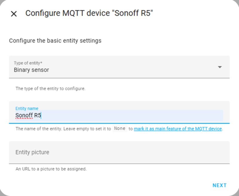

    On the next screen Type of entity should be Binary sensor and entity name you chose for yourself:
    On the next screen leave the device class empty, you can change this later if you need to.

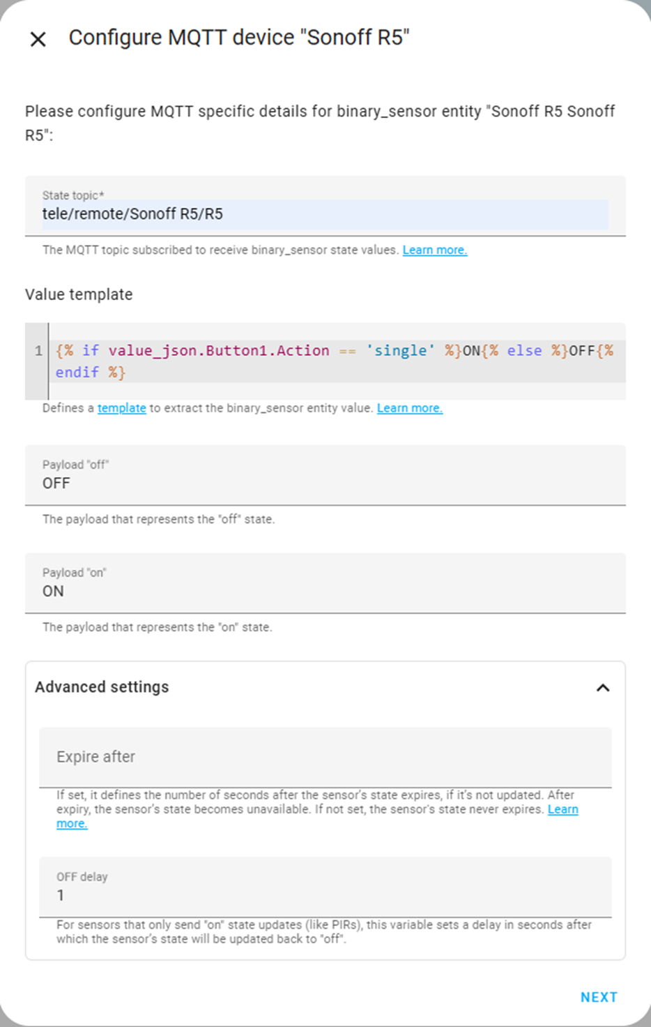

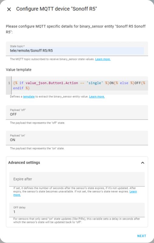

    Click next and now we are configuring MQTT specific data. State topic should be:
    tele/remote/<your_device_name>/<model>
    Value template field should contain this string:
    {% if value_json.Button1.Action == 'single' %}ON{% else %}OFF{% endif %}
    Payload for on and off should remain the same, click on advanced settings and for OFF delay type in 1, leave expire after blank:

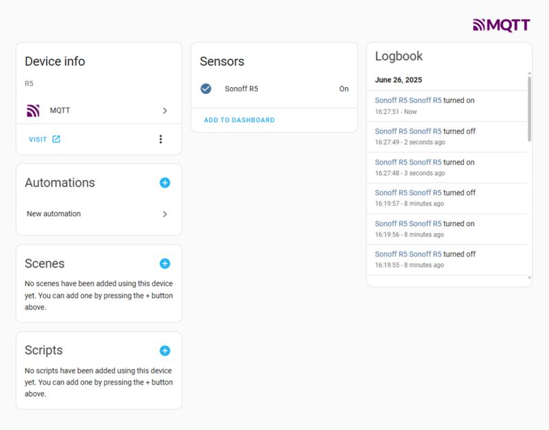

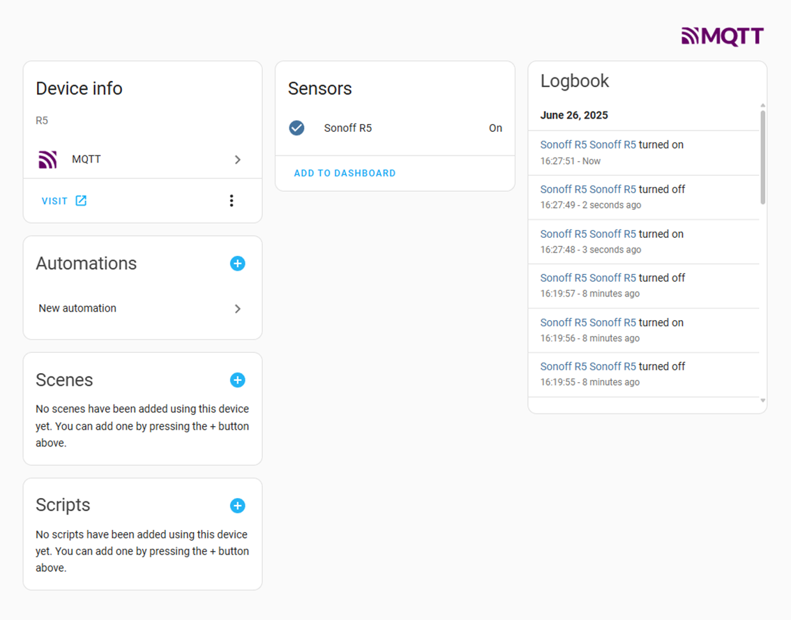

    We are done, finish the wizard and a new Sonoff R5 entry should appear, click on 1 device under it’s name and test:
    The same approach can be used for other buttons, just use names like Button2, Button3, etc. Similarly, you can use event names like "double" or "hold".

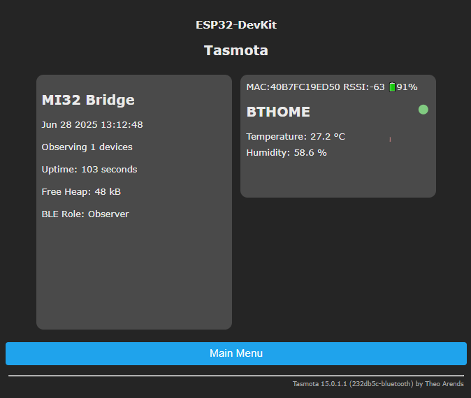

    In case you want to publish and see data from the sensors this build is designed for - Mi thermostats use a rule, in tasmota console type:
    Rule1 on System#Boot do RuleTimer1 10 endon on Rules#Timer=1 do MI32Option2 1 endon
    activate it with
    rule 1 1
    and reboot the device.
    also to enable ESP32 internal temperature showing both in the tasmoat page and publishing it via MQTT in tasmota terminal type:
    setoption146 1
    More info on how to add these sensor to HA will follow soon, but the principle is basically similar.

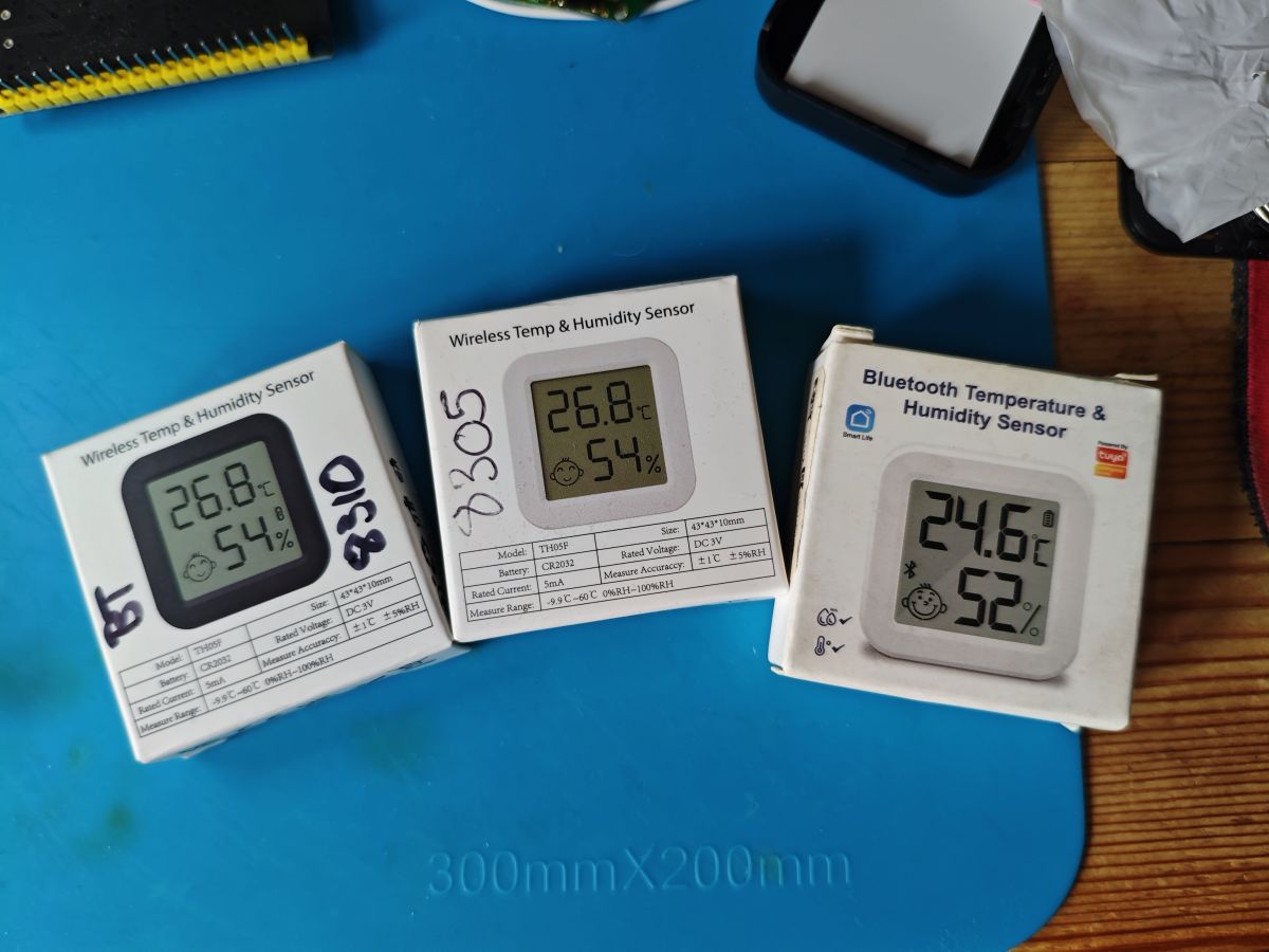

    but I do have a collection of TH05F/THB3 Tuya bluetooth temp/hum devices

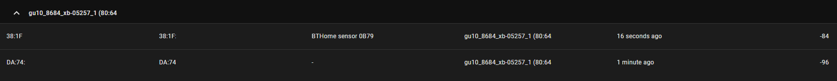

    Just converted one to BTHome opensource firmware https://github.com/pvvx/THB2 and here she is in Mi Tasmota
    maybe the conversion steps of these types of devices needs its own thread.

    Screenshot of a table showing Bluetooth device data including names, MAC addresses, and RSSI values
