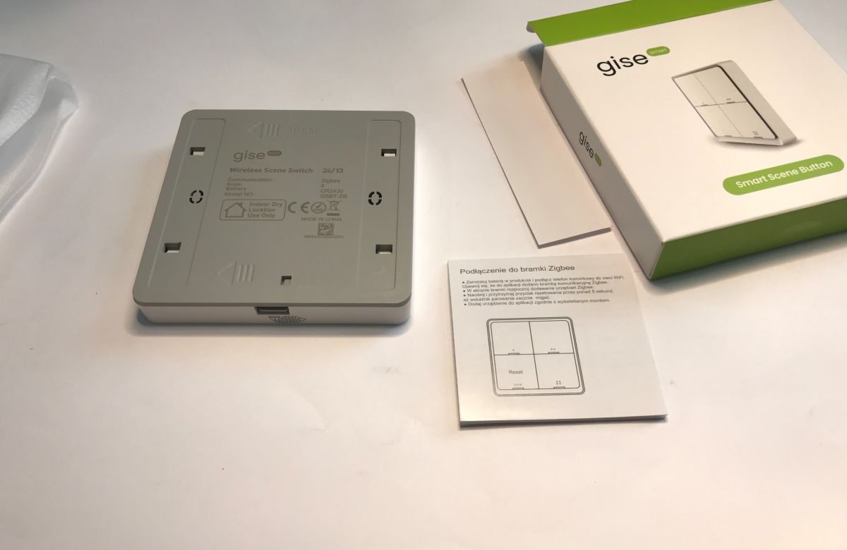

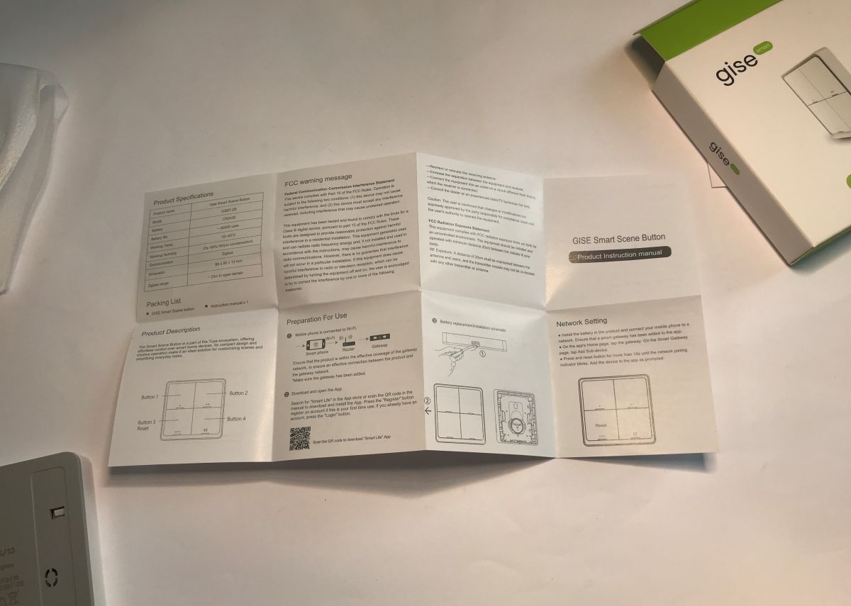

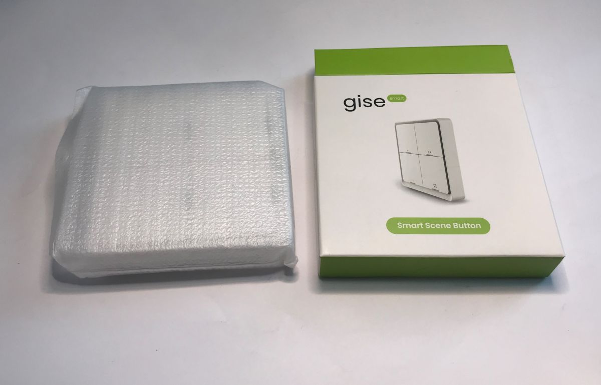

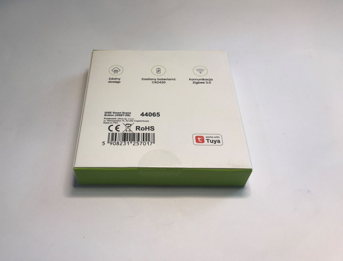

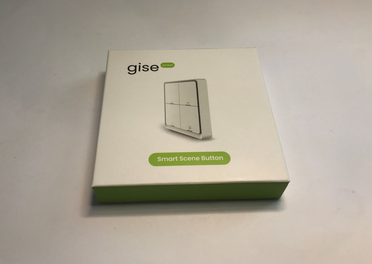

Let's start with the unboxing. The product discussed here is under the brand name GISE and the model is GSBT-ZB 44065. The lettering on the packaging is in our language, as it was purchased from a distributor in our country.
A strip of tape is included to stick the product to a smooth surface, but potential screw holes are also available on the case. The instructions are in Polish.

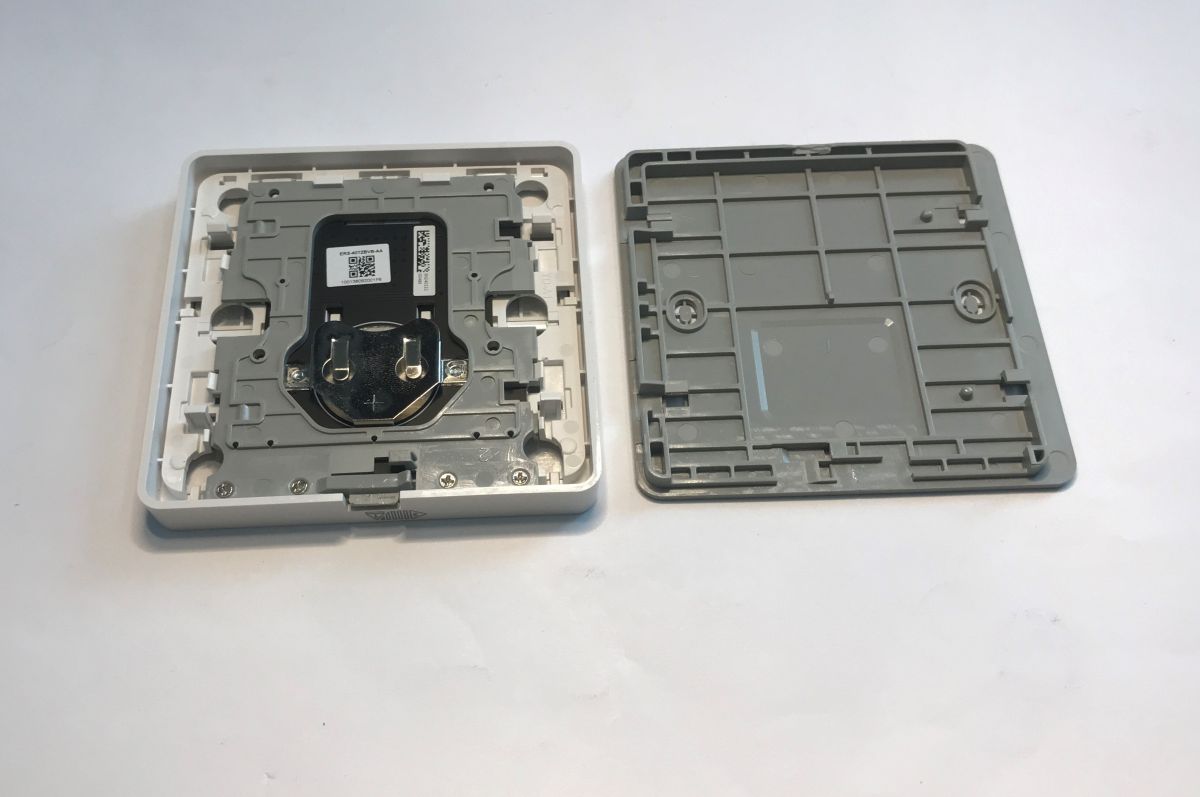

The product is powered by one CR2430 battery.

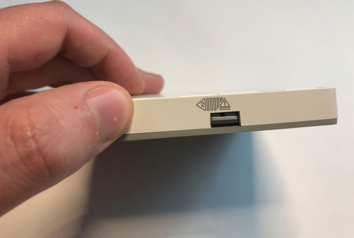

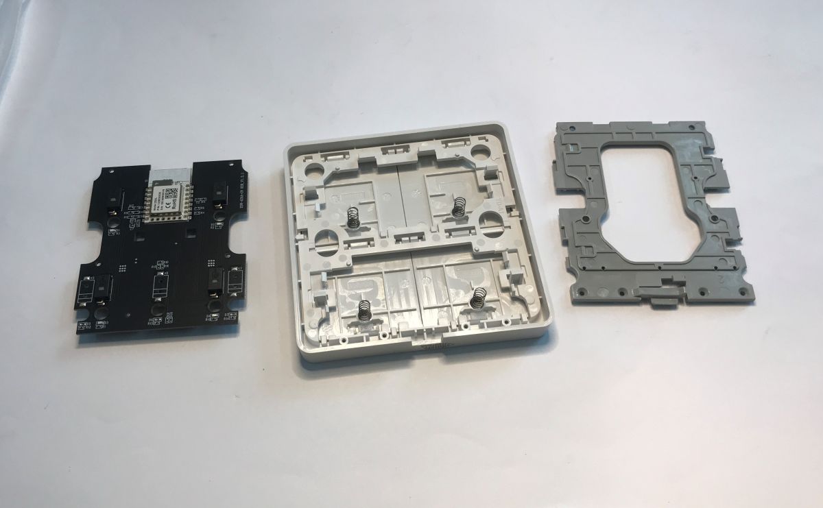

Let's take a look inside the product. Opening it is extremely difficult - you have to push in a lever and slide the casing to the side. This is not a USB port, although from the outside it looks like one.
The battery inside is one.

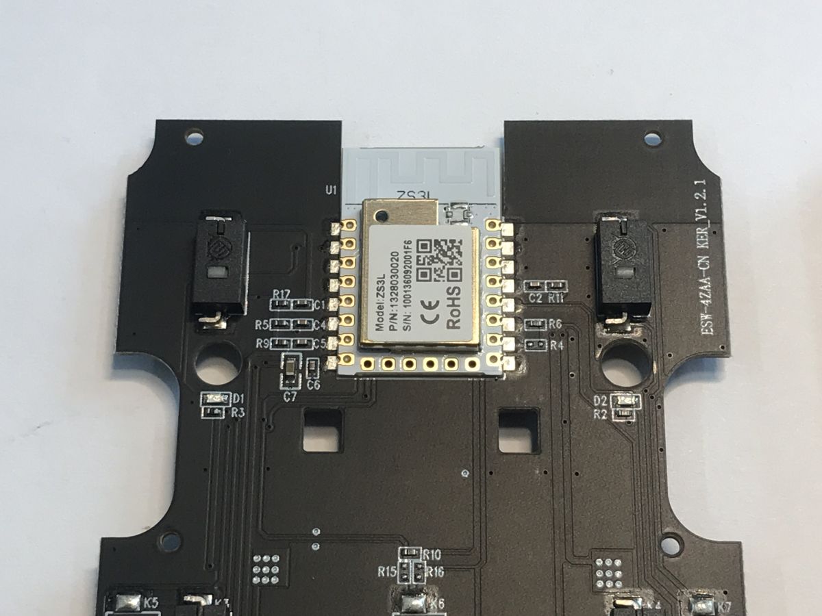

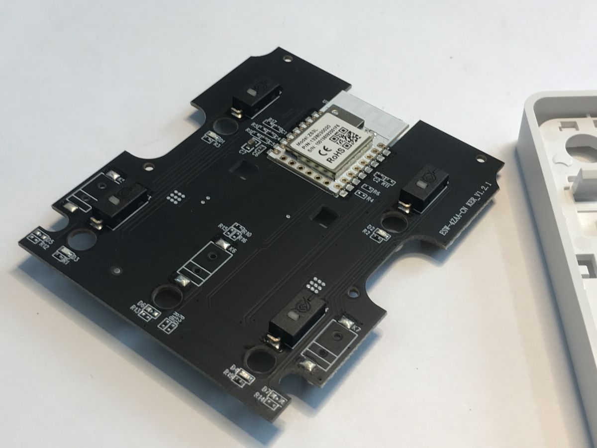

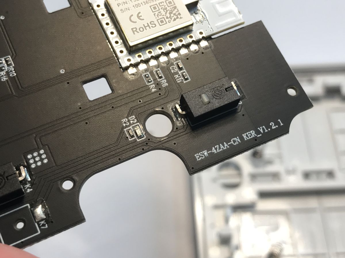

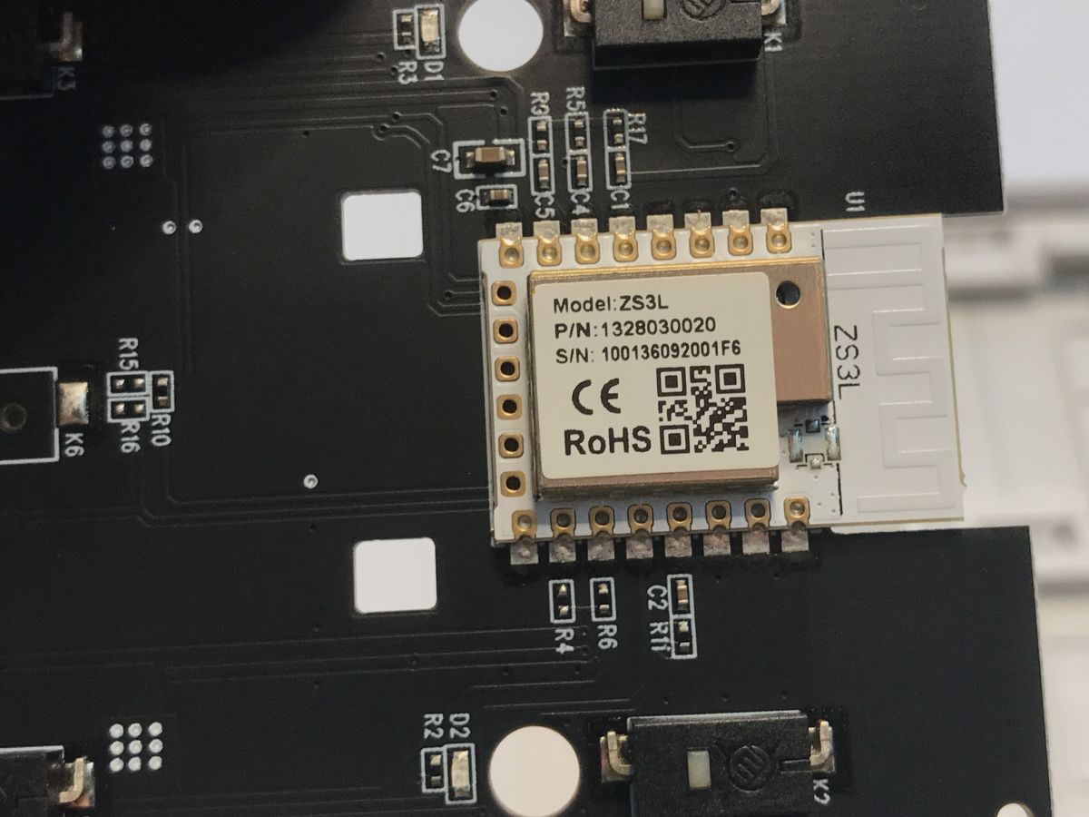

The product is built on the Z3L. Inside you can see that a 5-button version was also in production (or at least in the plans).
PCB designation: ESW-4ZAA-CN KER_V1.2.1
The circuit is very simple, but this is understandable. Any inverters between the Zigbee module and the battery would introduce additional losses.

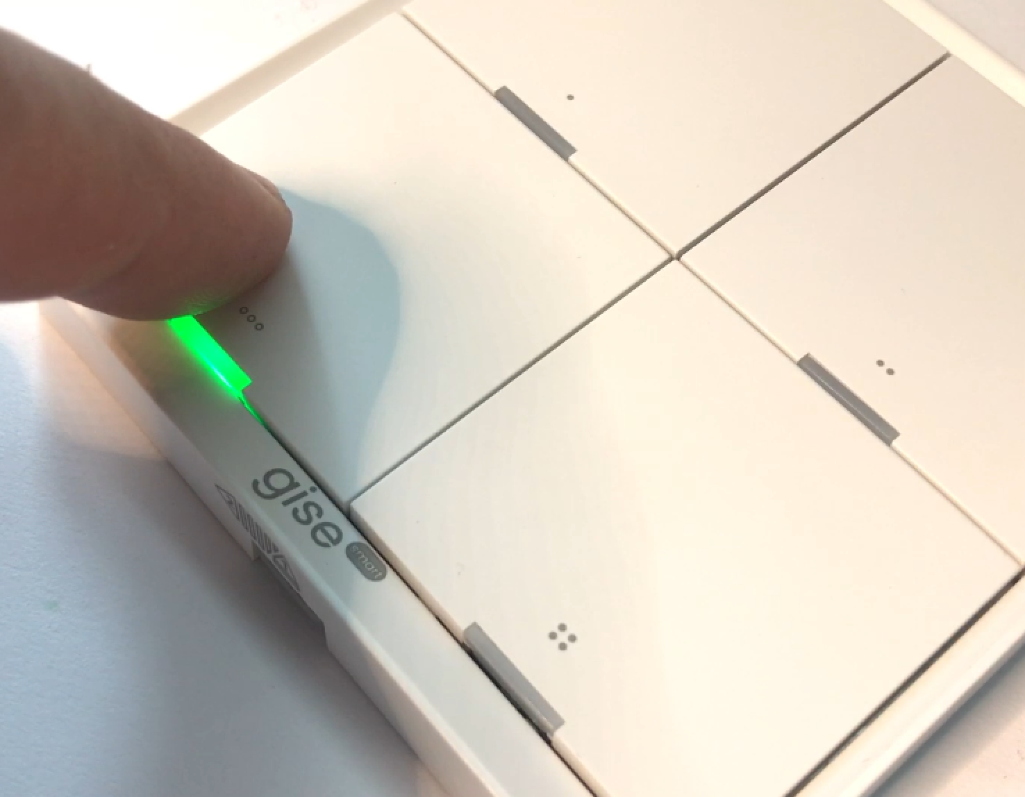

Let's get to the operation of the device already. First, a small audiovisual presentation - in the video you can hear the click we want and you can also see that an additionally pressed button lights up the corresponding LED.

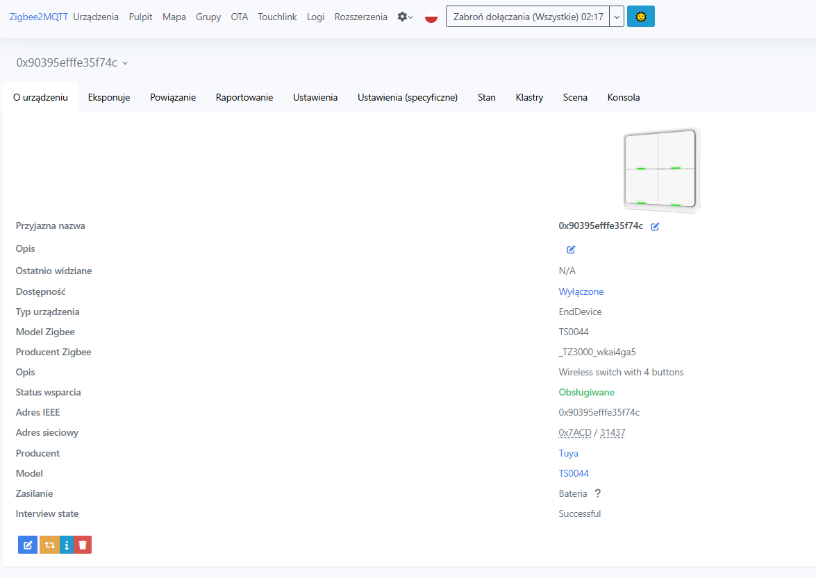

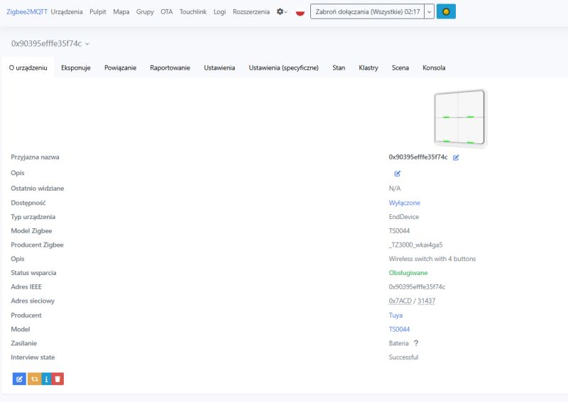

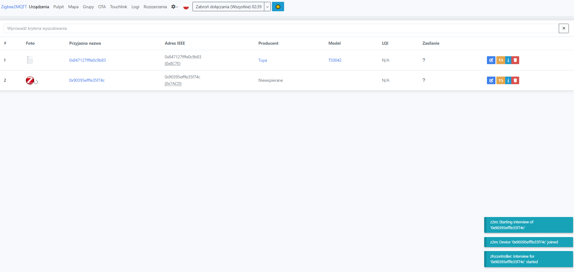

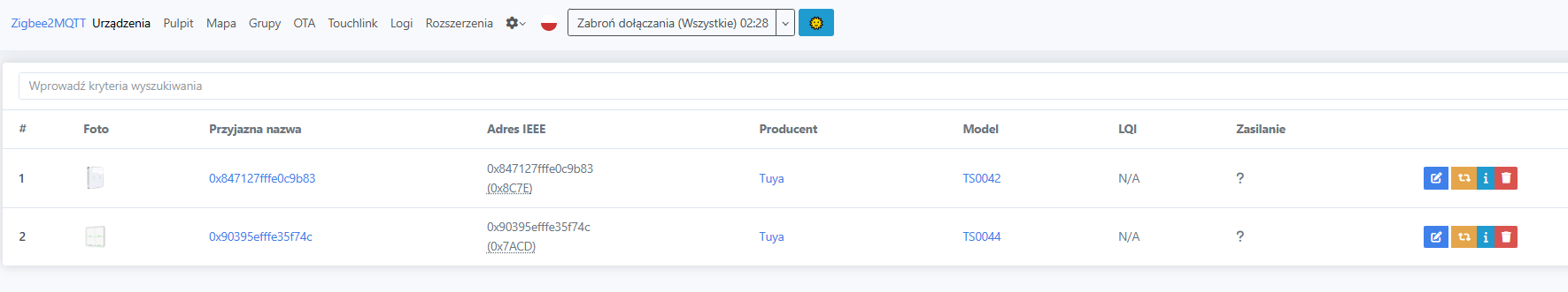

Pairing with the gateway/Home Assistant is very simple. Press the third button for longer as instructed.

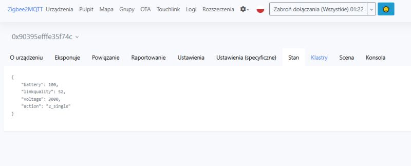

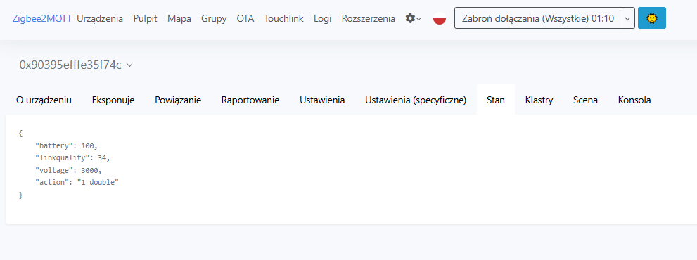

The device is seen as TS0044:

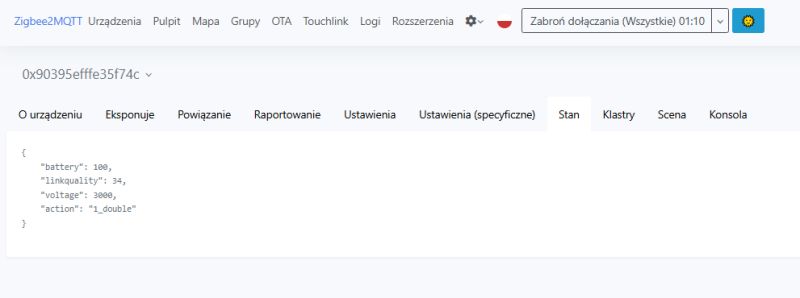

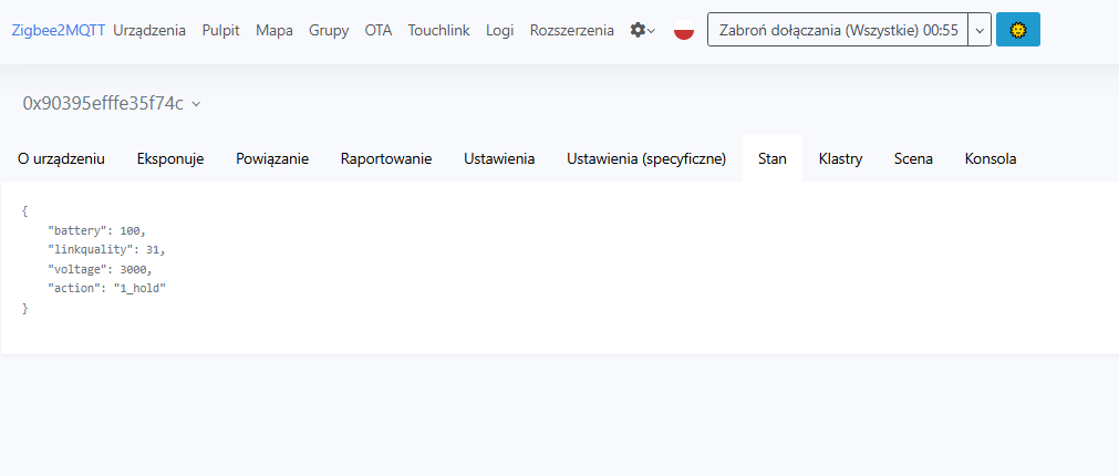

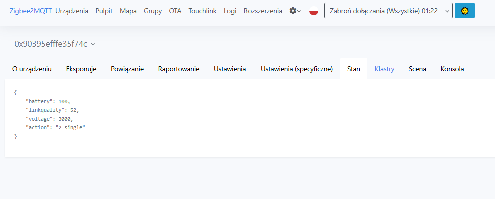

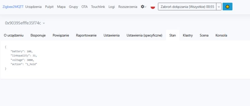

The entities provided are battery level, signal quality, voltage on battery in mV and current event.
An event consists of a button index (1 to 4) and an action name - single, double or hold. Single click, double or press. That's all we need and you can already trigger scenarios in HA with this.

Is it possible to send a feedback signal for the LED from the button? [Read more]
p.kaczmarek2 16 Jul 2025 18:14
I have not found such an option, it seems to me that the LEDs are permanently controlled directly by the buttons. [Read more]
