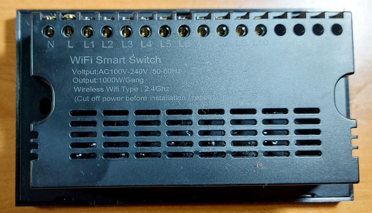

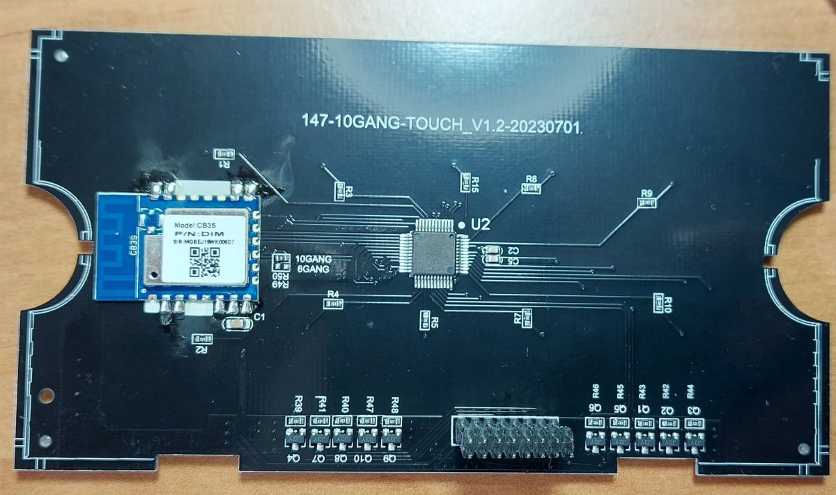

    I bought a touch glass light switch from AliExpress
    link
    https://pl.aliexpress.com/item/10050058448255...t_main.29.17b71c24lgSfCF&gatewayAdapt=glo2pol
    I connected it with Domoticz using the plug.
    Domoticz found 7 buttons out of 10. One of the found switches does not work.
    Is there perhaps a way to make Domoticz department in all 10 buttons?
    Maybe there are already procedures for this type of switch to change the software to disconnect from the cloud?
    I mention that when switching all the switches switch in turn with a delay. Maybe due to the current capacity of the inverter.
    Is it possible in the alternative software to assign one of the buttons to light up e.g. 5 buttons?

    It will probably work with OpenBeken by colleague p.kaczmarek2 Read about how to change the software in CB3S.

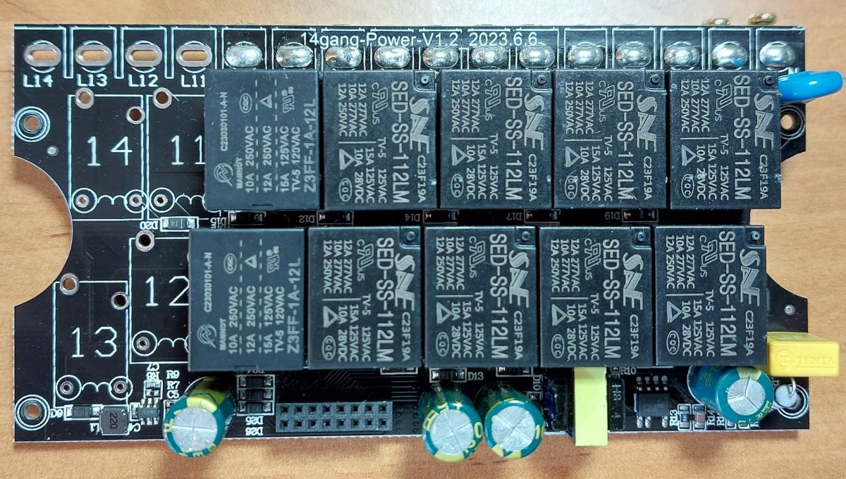

    Probably because of the number of relays, it is not directly operated via the BK7231N pins - because that is the circuit there, but via TuyaMCU.
    After changing the software to OpenBeken, you only have to find which dpId correspond to which relays and map them in OpenBeken. Then using mqtt you can do whatever you want e.g. in Domoticz
    Perhaps someone has already done this before and the dpId are known.
    I recommend by changing to backup CB3S so that in case of emergency you can return to the original firmware.

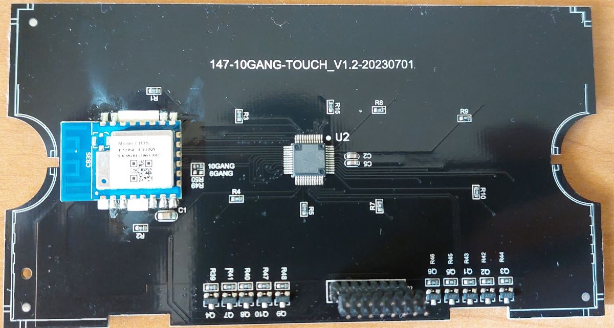

    So I have to read what the CB3S transmits to the TuyaMCU myself.
    Does the program to read is the TuyaMCU Analyzer?
    Do I read only the operation of the buttons or also the communication of establishing a network connection?
    Does the OpenBeken program have the possibility to handle some scripts. So that it turns off the switches after a certain period of time, for example.
    Or access to the source and handling of such an event in the code?
    In this switch the TuyaMCU processor has a burnt marking. Secret by secret.

    I have read the communication between the CPUTuya and the SB3S
    The button numbers are numbered from 1 to 6 and then from 102 to 105.
    How do I configure the alternative software?
    • Odczyt Tuya.txt (7.91 KB) You must be logged in to download this attachment.

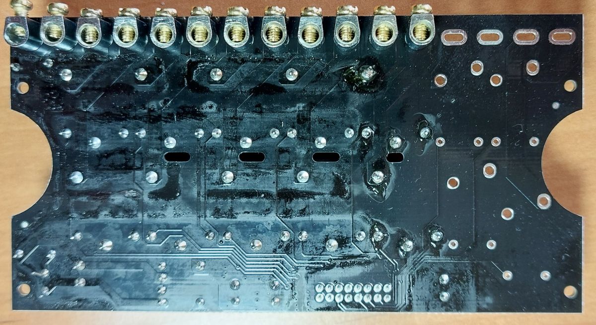

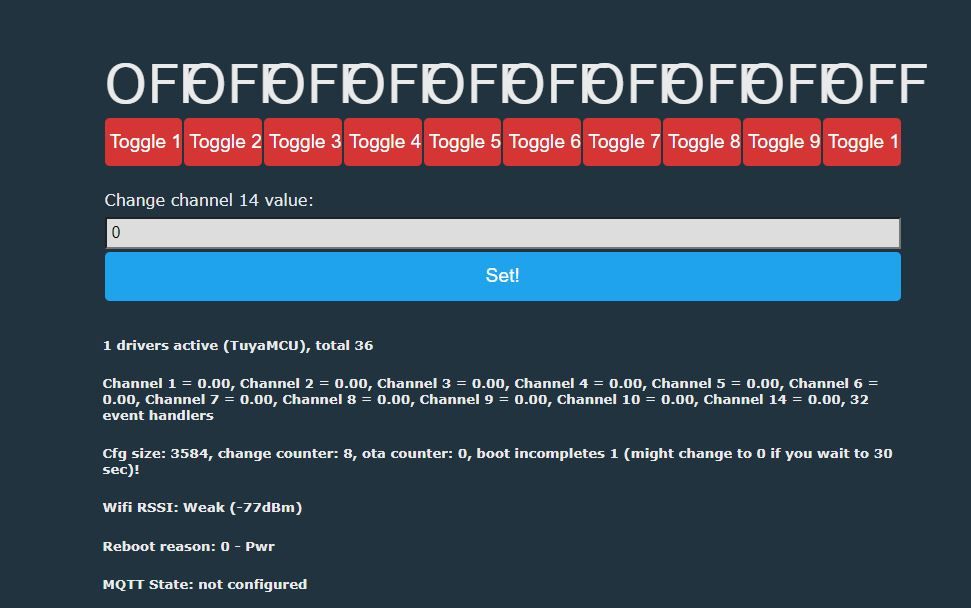

    I managed to get my 10 field switch working
    Programming in the device did not follow which prompted me to solder out. The programming of the soldered out chip went smoothly
    All switches are working.
    Configuration
    startDriver TuyaMCU
    setChannelType 1 toggle
    setChannelType 2 toggle
    setChannelType 3 toggle
    setChannelType 4 toggle
    setChannelType 5 toggle
    setChannelType 6 toggle
    setChannelType 7 toggle
    setChannelType 8 toggle
    setChannelType 9 toggle
    setChannelType 10 toggle
    linkTuyaMCUOutputToChannel 1 1 1
    linkTuyaMCUOutputToChannel 2 1 2
    linkTuyaMCUOutputToChannel 3 1 3
    linkTuyaMCUOutputToChannel 4 1 4
    linkTuyaMCUOutputToChannel 5 1 5
    linkTuyaMCUOutputToChannel 6 1 6
    linkTuyaMCUOutputToChannel 102 1 7
    linkTuyaMCUOutputToChannel 103 1 8
    linkTuyaMCUOutputToChannel 104 1 9
    linkTuyaMCUOutputToChannel 105 1 10
    SetChannelLabel 1 1
    Is it possible to change the button name from Toggle to another?
    Is it possible to set the buttons on the page in 2 lines aUser interface with switches and channel settings.
    I still have channel 14 inserted. Where is it set if the autoexec.bat file does not contain its declaration?
    How to remove it?
    It hangs up when I enter the Config session and click Configure Module or Configure General/Flags.
    Is it some program error or something in me?

  • #14 20812006
    Honsu
    Posts: 76
    After configuring the MQTT Auto Discovery client gateway with LAN interface in Domoticz, all switches were found in Domoticz.
    Only the label at switch on is displayed 1% at switch off is shortened to Off.
    How to correct this?
    How to program the openbk to time the switch on and switch off afterwards?

TL;DR: 10 channels mapped (dpIDs 1–6, 102–105). "I managed to get my 10 field switch working." Flash OpenBeken, map TuyaMCU outputs, then enable MQTT Auto Discovery in Domoticz to surface all switches. [Elektroda, Honsu, post #20811276]
How do I make Domoticz detect all 10 buttons on this Tuya glass switch?
Flash OpenBeken, start the TuyaMCU driver, set channels 1–10 to toggle, then link dpIDs 1–6 and 102–105 to channels 1–10. Save to your startup script and reboot. Test each channel from the OpenBeken UI, then point MQTT to your Domoticz broker. All 10 buttons operate after this mapping. How-To: 1. startDriver TuyaMCU; setChannelType 1..10 toggle. 2. linkTuyaMCUOutputToChannel 1..6 -> ch1..6 and 102..105 -> ch7..10. 3. Reboot and verify. [Elektroda, Honsu, post #20811276]
Which dpIDs correspond to the 10 relays?
Reading the TuyaMCU traffic showed button dpIDs numbered 1–6 and then 102–105. Link those ten dpIDs to channels 1–10 in OpenBeken to control all relays. This aligns the device’s touch zones with channel toggles. [Elektroda, Honsu, post #20809064]
Is this device TuyaMCU-based (CB3S/BK7231N)? Why does that matter?
Yes. A CB3S (BK7231N) module runs firmware that talks to a TuyaMCU coprocesor for relay control. Direct GPIO per relay is not exposed, so you map dpIDs instead. "After changing the software to OpenBeken, you only have to find which dpId correspond to which relays." [Elektroda, xury, post #20804364]
