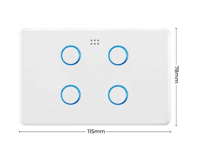

  • The Deta Grid Connect Smart Quad Gang Touch Light Switch - 6904HA uses a WB3S module with a BK7231T chip.
  • The chip was manually flashed with the BK7231 GUI Flash Tool, then the WB3S module pins were mapped for WiFi LED, buttons, and relays.
  • The switch was purchased from Bunnings Warehouse for $73.58AUD.
  • Pin assignments are listed as P1, P6, P7, P8, P9, P10, P14, P24, and P26 for WiFiLED, buttons, and relay channels 1 to 4.
  • The button layout is identified as Top Left channel 1, Bottom Left channel 2, Bottom Right channel 3, and Top Right channel 4, though the mapping is noted as uncertain.

    Button Layout on device - I did check it twice but let me know if I have it wrong.
    Top Left - Channel 1
    Bottom Left - Channel 2
    Bottom Right - Channel 3
    Top Right - Channel 4

    I used a 3D printed pogo pin jig to go over the top of the WB3S chip so that no soldering of wires was needed.
    I flashed a Deta 4 gang 6904HA series II and the pins are the same but I wanted the switch to go across ways not vertical. So 1 and 2 across the top and 3 and 4 across the bottom. This resulted in the following pin layout.
    P6 - Button - Channel 4
    P7 - Relay - Channel 4
    P8 - Relay - Channel 3
    P9 - Button - Channel 1
    P10 - Button - Channel 2
    P14 - Button - Channel 3
    P24 - Relay - Channel 2
    P26 - Relay - Channel 1
    Interestingly these did not correspond in any way to the switch wire locations on the actual switch except for button 4.
