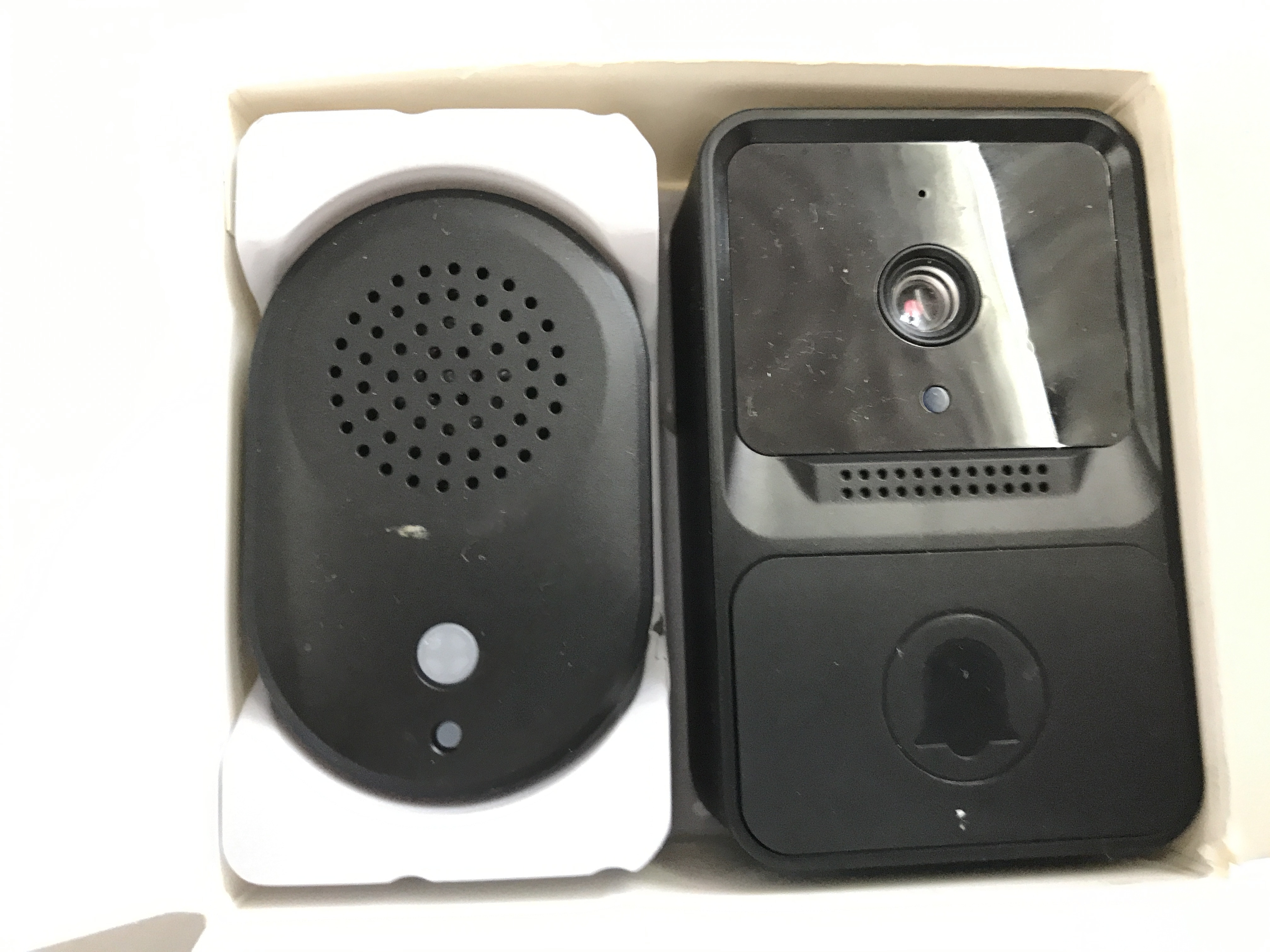

The kit comes with a battery-powered module with camera and button, and a separately USB-powered receiver to play the ringtone.

Interior of the camera Now perhaps the most interesting part. Inside is a YW 803035 800 mAh 3.7 V 2.96 Wh battery and a single board. You can also see the antenna.
Removing the board. You can already see the XR872AT Wi-Fi chip and the second antenna on the PCB. You can also see the two quartz resonators. It can be judged that probably one chip is the Wi-Fi connectivity and the other is the RF to the module that plays the ringtone.
Here is the Wi-Fi chip section - the software is on a 25QH32 flash bone, which is 2MB in size.
This memory can be soldered out and read using CH341.
Memory in the process of being read out:
Copy of the batch (XR872_Doorbell_T2Kemet_CH341_25QH32CHIG):
