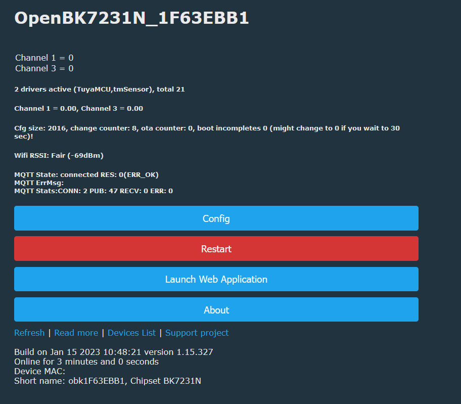

  • OpenBeken already supports it via tuyaMCU and tmSensor drivers, but RX/TX are occupied by TuyaMCU, so programming needs cutting or unsoldering the MCU.

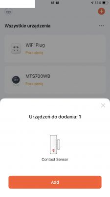

    Test with applicationTuya
    The sensor is repainted with SmartLife and the QR code leads to the SmartLife application, but is also compatible with the original, "orange" Tuya application:
    Energy-saving (?) Battery-operated door / window sensor for WiFi DS06 Energy-saving (?) Battery-operated door / window sensor for WiFi DS06 Energy-saving (?) Battery-operated door / window sensor for WiFi DS06 Energy-saving (?) Battery-operated door / window sensor for WiFi DS06
    You can create automation in it, but this has already been discussed in the forum several times.

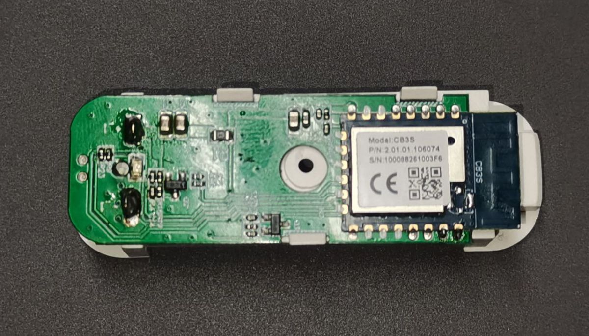

    Interior of D06
    It is enough to pry the housing with a knife:
    Inside there is a CB3S WiFi module (BK7231N) and a microcontroller (no marking):

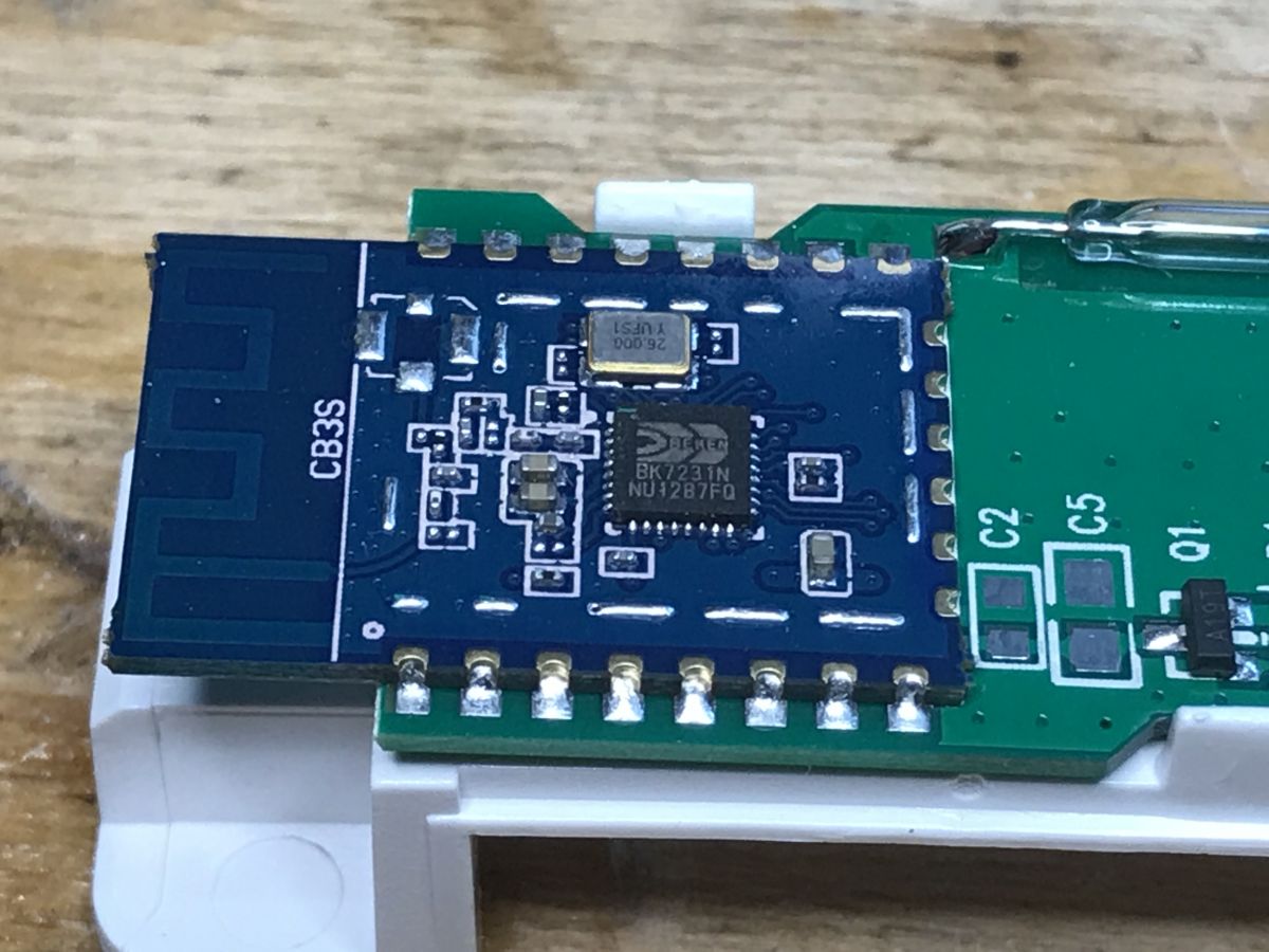

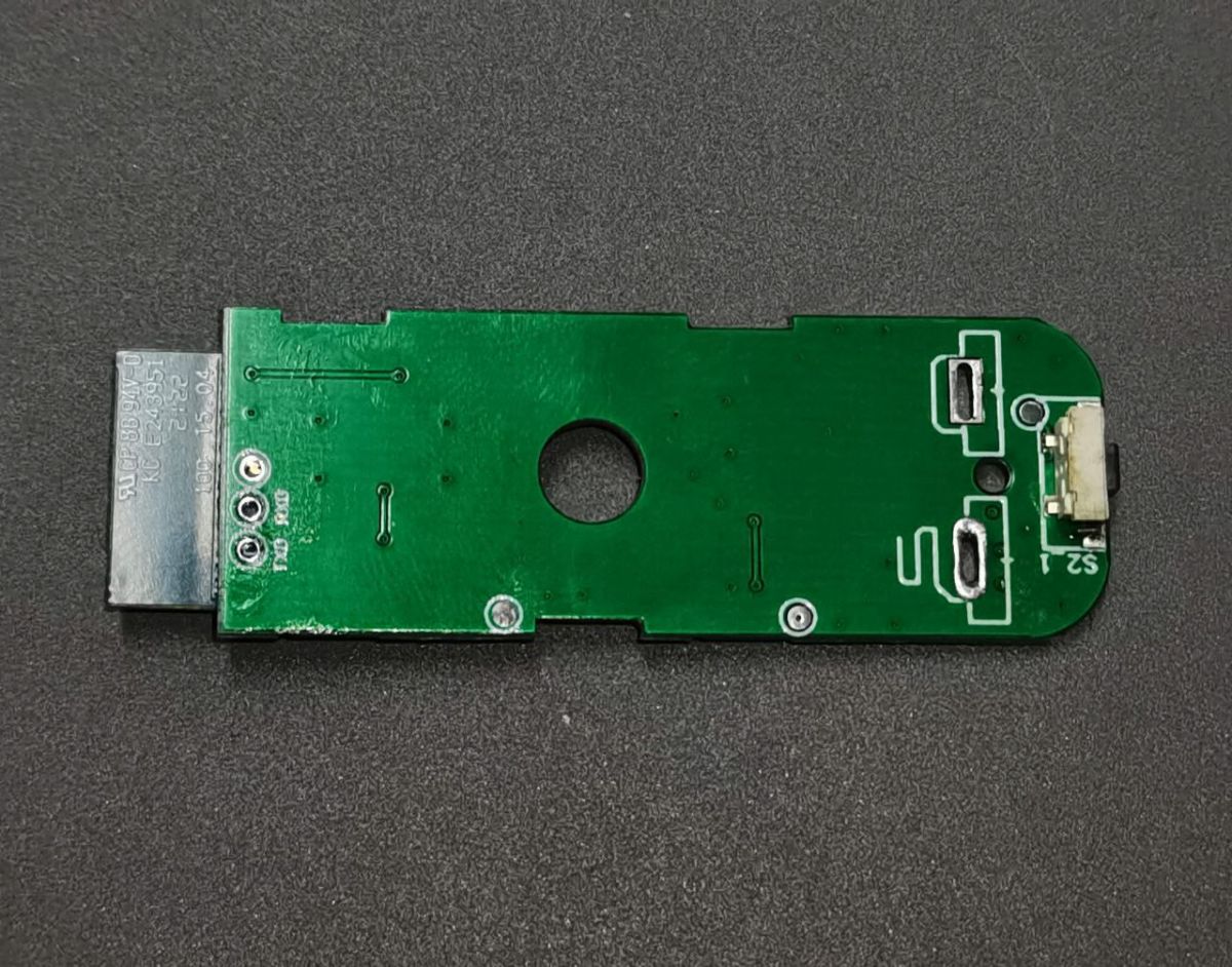

    In order to analyze the tile in more detail, I first removed the binder with the braid and then removed it from the plastic base:
    However, there is not much on the bottom:

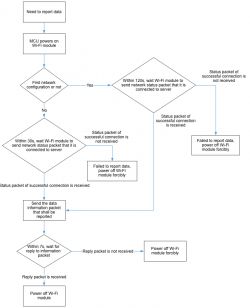

    The method of reporting data by the sensor is illustrated by this algorithm:
    The WiFi module works for a really short period of time, normally only the microcontroller in the low power consumption mode listens for changes on the sensor.

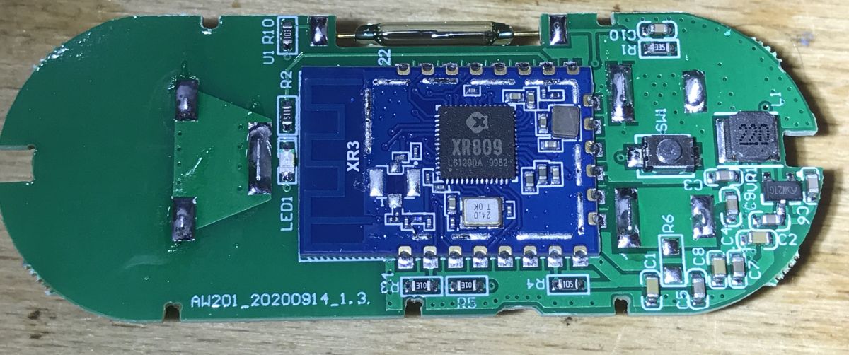

    A twin product - flood sensor W06
    As in the case of the previously discussed window opening / door sensor based on the XR809 module (but without TuyaMCU), this product is also sold in the form of a flood sensor - it is just the same PCB, the same circuits, but instead of the reed switch, the contacts are just brought out moisture sensor:
    I performed the tests below on both devices - they work similarly.
    The only difference is that we as a user know that the door open sensor is reporting Open / closed and the moisture sensor reports wet / dry . The packages themselves are identical.

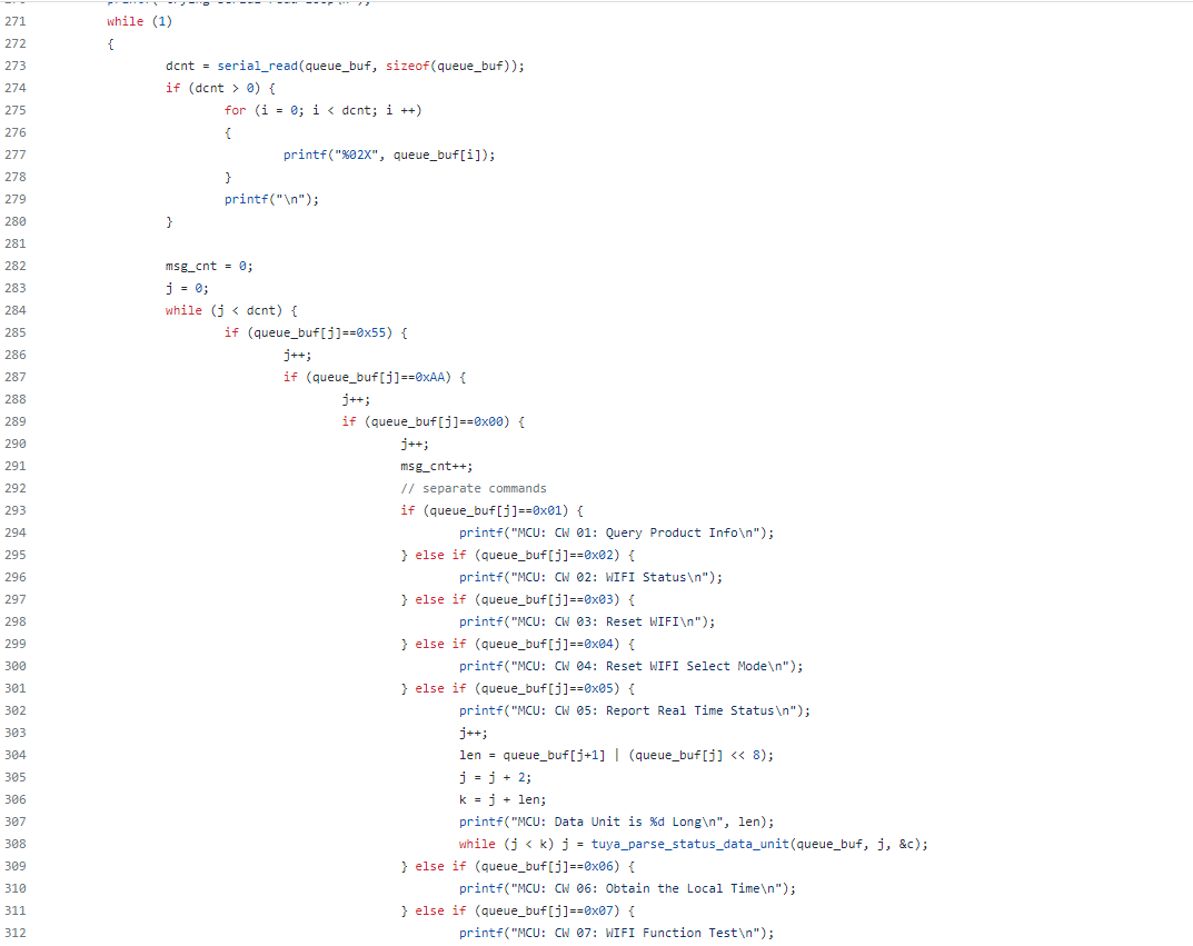

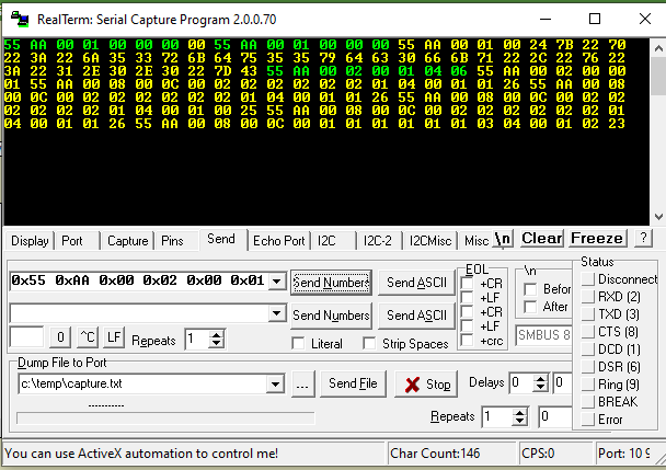

    Captured TuyaMCU packets to UART
    I intercepted at baud 9600. I leave packages here, among others. for myself for the future, when I will implement / finalize the support of this TuyaMCU version in OpenBeken .
    I described the basics of TuyaMCU here (it was a slightly different version, but most of it fits):
    TuyaMCU protocol - communication between the microcontroller and the WiFi module .
    When analyzing packages, I recommend using the official documentation:
    Serial Communication Protocol
    Activation.
    CB3S ships:
    55 AA 00 01 00 00 00
    We have here (hex):
    - heading - 55 AA
    - version - 00
    - command code - 01
    - data length - 00 00
    - checksum - 00
    Command code 0x01 is getting product data - Query Product Information.
    TuyaMCu replies:
    55 AA 00 01 00 24 7B 22 70 22 3A 22 65 37 64 6E 79 38 7A 76 6D 69 79 68 71 65 72 77 22 2C 22 76 22 3A 22 31 2E 30 2E 30 22 7D 24
    The content of this packet (0x24 bytes long, i.e. 36 bytes in decimal) is ASCII text:
    55 AA 00 01 00 24 {"p": "e7dny8zvmiyhqerw", "v": "1.0.0"} $
    Device ID + version.
    Already paired, contact closed when power was applied.
    (in the following quotes I have not divided separate request-reply pairs, only in the form of one block, I gave first what the CB3S sends and then what the microcontroller corresponds to)
    CB3S ships:
    00 00
    55 AA 00 02 00 01 04 06
    55 AA 00 08 00 01 00 08
    55 AA 00 08 00 01 00 08 00
    TuyaMCu replies:
    00
    55 AA 00 02 00 00 01
    55 AA 00 08 00 0C 00 02 02 02 02 02 02 01 01 00 01 01 23
    55 AA 00 08 00 0C 00 01 01 01 01 01 01 03 04 00 01 02 23 00
    The message type 0x02 is a setting of the WiFi working status, and 0x08 is already sensor data, but more on that in a moment. First, a few more examples.
    Already paired, device in sleep mode, I woke it up by closing the contact.
    CB3S ships:
    00
    head vr id size FL YY MM DD HH MM SS ID TP SIZE VL CK
    55AA 00 08 000C 00 02 02 02 02 02 02 01 01 0001 00 22
    55AA 00 08 000C 00 01 01 01 01 01 01 03 04 0001 02 23
    Under the package I wrote what is what - head (header), vr (version), id (package identifier), size (size), FL (flag), then date values, then ID (dpID / fnID, i.e. the name of the variable) , TP (type), SIZE (variable value size), VL (value - its value), CK - checksum, checksum.

    0x55 0xAA 0x00 0x01 0x00 0x00 0x00
    Response:
    55 AA 00 01 00 24 7B 22 70 22 3A 22 6A 35 33 72 6B
    64 75 35 35 79 64 63 30 66 6B 71 22 2C 22 76 22 3A 22 31 2E 30 2E 30 22
    7D 43
    Yes - this is already the packet discussed with an ASCII value of type {"P": "vHXEcqntLpkAl ***", "v": "1.0.0 "} ;
    Screenshot:
    How do we try to ask him about his condition?
    0x55 0xAA 0x00 0x08 0x00 0x01 0x00 0x08
    No answer.
    You have to send the configuration first, then you can ask for Data Points 0x08:
    0x55 0xAA 0x00 0x02 0x00 0x01 0x04 0x06
    Below is the entire transaction:
    Broken answers:

    Configuration in OpenBeken
    My OpenBeken it already supports this sensor, but I haven't fully tested the full functionality yet.
    To support this sensor, you need to turn on two "drivers", one TuyaMCU and the other tmSensor. TuyaMCU handles the UART communication base, and the tmSensor itself sends out state inquiries (remember - the WiFi module first responds to TuyaMCU via UART).
    Here is the OpenBeken command line (I entered it in the startup command to be executed at startup):
    backlog startDriver tuyaMCU; startDriver tmSensor; linkTuyaMCUOutputToChannel 1 val 1; setChannelType 1 ReadOnly; linkTuyaMCUOutputToChannel 3 val 3; setChannelType 3 ReadOnly;
    Channels / dpID the same as above - 1 and 3. One is the state of the sensor, the other is the battery.
    Yaml configuration in Home Assistant (this example is for a water sensor, but as I wrote, it's the same system, only a different sensor, the door opening sensor works similarly):
    Code: YAML
    I have not done the battery reading yet - I will post the full version in the next topic.
    Screenshot from the panel:

    As for the TuyaMCU protocol for battery powered devices; such a curiosity; I can see that someone, based on my article about XR809 programming, made a simple demo of this protocol only for this platform:
    https://github.com/tony-fav/FavTuyaXR3
    This is an attempt at a custom firmware for the Feit Electric Smart Wi-Fi Water Sensor (https://www.feit.com/product/smart-wi-fi-water-sensor/) which has a Tuya XR3 WIFI Module ( https://developer.tuya.com/en/docs/iot/xr3-datasheet?id=K98s9168qi49g) following the efforts of p.kaczmarek2 on elektroda.com (https://www.elektroda.com/rtvforum/topic3806769. html # 19447386). I got mine from my local Menards after seeing the elektroda post because it seemed like a fun project (https://www.menards.com/main/plumbing/pumps-tanks/pump-well-tank-accessories/feit-electric- smart-wi-fi-water-sensor / senfwag / p-7919224473280192-c-8672.htm).
    You have photos of another device from TuyaMCU, this time on XR3, I have not seen one like this before.
    Package parsing the code author has here:
    https://github.com/tony-fav/FavTuyaXR3/blob/master/project/at_demo/main.c
    Although this is only quickly put together, judging by the way it is implemented:
    Code: C / C++

    Hi.
    I bought another revision of the water leakage sensor.
    It contains cb3s and um8005(tuya?) chips.
    I flashed cb3s with the latest firmware OpenBK.
    It works, but tuyaMCU needs baud rate 115200. I used startup command "tuyaMcu_setBaudRate 115200"
    But there is a problem. Often the first time we get wet, the mqtt doesn't send a message. If you immediately dry it and wet it again, the messages come normally. After a deep sleep, the first message can again be missed.
    in the stock firmware all messages arrive correctly

    Hypothesis: the channel changes before the wifi connects. This is strange. the code is expected to connect to mqtt.
    Also i enable flag 19 - [MQTT] Always publish channels used by TuyaMCU and set the start value for channel 1 and 3 as '9'. For me it means 'unknown' in HomeAssistant
    Success:

    If enable only in flag 19 it works too.
    Thanks for your project!

    Hey,
    First of all, thank you for the great work. Flashing the sensors worked great with the instructions. This is my first attempt at openbeken.
    I can also reach the modules via IP address and MQTT. Unfortunately, the sensor does not send any change in contact state. I assume it's a pin configuration issue. I can't find any reference to it. I tested it with different settings but still can't.
    TuyaMCU works.
    Can anyone give me a hint which setup is still pending? Do I need to adjust anything on the pins? if yes, where?
    Thank you and best regards

    #18 20386473
    klaudi43
    Posts: 8
    Witam,
    Przede wszystkim dziękuję za szybką informację zwrotną. Dostosowałem ustawienia zgodnie z opisem. Niestety oba kanały wysyłają tylko 0.
    Zakładam, że jest to związane ze sprzętem. Wydaje się, że jest to nowa generacja czujników. Wygląda więc na to, że to coś większego.
    „Bawiłem się” również dostosowywaniem szybkości transmisji i przełączaniem kanałów, ale zawsze uzyskuję te same wyniki.
    Zrobiłem zdjęcie modułu. Może to pomaga.
    Jeszcze raz dziękuję i pozdrawiam!

    Wait a minute, is that your device? There is no TuyaMCU on your board.
    The TuyaMCU is external microcontroller that is next to the WiFI module:
    Your device is not a TuyaMCU one.
    You should configure it differently.
    What kind of device is that and where was it bought?
  • #20 20386573
    klaudi43
    Posts: 8
    Kupiłem na Ebayu. Numer zn373141_01 jest wydrukowany na opakowaniu. Odpowiada również zdjęciom na AliExpress i jest oferowany jako Tuya / Aubess.

    Please attach screenshots from ebay offer to the post. Futhermore, I am still not sure what kind of sensor is that - is this a door sensor or a remote switch? I can't see the sensor part... here's a photo of another door sensor, I am asking about the part marked with arrow:
    Futhermore, on .com domain please reply in English and on .pl domain reply in Polish, that is because we have automatic translation between those two sides and it breaks if someone uses wrong language on wrong side of the forum.
    Why is the sensor not soldered on your photos? Is your device some other kind of IoT gadget, I don't know, a remote switch?

    klaudi43
    Posts: 8
    Hi,
    these are Door Senors. I've bought them "second hand". The seller used them with tuya software and it has worked (I have to believe this, because I didn't try it.). As I mentioned, I think this is another generation of sensors. It seems, the functionality is in the CB3S - Module. I've seen the missing hall-sensor but - I'm not sure, because of missing documentation, this could be another type of hall-sensor. (Q3 on the picture - 204NS).
    Please excuse the language confusion.
    Best regards!

    Posts: 14810
    Rate: 12977
    No problem, i guess the first step would be trying to figure out which IO port of CB3S is used for door state.
    You can do this in many ways, including:
    1. check with multimeter which IOs are connected where and sketch connections
    2. desolder CB3S and just take a look
    3. try guessing in firmware?
    As for firmware, I'd recommend setting "dInput" role, which is a digital input, with channel, let's say, 0, and then simulating door close and open to see if it changes from 0 to 1.
    This way you can figure out which IO is a door state.
    Futhermore, you will need a "PowerSave" command in short startup command otherwise battery will drain in HOURS. You will also need a Deep sleep feature soon, but we're working on it.
    Please remove MCU code, there is no TuyaMCU on this board.

    klaudi43
    Posts: 8
    Hello again,
    I tried configuring it with the CB3S module. The door contact works on pin 8. Maybe it will be helpful for others in this forum.

    Hello @klaudi43 , can you set the ADC role for the ADC pin, assign another channel and see it gives sensible readings?
    Where is ADC pin connected? Maybe it's the one we're looking for.
  • #26 20389942
    klaudi43
    Posts: 8
    Hi,
    by using the ACD3 Pin (P23) I get the Value 4096. By trying the same with other Pins, I only get a -1.
    Greetings
  • #27 20389963
    Posts: 14810
    Rate: 12977
    @klaudi43 maybe check on PCB? Do a bit more detailed PCB analysis...
    @klaudi43 we have a deep sleep progress, this will be useful for your device: https://www.elektroda.com/rtvforum/topic3945688.html#20389704 we might get your device fully supported really soon.
  • Measured pin voltages on DS06 sensor board
    #28 20400962
    klaudi43
    Posts: 8
    Hi,
    I've measured the pins, but I can't make sense of the values. But it's not my world either :).
    Maybe you can do more with the values. As I said - all soldered pins - except for the ADC always give a -1 out.

  • OpenBeken flash succeeded but bricked device
    #29 20405390
    elbuit
    Posts: 10
    Rate: 7
    klaudi43 wrote:
    Hello again,
    In the next step I need to find out how it is possible to monitor the battery level. I think it's realized on another pin.
    As you have already written, it currently makes no sense to operate the modules with batteries. So thanks again for the support! Have a good start into your week!
    Many greetings
    Hi.
    I've same device bought on aliexpress.
    Energy-saving (?) Battery-operated door / window sensor for WiFi DS06 Energy-saving (?) Battery-operated door / window sensor for WiFi DS06 Energy-saving (?) Battery-operated door / window sensor for WiFi DS06 Energy-saving (?) Battery-operated door / window sensor for WiFi DS06 Energy-saving (?) Battery-operated door / window sensor for WiFi DS06
    But I couldn't manage to install OpenBeken firmware.
    I tried with gui flash tool under linux but it showed a UART error.
    So I tried to flash with CLI but I got a CRC error.
    [/code]
    $ ./uartprogram -d /dev/ttyUSB0 -r door_sensor_pati_backup.bin -u
    UartDownloader....
    Read Getting Bus...
    Gotten Bus...
    Set baudrate successful
    len: 119000
    startAddr: 11000
    Reading 11000
    ReadSector Success 11000 len 1000
    4096
    Reading 12000
    ReadSector Success 12000 len 1000
    ReadSector Success 129000 len 1000
    1150976
    CRC should be 7f0be275
    CRC is 61efceb3
    CRC check failed
    Wrote 119000 bytes to door_sensor_pati_backup.bin
    [/code]
    I did it serveral times and I got the same error and the same CRC (61efceb3) so I thought that the CRC error couldn't come from the wires or the USB reader.
    So I tried to write the OpenBeken firmware, and it worked.
    $ ./uartprogram -d /dev/ttyUSB0 -w OpenBK7231N_QIO_1.15.384.bin -u
    UartDownloader....
    programm....
    Write Successful: |##################################################|[ 10.6k/s]
    But unafortunatelly that bricked my device, or at least I couldn't see OpenBeken SSID.
    Any advice to unbrick.
    Thanks.
    NOTE: I used CLI because I coulnd't manage to write OpenBeken firmware with the gui flashtool, I used CLI with an WB2S device and it worked fine but not the mono BK7231Flasher.exe.
  • uartprogram needs an offset parameter
    #30 20405438
    Posts: 14810
    Rate: 12977
    Hello @elbuit . You are using uartprogram incorrectly. Please consult manual:
    https://github.com/OpenBekenIOT/hid_download_py
    You are missing offset.
    You can also watch out CB2S flashing video:
    Here's the part that should interest you:
