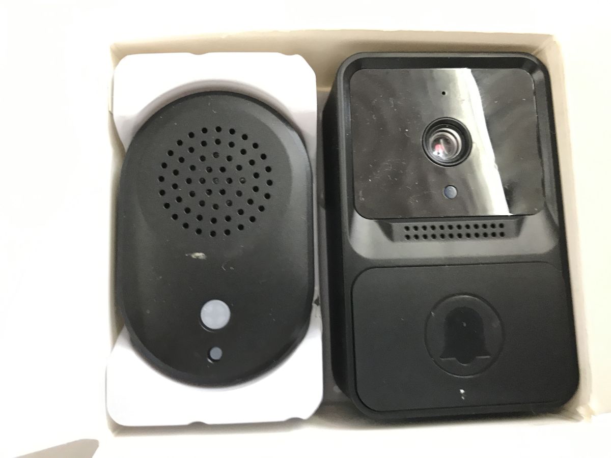

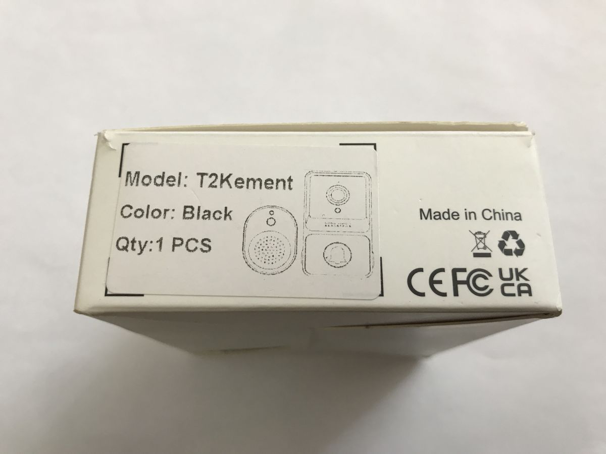

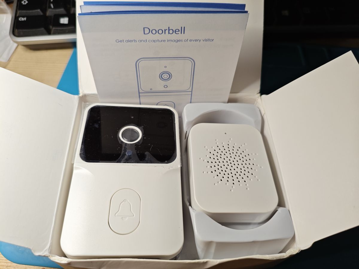

    The kit comes with a battery-powered module with camera and button, and a separately USB-powered receiver to play the ringtone.
    Let's start with the pairing.
    Before starting, it is a good idea to connect the product to the power supply. A regular USB C cable will suffice. On your phone we download the app Aiwit . On Google Play at the link com.eken.aiwit we find:

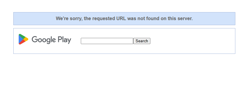

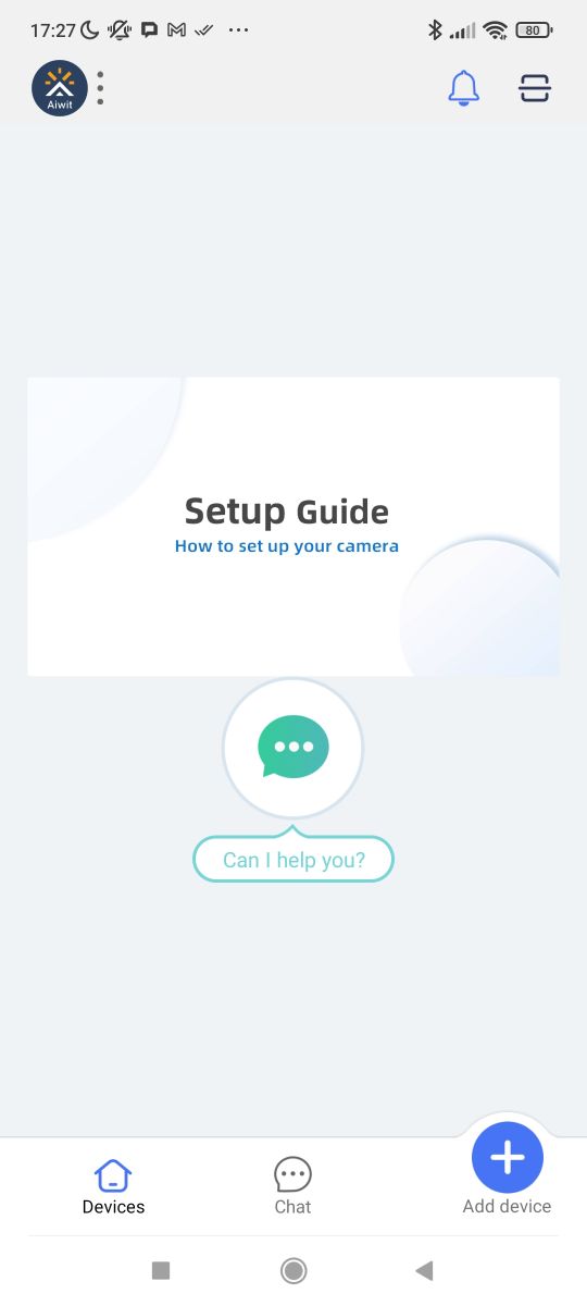

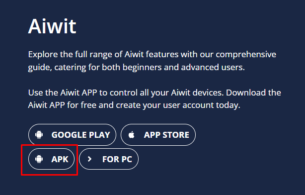

    The app has been removed - fortunately it is still possible to download it from the manufacturer:
    Battery-powered doorbell with camera and app - inside, what to look out for

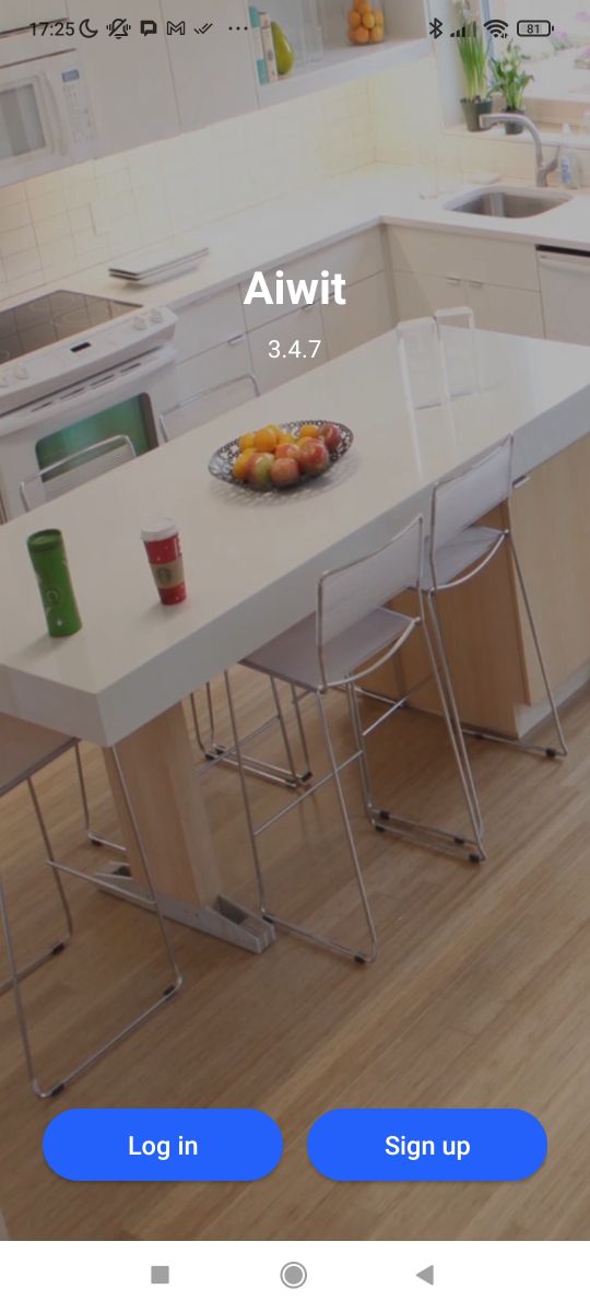

    We launch, register.

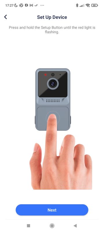

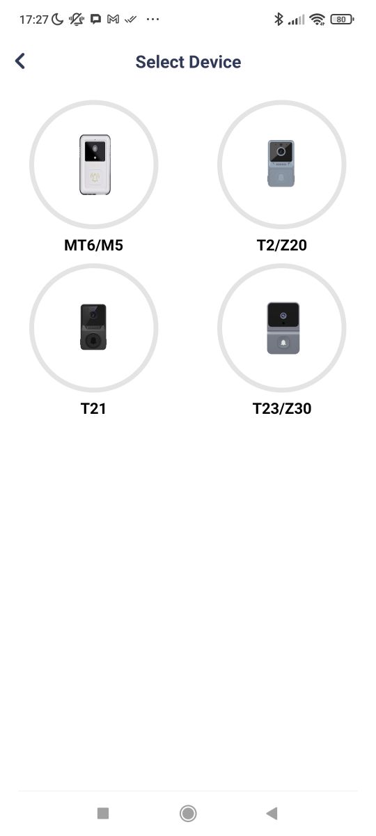

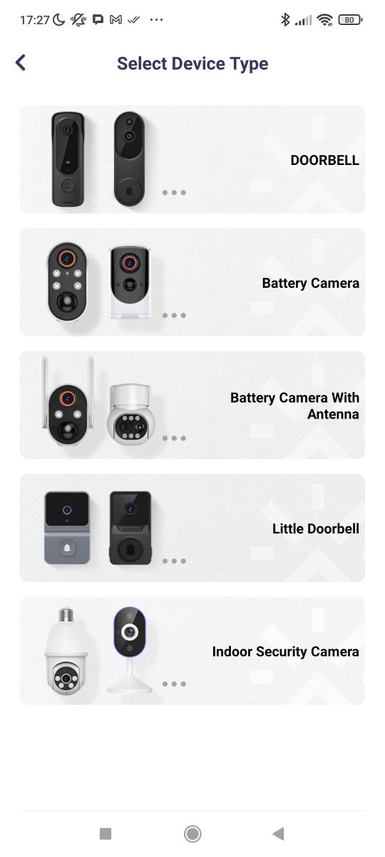

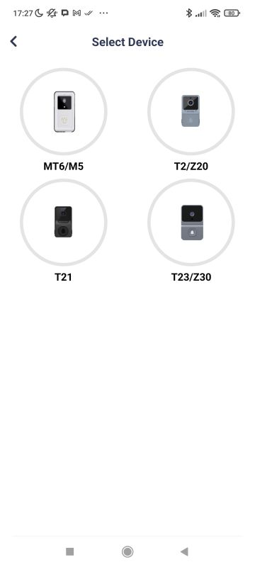

    We select our product type from the list. You can look by the images:
    Battery-powered doorbell with camera and app - inside, what to look out for Battery-powered doorbell with camera and app - inside, what to look out for
    We follow the instructions:
    To enter the pairing state, hold down the button longer. After a moment, the LED will start flashing and we will hear "entering pairing mode".

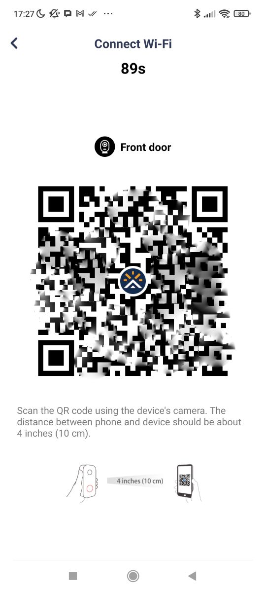

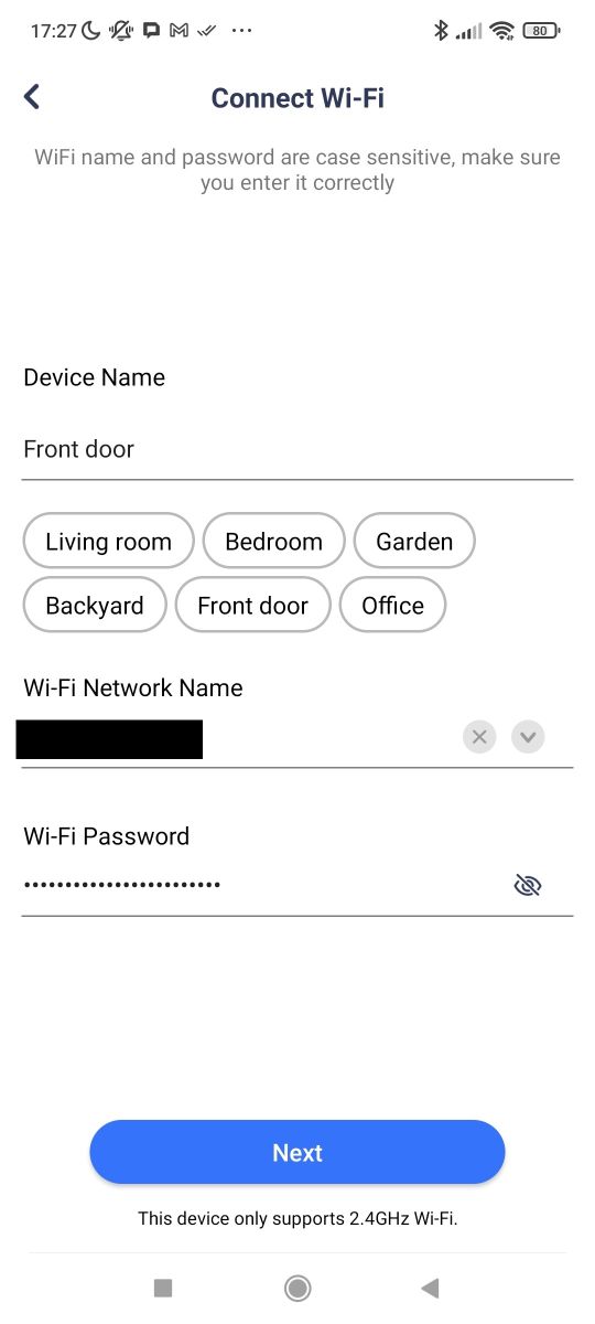

    The application will ask us for our Wi-Fi details - we need to enter the location of the 2.4 GHz network.
    The app will turn our Wi-Fi data into a QR code, which we then have to let the camera scan:

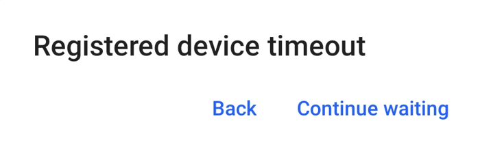

    I didn't get it right the first time:

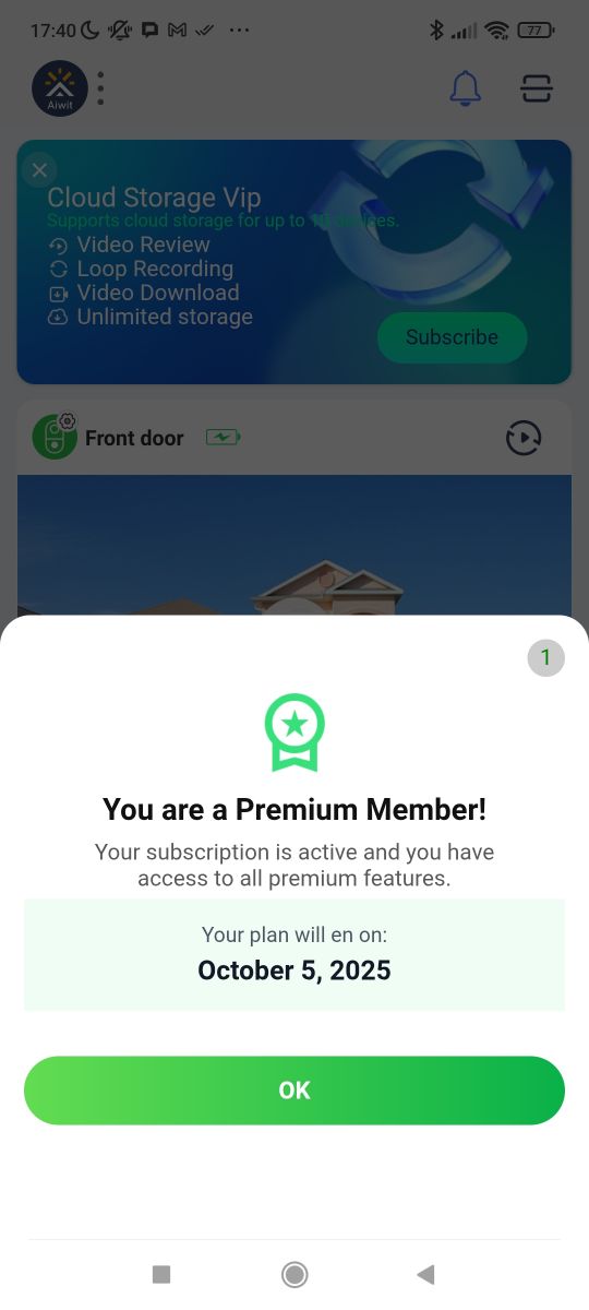

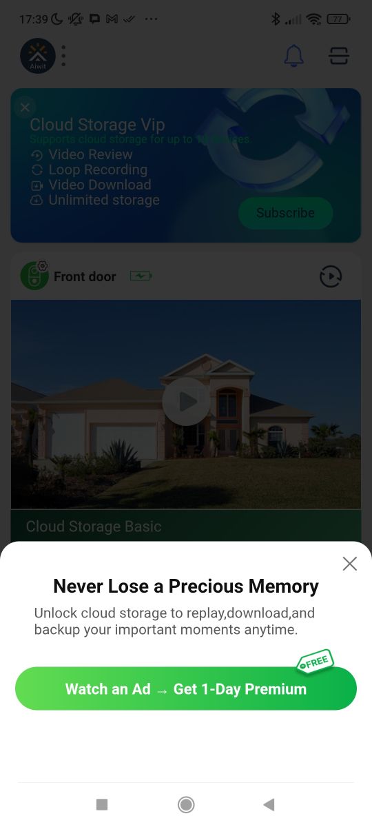

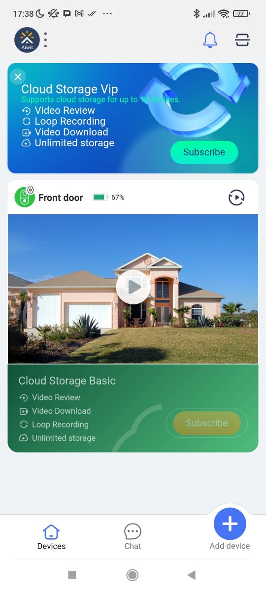

    Eventually it should work - the camera connects and the app offers us a paid plan:
    You can get one premium day for watching the ad:

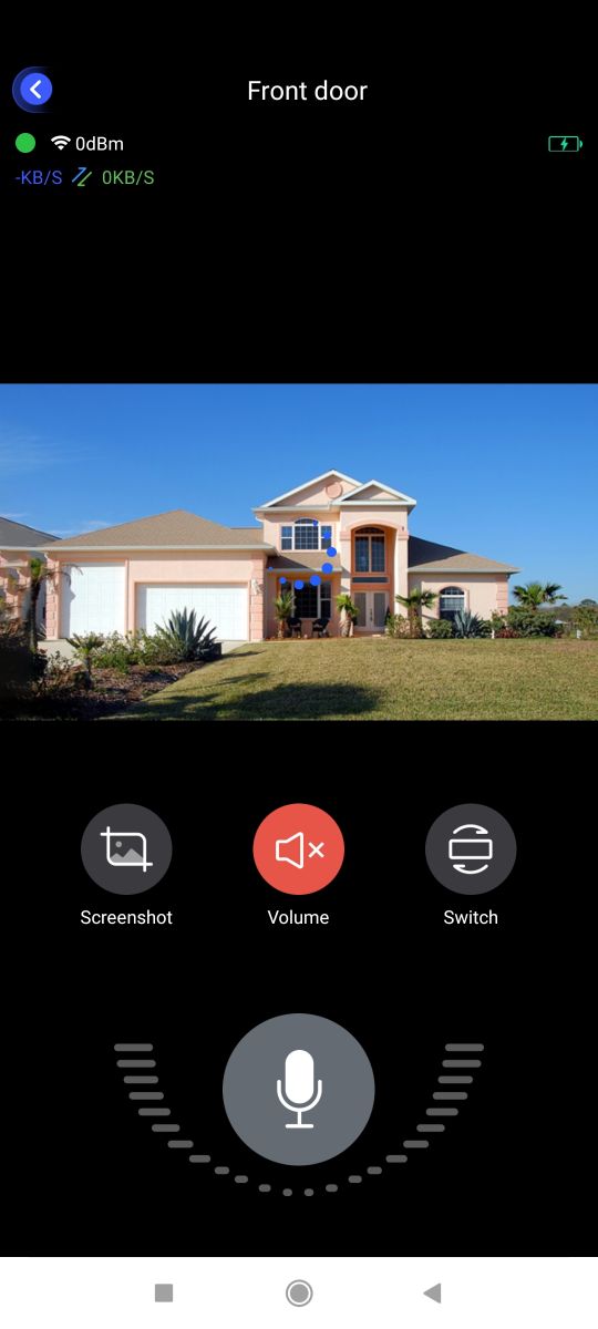

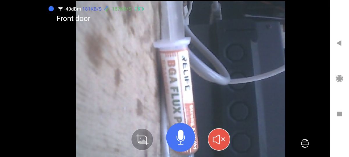

    The camera can then already transmit images:

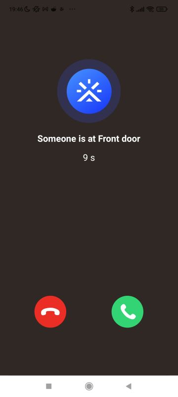

    Basis of operation
    The camera module is normally asleep and not connected to Wi-Fi. This helps to extend the battery life. Only pressing a button wakes it up. The video shows how quickly the phone responds to a ringtone.

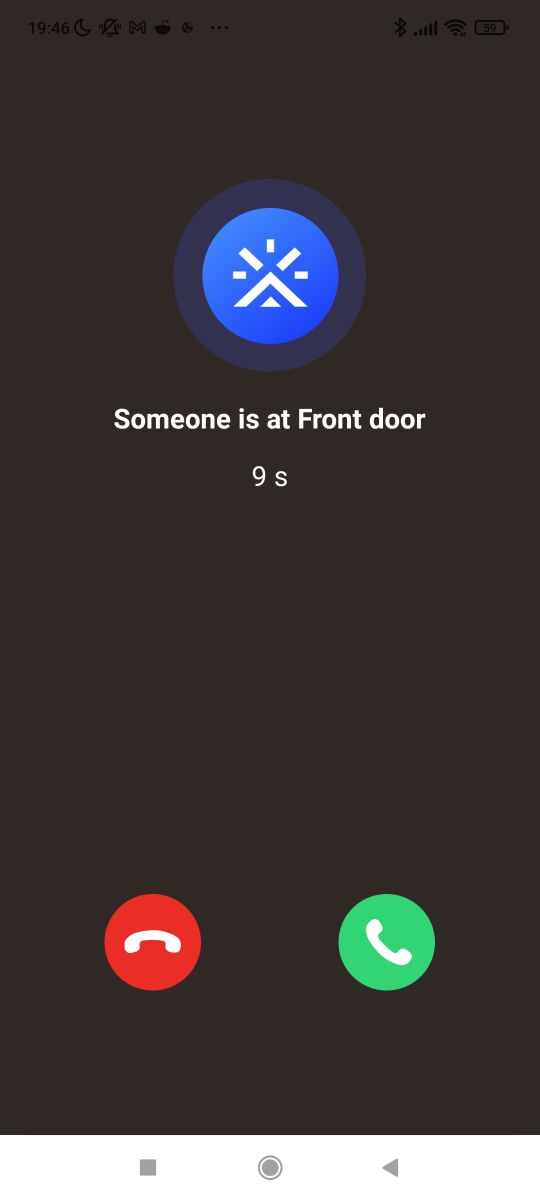

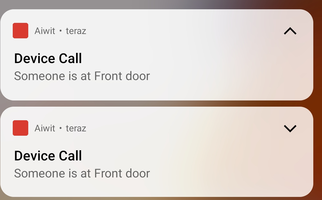

    When we pick up, we can see who is ringing the doorbell. There is also an option for two-way communication. If we are late, we have a notification and video footage in the history in the app.

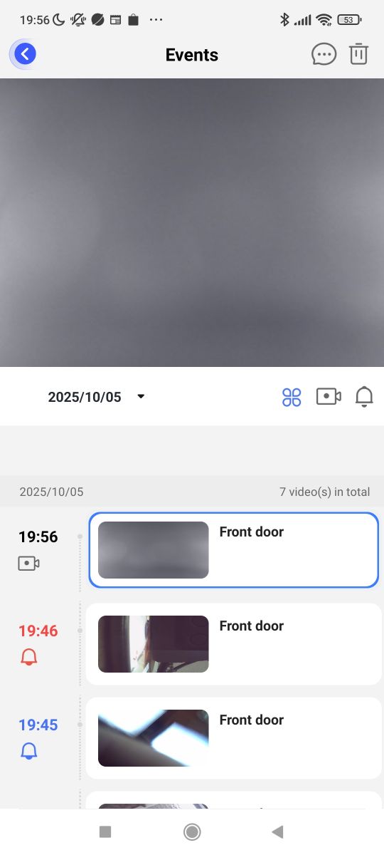

    After clicking on the notification, we still have the option to decide if we are sure we want to receive it:
    This is the story, unfortunately here it is paid for, which spoils the point of this product somewhat:

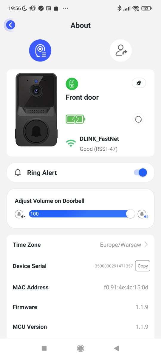

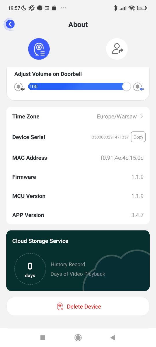

    Settings in the app
    In the app we have control of the volume level, product information (firmware, Wi-Fi, etc.), battery status and the possibility to share:

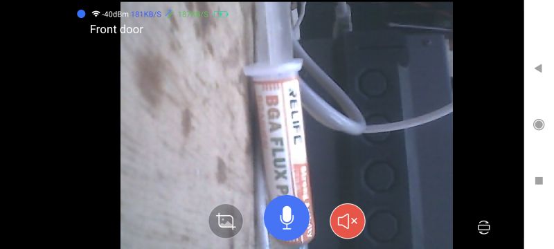

    Camera response time
    Let's check how much latency the video sent by the camcorder has;

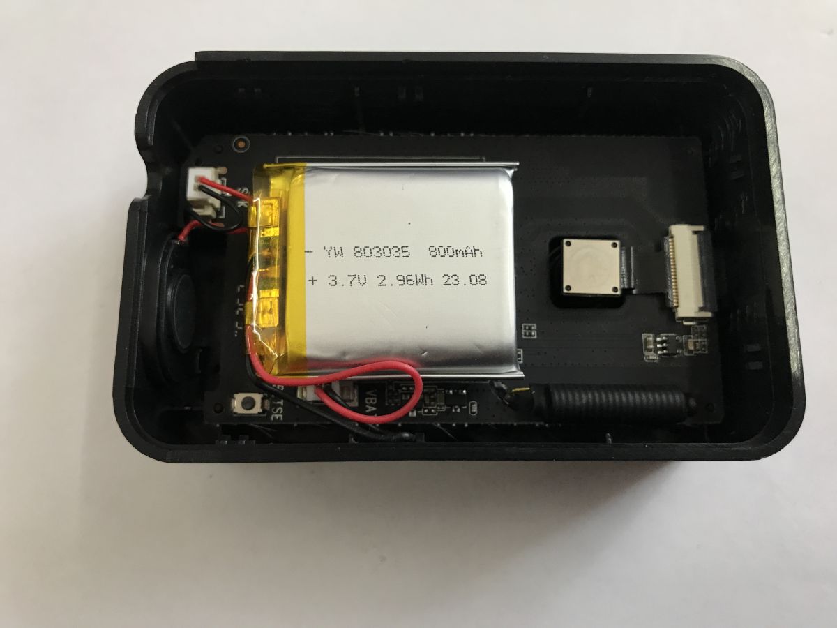

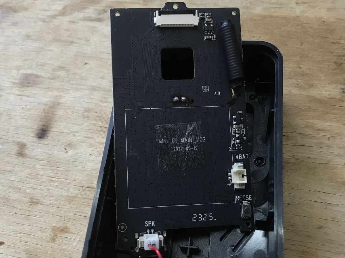

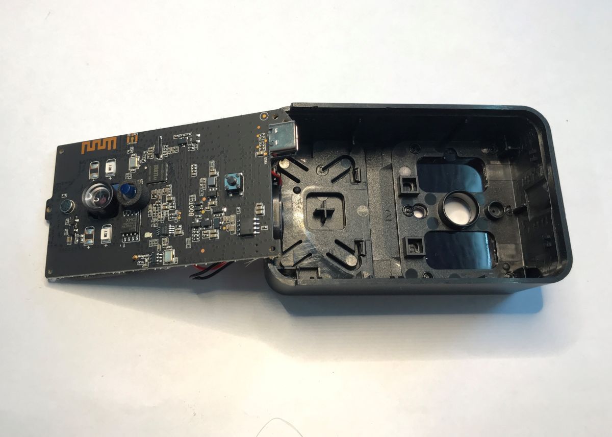

    Interior of the camera

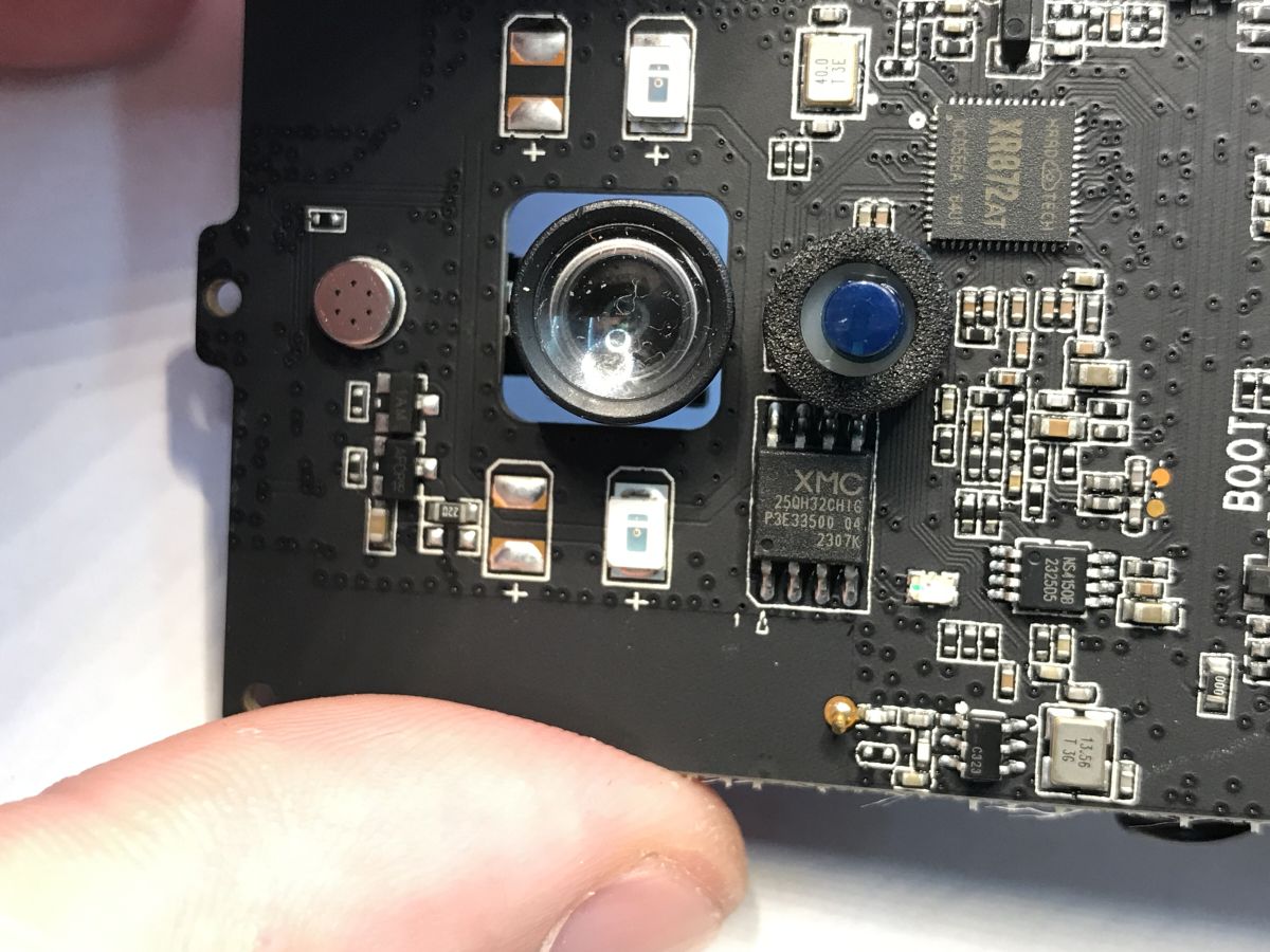

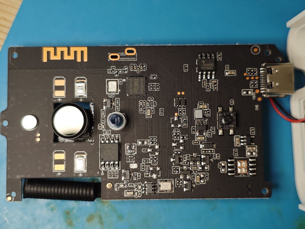

    Now perhaps the most interesting part. Inside is a YW 803035 800 mAh 3.7 V 2.96 Wh battery and a single board. You can also see the antenna.

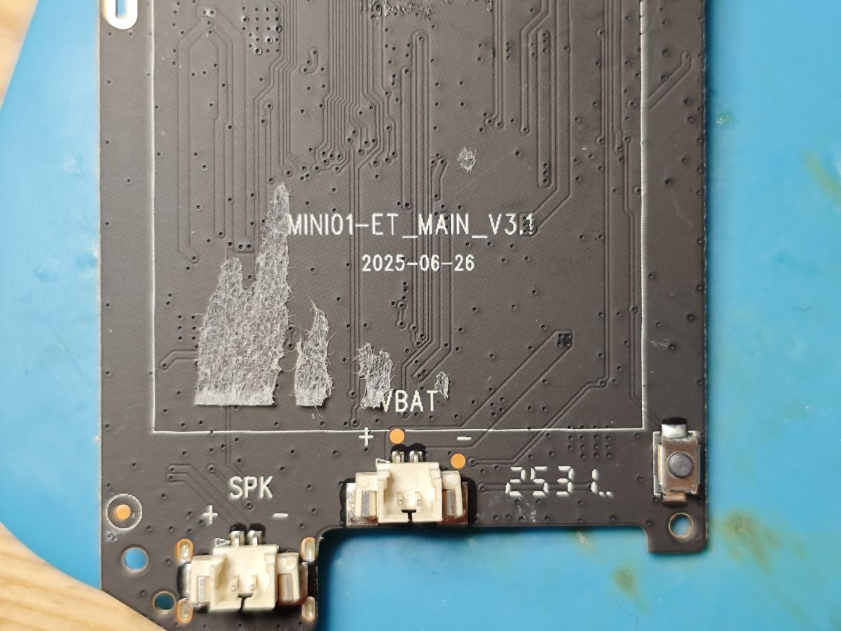

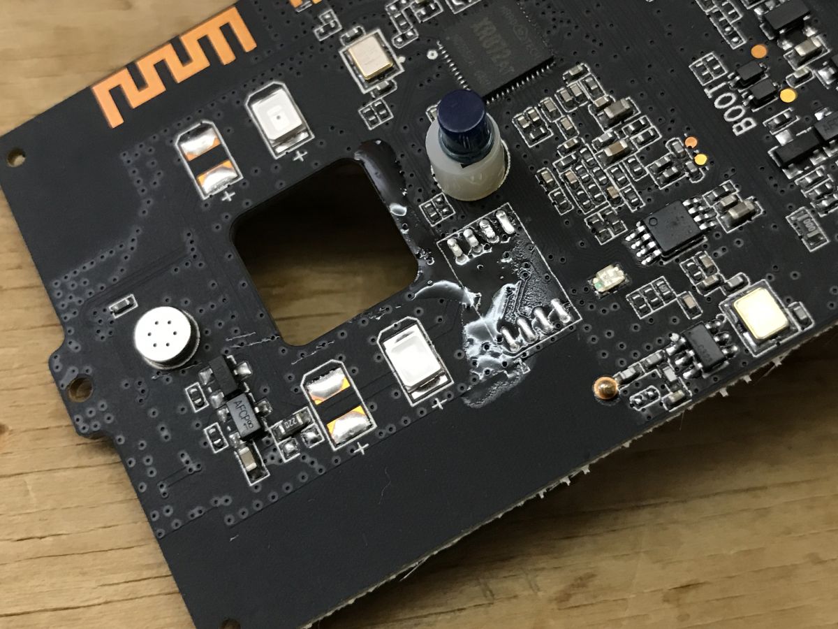

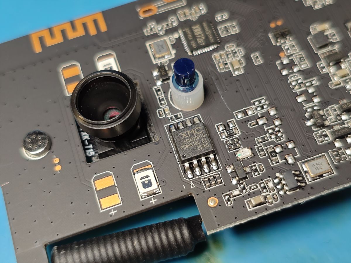

    Removing the board. You can already see the XR872AT Wi-Fi chip and the second antenna on the PCB. You can also see the two quartz resonators. It can be judged that probably one chip is the Wi-Fi connectivity and the other is the RF to the module that plays the ringtone.

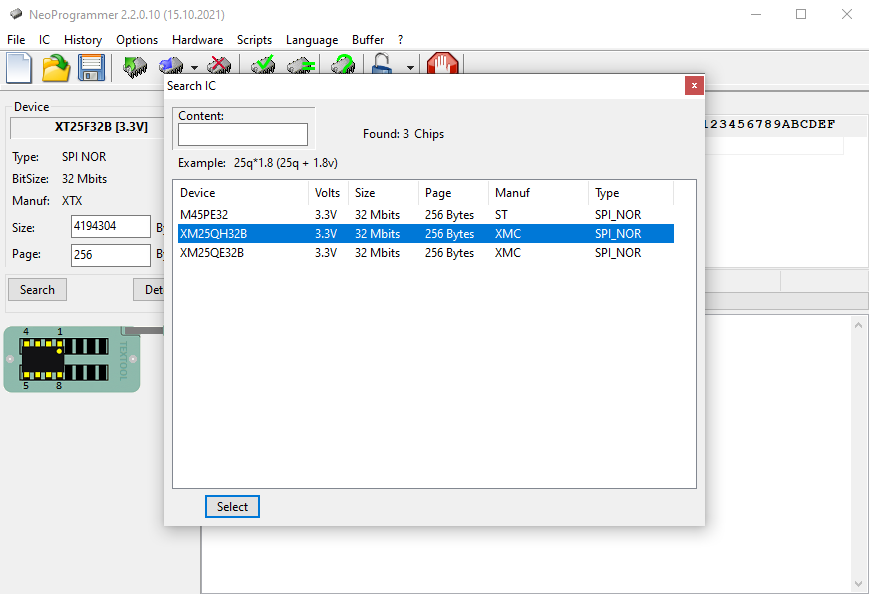

    Here is the Wi-Fi chip section - the software is on a 25QH32 flash bone, which is 2MB in size.

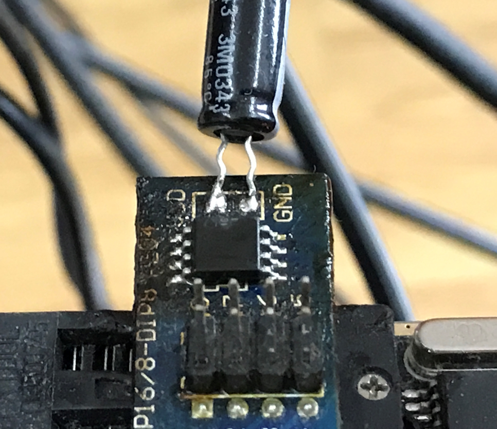

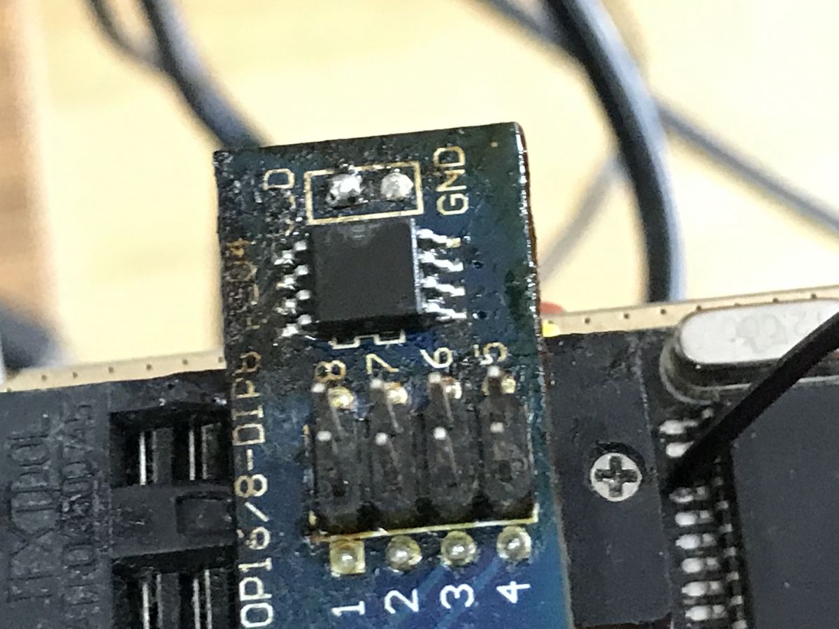

    This memory can be soldered out and read using CH341.
    Memory in the process of being read out:
    Copy of the batch (XR872_Doorbell_T2Kemet_CH341_25QH32CHIG):
    https://github.com/openshwprojects/FlashDumps/commit/f91d84604147e8c4b082f8e160d2c815af87a415
    There is an interesting problem with this memory - I could not overwrite it (clear and program it) until I added a capacitor to the power supply :

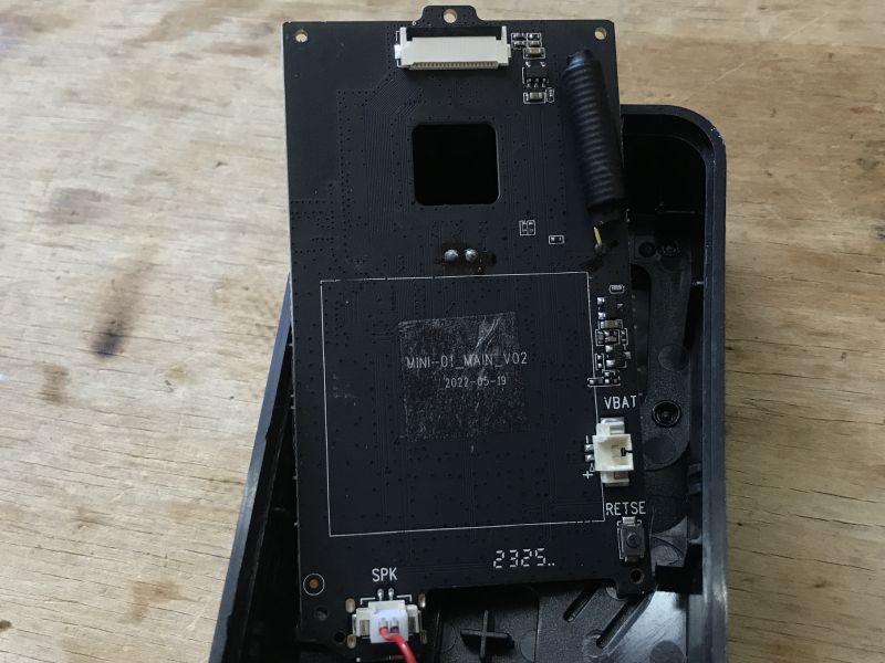

    Other side of the plate:

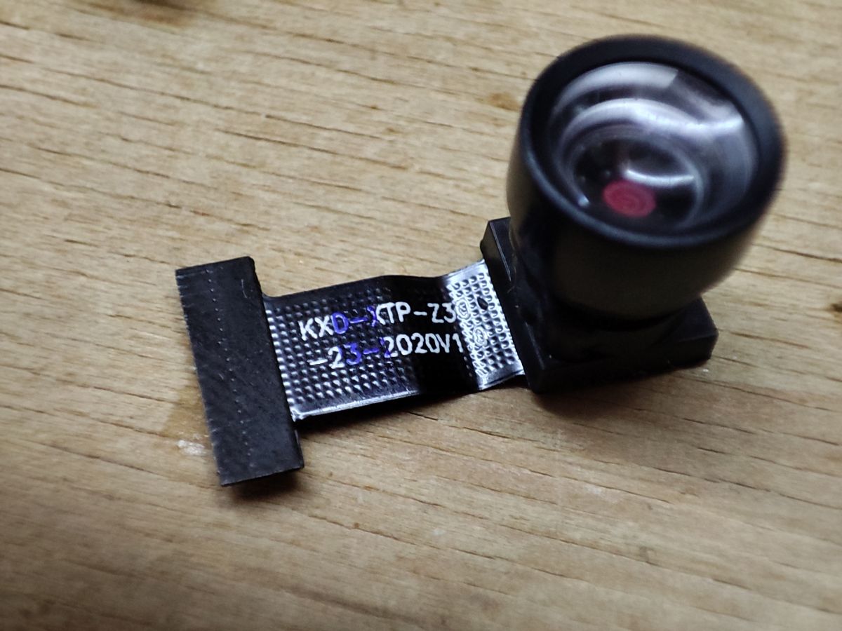

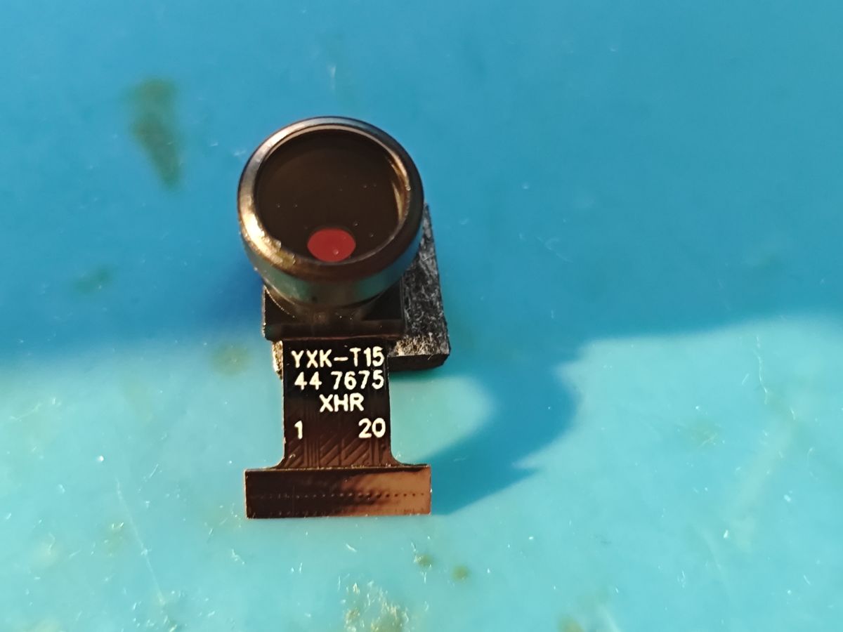

    Camera:
    The microcontroller from the middle is supported by OBK , but we do not have a camera controller yet. Only the GPIO can be controlled:

    This removed app from Google Play does not bode well - I wonder what they deleted it for?

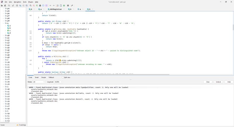

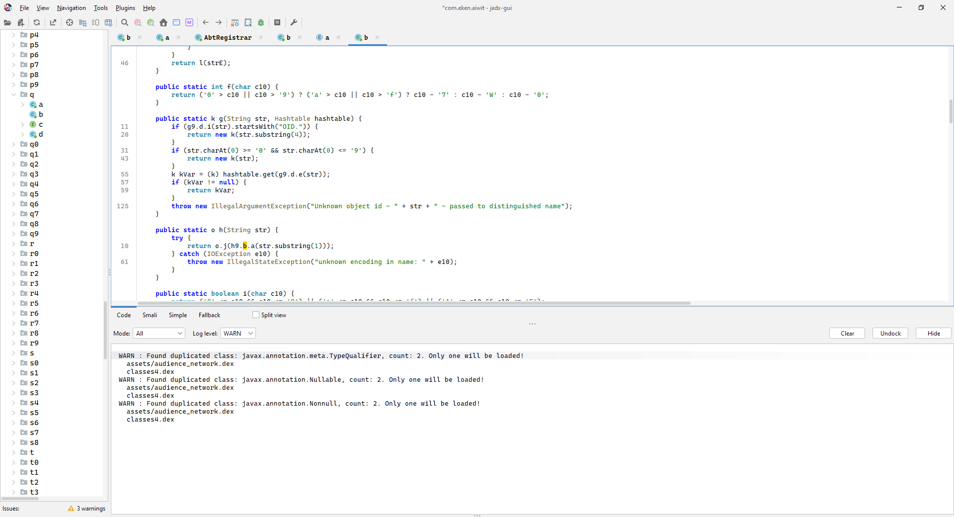

    Aiwit app backup from APKPure - Aiwit_3.4.8_APKPure.xapk
    Following can be opened with, for example, jadx-gui-1.5.3.exe, to see code.
    jadx-gui IDE showing decompiled Java code and class duplication warning messages
    Some curious settings and stuff:
    Code: Java

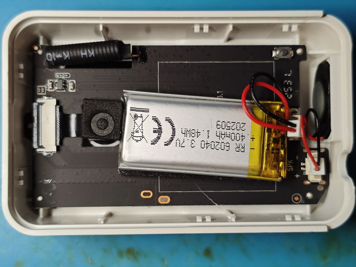

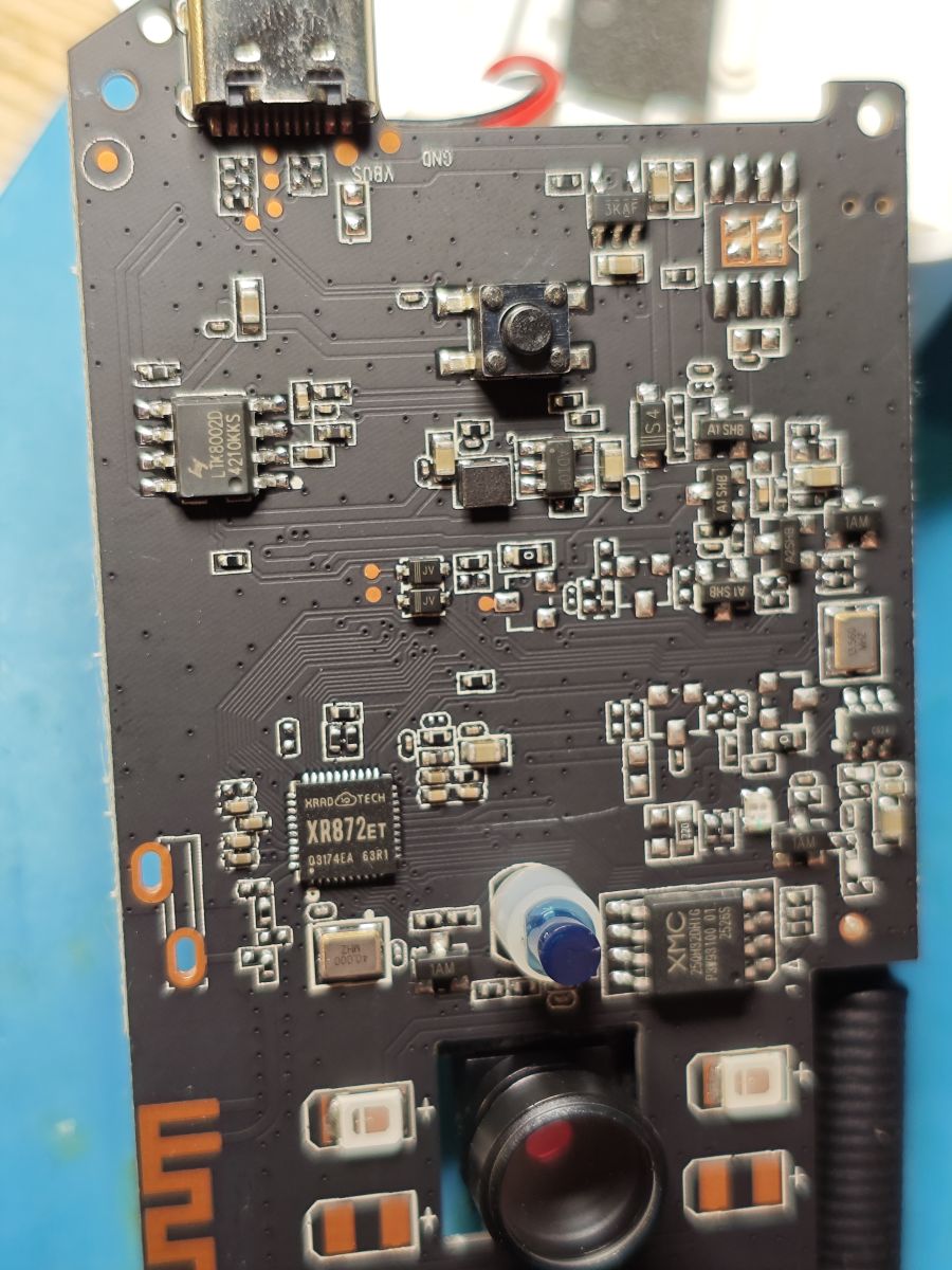

    I have one now too. White case, seems to be the Kement type @insmod bought.
    XR872ET variant.
    White box with illustrations and the label “MINI DOORBELL” on top. Video doorbell and receiver in an open box on a desk Label with QR code and markings on a white folded cardboard box Interior of an electronic device showing a 3.7V Li-Po battery and circuit board Electronic module with camera and ICs on black PCB with USB connector Close-up of a PCB with camera lens and XMC microcontroller PCB with electronic components and Wi-Fi module on a blue background PCB section labeled MINI01-ET_MAIN_V3.1 with date 2025-06-26 and connectors
    Camera module with lens on flexible ribbon cable on blue background

    with a little tweak to the bootloader on Kement XR872ET dump we can change
    HAL_Flash_SetDbgMask(0);
    this only then gives this log out though
    Added after 2 [hours] 47 [minutes]:
    silent no more!

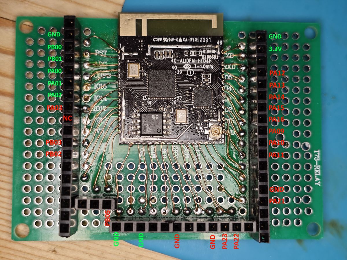

    I'll do your XR872AT Kement next then flash to that T-Mall module I have
  • XR872 doorbell boot log and Wi‑Fi startup details
    #10 21947234
    Posts: 5215
    Help: 448
    Rate: 917
    your XR872AT Kement:
    crash maybe because it's running on this monster and not your hardware
