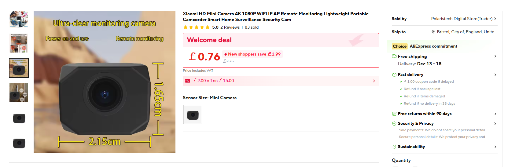

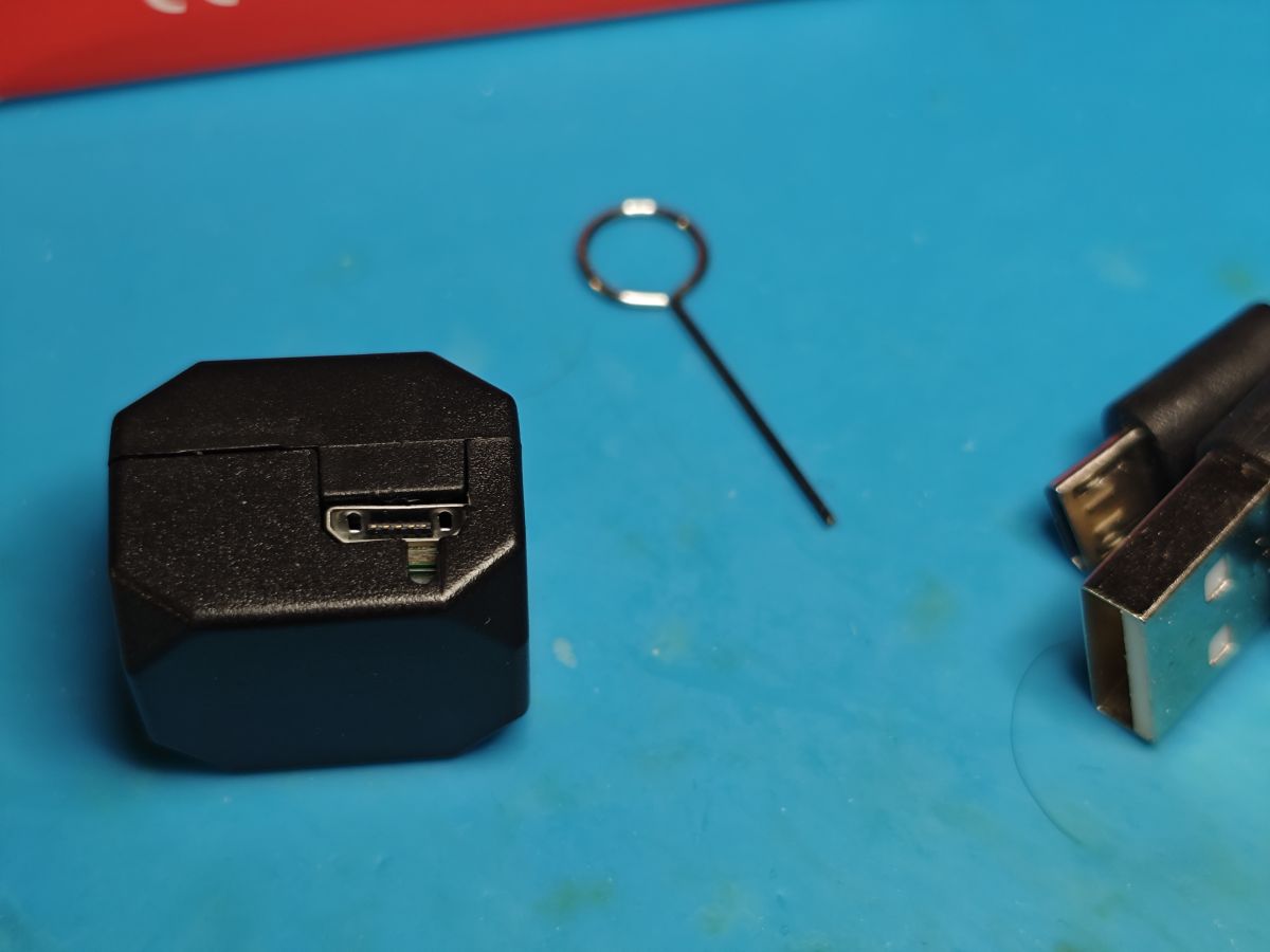

  • Hi, here's a peak at a tiny little Beken BK7252N 'Xiaomi' '4k' Rear View Car IP camera bought from Ali Express.
    Screenshot of HD mini camera product listing on AliExpress with device dimensions
    https://www.aliexpress.com/item/1005010353283701.html
    It's far from a full rear-view camera car kit, more like another cheap Chinese mini cam packaged with standard micro USB cable. No mounting options are supplied.

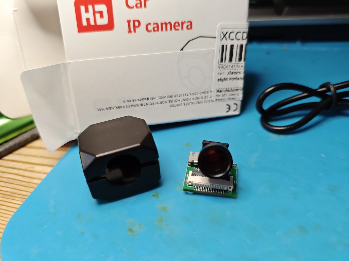

    White box labeled Car IP camera with barcode and XCCD marking Package corner with distributor name, address, and product barcode visible. Stickers with codes and product information on a white electronics box. Close-up of a label on a box reading 4K HD Mini Camera WIFI Close-up of barcode and product label for Xiaomi 4K HD Mini Camera on packaging corner. Close-up of product box label with number PA1413024 and barcode Label with code PA1413024 on a camera IP box with manufacturer details

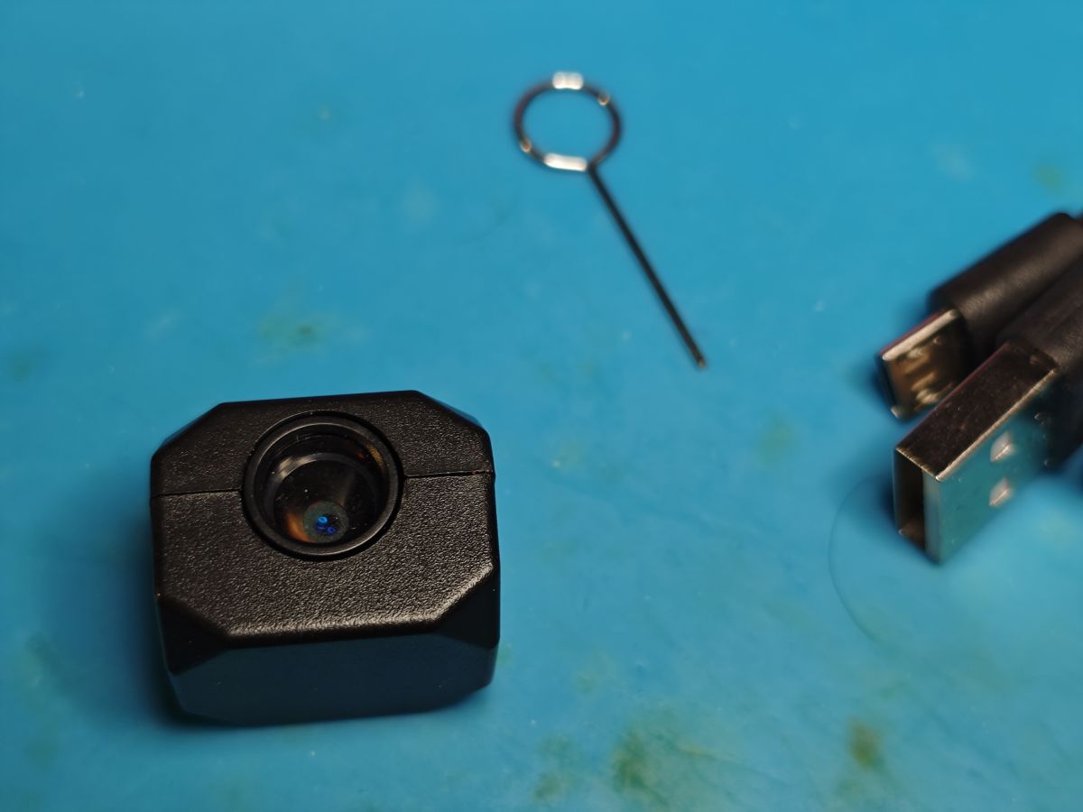

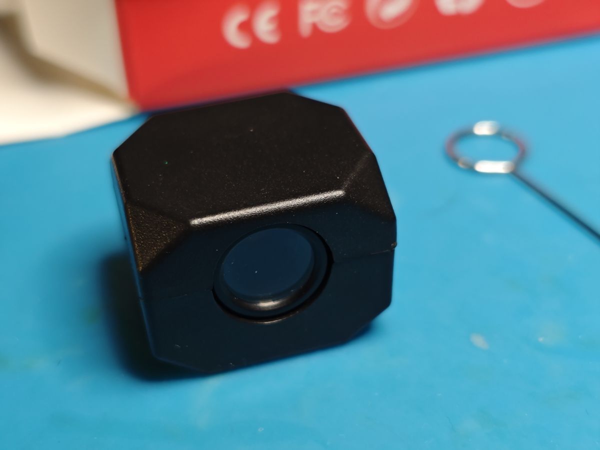

    Disassembled mini car camera with housing and box on a blue service mat. Black cube-shaped camera with lens on blue mat Small camera with black casing beside micro USB cable and SIM tray eject tool Small black camera with micro USB port, SIM-eject pin, and USB plug on blue surface

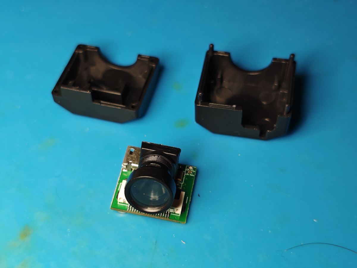

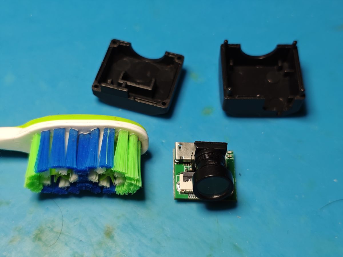

    The case is pried open very easily with only 4 plastic corner pips holding the two main parts together.
    Disassembled mini car camera with lens module and black casing on blue surface

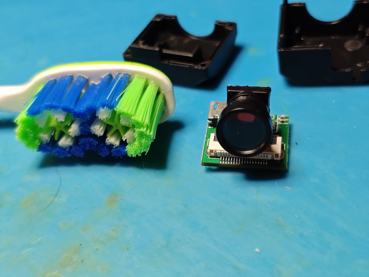

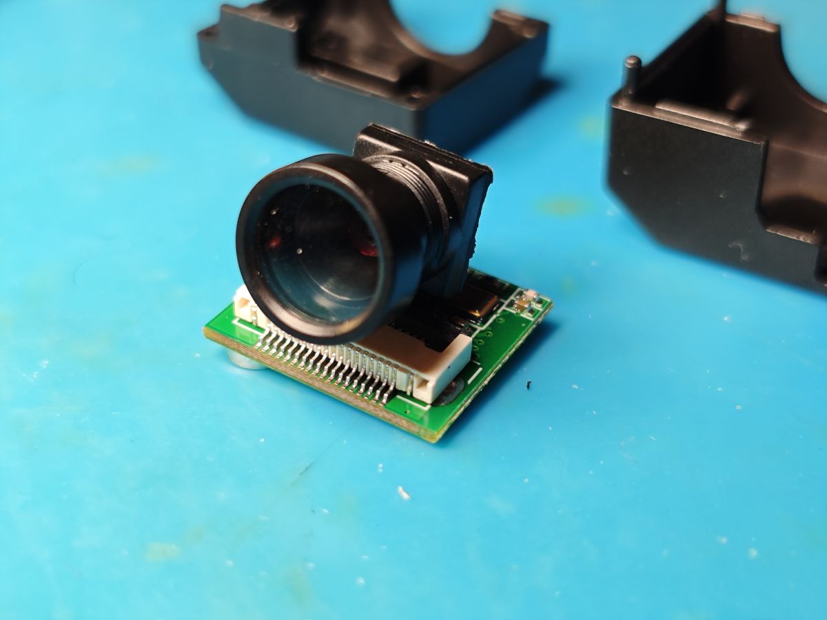

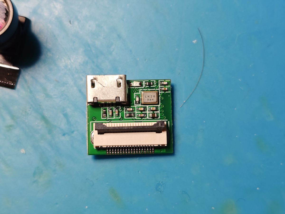

    then the insides. toothbrush for scale
    Camera module with large lens and exposed PCB on a blue background Camera module with lens next to a toothbrush for scale Disassembled mini camera with its casing and a toothbrush for scale PCB module with micro USB port and ribbon cable connector on blue surface. Electronic module with Beken BK7252NQN481 chip and microphone on green PCB Circuit board with Beken BK7252N chip and micro USB port in front of a toothbrush GC0311 camera module with lens on a blue background

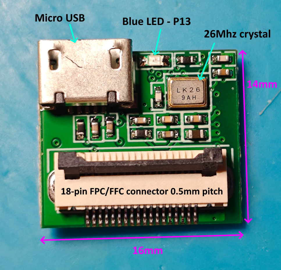

    To break it down a little, on this side we have the 5v micro USB port, a blue LED (connected to P13 of the BK7252N) a 26 MHz oscillator (LK26 9AH), and the now quite-familiar top-lock FPC/FFC, 18-pin, 0.5 mm pitch connector for the cam sensor.
    PCB of camera module with micro USB port, blue LED, and 18-pin FPC connector

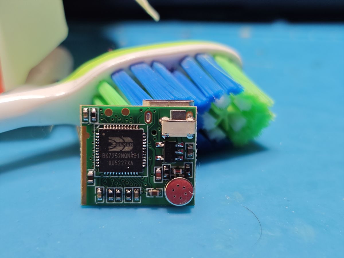

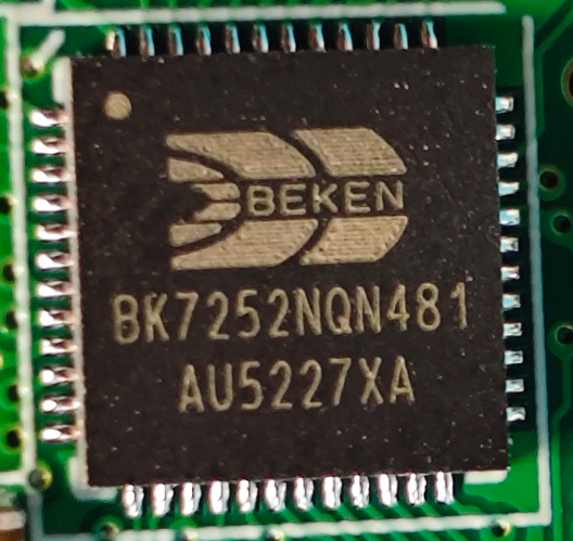

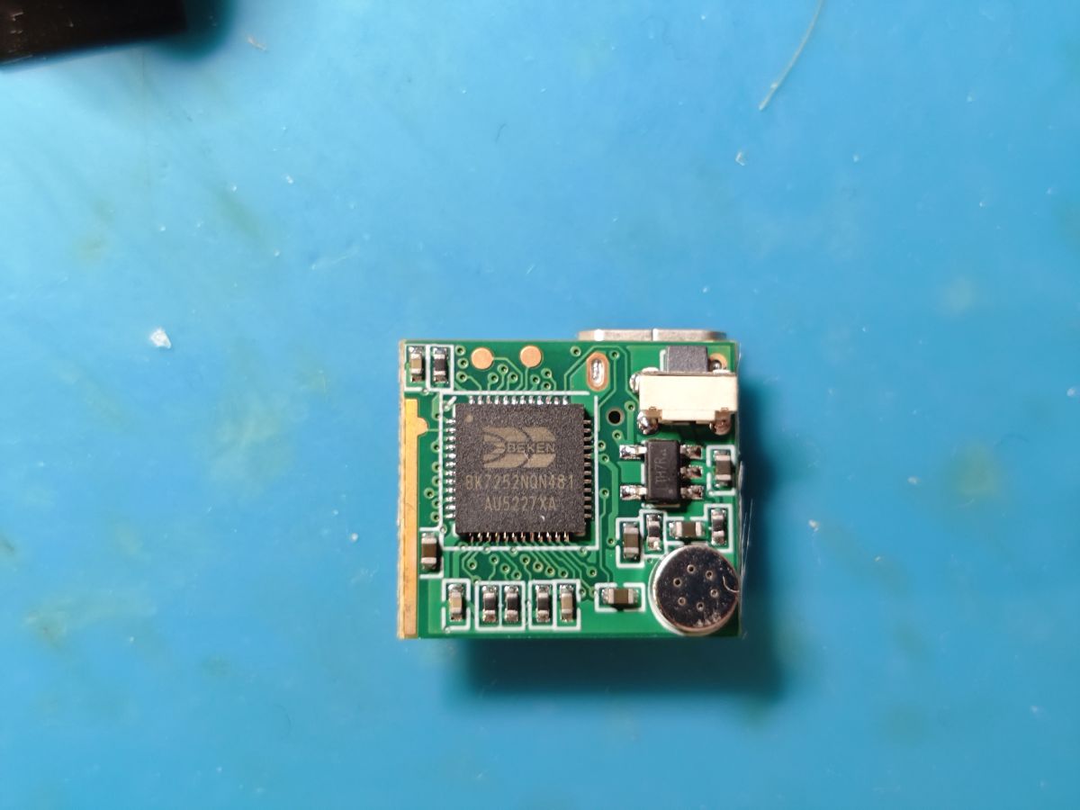

    on the other side, the 2mb Beken BK7252NQN481 MCU (also seen https://www.elektroda.com/rtvforum/topic4118499.html) (datasheet attached)
    Close-up of Beken BK7252NQN481 chip on a green PCB.

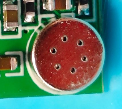

    an analogue electret microphone
    Close-up of electret microphone on a green PCB with blue background

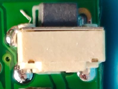

    a standard tactile push button (connected to P7 of the BK7252N)
    Close-up of a white tactile switch soldered to a green PCB

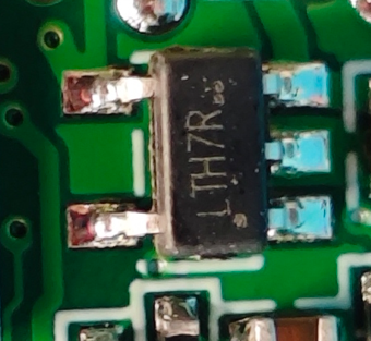

    LTH7R SOT-223-5 (?) 3.3v LDO - supplies 3.3v to the MCU from 5v USB input. Googling seems to suggest it's a Li-ion battery charger chip, but this device was not supplied with battery.
    Close-up of LTH7R chip on a green PCB

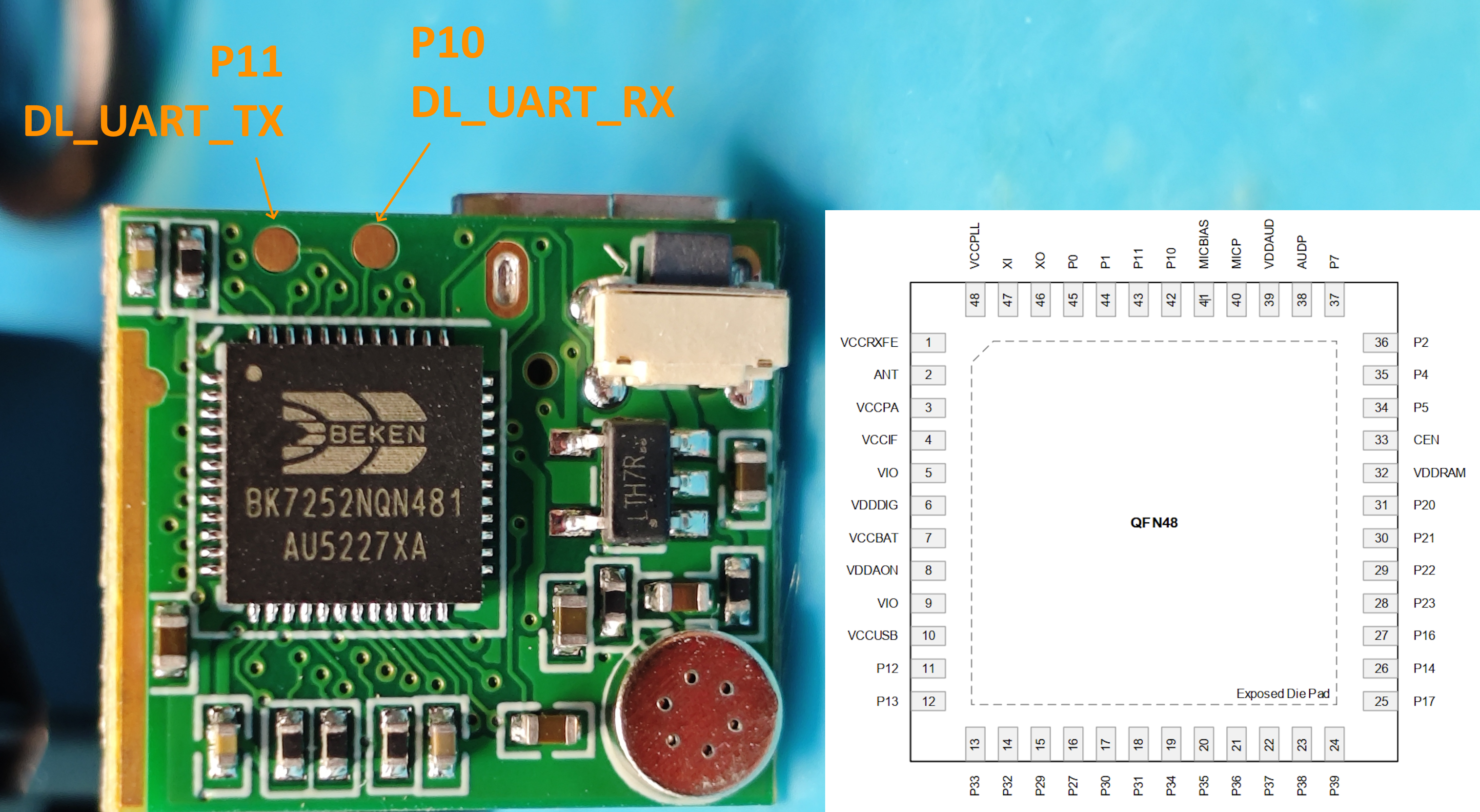

    The only test pads on the PCB are P10 and P11, which are good for programming
    Module with BK7252NQN481 chip and labeled P10 and P11 pads on PCB
    From P11 we also get this log out at 115200 baud
    no log from P0 (UART1_TX)

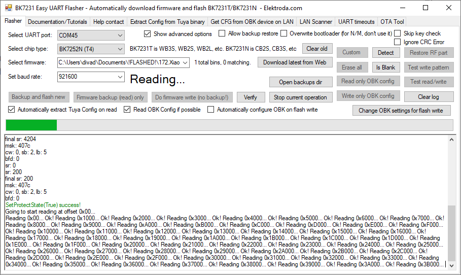

    With Easy Flasher the BK7252N 2mb flash is read with ease.
    BK7231 Easy UART Flasher interface reading BK7252N flash memory

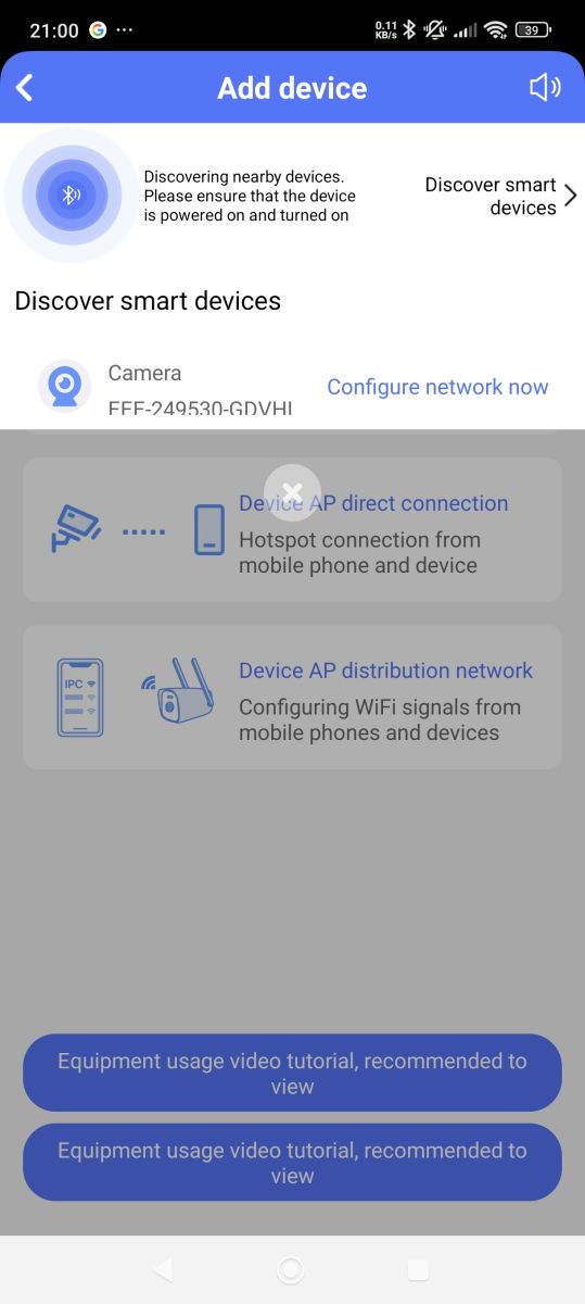

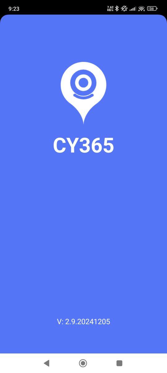

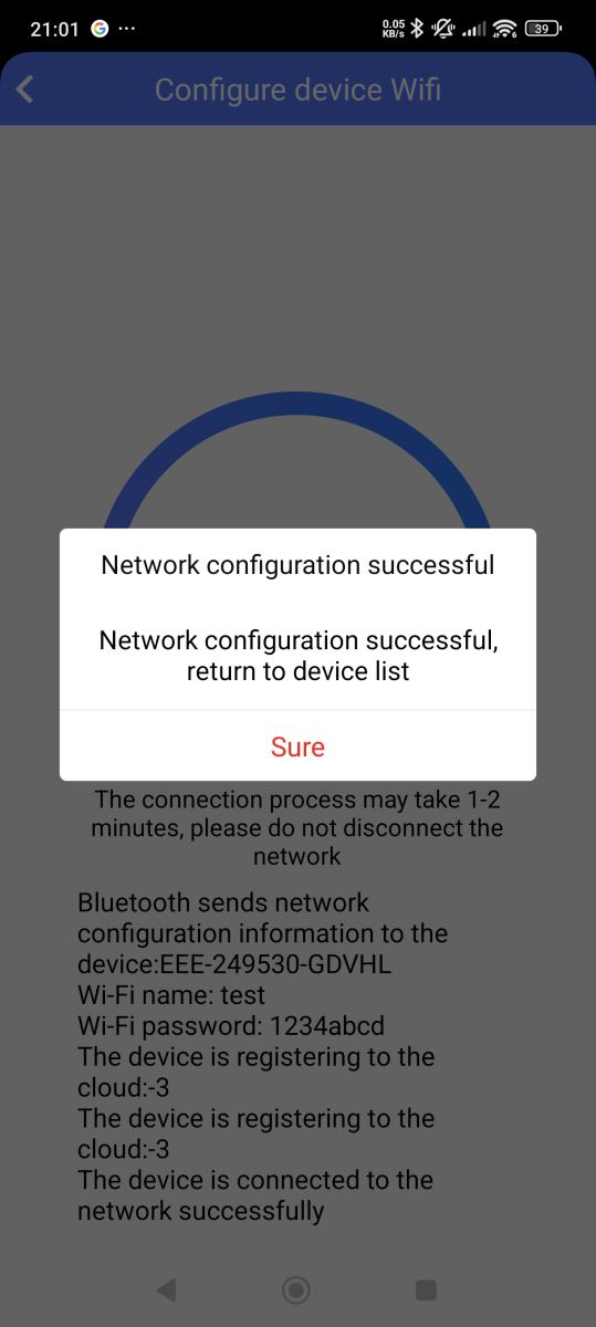

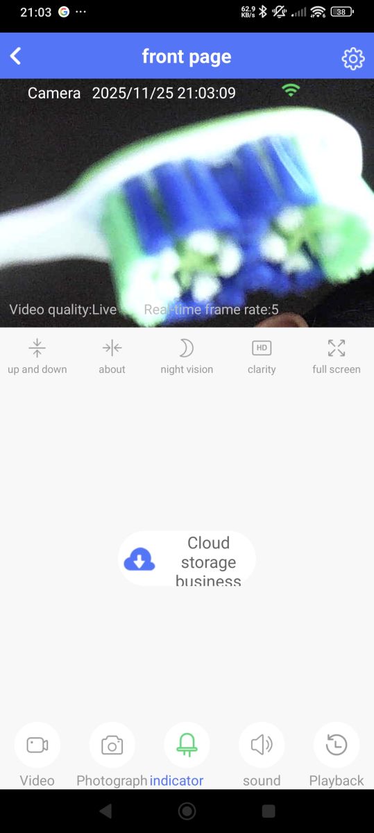

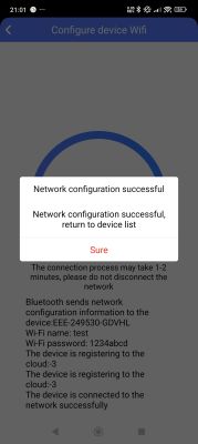

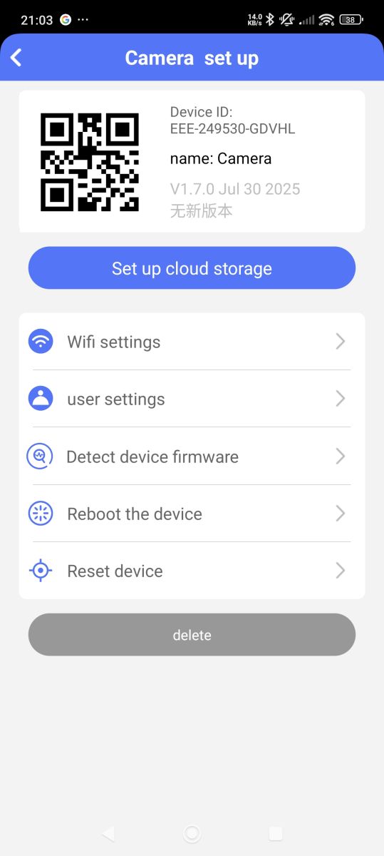

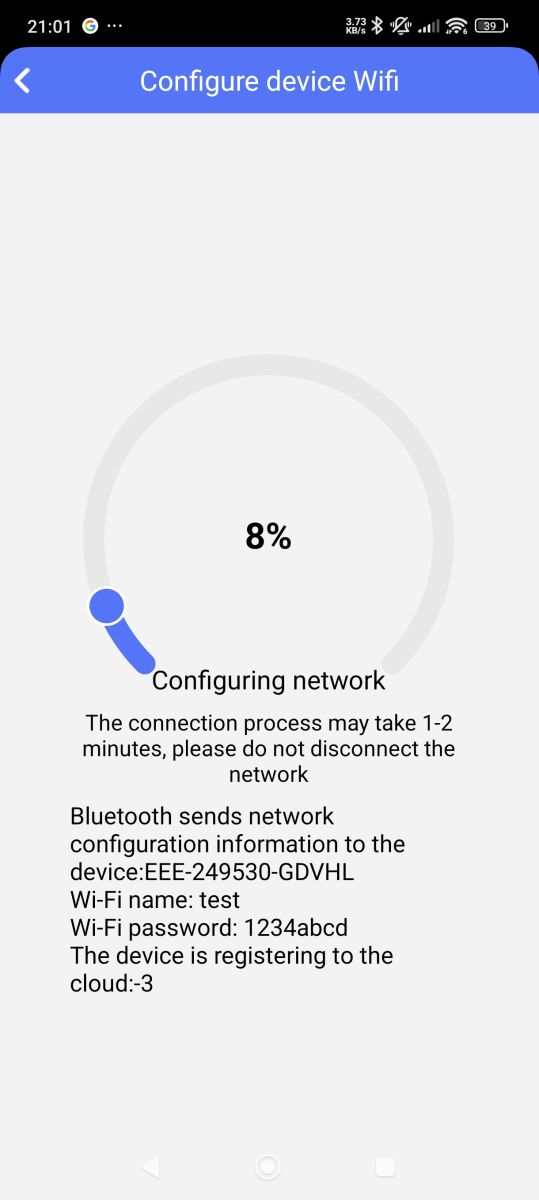

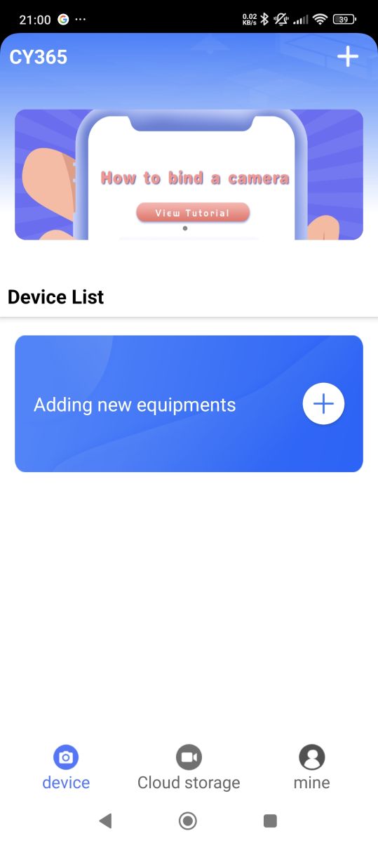

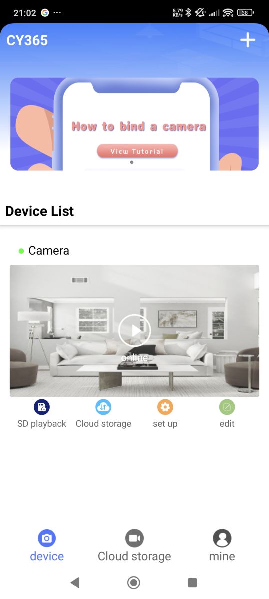

    Regarding the CY365 app (Shix Zhao shix.cy.camera) referenced in the 'manual' to be used when pairing device with phone
    Instruction leaflet for CY365 camera setup with QR code and English text Instruction leaflet for IP camera setup using a mobile app and WiFi connection
    CY365 app splash screen showing white camera icon on blue background CY365 app screenshot showing device pairing and bottom menu options App screen for adding a device, camera with ID FFF-249530-GDVHI is detected Wi-Fi setup screen showing 8% progress and network details for camera device Device Wi-Fi setup screen showing success message and connection details CY365 app screen showing active camera preview and feature menu. Close-up of a toothbrush captured by a surveillance camera. Camera setup screen with QR code and network configuration options

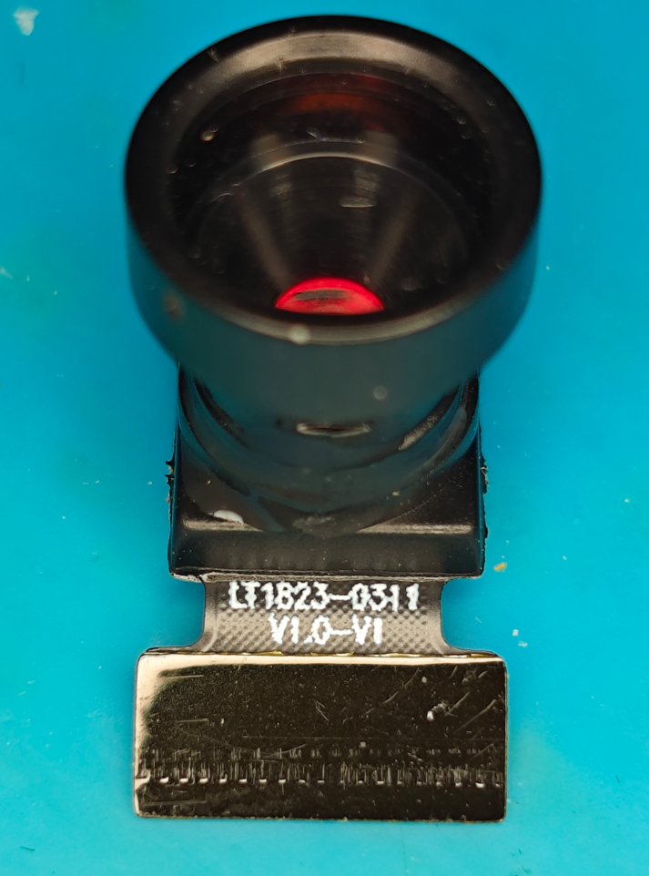

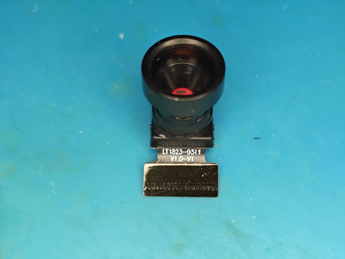

    The sensor itself, labelled as LT1823-0311 V1.0-V1, is a GalaxyCore GC0311 640x480 model.
    Camera module with lens and ribbon connector on blue background

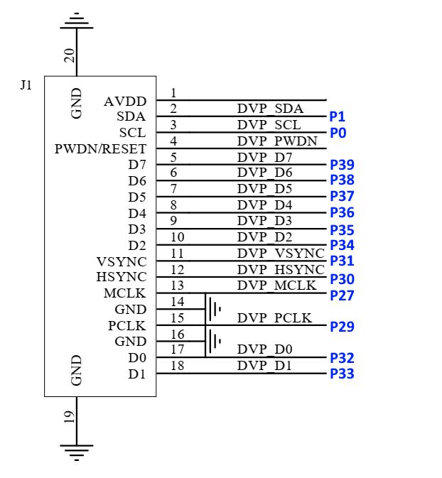

    And tracing from each of the pins on the 18-pin FPC connector we determine the following:
    DVP interface connection diagram with pin mapping for connector J1

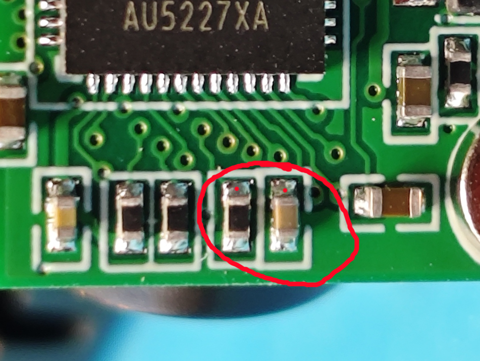

    So P0 is used for SCL. I'm not sure of the role of PWDN/RESET at this stage, but it doesn't directly route to an IO on the BK7252N but rather has continuity to the top contact of these two components on the reverse

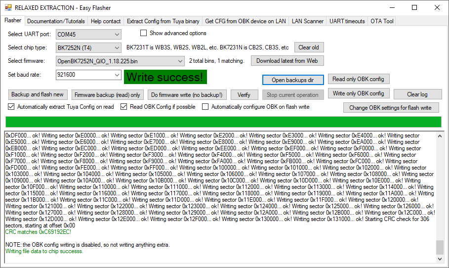

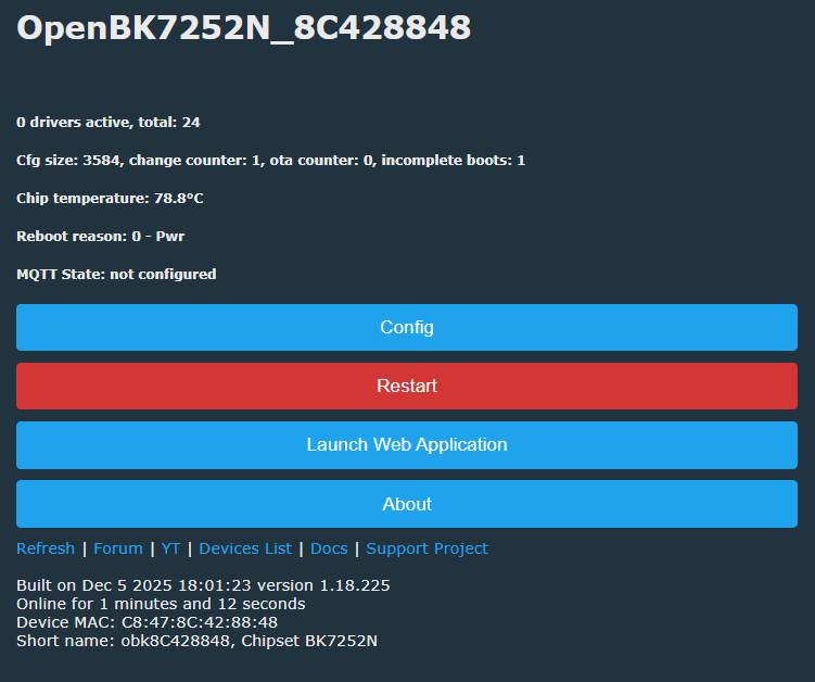

    Flashing OpenBK7252N means a cloud-free device, but currently no cam or mic support
    Easy Flasher interface with Write success! message and flash writing log
    OpenBK7252N interface with chip data and configuration options displayed

    Device ID:
    EEE-249530-GDVHL
    V1.7.0 Jul 30 2025
    No new versions
