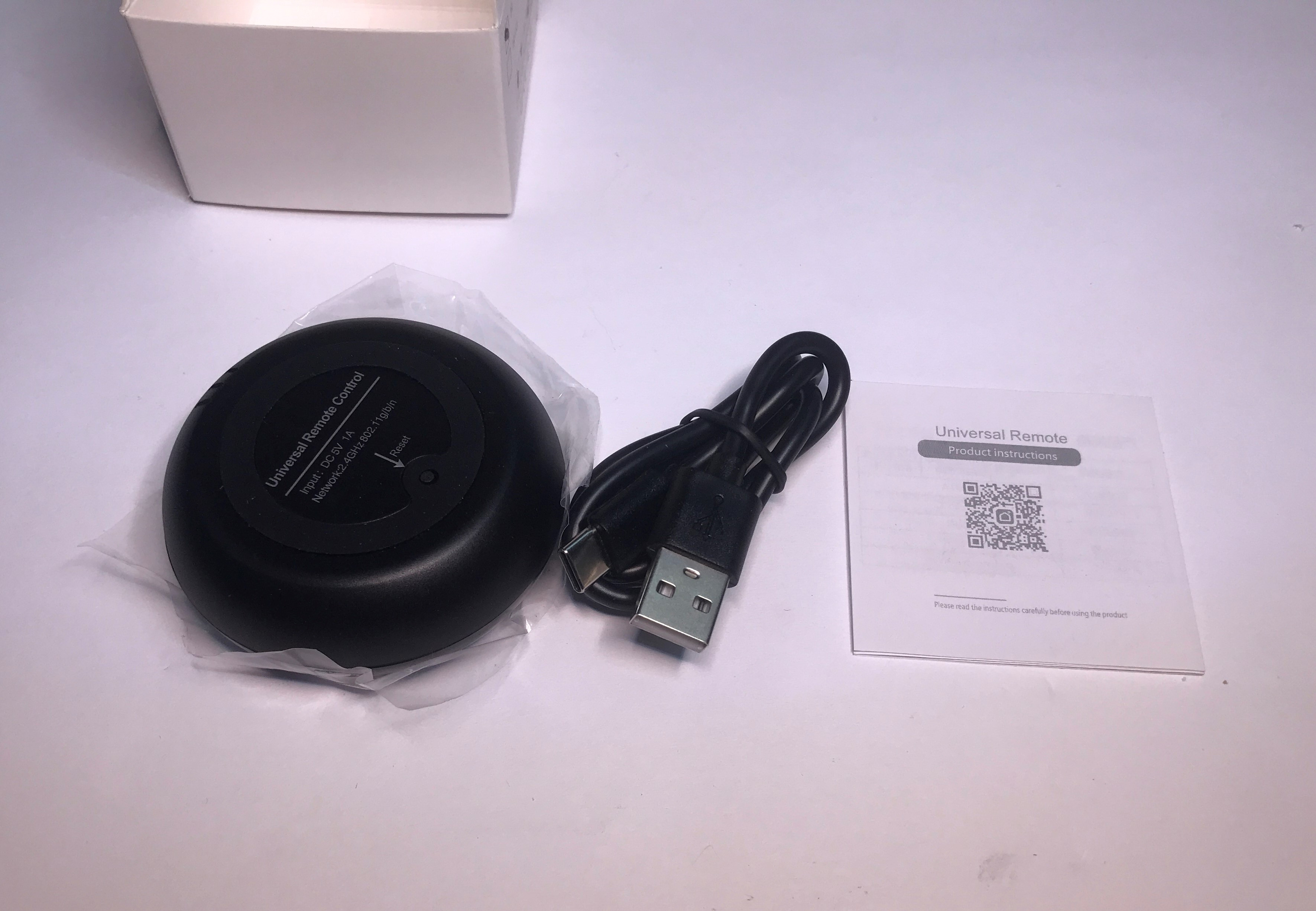

Black IR remote shell, USB cable, and instruction sheet on white surface
I would like to invite you to a demonstration of the interior and software changes of the Tuya universal IR remote control. The device shown here is capable of receiving and transmitting infrared signals in various remote control standards such as RC5, RC6, NEC, etc. The whole thing is controlled from Wi-Fi, so various complex mechanisms and automations can be created, and even potentially paired with Home Assistant.
I will skip the tests with the Tuya app in this topic, as this has been presented before.
White box labeled Universal remote control with Tuya logo on top Box of ATLO-RC-IR-TUYA device with label and barcode visible Top of the device box with IR option marked in black
The adventure begins with the purchase of the hardware - in our country for around PLN30, probably cheaper in China. The kit also includes a USB cable, but this won't be of much use to us as it doesn't have a data line.
Tuya IR universal remote with USB cable and instructions on white background
