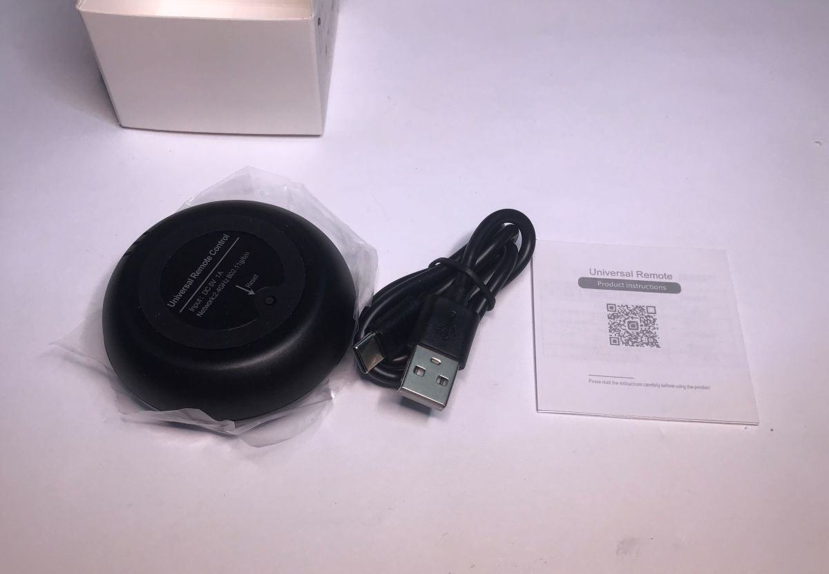

    The adventure begins with the purchase of the hardware - in our country for around PLN30, probably cheaper in China. The kit also includes a USB cable, but this won't be of much use to us as it doesn't have a data line.

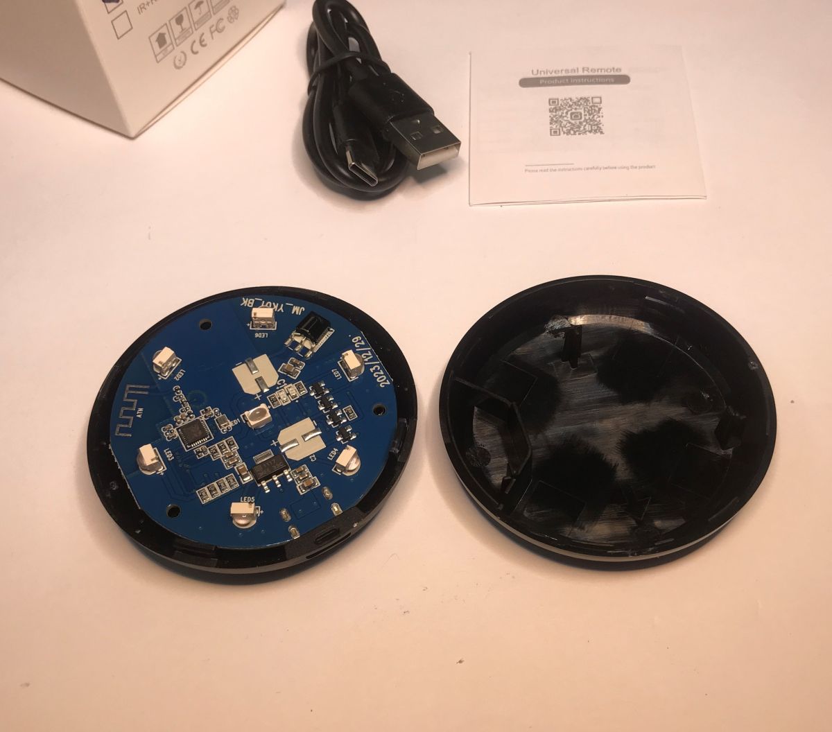

    Let's take a look inside:
    Disassembled Tuya IR universal remote with visible PCB and casing

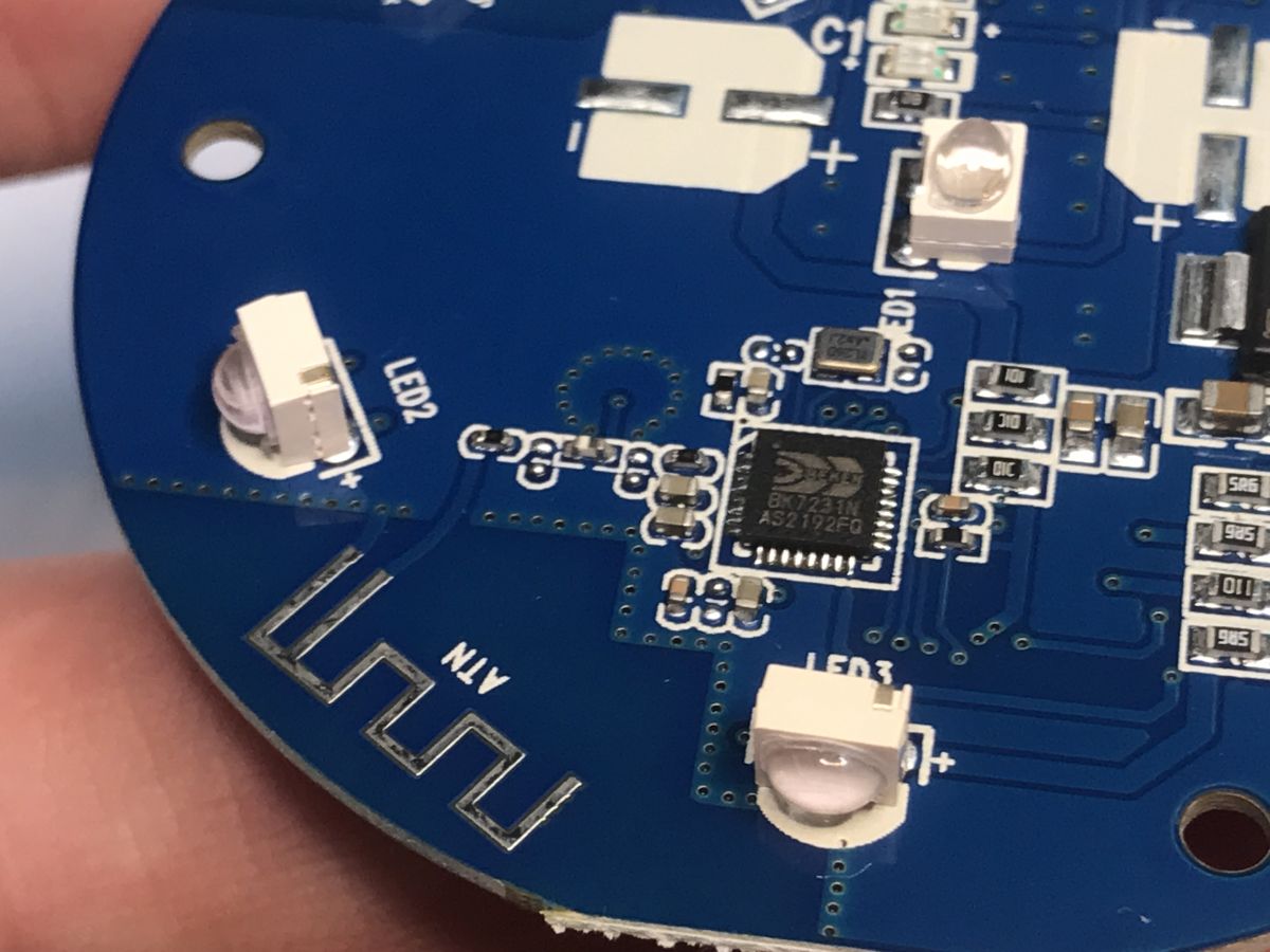

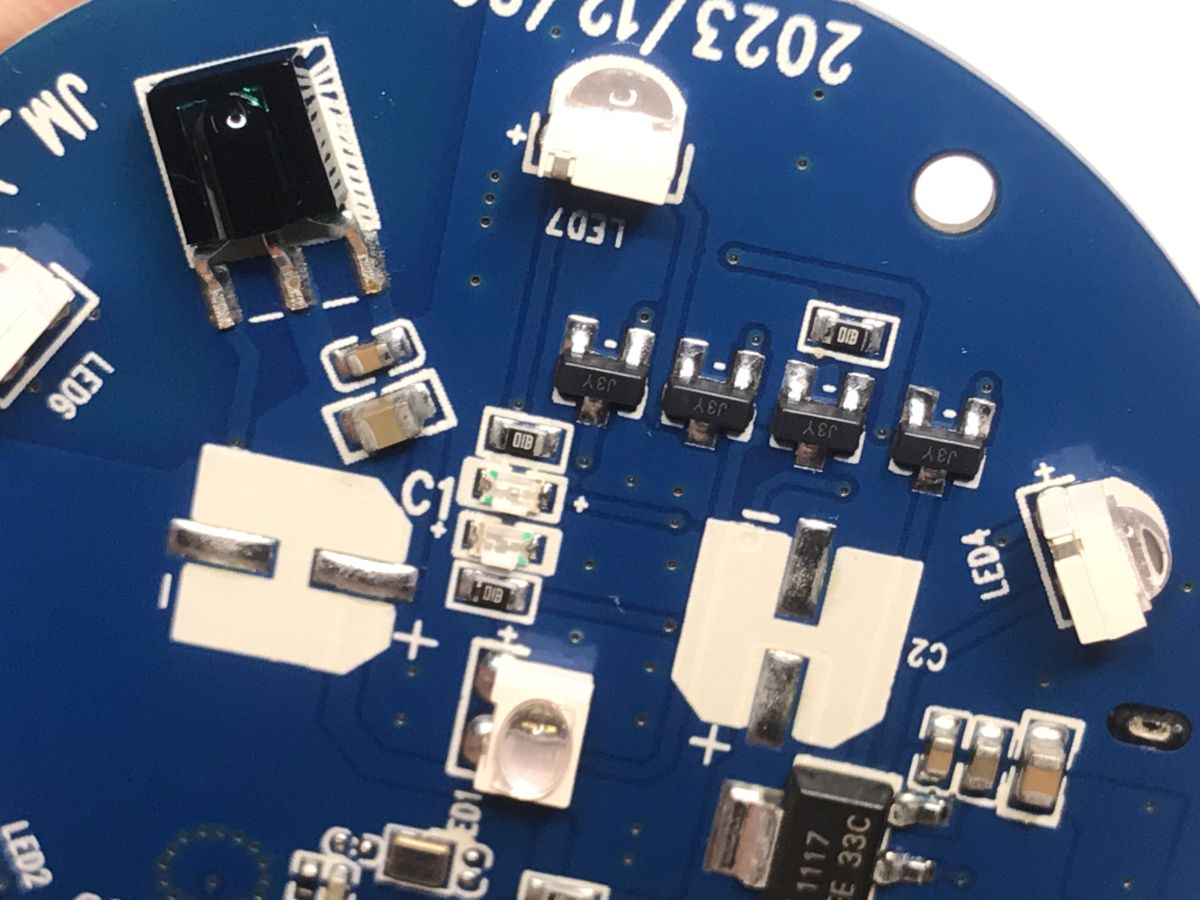

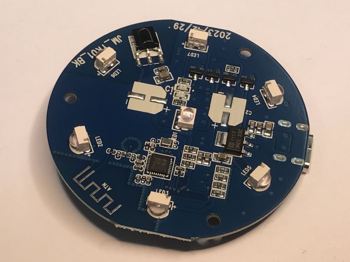

    The construction of this device is very simple. The whole thing is powered by 5V from USB, so no converters are needed. An LDO AMS1117-3.3V regulator is sufficient, which powers the BK7231N located directly on the PCB. There are also separate IR LEDs on the PCB from the transmitter, pointing in different directions, and a single IR receiver.
    Round PCB with BK7231N chip, IR LEDs, and Wi-Fi antenna trace visible.
    Due to the low performance of the microcontroller GPIO, transistors were used here to control the transmitters:
    Close-up of PCB with IR components, transistors, and status LEDs.
    The Wi-Fi antenna is also in track form on the PCB:
    Close-up of PCB with BK7231N chip, IR LEDs, and PCB Wi-Fi antenna

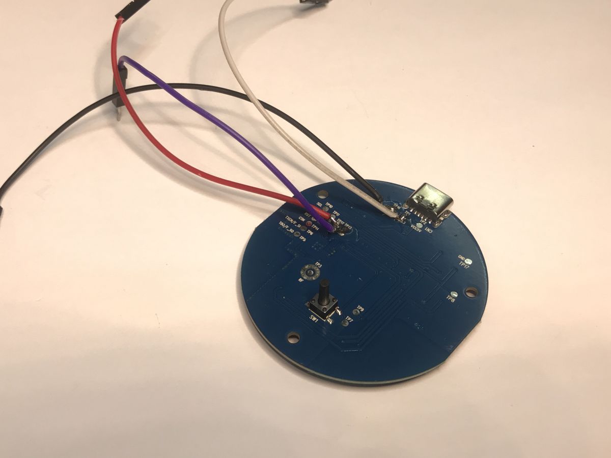

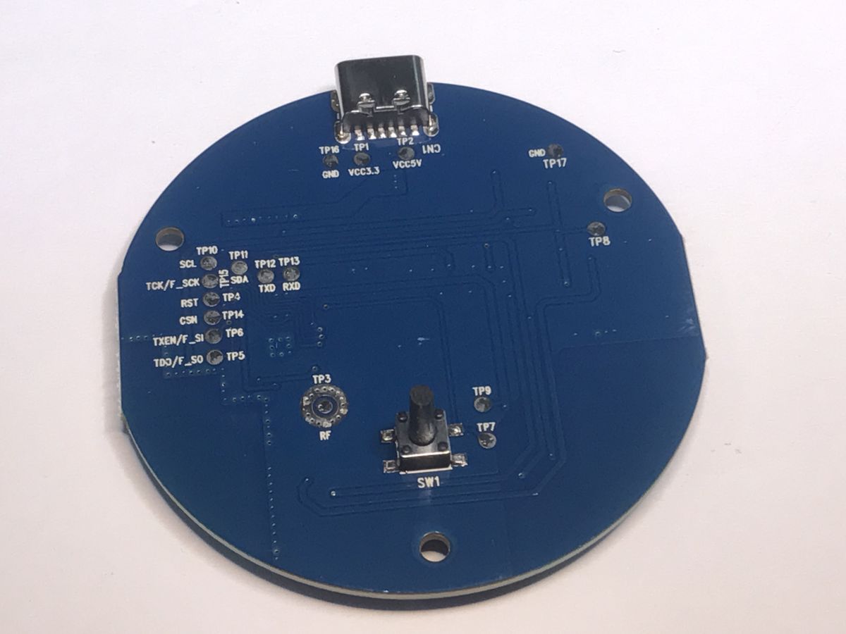

    On the bottom of the PCB there are pads for programming. The signals from UART and SPI can be distinguished here.
    Bottom of a blue circular PCB with a button and labeled programming pins
    We program the device with our flasher, following the instructions from the repository:

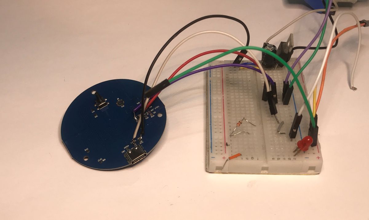

    We need a USB to UART converter. We solder the power supply, RX1 and TX1.
    Round PCB with connected wires and a micro USB port for IR Tuya device
    This also needs to be well powered. In the picture I have used an external LDO for this, although here you could just as well solder 5V to the input of the LDO found on the board. It's important that the BK7231 gets 3.3V at VDD, not a higher voltage. It can easily be damaged.

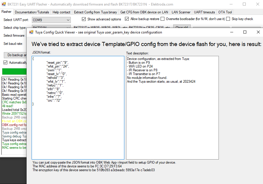

    Flasher correctly detects GPIO configuration:
    GPIO configuration window extracted from Tuya device memory in flasher software
    JSON Tuya:
    You can read from here:
    - wfst_pin - pin with status LED on it
    - reset_pin - pin with pairing button
    - infrr - pin with IR receiver
    - infre - pin with IR transmitter
    Description from the converter:
    - WiFi LED on P24
    - IR Receiver on P8
    - IR Sender on P7
    - Pair/Reset All Pin on P9

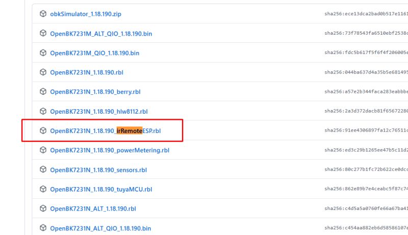

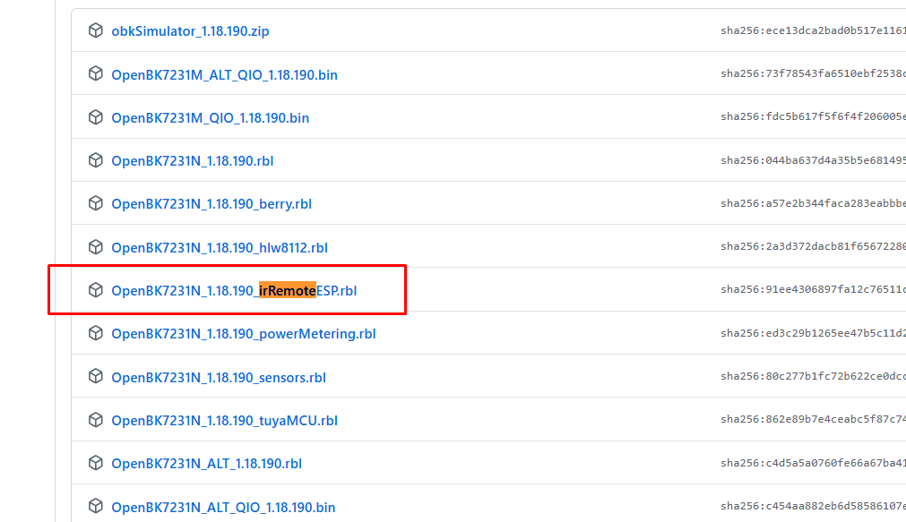

    Note that there are two versions of the OBK available - the main one is the Arduino-IRRemote integration and the other is the IRRemoteESP8266. The IRRemoteESP8266 version supports additional protocols and can be downloaded here:
    Firmware file “OpenBK7231N_1.18.190_irRemoteESP.rbl” highlighted in red box
    OpenBeken is thoughtfully designed to support a wide range of use cases and anyone can select a version that suits them. If desired, you can also compile a custom configuration online - without having to install the compiler on your computer ( tutorial ).
    https://github.com/openshwprojects/OpenBK7231T_App/releases/

    Is there any reason why you are connecting an external power supply instead of powering this via the USB plug? Then you only need to solder 3 wires - GND, Tx and Rx.
  • USB-powered BK7231 flashing with GND, Tx and Rx only
    #3 21793413
    Posts: 14771
    Rate: 12914
    In this particular case, I think you could simplify and power this from USB, while soldering only GND, Tx and Rx. Then you could do the "power off"/"power on" cycle required by the flasher by disconnecting the USB cable. This is required when programming the BK7231, their bootloader does not have a BOOT pin like the ESP, it just works in such a way that it waits for a packet for a short moment after a reboot/reset. This is called "getting bus"
    I simply want to show good practice so that someone does not later connect a device powered from 230 V and still with a non-isolated inverter on a BP2525 to a computer
    Well, and I also have a limited number of USB ports and it's quicker for me to make four solders rather than three+connect the cable....
    What you say is more likely to work for USB powered devices, and will work for LED controllers powered from, say, a 12V typical power supply. Similarly, if you have a mains-powered device, then although you can't power it from the mains when it's connected to a computer , you can plug in from 5V to the AMS1117-3.3V input as it's available on the PCB, and not use an external LDO.
    On the other hand, it won't work to power the Wi-Fi module from a low-radio 3.3V source - as some USB to UART converters have a 3.3V pin, then you'll run out of current and there could be a problem.
    Generally these BK7231 are a bit problematic to program, I already had various interesting situations. For example this:
    Microcontroller works without power connection? We are running on GND and UART alone, a conundrum.
