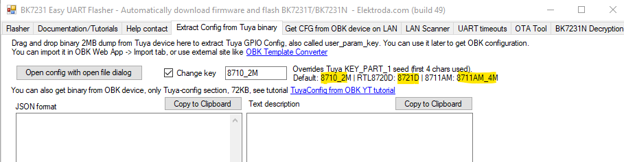

I've been trying to figure out why we cannot decrypt the key vault on some Tuya flash backups and why this seems to be the case for certain, typically older, platforms. BK7252U, TR6260, W800 to name a few.
The decryption method for BK7231N/T (and some RTLs) is known, though the Tuya 'seed' KEY_PART_1 has been known to deviate away from 8720_2M (effectively '8720') depending on the platform.
eg
Screenshot of BK7231 Easy UART Flasher showing Tuya config extraction tab
In an effort to find the assumed unknown, but present, seed key I spent quite a bit of time in LLM discussions, poring over various SDKs, programmatically trying different plain-text strings from dumps, PowerShell-generated key combinations numbering into the millions, breaking down libs with various csky tools (W800 dump).
What turned out to be different is that this “vault KV” path is not KEY_PART_1-seed driven at all.
Instead of the BK7231N/T-style config extractor model (where a platform “seed” influences the key used to decrypt a specific config blob), this vault mechanism is device-key centred and two-stage:

Very interesting finding, how did you find that out? I think it's worth to add this to the flasher. However... that missing key issue we was searching for in Ghidra is still not yet solved? [Read more]
divadiow 14 Jan 2026 20:38
basically hours of trying stuff with LLM. So many angles explored, but ultimately feeding it the Tuya LN882X SDKs from the Lightning Semi FTP seemed to contain the answer. Expert handling of the LLM also... [Read more]
