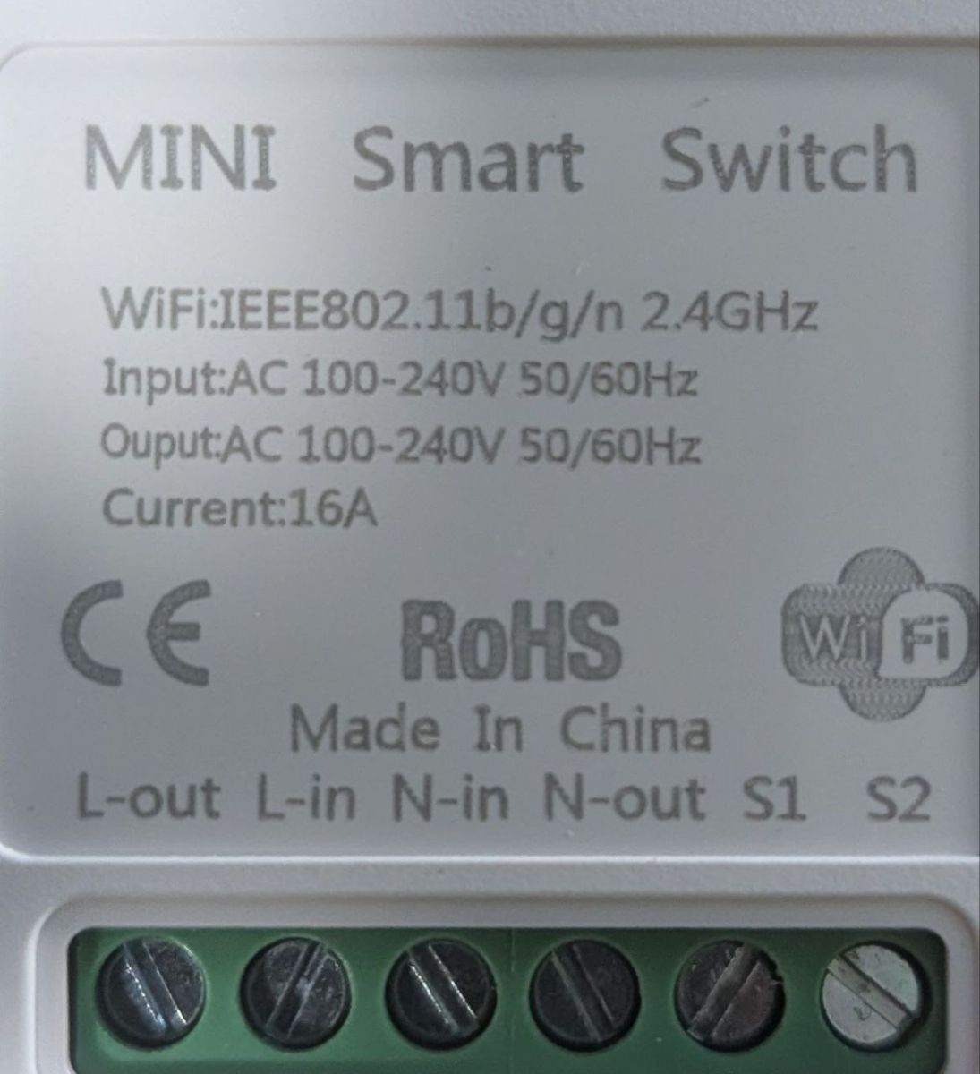

    00svd00
    Posts: 26
    divadiow wrote:
    are you expecting device to have power monitoring too?
    I don't think so. No other chips on PCB, and also no other pins were soldered, only ADC, P8, P9, P24, 3V3, GND, RX1 and TX1
    divadiow wrote:
    where was it bought?
    From my country's local marketplace.
    divadiow wrote:
    also, what does the device look like?
    Mostly like normal Tuya smart mini. Only difference - different contact order
    Mini Smart Switch module with labeled terminals and technical specifications on the casing.

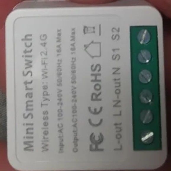

  • #9 21650893
    groove6j
    Posts: 52
    Rate: 13
    Similar device, same BK7238. Connect 3V and GND to 1117 pins. Tx1 and Rx1 pins 29 and 30 are already laid out. No initials on board at all.
    Different pinout.
    "pins": {
    "6": "WifiLED_n;0",
    "8": "Rel;1",
    "9": "TglChanOnTgl;1",
    "26": "Btn;1"
    Close-up of a MINI Smart Switch label with technical specs and screw terminal connectors.

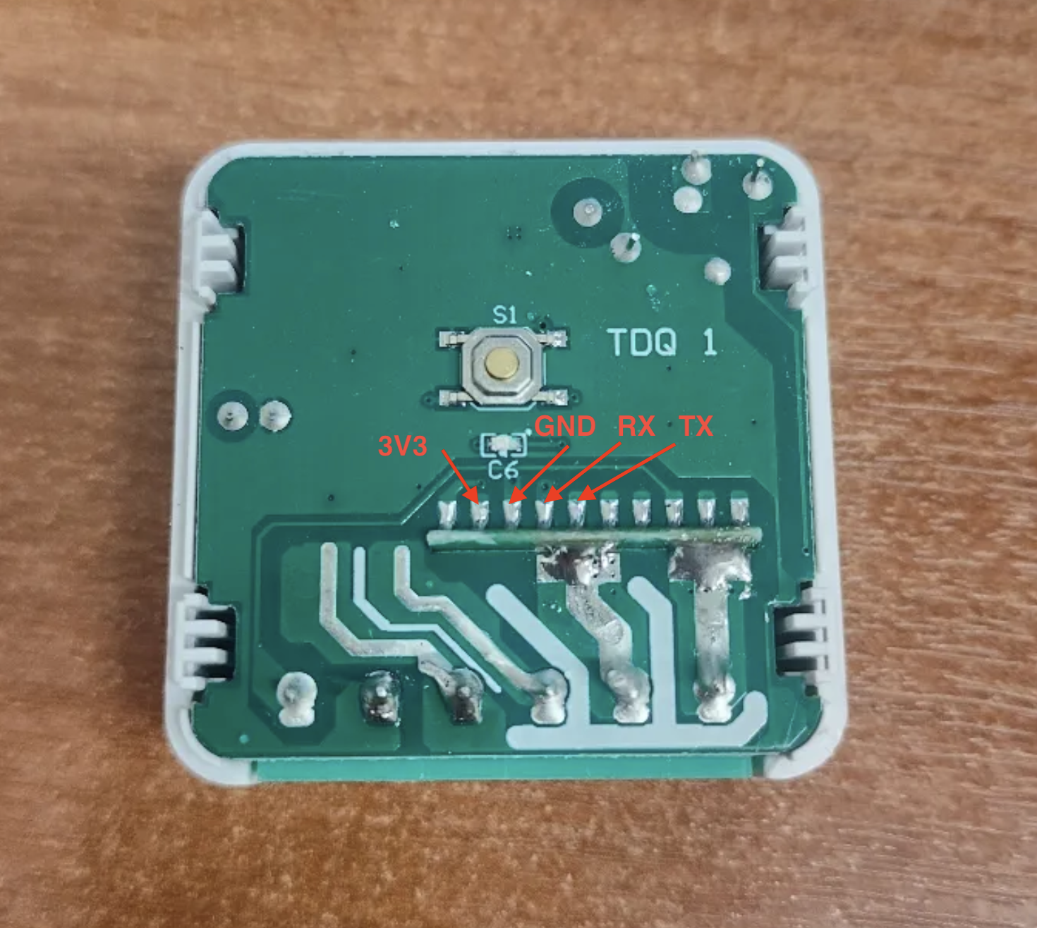

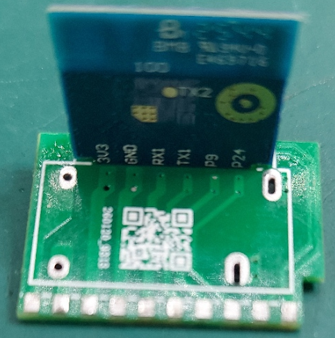

    #14 21696124
    bovops
    Similar device with T1-2S-NL and BL0942 energy meter.
    "pins": {
    "1": "WifiLED;0",
    "8": "Rel;1",
    "9": "Btn_Tgl_All;0",
    "24": "dInput_n;2"
    Energy meter starts work after loading the driver (startDriver BL0942)
    Electronic module with button and labeled UART pins: 3V3, GND, RX, TX

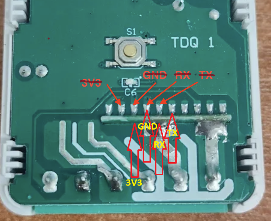

  • #18 21918129
    AlexTransit
    >>21696124 Error in pin description. Offset by 1 pin. :)
    Close-up of a green PCB with a QR code and an inserted FPC ribbon labeled with pin markings
    PCB close-up with S1 button and labeled 3V3, GND, RX, TX pins marked by red arrows
