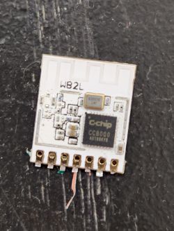

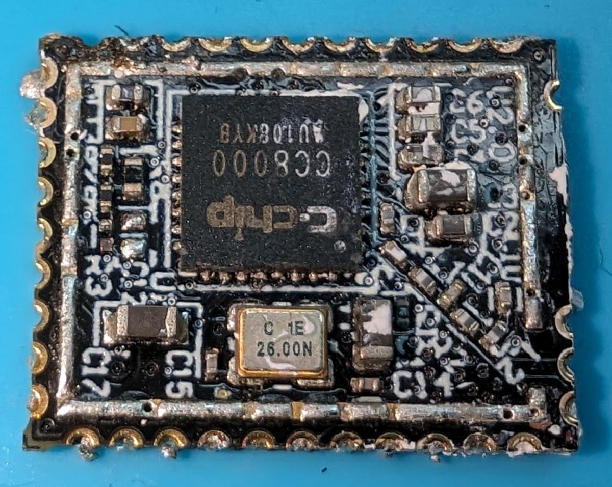

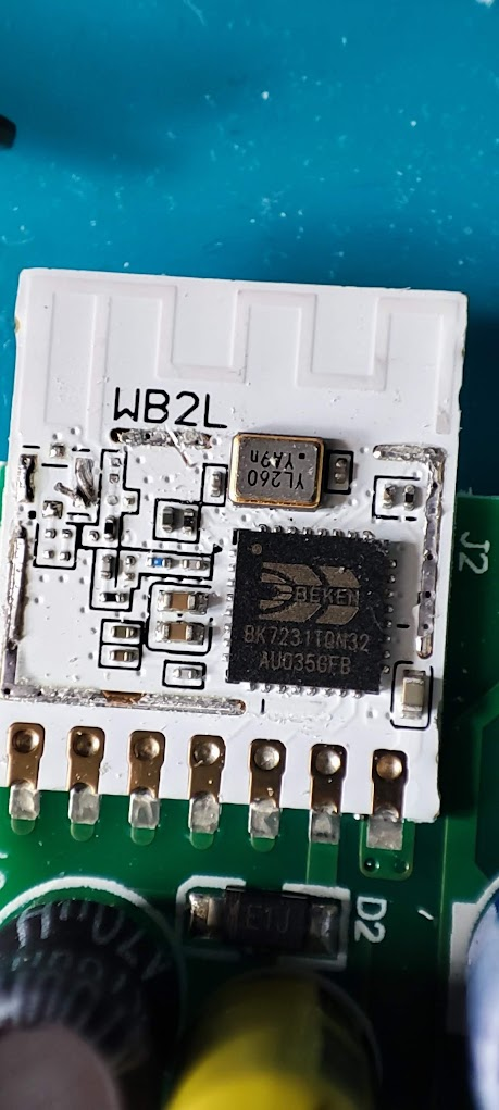

    A few months ago I had AVATTO Bulb that came with WB2L module .
    Under the metal shield I found C-chip CC8000 instead of BK7231T
    I don’t know if it's the same chip under a different name or Tuya was trying other chips than Beken

    @Zain00
    Well that’s something new
    That’s not even a beken chip, i’ve bought one before with the exact same chip (CC8000) and i ended just selling that one.
    The pinout was odd so I wasn’t sure if i could just swap it with esp

    Rate: 12611
    WB2L with CC8000? Can you try doing a flash read of that? Or at least try to get UART log?

  • #14 20456877
    Zain00
    Posts: 61
    Rate: 20
    This picture was taken 5 months ago.
    Sadly, I can't find the module

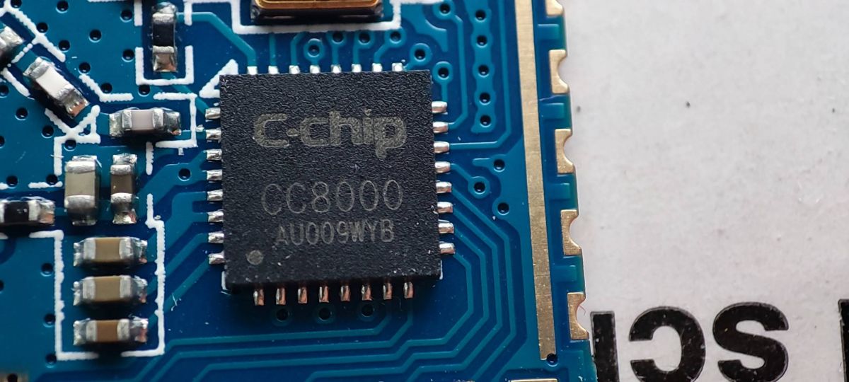

    Yea, same here... I once ordered BK7231U dev board from aliexpress and also got CC8000. I am not sure if I tested it more... I must find my module and test.
    https://www.elektroda.pl/rtvforum/find.php?q=CC8000
    https://www.elektroda.com/rtvforum/find.php?q=CC8000

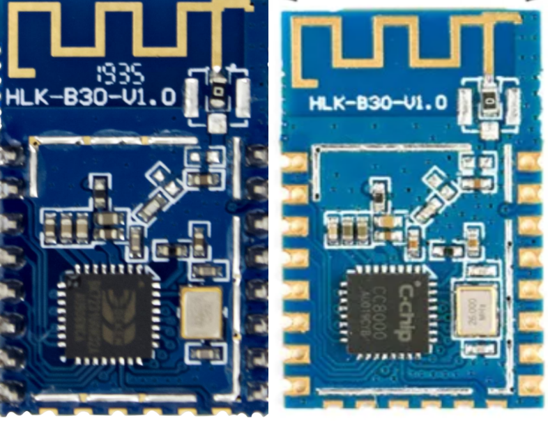

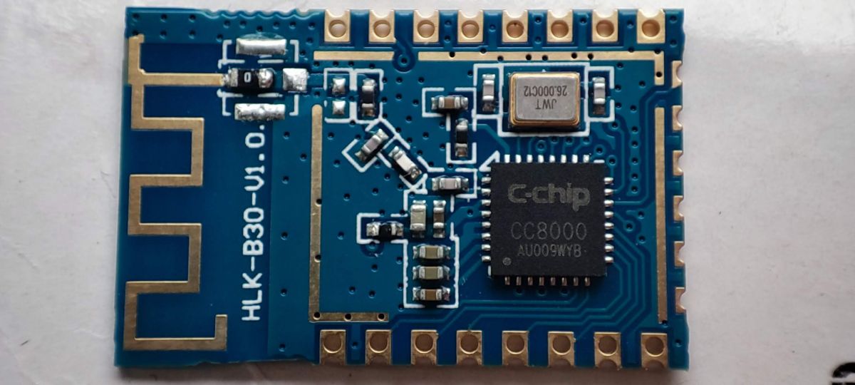

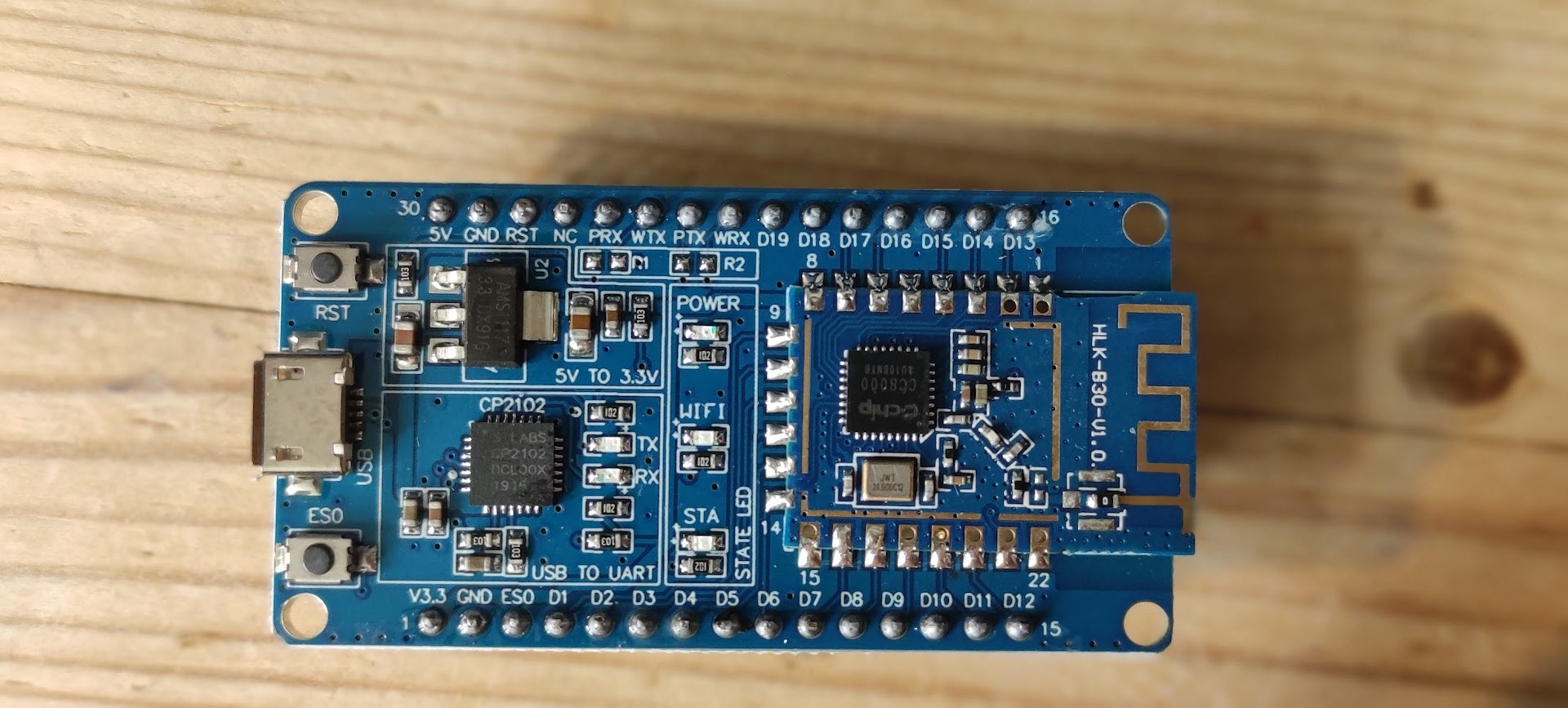

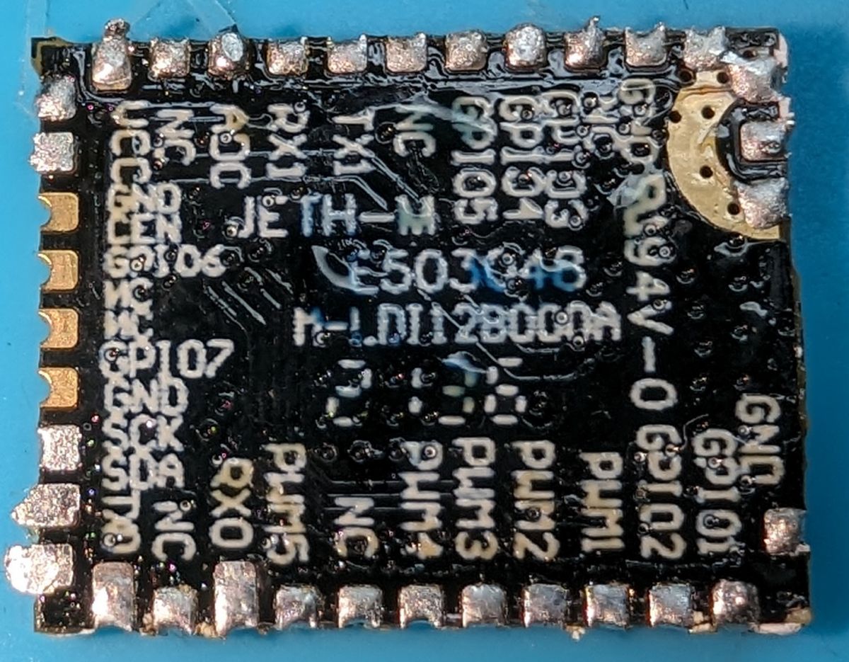

    Hello, I ran into a modul with CC8000, it is in a modul made by Leedarson based on the MAC address. On their website I was only able to find the ESP8266 version which has the same form factor and pinout then my CC8000 module.
    Here are some pictures of my modul:
    Close-up of a CC8000 electronic module on a blue background.
    Close-up of a CC8000 module with visible components on a circuit board.
    I checked the serial ports and it seems to be pin compatible with BK7231. This is also confirmed by looking at pictures of HLK-B30 modules with Beken and CC chips. The PCBs are identical, thus I assume the pinout is identical too:
    Two electronic modules HLK-B30-V1.0, the left one with chip 1935, the right one with chip CC8000.
    Can it be that the programing is the same? What is the best way to test it?
    Thanks

    It is Beken but it most likely has different encryption keys. I've been researching it some time ago. Maybe bootloader is different. Make sure to get full flash backup first.

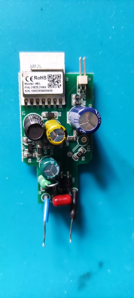

    Ooh. I have a WB2L device I haven't explored yet. Maybe there's a CC8000 under the shield
    WB2L module on a circuit board with visible capacitors and other electronic components.
    Added after 7 [minutes]:
    oh boring
    WB2L electronic module with visible components and connectors.

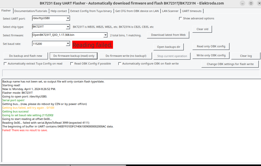

    I connected the CE to VCC and the device started to boot. However the boot on UART0 is boring. This is the only output I get:
    enter [cc8000::V2.3.72::V2.04.51] main ok ; tick=57
    -----rw_main task init----
    -----rw_main  start----
    Tried BKFlasher to do a backup but it fails with both with T and N:
    Backup name has not been set, so output file will only contain flash type/date.
    Starting read!
    Now is: Monday, April 1, 2024 8:26:52 PM.
    Flasher mode: BK7231T
    Going to open port: /dev/ttyUSB0.
    Serial port open!
    Getting bus failed, will try again - 0/100!
    Getting bus success!
    Going to set baud rate setting (115200)!
    Going to start reading at offset 0x00...
    Reading 0x00... failed with serial.BytesToRead 3999 (expected 4111)
    The beginning of buffer in UART contains 040EFF01E0FCF40610090000002000AC data.
    Failed! There was no result to save.
    Now is: Monday, April 1, 2024 8:34:32 PM.
    Flasher mode: BK7231N
    Serial port open!
    failed with serial.BytesToRead 0 (expected 15)
    The beginning of buffer in UART contains  data.
    Failed to read device MID!
    Reading 0x00... failed with serial.BytesToRead 1433 (expected 4111)
    The beginning of buffer in UART contains 656E746572205B6363383030303A3A56 data.
    Screenshot of BK7231 Easy UART Flasher application with Reading failed error message.
  • #28 21037855
    Posts: 5038
    Help: 438
    Rate: 891
    Looking around though, the cc8000 looks to be a rebadged BK7231U, not N or T. So probably won't work with OBK? Won't it need a different SDK/fork/whatever to build a new fw?

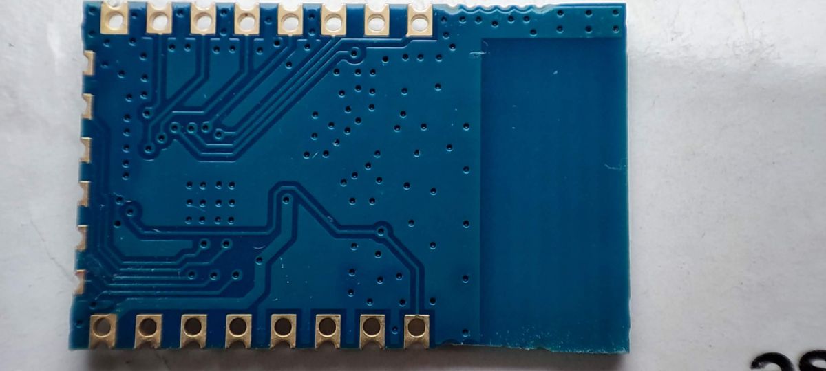

    divadiow wrote:
    I'm going to order one to see what I get! https://www.aliexpress.com/item/4000981643389.html
    some pics I took before I started playing and later killed the chip. Didn't get anywhere with flashing. Have ordered another module (with pins!) and the dev board.
    Electronic module HLK-B30 with CC8000 chip on a blue PCB Blue electronic module with visible circuit traces and soldering points. Close-up of C-chip CC8000 integrated circuit on a blue electronic board.
    https://www.aliexpress.com/item/1005005878342693.html
    Added after 25 [minutes]:
    Maybe this should be its own topic about BK7231U/CC8000

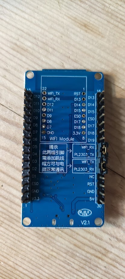

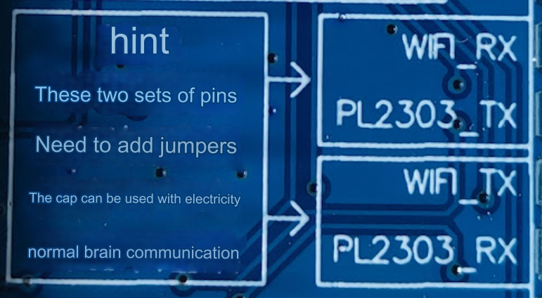

    shiny new toy
    New electronic board with various components in the center.
    Blue printed circuit board with pin labels and side connectors.
    Close-up of a circuit board with labels and connection diagrams.
    • hlk-b30.pdf (1.72 MB) You must be logged in to download this attachment.
