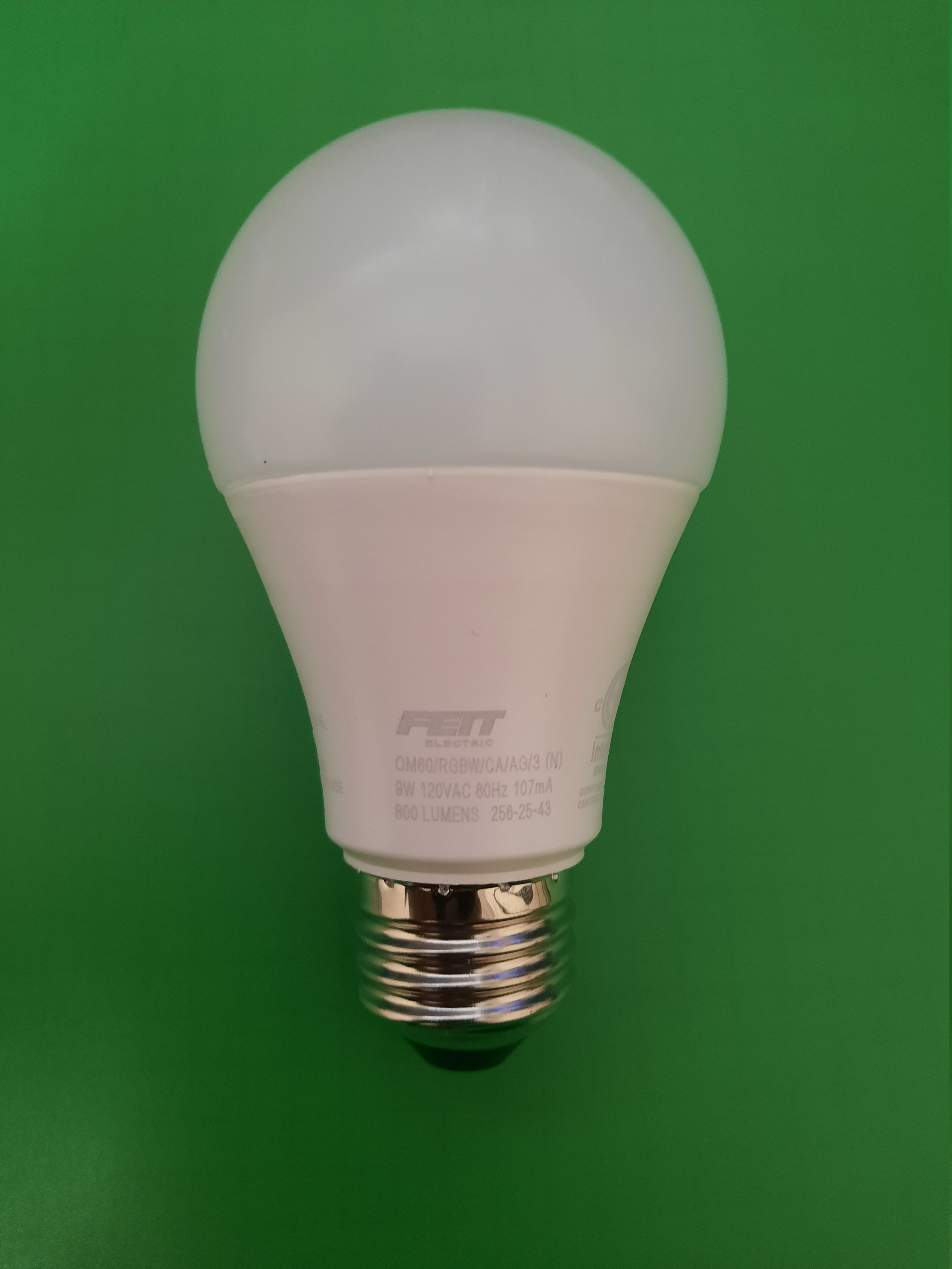

I bought a pack of 3 Feit OM60/RGBW/CA/AG(N) smart light bulbs
The (N) in the model name seems to denote a newer revision from the already posted non-N version, as these use a Tuya T1-U-HL (Beken BK7238), not the BK7231N
They still use the BP5758D LED driver IC.
Since they have the updated BK7238 cloudcutter won't work and will require UART flashing.
Teardown
Getting the dome off is tricky without damaging the housing (I have yet to find a way to not damage the housing)
I used a plastic scraper and wedged it between the dome and the housing and then went all the way around the dome.
This results in some plastic breaking off from the housing though.
I then pulled and twisted on the dome until it popped off.
Then remove the remaining silicone from the bulb.
To get the light board off I used a utility knife to pry it off, it is connected only by the 6 pin connector.
The PCB is flat on four sides, I went around prying up on all of those points until the board came off.
Now to pop the center contact from the bottom of the bulb.
I again used a utility knife to pry it off. after that is off you will see a wire bent around the black plastic, unbend it so it can go through the hole.
There is another wire wedged between the housing and the screw, I used tweezers to yank it out.
Once both wires are free from the housing, the main board can be pulled out.
WARNING: if the bulb has been plugged in, the capacitors may still be charged. They can't cause any harm, but you may get a small shock if you touch the leads on the back of the board.
