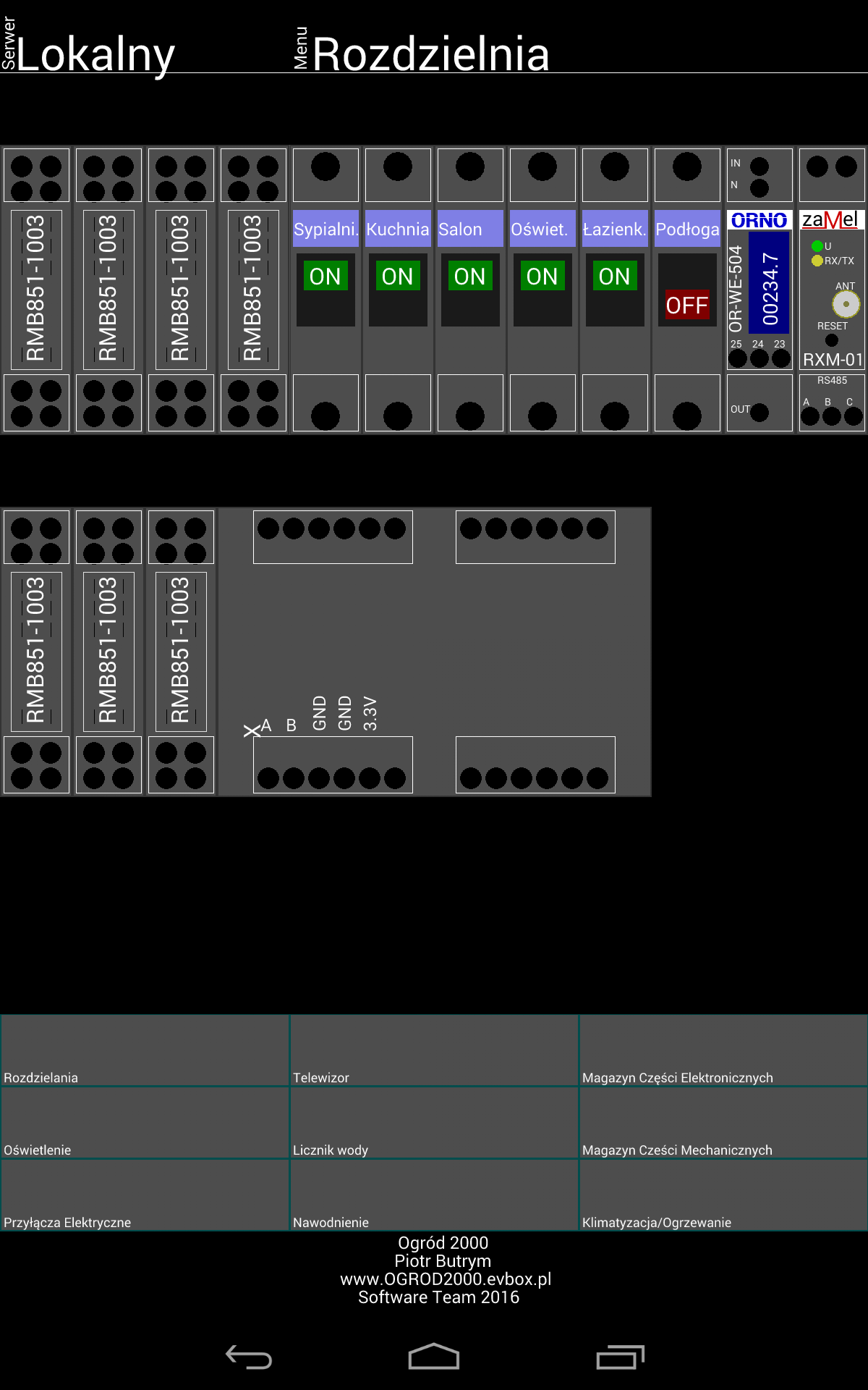

    Zamel works very reliably; I’ve never had it lose a frame.
    At home, instead of off-the-shelf control units, I’ve used an ESP8266 to act as a keypad, remote control and monitor, replacing my tablet and smartphones. The downside of Zamel components is the lack of a feedback channel, which is why I’ll eventually be replacing the ROPs with my own modules – and everything points to it being the RFM69 or something similar. As a ready-made component, Zamel is worth recommending, and if the lack of a feedback channel isn’t an issue, it’s worth using this manufacturer’s modules – especially as their support team is always happy to help with any problem. And it’s a Polish product :)

    RS-485 is pointless for unidirectional transmission. It’s exactly the same as adding a CRC during transmission. If the ROP misreads a frame, there’s no way to inform the transmitter of the error. Due to the lack of a return channel, Zamel cannot inform the system of its status – whether it is ON or OFF. That is why I am gradually moving away from Zamel. This does not detract from Zamel’s very good performance and, as you rightly pointed out, the quality of its build, both in terms of the electronics and the casing. The new Elro looks good too; as for reliability, you’re right ;) – it’s poor.
    Zamel operates using SI chips – exactly the same as those in the RFM01/02 modules. That’s why it’s easy to make bidirectional modules that are 100% compatible with the RFM22 modules. However, I’ve chosen a different path and am using the newer RFM69 modules, which are bidirectional and cheaper. The unfortunate thing is that even the new version of the EFC01 won’t change this, as it would involve replacing all the ROPs with two-way ones – which is economically unjustifiable, as it would be like buying a whole new system. When I have a spare moment, I’ll post some photos showing how my modification of the Zamel works bidirectionally, allowing me to read the status of ROPs, meters, fuses, manage storage facilities, heating and air conditioning. I’ve written the apps for Android, and from my tablet I have access to all the system components and more :) As I have my own router rather than the rather limited EFC, the IP address isn’t an issue, because locally the server is the ESP, and on the public network it’s an FTP server, so I don’t need a public IP address. :)
    Exta Free – is it worth investing in this smart building system?
    Exta Free – is it worth investing in this smart building system? [/img]
  • #26 15757069
    zoltar_vero
    Posts: 27
    Well, it’s already looking very good. I’m writing this as a professional PLC, HMI and PC programmer – I’m impressed by the commitment shown in building the system. Unfortunately, I don’t have the time at the moment to mess about writing software from scratch or tinkering with the modules. I’d need an Exta RS-485 transmitter so that I can control the garage from a single Exta application whilst I’m inside – the garage itself is based on an industrial Proface LT, and its surroundings are based on Exta. I could probably add three or four Exta transmitters and feed the signals into the PLC inputs, but where’s the point in that, and how would it make diagnostics any easier? Personally, having had various – and sometimes not particularly pleasant – experiences with industrial communication standards, I wanted to set up something simple at home without delving too deeply into the subject. Even two-way communication won’t protect you from, for example, relay contacts sticking together. The coil might give out, but the contacts will remain shorted, and even this communication won’t help here; it will indicate that the module is in the ‘off’ state, whilst physically, for example, a lamp or a pump will still be live. And in that case, what will you do? Will you add analogue modules to monitor current draw, or modules to check light levels and logic: it’s daytime, the sun is shining brightly, so the difference between the switched-on lighting and natural light at this time of day is X – does that mean we have a faulty module? Having learnt from experience in industry, I won’t complicate my life with such things. Even in industry, an over-engineered system will fail sooner rather than later. Well, unless we follow the example of our Coal Company and implement double redundancy for controls and actuators, plus PC control, plus remote manual control (Drutex), plus local control (Drutex) from the control station. Well, but then you’ll realise that the systems are reliable, but they cost what you might call a gazillion PLN. That’s exactly how Kompania Węglowa went under, having ordered machinery such as stackers, amongst other things.
  • #27 15757432
    piotr411
    Level 22  
    Posts: 483
    Help: 43
    Rate: 45
    It is precisely because off-the-shelf systems are not very intelligent that I am replacing them with my own. Note that the system includes an ORNO 504; the meter measures total consumption, but via the pulse output I can check the instantaneous consumption on any circuit. Now, if the load sends a signal indicating it is switched off whilst there is a load on that line, the ESP checks what is switched on and compares it with the status; therefore, there is no possibility of an incorrect reading. In the event of a short circuit, the ESP will detect that the load is switched on and attempt to switch it off again; if this fails, it reports a system fault. This is precisely the advantage of homemade modules over shop-bought ones: they can do more and are usually waaaaaaay cheaper. So, my home system is a spin-off from a major project I was working on in DIY stores; the only difference is that, whereas there I was working with Zamel, here I’m using RX/TX434 modules and Attiny chips, with an Odroid running my software acting as the server. Recently, I was writing such a large piece of software for the ESP that I had to use the ESP8266 13, because the 12F couldn’t accommodate the database – and even that turned out to be insufficient – so I bought the ESP chips themselves and, instead of on-chip memory, used memory cards: two 32GB cards switched via the app. I think the two-way modules I’ve developed based on the RFM69 could be brought to market as mass-produced commercial products in a short space of time, and in terms of price, with larger orders, they could compete with Elro. That’s about 30 zł. I also have some very nice modules of my own based on the HC-11 434 MHz, but commercially they’d cost about the same as the Zamel modules, though they’d be two-way. I’m also tempted to make a module based on a more powerful version of the RFM69, but the 150mA current poses a power supply problem; the modules would be too large to fit into 60mm enclosures.
