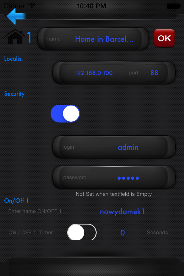

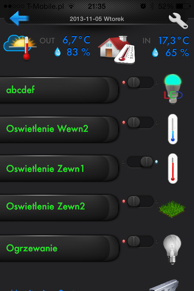

    For the long-established Lan TINY Controller module on the market, I recently decided to write an attractive-looking and pretty cool application for the Apple smartphone platform Tiny OnOff .
    Since the module is attractively priced (136 PLN) and extensions to it cheap , so I think that the offer in combination with my application may seem reasonable and economically correct :)
    I would like to add that I am looking for suggestions as to what functionality could be added to the application. Currently we have temperature and humidity readings and control of 5 relays - NOTE - in 4 controllers at the same time, which gives us 20 ON/OFF circuits.
    I would like to add that the application enables us to program an OFF-Timer / in seconds / for each of the outputs, each icon is programmed by the user during the configuration according to needs, and the descriptions of the buttons are also programmable and can be changed freely. Each change-control of the circuit results in a feedback check of the states of the switches and other parameters from the module, and the changes are reflected in the application window in a pleasant graphic form.
    In the near future, we are planning RGB control, and perhaps DIMMER - dimming for traditional 220 volt lighting.
    Short presentation: Presentation

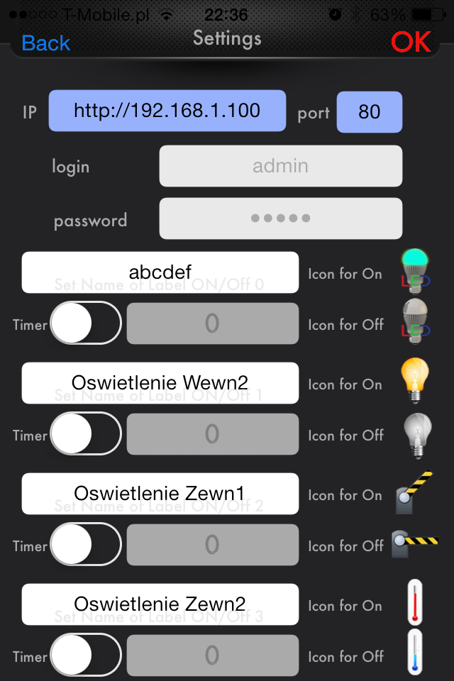

    i changed the ip to 192.168.1.100 and port 80 as it is on the device and it doesn't work, what should I do?

    is a local address. are you sure it's port80?
    and the IP address should be http://
    is the device available in the public address range?
    is a password set up?
    my information for you is complete
    construction of a sample IP address:
    http://192.168.0.100
    port 88
    passwords disconnected
    and if you have a fixed IP and unblocked forwarding on the router then you can try an external IP, and it must work. tested on software from 2.50 up to and including the current one with both 1.0 and 1.2 HW drivers.
    - one more thing occurred to me - maybe you have a current 3G connection and not WIFI connected to the same router ?
    If so, you must configure everything under public addressing.

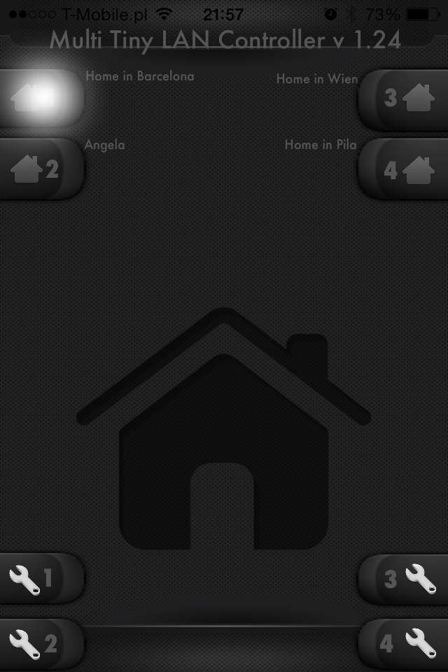

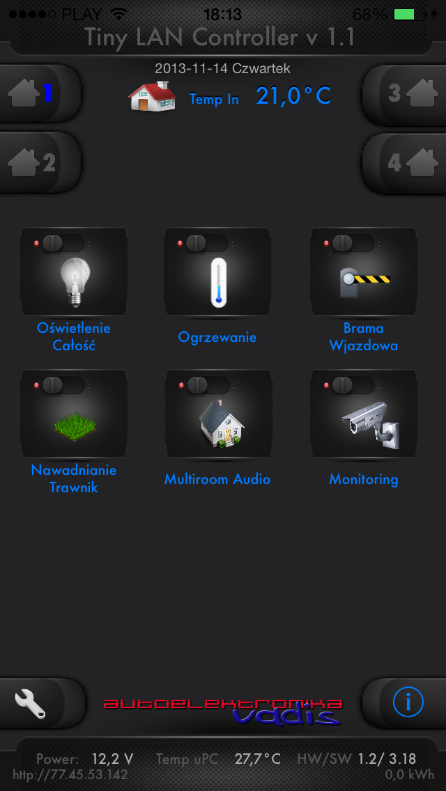

    I installed the app today but it has a lot to be desired:
    - The screen is not adapted to the Iphone 4S and yet it is the most popular model, only 4 outputs can be configured because 5 do not fit on the screen
    - It is not possible to connect more LK than 1,
    - Temperatures are probably preset because I do not have any sensors connected to the LK yet it displays some temperatures.
    - The application does not refresh the status of the outputs, it is necessary to switch on one of the outputs or switch to another screen in order to refresh all of them
    Let us hope that the next version will be more refined

    The application is optimised for iOS7 and iPhone5 , 5S , 5C.
    The iPhone 4 is slowly going away, but although I have not taken this display size into account in the next version, i.e. 1.24, which will be available any moment, I will try to take it into account in the next version. We are writing something for a larger display, so it is difficult to fit it on a smaller one and to display it dynamically. But I will try very hard :)

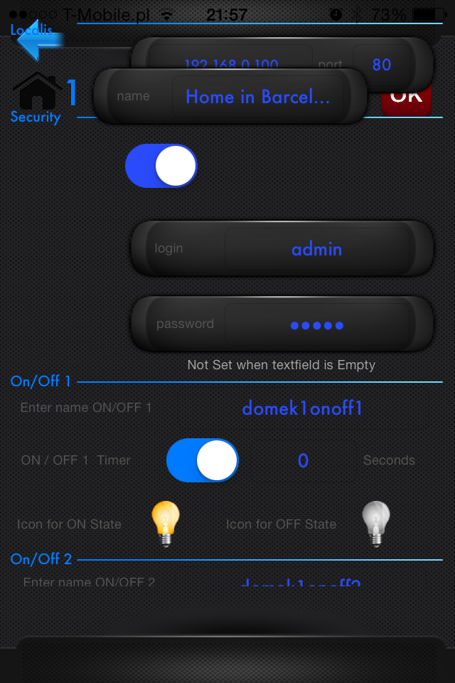

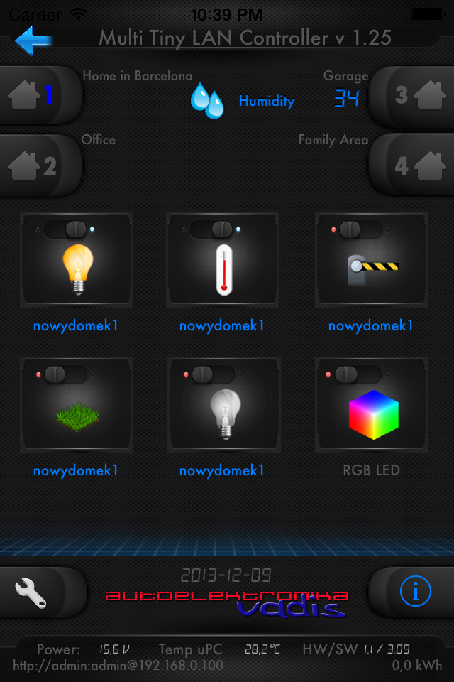

    I did the optimisation for iphone4 today, your information was sent in a post after I sent version 1.24 to Apple. I am sorry, but today's version 1.25 has already been sent to Apple, and I only included support for 3.5" display.
    You are waiting another 6 days for a version that will satisfy you, I believe.
    Version 1.24 itself is very stable and has many improvements. The fact is that I was not aware of such overlapping of graphics on a smaller screen before. From the very beginning of the creation of the application was on the iphone5. It was only under your suggestions today that I changed this.
    I hope that 1.25 will satisfy you. Unfortunately, every work is born in pain.
    As far as the dimmer is concerned, I think that as soon as the controller pcb evolves, we will definitely implement it quickly. I think everyone would be more interested in PWM RGB loadable up to 2-3 A. This would give interesting possibilities, if the board supports this I will add it as soon as possible.
    other than that , the setting views move up - down.
    Attached are the revised views for the 3.5"

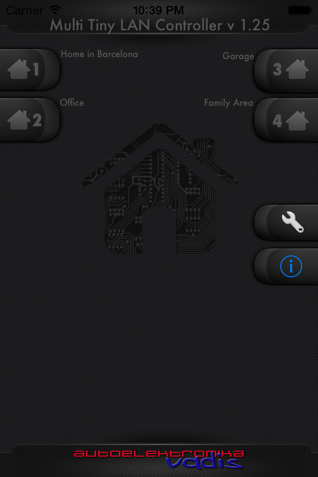

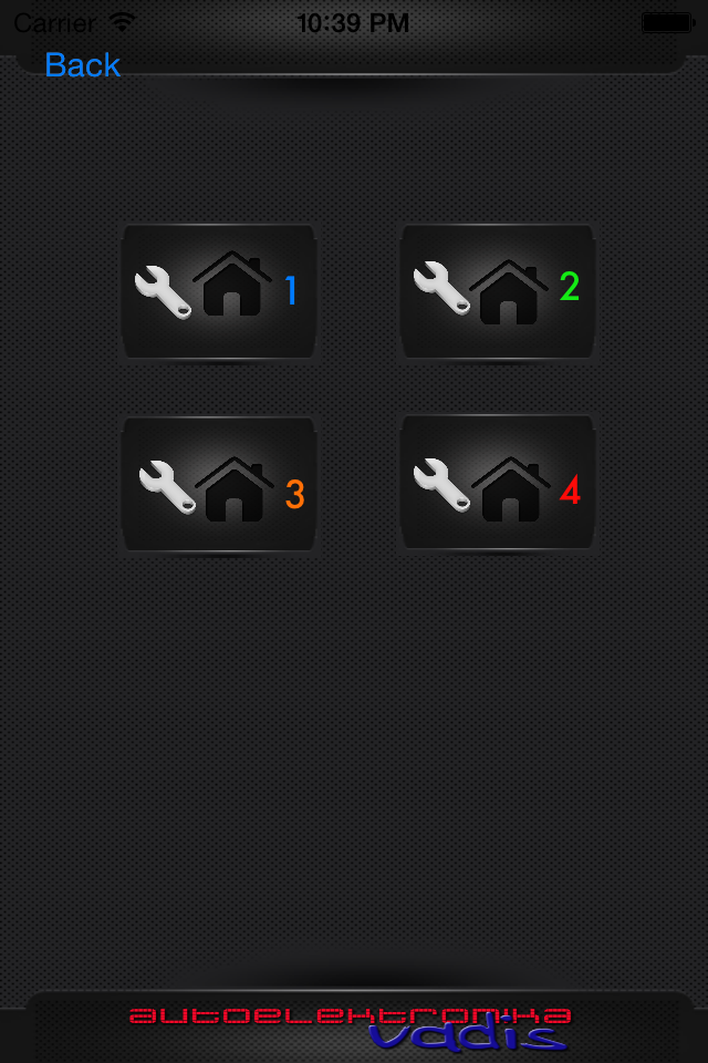

    In fact, I'm about to make a smart home on 4 LK units. TZN:
    - Control of lighting and appliances in the rooms (each input to the LK i.e. light attachment is redirected to an output on the LK or PWM i.e. dimmer)
    - display of temperatures, future regulation by strain gauges on radiators
    - possible placement of motion detectors which will switch off unnecessary lighting in rooms after e.g. 10 minutes of immobility.
    As you know, there are no dimmers for LED bulbs on sale, but it is very easy to dim a 12V bulb using current rather than voltage control.
    All you need to do is shape the PWM signal from the LK and feed it into the transistor that regulates the bulbs current. If anyone is interested I can post the schematic.
    Maybe you have some way of controlling 4 pieces of LK from the outside
    I have purchased 1 external IP and have no problem controlling 1 LK when redirected from WAN to LAN but how to do it with 4 LK pieces that have internal IP. Additionally, when I am at home the Iphone uses the internal IPs on the LAN as it connects to the router.

    Set each driver to a different port. That's all

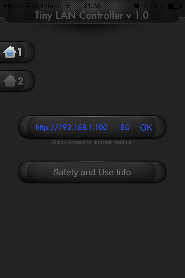

    why can't I set anything in this program after the update, it displays the message 0001
  • #18 13046725
    vadis0781
    Posts: 35
    Rate: 7
    Aeroplane mode, but everything works even without it
    settings and reassign the correct IP, and check everything for the presence, correctness of the password and user name. And if required, toggle the password switch. Finally, save the settings

    Sorry it's already working but I have one more problem how to change the light bulb icons ?
    And one more question what should be done to make the outside temp shown. At the moment it shows 5.1 degrees and I don't know where from ?
  • #20 13047595
    vadis0781
    Posts: 35
    Rate: 7
    Outdoor temp and icons at the next update. I didn't have a sensor to plug in :) , The only one I had was this DTH-11 with humidity measurement, and it works ok.

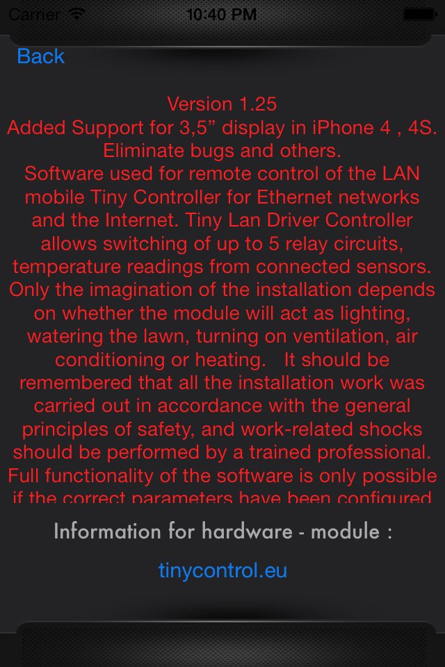

    Version 1.25 available in the AppStore.
    Some of the fixes have been implemented, others will follow in the next update publications.

    Have you read the 1.25 changelog?
    There is a new concept for changing the icons
    I am working on it.
  • #24 13065188
    arkomp
    Posts: 14
    Apparently so, but the application does not run stably from the outside: On the icons you can not see if the port is on…, it crashes. In addition, when you come home - as the phone connects to the internal network and so you have to give the IP over the LAN.
    What are the channels that scroll for (4 x 6 icons each)?
