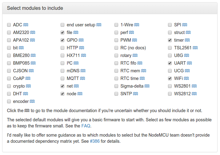

    I found a STRONE where you can build your firmware for the ESP.
    What should be in the firmware for my target to come up with this minimum?

    Again, use text, avoid this because it kills your memory. Assign sensor names to numeric values. LUA ESP has limited. space for global variables. After that, you can make each sensor in different files, and write the data into one common one.
    Casotome firmware is very unpredictable, on top of that it is bizarre to load and handle. You don't have to tick anything because these are just modules extending the capabilities of standard or new functions. For example, you use Uart, the 2015 version you currently have won. you can only set the speed and the number of bits, you cannot set the parity and the stop bit. Only selecting the uart module will give you such possibilities. And so with almost every function, something is improved there.
