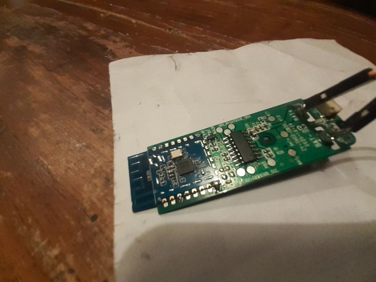

    Close-up of a green-and-blue PCB with electronic components and attached wires on a white sheet of paper.
    It's from AliExpress, I think Tuya MCU. This is my first temp sensor, more complicated than Wi‑Fi plugs!

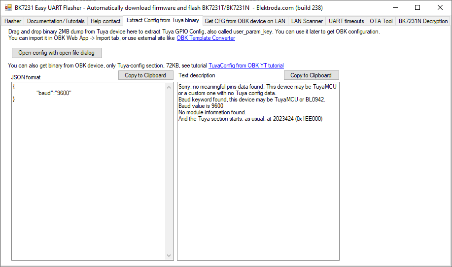

    Tuya KV extraction is performed in this tab in Easy Flasher
    Screenshot of Easy UART Flasher Tuya extraction tab showing JSON baud 9600 and notes about missing pin data
    If it's a TuyaMCU device only the baud needed will be shown as there are no GPIO assignments

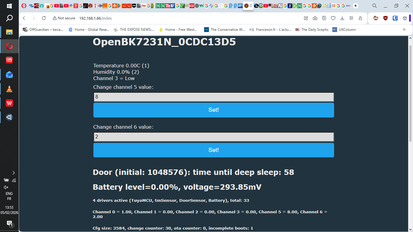

    Ah, I think it's too late then, as the original was deleted and written with the OBK firmware over the top. I must have extracted the original with the wrong baud rate (if that's possible); it just shows as bizarre characters.
    Any idea why I get no temp readings?
    Screenshot of OpenBK7231N web page showing 0.00°C temperature, 0.0% humidity, and channel value controls
  • Autoexec.bat mapping for TH01 temperature and humidity channels

    yes, there are quite a few TH01 variations, some with TuyaMCU, some without. Could do with a TH0x library with pics and known-good autoexec.bat, if theyre TuyaMCU.
  • Identified board as ZY-TH02-CB3S_V.1.0 and sensor markings

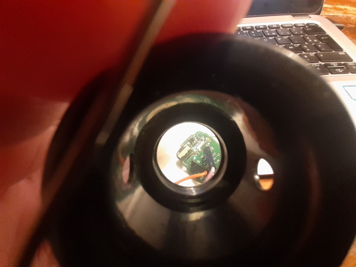

    Added after 1 [hours]:
    I haven't got what it takes to photograph tiny components but this sensor has S M L and EBPT on it.
    View through a magnifying glass of a green PCB with wires; a laptop keyboard in the background.

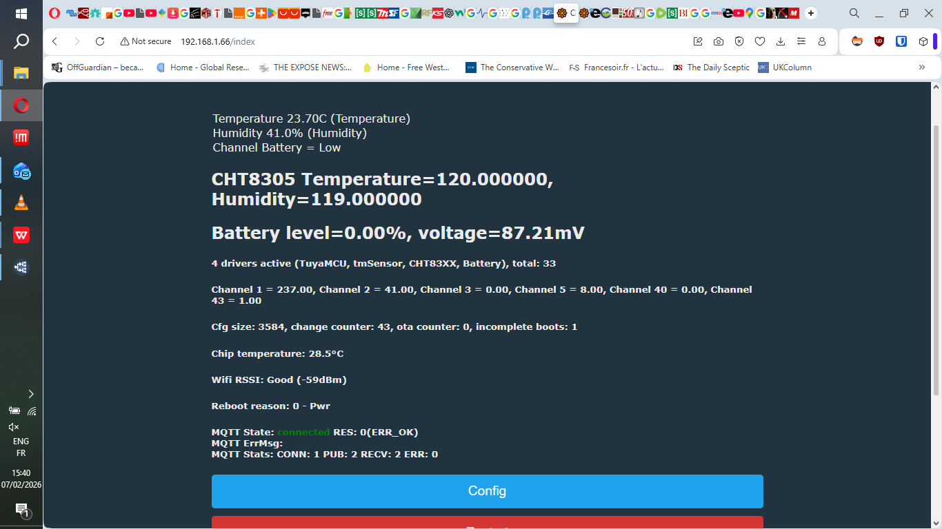

  • CHT8305 readings stay stuck at 120.00 and 119%
    #24 21831865
    johnnyh
    Posts: 16
    After playing about with the thing, holding my finger on the sensor and on the chip, I often get plausible readings. It seems to be working at least for now, although if anything it may be a faulty product.
    However, in the screenshot the top part shows the correct readings, but below that CHT8305 TEMPERATURE stays at 120.00, and Humidity also stays "wrong" at 119%.
    Screenshot of a web dashboard showing 23.7°C and 41%, but CHT8305 reads 120.00 and 119%, battery 0%

    oh. you have start-up commands too? only TuyaMCU and tmsensor should be running. The other drivers are for non-TuyaMCU devices. Clear startup command and use autoexec.bat only?

    CH83XX driver should not be run. It may overwrite your channels with bogus data.

    johnnyh
    Posts: 16
    I don't think I've got that. I've got no startup commands now and the Autoexec.bat doesn't mention CHT83XX driver — only TuyaMCU and tmSensor drivers.
    Edit: No, but yeah! There it is: "4 drivers active... CHT83XX..."
    Where is the thing that makes that happen? The template?
    I can't see where it's activated, and I have other issues with wifi etc. so maybe this will be the fix. Otherwise, it's working at least for temperature and I don't care about humidity. So how do I turn this driver off ?
