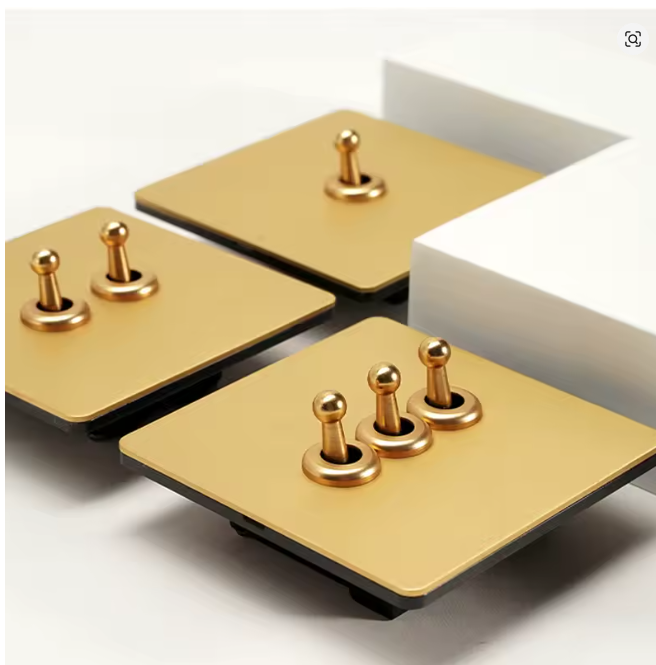

    1) The switches I want to buy are 1 gang, 2 way. It sounds weird because it's like it's supposed to be a staircase switch, but they're all like that on AliExpress, no 1 way. I attach a photo.

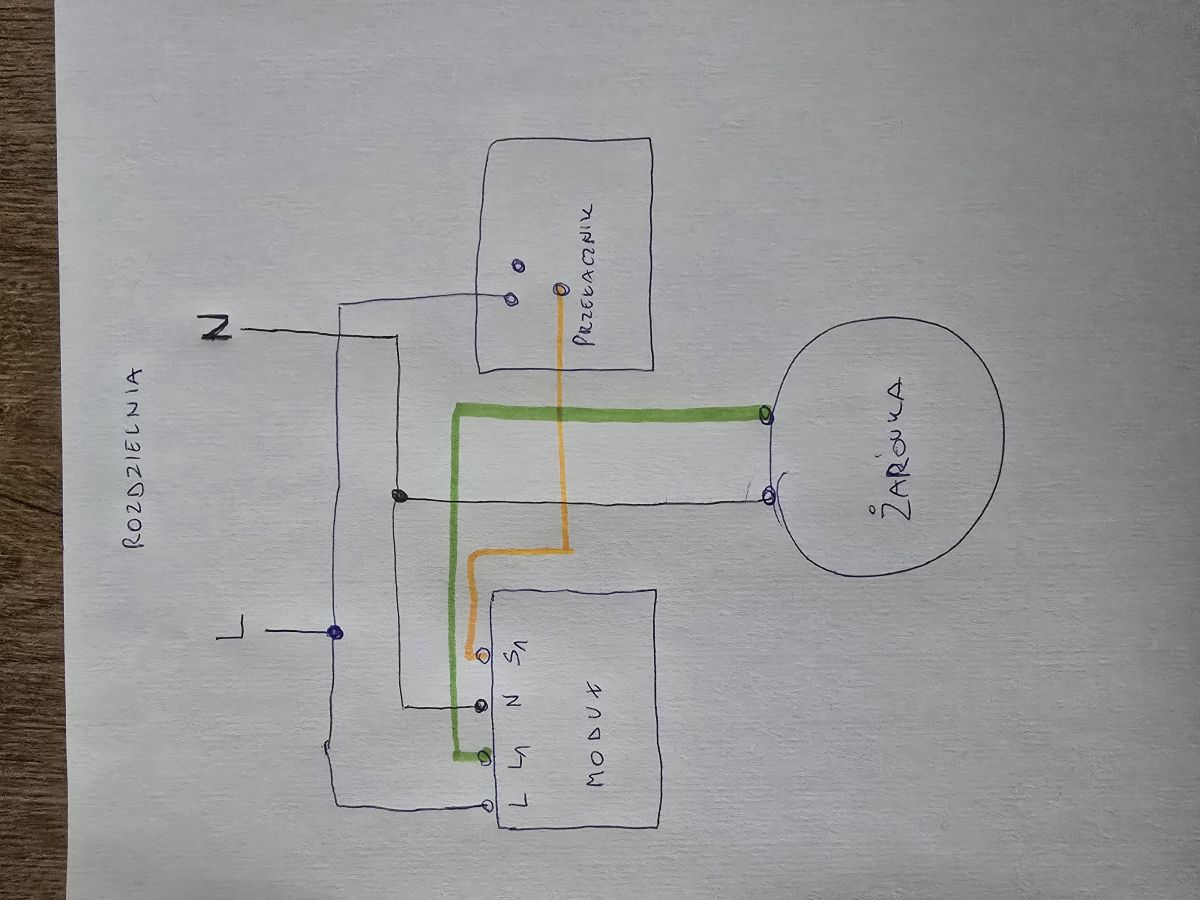

    I'm not familiar with it and don't know how to wire it up. According to the picture, a simple matter:
    L and N from the switchboard.
    L1 and N to the bulb (the neutral wire from the distribution board goes to both the module and the bulb, right?)
    S1 to the switch.
    And this is where I seem to have a conundrum. It appears that only one wire goes to the switch? How is this supposed to work?
    [Edit] I've added a drawing of how I see it. I don't know how correct this is. Especially if the light switch has an output for 3 cables, from what I saw in the auction pictures. Is it enough for me to connect under two?

    Gold toggle switches on square 86x86 mm mounting panels Zigbee switch modules, 1-channel and 2-channel versions with wiring diagrams

    electro4 wrote:
    And here I think I have a conundrum. it comes out that only one cable goes to the switch? How is that supposed to work?
    You have everything well drawn, and the cable to the switch may go one but there must be and are two wires.... When the switch is a two-way switch and has three contacts it can still be used in a normal non-switched circuit as it has two positions of which one connects two contacts and in the next position it disconnects the same contacts, simply, even if you don't understand it, you will connect two contacts in the switch, choosing those on which the circuit will work properly e.g. by trial and error... And if you want the circuit to be connected upwards and disconnected downwards, if it doesn't suit you, turn the whole switch by 180 degrees and it will be OK...

    Yes, you only need to connect under the correct two and "clockwise" you have three possibilities with three contacts and if the first attempt fails then the second attempt will be the correct one no matter if left or right you will put one of the wires or both at once....

    Well, yes, when you have stairs you have to buy staircase switches and these are the three-contact switches and the one-key bistable switches are usually staircase switches, and how many to buy you need to know the building plan and possibly also electrical engineering because you don't know how many floors up and how many down etc. etc.. And stair switches are used not only for stairs but also in long corridors or in two entrances to one and the same room in order to light a lamp or lamps from both sides of the room and if one lamp is a single path and if two lamps are switched, it is a double path and that is why they are called (way) - paths or circuits....
    PS. A photo with the number of levers without photos of the contacts and without description tells us nothing about the type of switch and how the lever works....

    Note that the modules you plan to buy require a minimum of two supply wires "L" and "N". And now there is the question of where you want to place them, if traditionally in the switch box then the question is whether you have the "N" in addition to the "L" there or not, because if not, then you have to provide it or place the modules in the switchboard or in the ceiling if there is space for them and change the concept of cable routing, that is, then draw yourself an installation diagram and not a general one as in your first post to understand what the next conundrum is....
    I have drawn you an imaginary box around the module, and also around the module including the switch because it would fit behind the switch to put the module in a deep box and counting around the perimeter you must have a minimum of 4 wires in the box leading to the required places and usually in such boxes made in the past there is / was only 3?

    >>21829260
    You've knocked me off track a bit.
    I thought there were only 3 wires going from the switchboard: phase, neutral and earth.
    According to what I understand, I split the L phase from the switchgear into two wires in the box. One goes to the module to L and the other to the light switch.
    The N from the switchboard I also split into two wires in the box, with one going to the N in the module and the other to the light bulb.
    This now leaves a loose s1 in the module, which I connect to the switch. And L1, which I pull to the bulb.
    So in theory two wires from the switchboard are enough. And I can connect this third earthing wire to the lamp if I have a metal housing.
    Please correct me if I am wrong.

    So you have assumed that the module is to be in the box together with the switch as I understand it?
    All good reasoning and well drawn.
    Now it's just a question of how many wires you have in the box in real life and where do they run?
    If they provide you with what you have assumed and what you have written and drawn, then OK.
    When the modules and connectors arrive, you'll be able to practice and understand.
    What I meant was the first situation where in the junction box you have only 3 wires led in the old way, i.e. phase from the distribution board and only two outlets (two phases) to the chandelier to two branches (light points) of the chandelier in the ceiling and nothing more, i.e. "N" is not in the junction box because it is only in the ceiling:

    These Tuya dimmer modules are designed for reset (bell) switches. The classic one works too, but you have to switch it on and off quickly, because as soon as you switch it on, it dims the bulb or similarly in the other direction it brightens it.
    Question:
    Are there any other dimmers that support the classic switches normally? Because I don't smile to buy bell switches. Because one day, as if one module dies, I just disconnect it and connect the button normally. With a bell switch this won't work. Besides, I already have a selection of nice gold metal switches like in the picture above.
