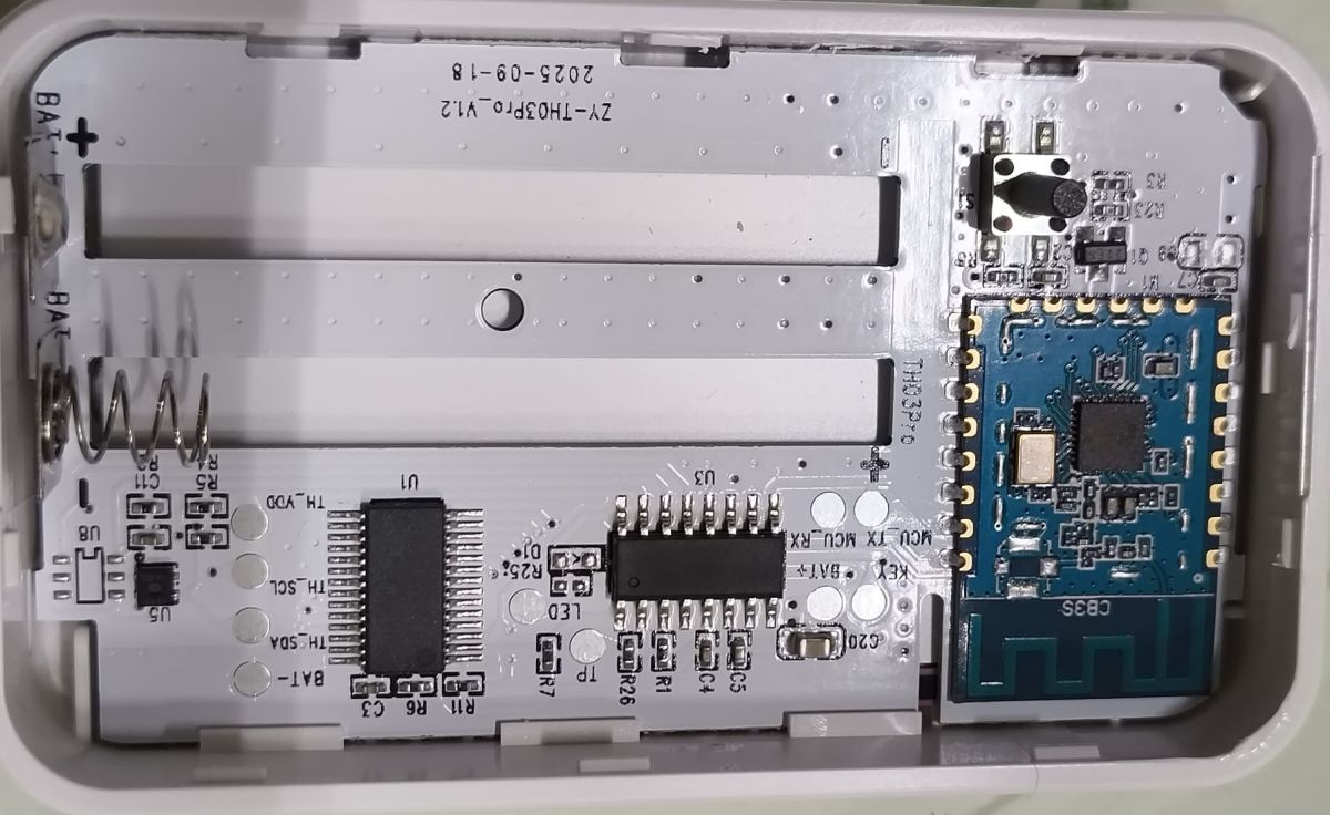

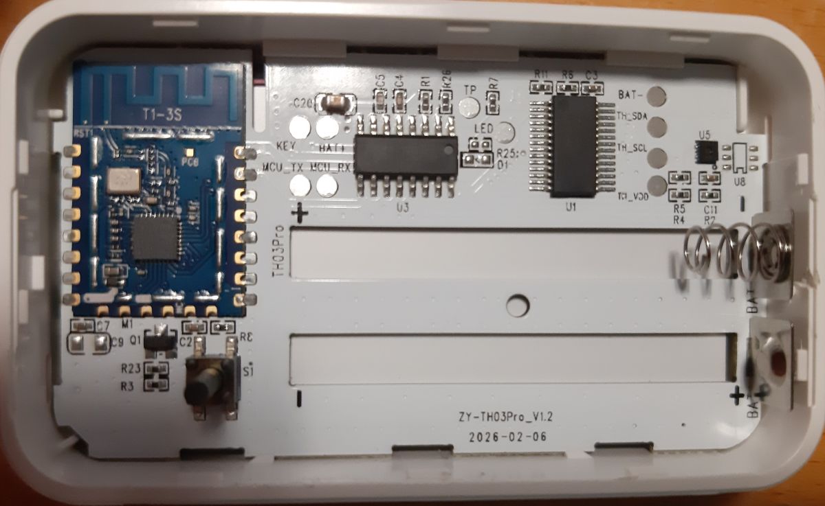

    The item you found should be exactly the same model, TH03 Pro. That's what's inside:
    Inside of a device showing a PCB with battery spring contacts and a blue electronic module on the right

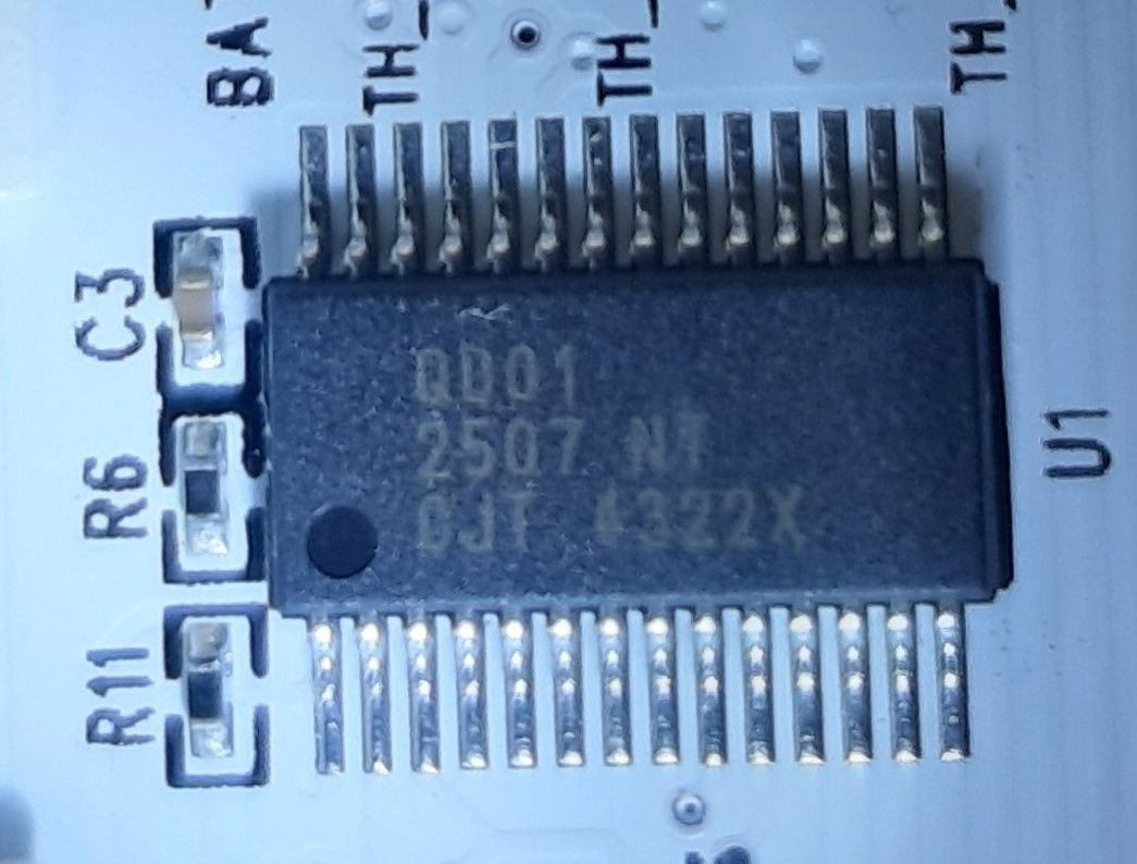

    U3 has nothing written on it, U1 reads something like "QD01 2507 NT CJT 4322X". I have no idea, which of the two chips is the MCU.
    Close-up of an SMD IC on a PCB with labels U1, R6, R11, and C3
    Communication module is CB3S, which is well known in OpenBeken. It transmits only three values: Temperature, Humidity and Battery State. It transmits data every 90 seconds (or so). Most of the time, the device is sleeping and the values in the display don't change, even if you heat or cool it. When the WiFi-Symbol starts animation, data is transmitted and some seconds later values appear in the app as well.

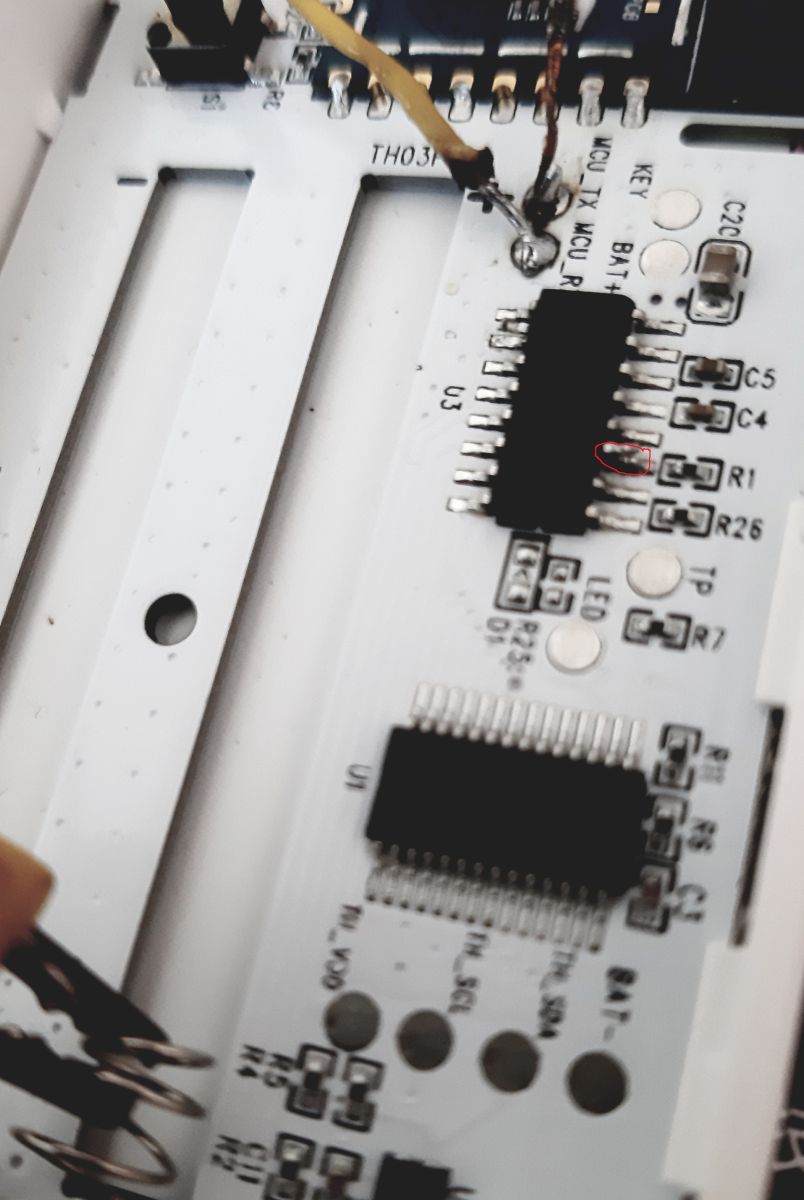

    For flashing I would have to mute the MCU, right? If anyone could help me with that? Probably there is an easier way than cutting the lead from CB3S to MCU, like setting an enable pin on the MCU to high or low signal?
    Update: Apparently U3 is the MCU, so U1 should be the LCD-Controller.
    Pin 10 of the MCU has direct connection to TX on CB3S, Pin 9 to RX. Pin 5 is V+, Pin 12 is GND.
    What does TP (Pin 2), TH_SCL (Pin14), TH_SDA (Pin 13) and TH_VOD (Pin 15) mean?

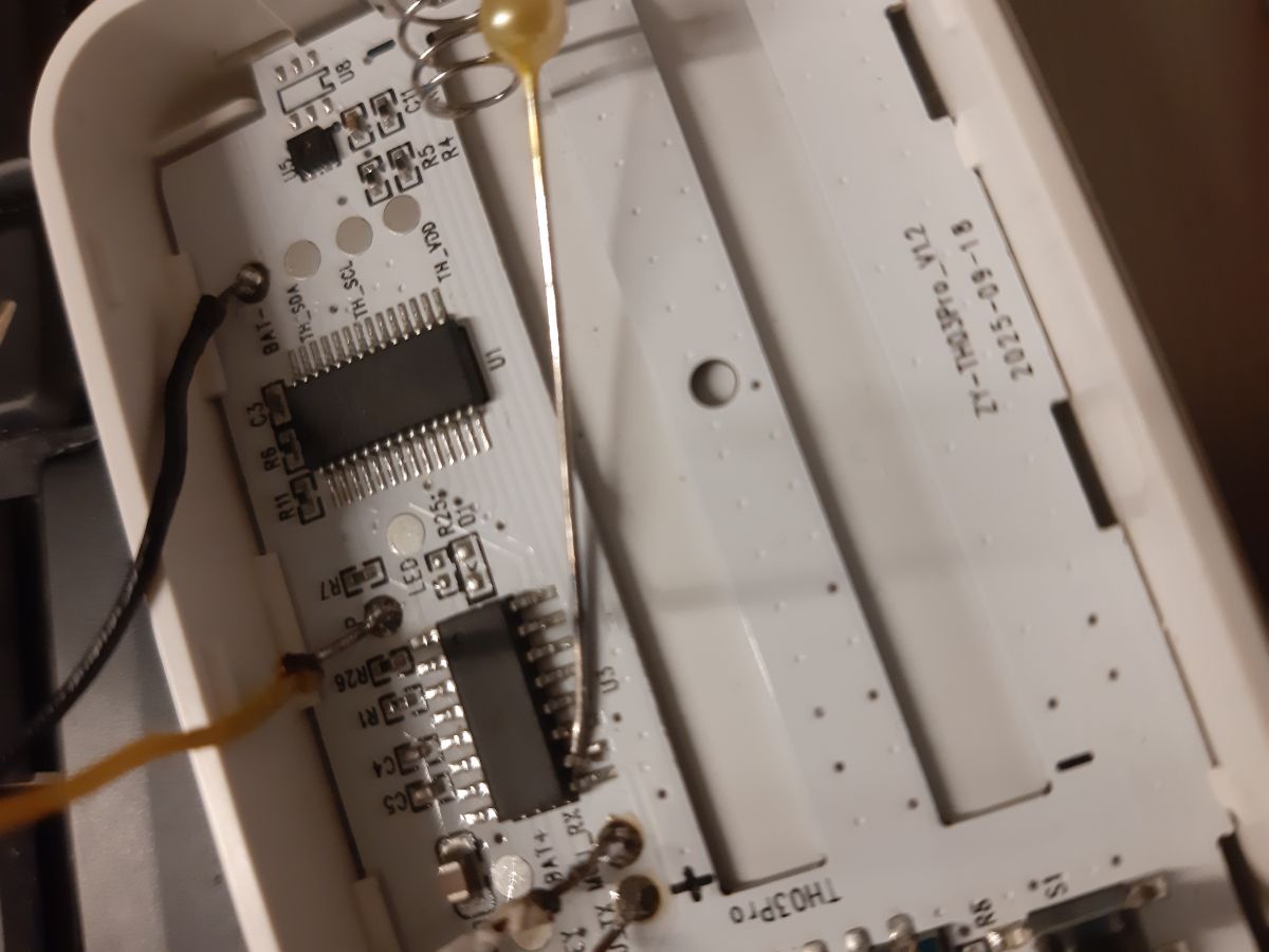

    >>21836406 For flashing you will need to disconnect MCU and CB3S. For me it worked to just heat up MCU-Pin 10 and lift up the IC-leg with a needle - just enough, that it has no longer connection with the board. You can check with a multimeter between leg and pad "MCU_RX" - there should be no longer connection if succesful.
    Inside a device: PCB with ICs and a two-AA battery compartment with a metal spring contact.
    For flashing I soldered wires to the pads MCU_RX and MCU_TX (which is - in this order - CB3S_TX and CB3S_RX). For power you can use the battery connectors on the right side. Apply 3V to V+, Ground to V-.
    After succesful flashing and device startup you only have a minute or so to connect to the OBK-Webpage for configuring, as MCU will send the WiFi-module to sleep after a while. Just pull out a battery and reinsert to complete configuration. You'll probably have to do that several times.

    I re-ordered another TH03Pro, and this time arrived with T1-3S controller instead of CB3S.
    TH03 Pro Temperature Humidity Sensor Compatibility with OpenBeken Integration (possibly)
    From searching in elektroda.com I found, that this is supposed to be BK7231T - BK7238 to be exact.
    Can anyone confirm that?

    Rate: 918
    it'd be a nice-to-have, sure. it'll be different to the BK7231N/CB3S version. T1=BK7238
  • Backup read stops after 8–9 seconds on TH03 Pro
    #21 21890692
    io2345
    Posts: 273
    Rate: 7
    >>21890540 I can't back up the original firmware. Read stops after 8 or 9 seconds, independently from hardware and baud settings. I used a different PC and a different serial adapter, tried all available baud settings. Even, if I connect the T1-3s's Vcc (pin 8) directly to 3,3V. No idea how to get on
    Hinzugefügt nach 2 [Minuten]:
    RX/TX are connected to the pads MCU_TX and MCU_RX on the board, MCUs Pin 10 is disconnected from the board - same procedure as above with the CB3S

  • TuyaMCU traces may need to be cut for flashing
    #23 21891045
    Posts: 5220
    Help: 449
    Rate: 918
    Yes. Unfortunately TuyaMCU on RX/TX can often get in the way of flashing efforts. It's been known that the traces between module and TuyaMCU need to be temporarily severed for successful flashing.
    Or desolder the whole T1 module if you have hot air gun to cleanly remove it
    Potentially TuyaMCU could be held in reset mode so it's effectively offline. BUT, I'm not sure if these unmarked generic 16-pin MCUs have that ability. No idea if we know what each pin on the IC is.
  • #24 21891084
    io2345
    Posts: 273
    Rate: 7
    >>21891045 Found, that the MCU periodically pulls Pin1 of T1-3S to ground. That's why read-back stops. This Pin is directly connected to Pin3 of the MCU. So you have to detach that line as well. Check between leg and R1 if detach was successful.
