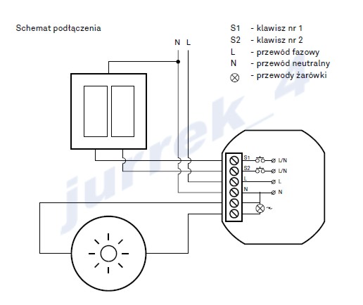

    I would like to connect such a wireless dimmer module, to an installation in an old block of flats.
    I have 3 wires in the switch box ( for 2 keys).
    According to the manufacturer, I cannot connect this module to such an installation.
    Maybe someone can take a look at it, whether there is a possibility of connection after all?
    Thank you in advance.
    Sebastian

    sebix30 wrote:
    Maybe someone can take a look at this, is there a possibility of a connection after all?
    No. It requires a neutral (or neutral wire) to work, which you in the breaker box don't have. Besides, there are more connection terminals there, so you are missing the wiring.
