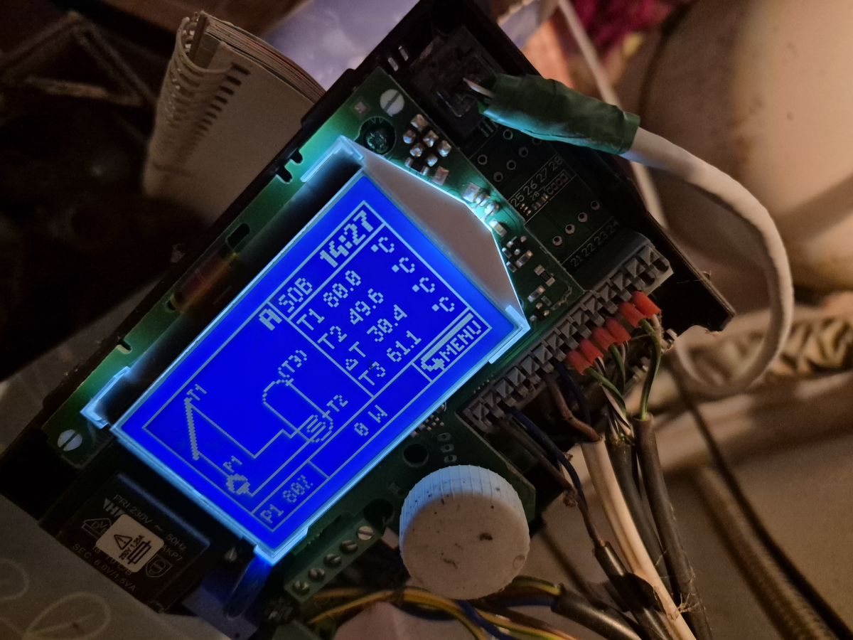

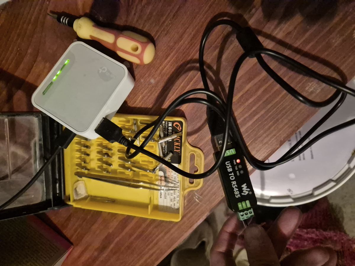

    ppsirius
    Posts: 23
    Connected to the solar collector controller. Two centre cables in 4-pin RJ-pot.
    Solar collector controller with illuminated LCD display and connected wires. .

  • #603 21527005
    SławekSS
    Posts: 726
    Help: 34
    Rate: 80
    connect this rs485 dongle to the PC and see what the device manager reports under ports (com and lpt)

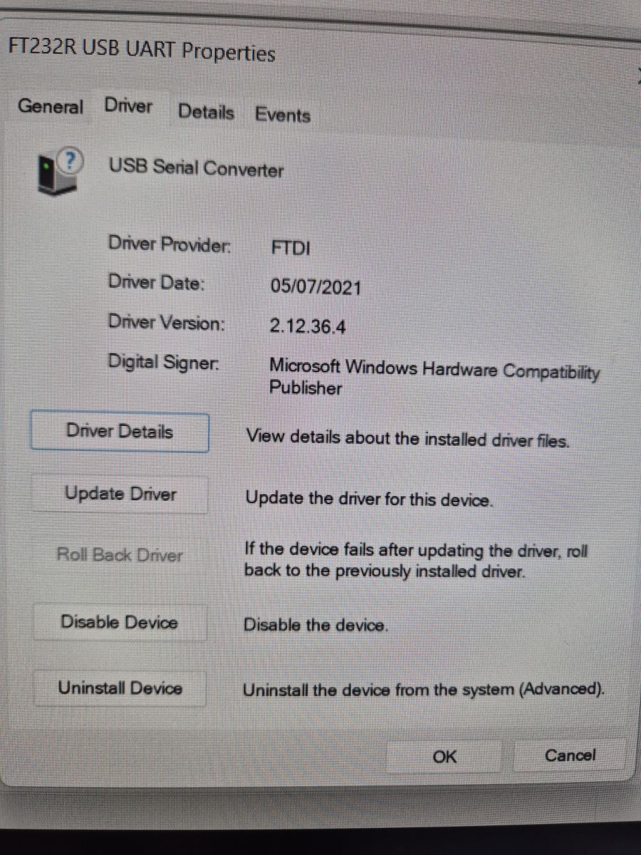

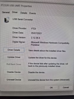

    ppsirius
    Posts: 23
    I guess that's the right equipment?

  • #605 21528063
    SławekSS
    Posts: 726
    Help: 34
    Rate: 80
    It appears to be ok.
    In that case, you are not connecting to the solar controller.
    Check on the board (along the paths) to which pins A and B are actually connected, if you are sure to the middle two of this rj-12
  • #606 21536586
    arni077
    Posts: 7
    >>21528055 .
    @ppsirius
    If you want to Solars, read post #484.
    Because the soft from cookers will not work.

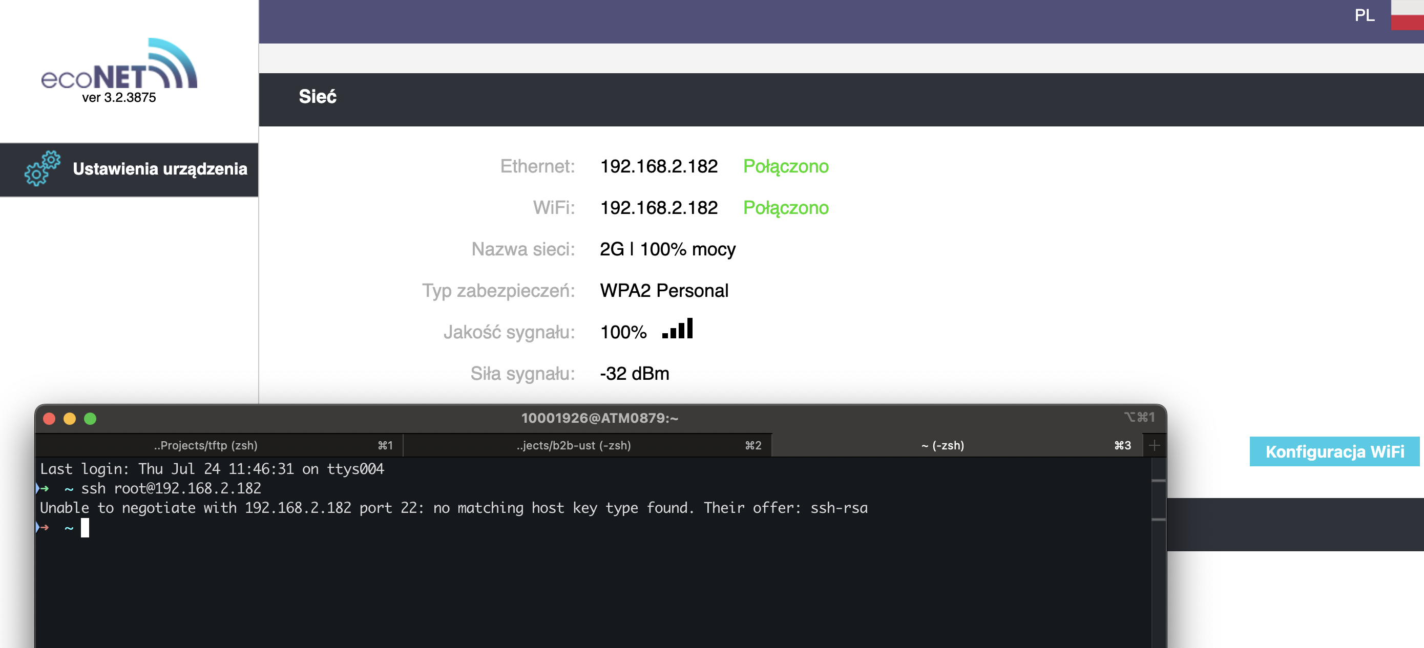

    ppsirius
    Posts: 23
    How should I upload this file? I am not able to access via SSH to the router :/.

  • #617 21620314
    ppsirius
    Posts: 23
    I have uploaded ecosol and now I am unable to restore OpenWrt. It pings 192.168.0.66, but after firing up tftpd64 and holding the WPS button nothing happens. Has anyone had any success uploading OpenWrt on ecosol?
  • #618 21620324
    SławekSS
    Posts: 726
    Help: 34
    Rate: 80
    Configure a TFTP server as follows:
    IP address 192.168.0.225
    The *.tftp-recovery.bin file is available in the root and renamed as tp_recovery.bin
    Connected to the mr3020v3 via a wired connection
    Install OpenWrt
    Power off the mr3020v3
    Hold down the 'reset' button - this is adjacent to the row of lights on the top panel
    Apply USB power to the mr3020v3 while holding the reset button
    After 20-30 seconds the upload will be complete, release the reset button
    The OpenWrt image will now be loaded on the device. By default wireless will be disabled. The system will be available on its wired interface on 192.168.1.1.

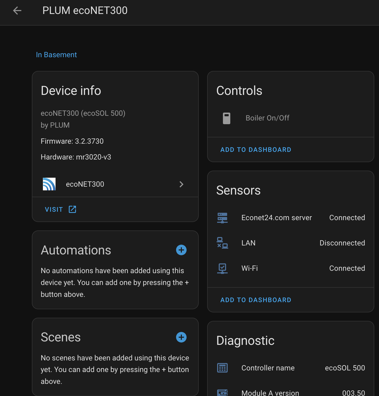

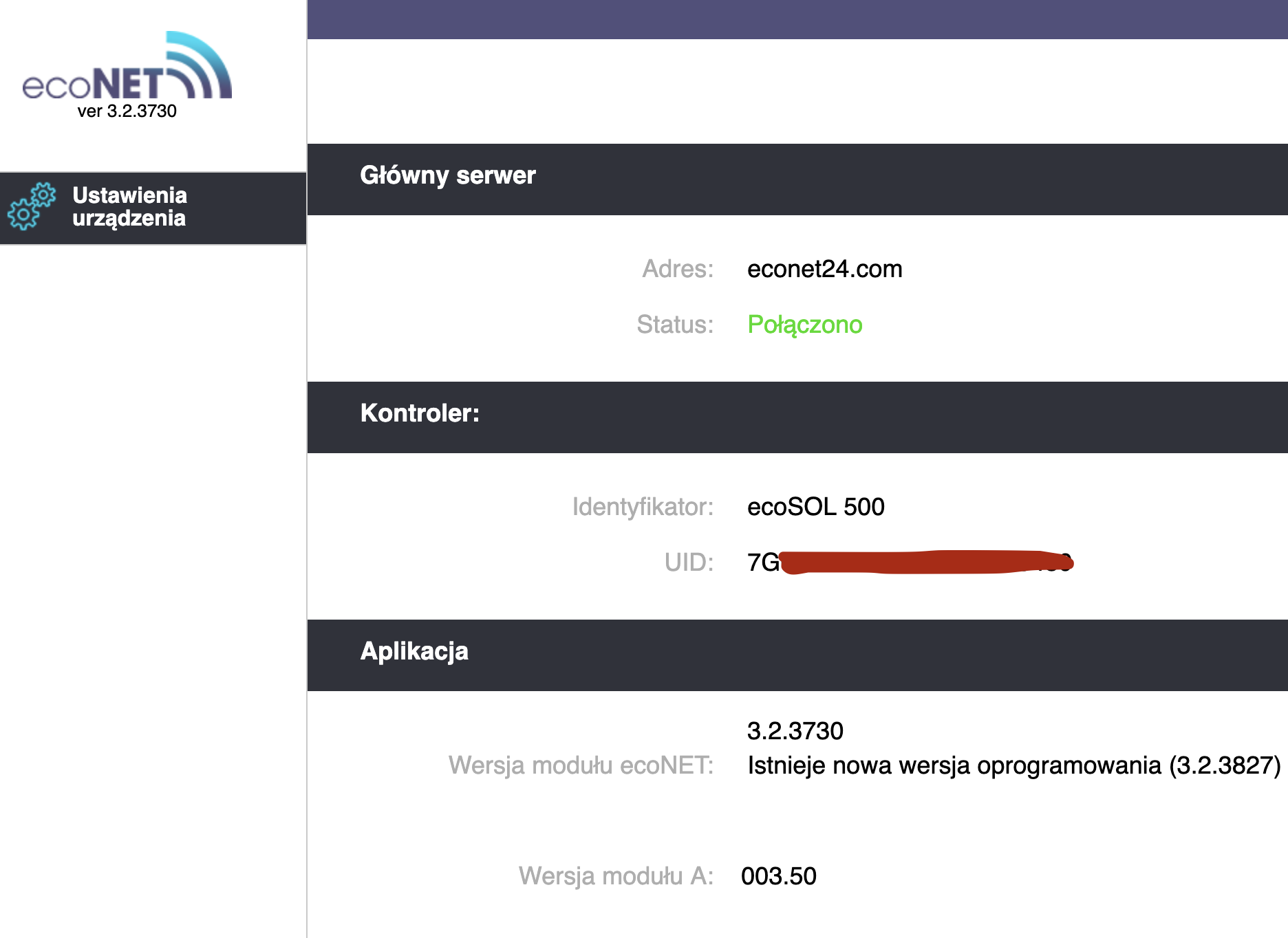

  • #621 21623050
    ppsirius
    Posts: 23
    It worked (it is reading the UID from the controller)! Thanks a lot for your help!
    I'm just wondering how I can read more sensors, because so far I don't have any useful information there. I'm mainly interested in the information from the DHW tank, which is available on the controller. I should add that I am connecting it to the ecosol 500 solar collector controller (I have swapped the files in the www folder).
    ecoNET control panel with ecoSOL 500 identifier and Connected status .
    ecoNET300 interface showing device info, network status, and diagnostics .

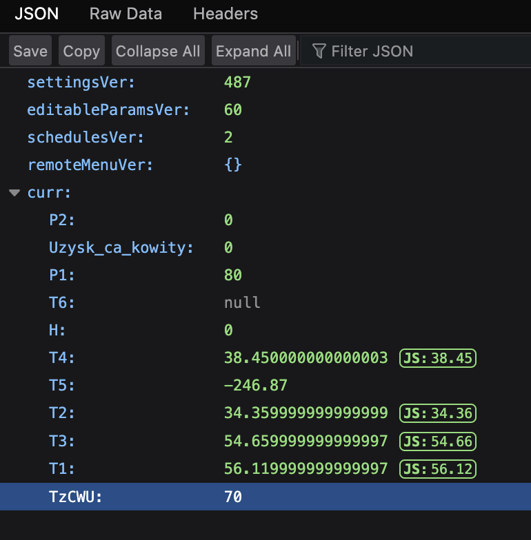

  • #623 21623138
    ppsirius
    Posts: 23
    It returns valid data in JSON. How can I add them to Home Assistant?
