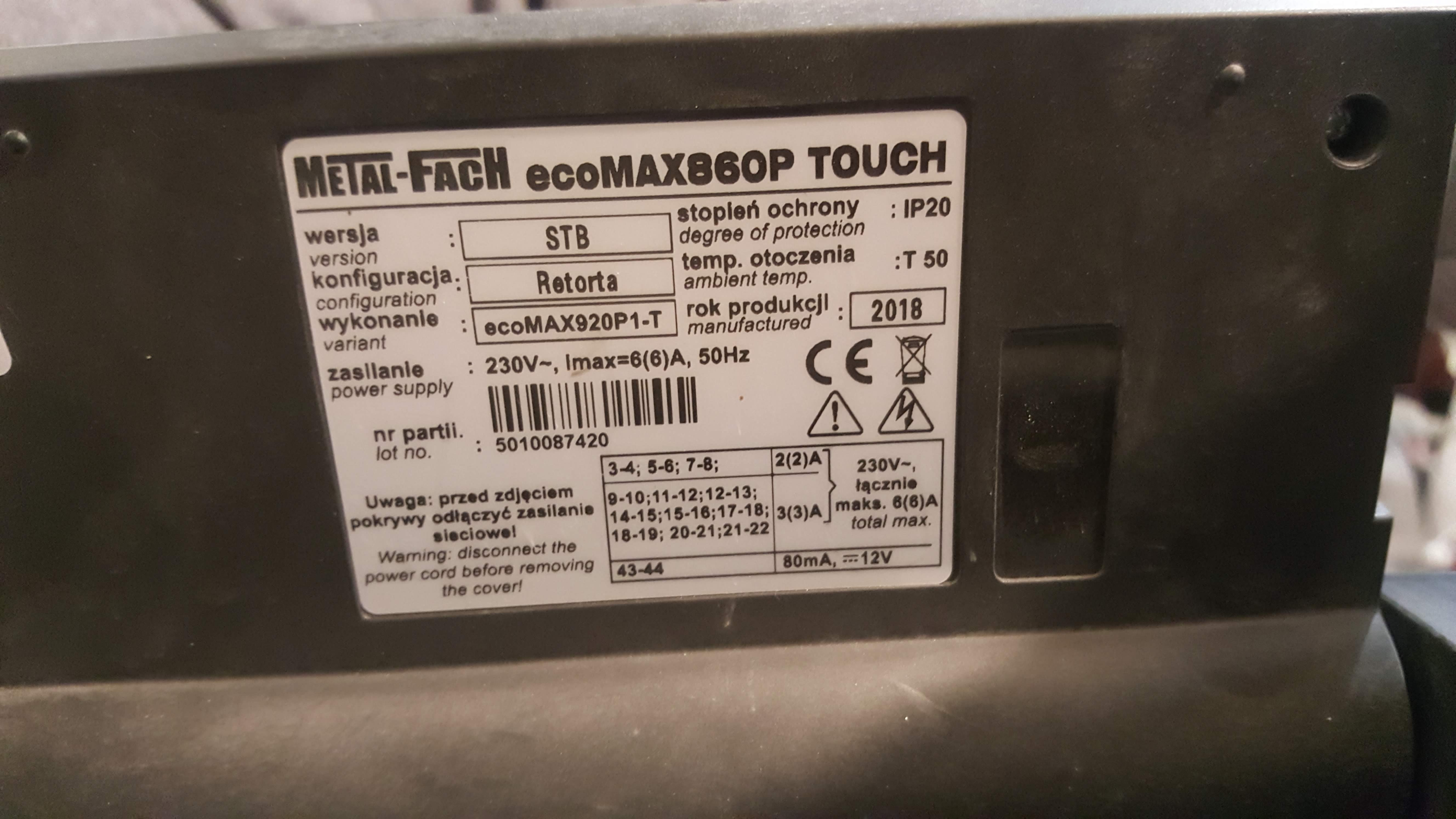

    I tested on my ecomax 920 and it reads everything nicely.
    It doesn't work for me
    i have ecomax920p1-t
    I watched him today most of the day and it turns out that the string 0x68 0x69 0x01 does not exist for me
    Probably my driver is different.
    The only thing I noticed is that there is something repetitive for 0x69, but I can't read anything from it.
    I enclose what my driver produces, maybe someone will help to catch the beginning of the frame

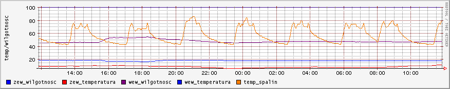

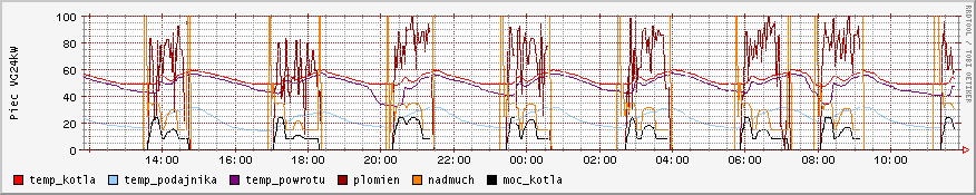

    Screenshot from the 1st day of operation of the furnace (ecoMax)
    Internet module ecoNet 300 and ecoLINK2
    Screenshot from the 1st day of Arduino work with DHT22 sensors and measuring the flue gas temperature sensor on the basis of a sensor installed manually in the chimney at the outlet of the furnace. It counts the resistance and on that basis I get the temperature.
