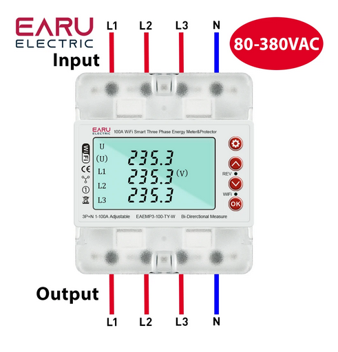

    This TUYA device is also labeled:
    - EARU EAEMP3-100-TY-W
    - SMTONOFF 3P4W G100A
    it has a RN8302B energy meter chip.
    EARU smart three-phase energy meter with display.
    SMTONOFF G100A smart energy meter with Wi-Fi functionality.

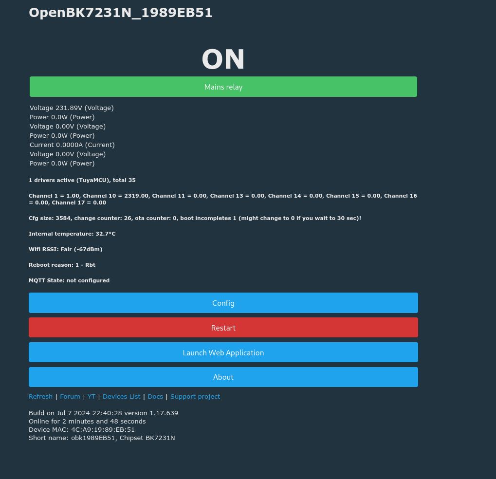

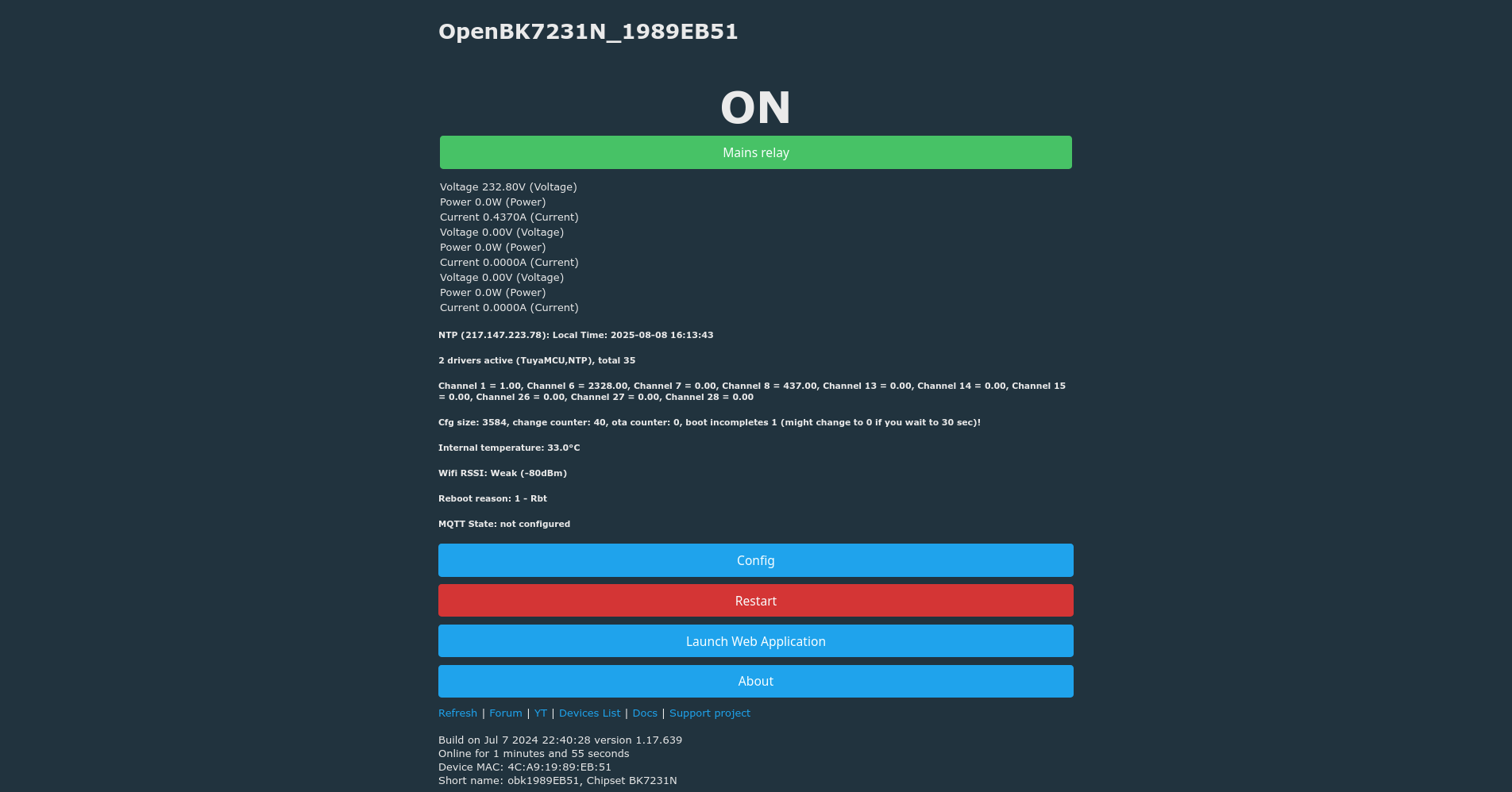

    atm i can't find any connection from dpid to any values. I started tuya driver at startup and tested a 100w bulb connected 3 phases but no values are near to some match.....???!!!

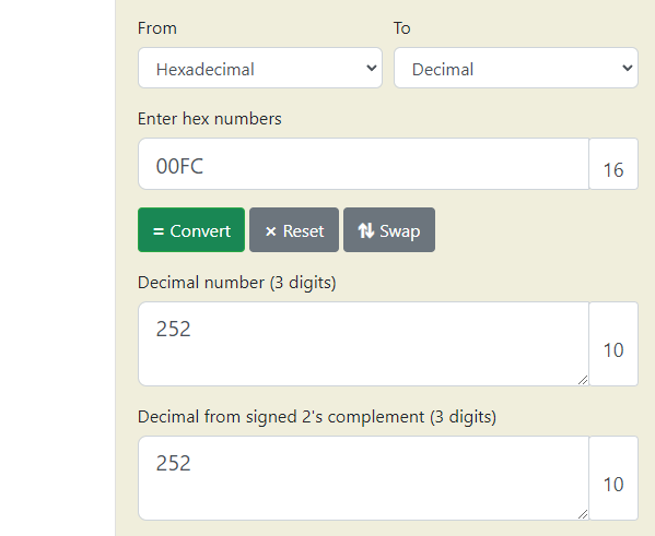

    55 AA 03 07 00 13 71 00 00 0F 09 29 00 01 B7 00 03 FC 00 00 00 03 E8 C3 32 65
    then payload is:
    FC 00 may be 252V?
    Hexadecimal to decimal conversion shows a result of 252.

    got something:
    startDriver TuyaMCU
    //tuyaMcu_setBaudRate 115200
    tuyaMcu_defWiFiState 4
    // --------------confirmed----working------------------
    // Mains relay on-off - Dpid 16 switch" -> channel 1
    linkTuyaMCUOutputToChannel 16 bool 1
    setChannelType 1 toggle
    setChannelLabel 1 "Mains relay"
    linkTuyaMCUOutputToChannel 6 RAW_TAC2121C_VCP
    setChannelType 10 Voltage_div10
    setChannelLabel 10 "Voltage"
    setChannelType 11 Power
    setChannelLabel 11 "Power"
    setChannelType 12 Current_div100
    setChannelLabel 12 "Current"
    linkTuyaMCUOutputToChannel 7 RAW_TAC2121C_VCP
    setChannelType 13 Voltage_div10
    setChannelLabel 13 "Voltage"
    setChannelType 14 Power
    setChannelLabel 14 "Power"
    setChannelType 15 Current_div100
    setChannelLabel 15 "Current"
    linkTuyaMCUOutputToChannel 8 RAW_TAC2121C_VCP
    setChannelType 16 Voltage_div10
    setChannelLabel 16 "Voltage"
    setChannelType 17 Power
    setChannelLabel 17 "Power"
    setChannelType 18 "Current_div100
    setChannelLabel 18 "Current"
    i attached a 160W bulb which results in ~0,6A on phase 1. but the outputs are not right at all. while voltage seems to be ok, but only on phase 1
    Screenshot of OpenBK7231N interface with active mains relay and parameter readings.
    i saw 1,0W once so maybe we need Current without div.

    vincenzoernst1
    Posts: 96
    Rate: 7
    @p.kaczmarek2
    no change. still only the voltage is shown on one phase.
    i tried
    linkTuyaMCUOutputToChannel 6 RAW_TAC2121C_VCP 0 10
    and
    linkTuyaMCUOutputToChannel 6 RAW_TAC2121C_VCP 1 10
    linkTuyaMCUOutputToChannel 7 RAW_TAC2121C_VCP 1 10
    linkTuyaMCUOutputToChannel 8 RAW_TAC2121C_VCP 1 10
    here is 160W attachted to phase1:

    @p.kaczmarek2
    i feel a little dump ...i cant find the mussing data
    from my dpld findings (1st post) it should be something like this:
    startDriver NTP
    startDriver TuyaMCU
    linkTuyaMCUOutputToChannel 6 RAW_TAC2121C_VCP 6
    setChannelType 6 Voltage_div10
    setChannelLabel 6 "Voltage"
    setChannelType 7 Power
    setChannelLabel 7 "Power"
    setChannelType 8 Current_div1000
    setChannelLabel 8 "Current"
    linkTuyaMCUOutputToChannel 116 RAW_TAC2121C_VCP
    setChannelType 15 Current_div1000
    setChannelLabel 15 Current"
    linkTuyaMCUOutputToChannel 126 RAW_TAC2121C_VCP
    setChannelType 26 Voltage_div10
    setChannelLabel 26 "Voltage"
    setChannelType 27 Power
    setChannelLabel 27 "Power"
    setChannelType 28 Current_div1000
    setChannelLabel 28 Current"
    but no output
    OpenBK7231N web panel with relay ON and displayed channel data
