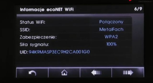

    I made a test applet with an attempt to download a file based on the data from miszko logs. It returns server status 200, but there is no download file, unless something is wrong :)
    • test.zip (1.05 KB) You must be logged in to download this attachment.
  • #73 18271996
    miszko
    Posts: 154
    Rate: 29
    From what I have read, he constructs the following address:
    https://econet24.com:443/ecosrv/default/getControllerSoft/?uid=STRING
    Whatever you put in a string, the server will reply 200. This string is listed above in these functions. Probably the whole thing is the correct counting of this string.
    I didn't have any more time to talk about it today.

    mr3020 v3.2
    UID device serial is generated by the driver after connecting econet
    Internet module ecoNet 300 and ecoLINK2
  • #82 18288475

    Hi
    Successfully uploaded this image .bin econeta posted by @kashue.
    the upgrade had to be forced, and as I had nothing to lose, I took a risk.
    Now I have an econet that connects to the econet24 server
    I tried to enter via SSH but it asks for a password, unfortunately it is different than to the website
    Internet module ecoNet 300 and ecoLINK2 Internet module ecoNet 300 and ecoLINK2
