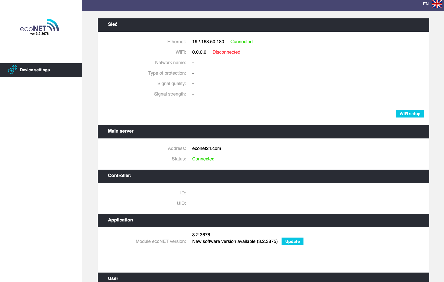

  • #584 21453239
    ppsirius
    Posts: 23
    Successfully installed gui: apk add luci. Firmware recovery does not have gui in defaults.
    I uploaded the bin from post #96 went force update but I am no longer able to get on 192.168.1.1
    Should I do something else before, or maybe some other ip?
    On the router only power is lit up no communication can be seen
  • #585 21453739
    SławekSS
    Posts: 726
    Help: 34
    Rate: 80
    ppsirius wrote:
    I uploaded the bin from post #96 went force update but I am no longer able to get into 192.168.1.1
    the ip address is the one the router assigned, because econet is not a router but a terminal device
    It will definitely not be xxx.xxx.1.1

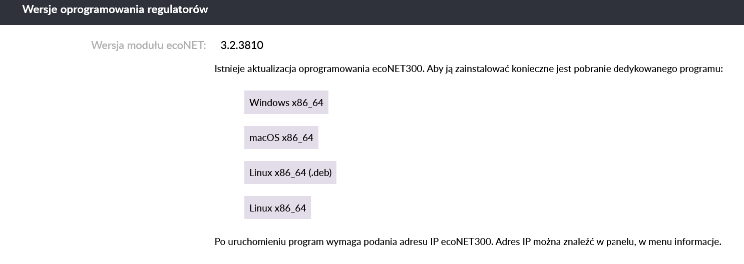

  • #589 21453896
    SławekSS
    Posts: 726
    Help: 34
    Rate: 80
    I have 3.2.3810, the next update is already done differently and is only available from the econet24 website.
    Screenshot showing ecoNET software version and update instructions. .
    I have not done this

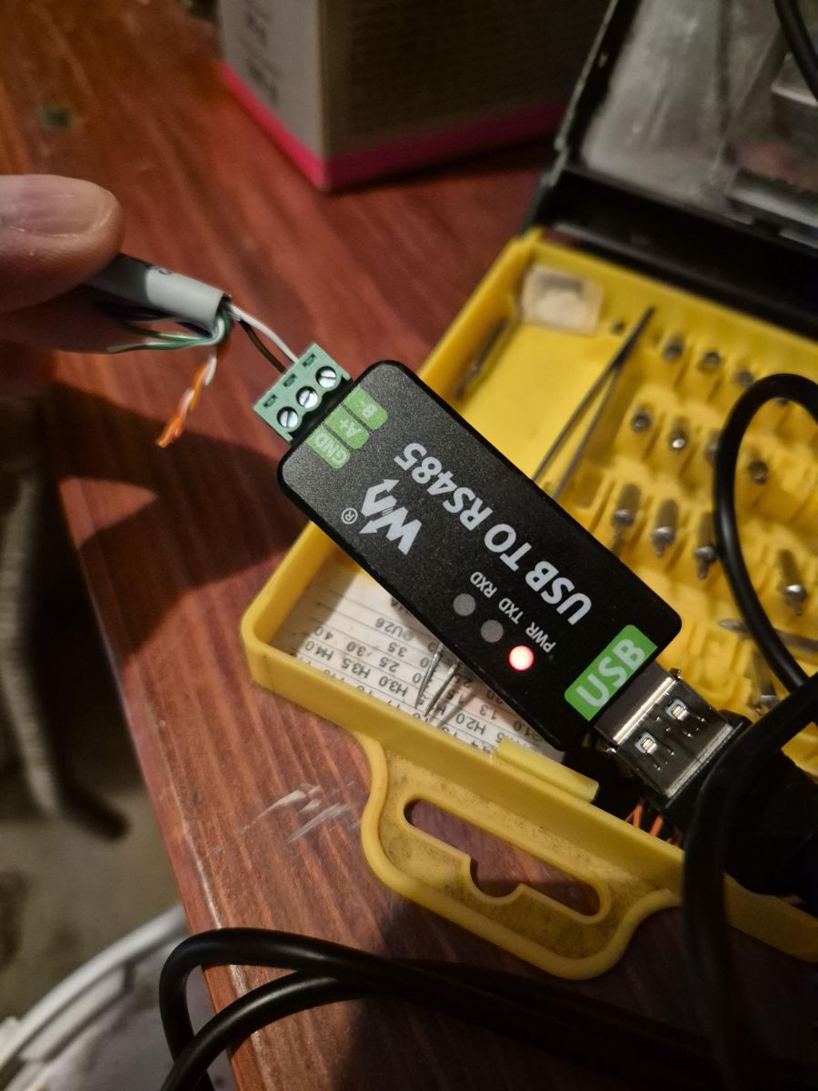

  • #598 21524069
    ppsirius
    Posts: 23
    After connecting the RS-485 during startup, all the lights flash for a while, but then only the PWR is lit. I have connected the 2 cables to the centre RJ pins, I have also tried changing the cables, but still no communication.
    Screenshot of ecoNET control panel showing Wi-Fi connection and missing controller connection. .
    USB to RS485 adapter connected to wires, with visible red PWR LED indicator. .
  • #599 21524165
    SławekSS
    Posts: 726
    Help: 34
    Rate: 80
    As such, Econeta only has drivers for the USB rs485 converter based on the ftdi chip.
