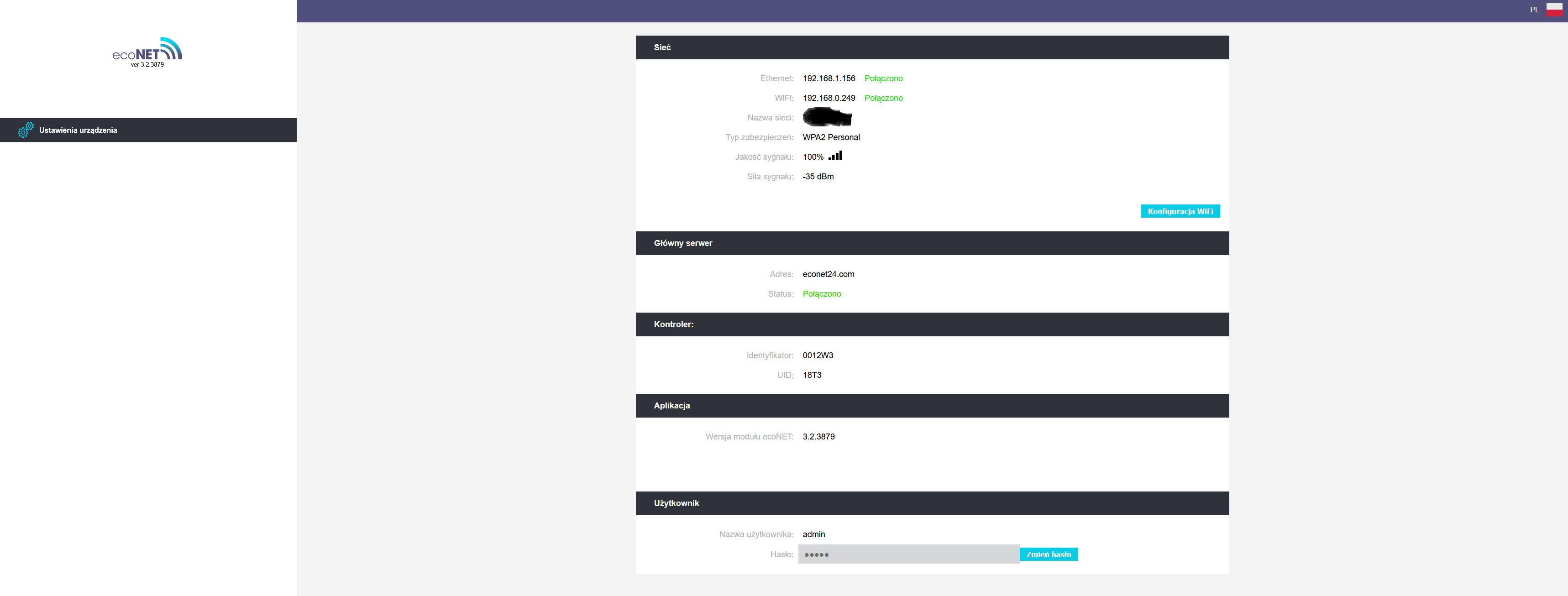

    Hi, does anyone know if the EcoMAXX800 R2 controller is compatible with ecoNet300?
    I'm asking because I've embraced an EcoNeta300 clone on an MR3020 V3.2. I've connected it to the local network and it works cool and over LAN and over WiFi, but unfortunately it doesn't generate the correct UID. On the EcoNeta configuration page in the browser on the PC it shows a UID of only 4 characters, above the ID of 6 characters and that's it. In the control panel next to the controller in the information there are two tabs with information about the status of the connection to the network and to the PLUMa server, but there is no UID anywhere.
    I have the converter on the FTDI FT232RL. The LEDs on the MR3020 are on.
    I have the software in EcoNet300 with 3.2.3875
    Software versions:
    Panel V.01.20.22.A1
    Module A V.01.31.23.G1
    I have the adapter plugged into D and D- on the G1 connector, where the panel is.

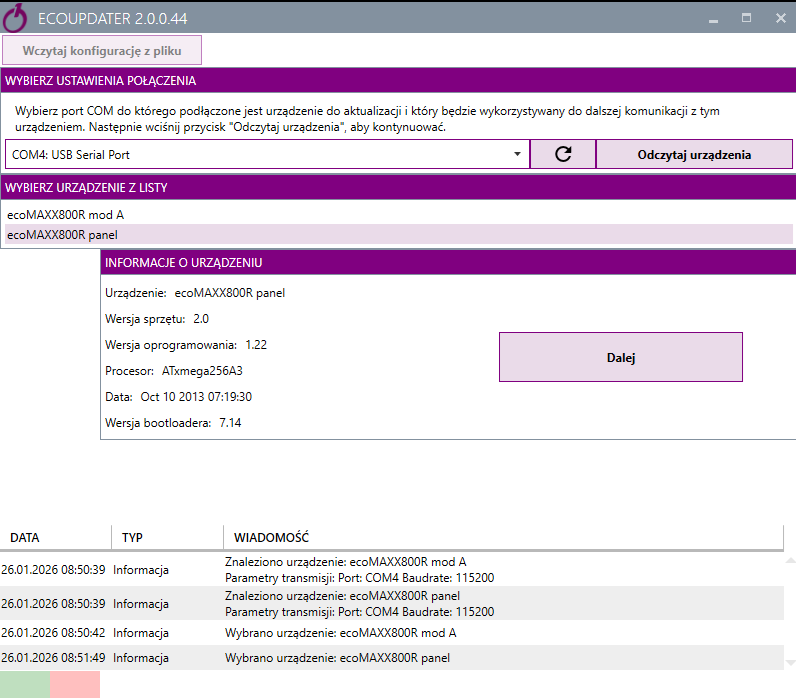

  • EcoMAXX800R2 may not generate the UID

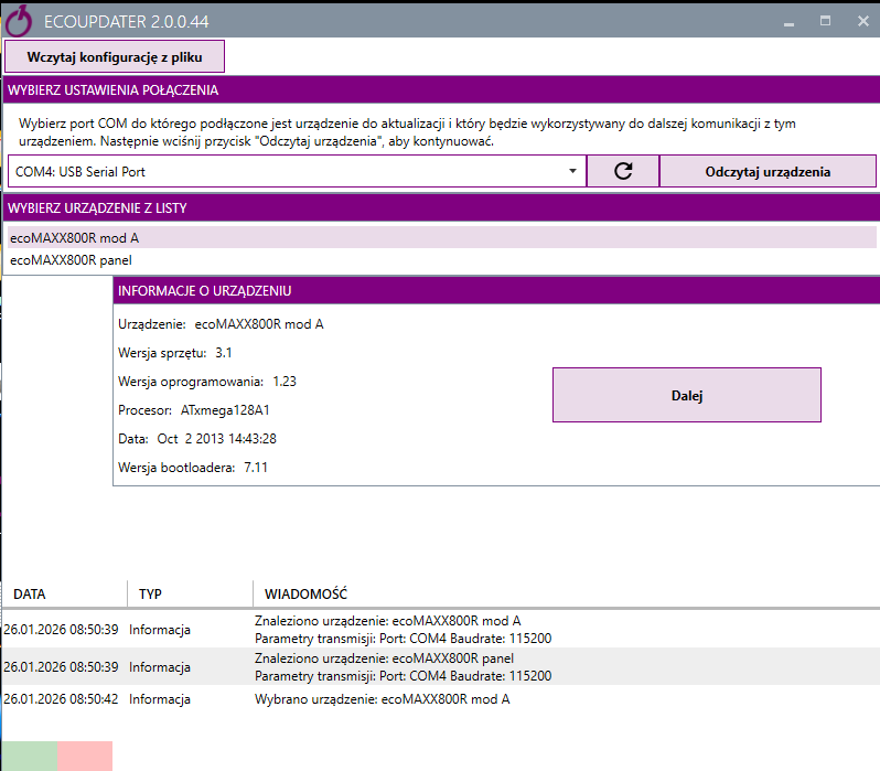

    #667 21816398
    jedrzejmichalak
    Checked: with reverse connection, there is no communication at all.
    and is there anyone on the forum whose EcoMAXX800R2 works with Econet300 and EcoLink2?
    I'm wondering if this version of ecomax will generate the UID, I'm running out of ideas already and I've already spent so much time on this that it would be a shame to let it go at this point.
    The FTDI adapter is connected fine, this is confirmed by the fact that when I connect the ecomax to the PC via the ftdi adapter the ecoupdater program reads the driver and panel information correctly, I upload the screenshots
    Screenshot of ECOUPDATER showing ecoMAXX800R device info and communication log Screenshot of EcoUpdater showing COM4 selected and device info for ecoMAXX800R ecoNET device settings page showing network, server, controller ID and UID

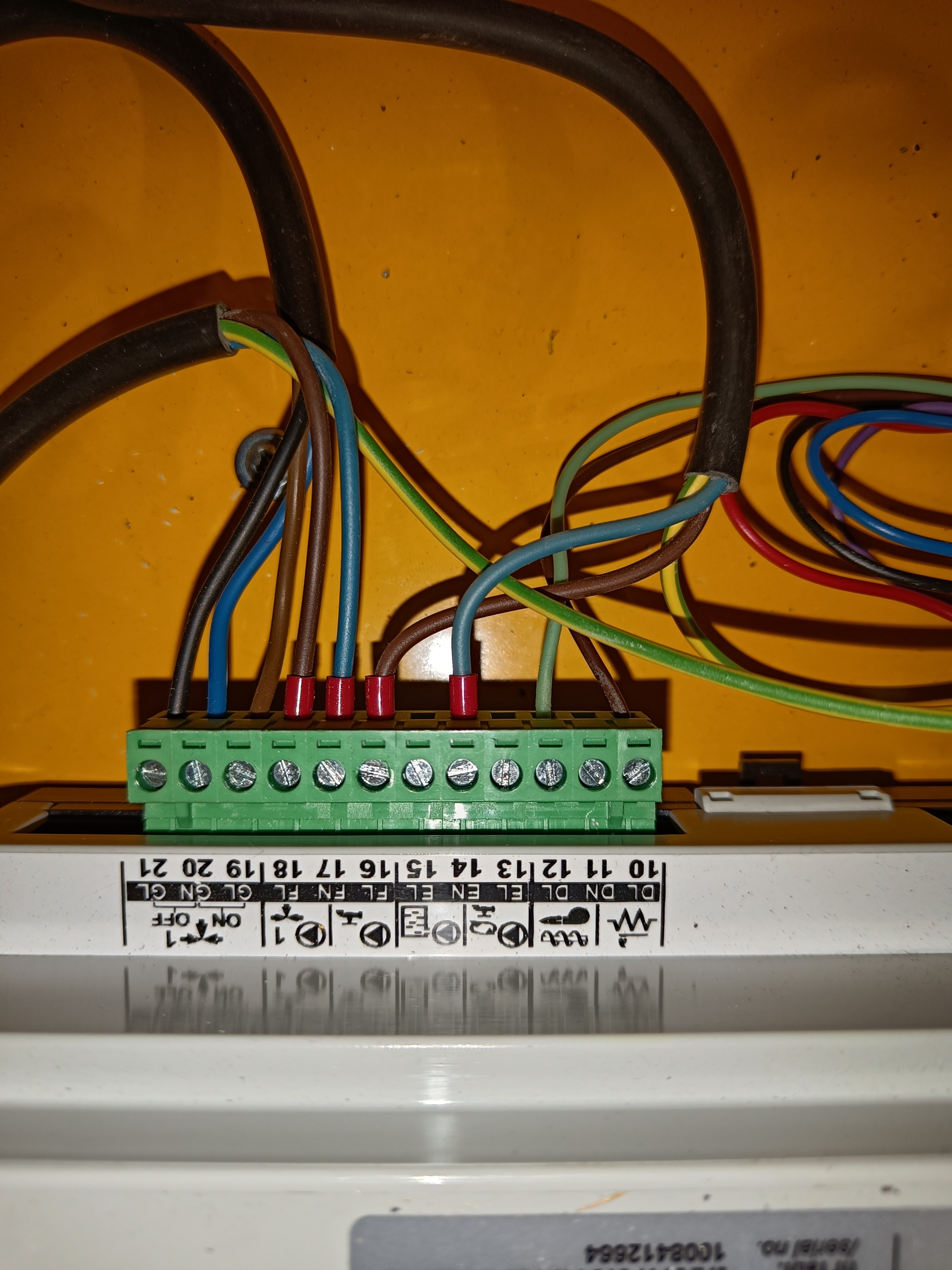

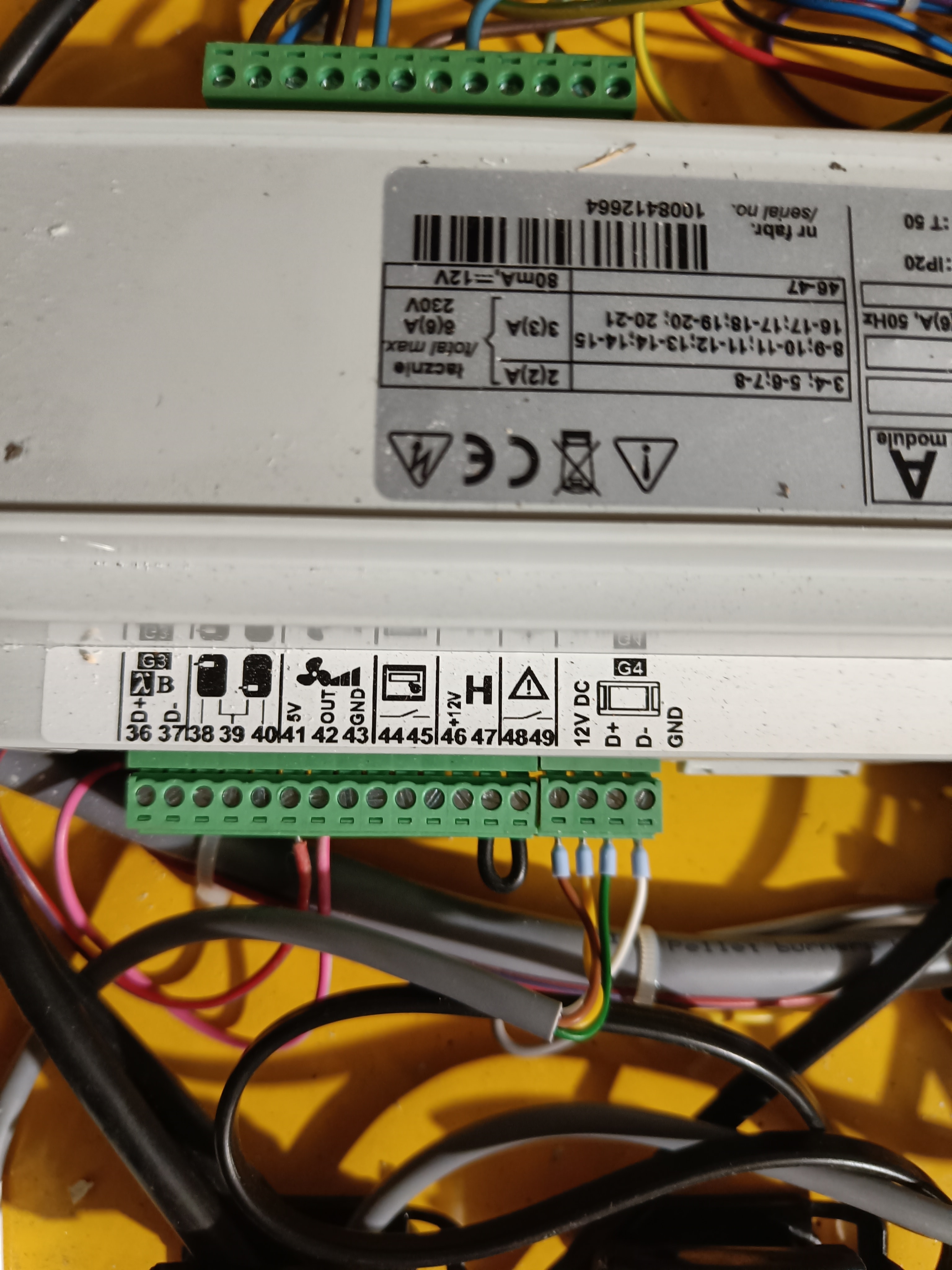

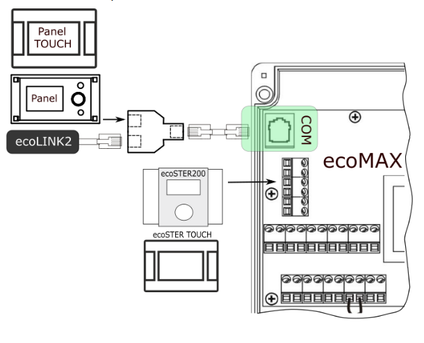

  • #668 21823111
    pawlus1841
    Good morning. I made myself an econet clone. I wanted to connect to the cooker and found that I have nowhere to connect it😃. I have a room thermostat connected. Does this mean I need to buy a B module still?
    • Internet module ecoNet 300 and ecoLINK2 IMG20260129110818.jpg (2.38 MB) You must be logged in to download this attachment.
    • Internet module ecoNet 300 and ecoLINK2 IMG20260129110820.jpg (2.29 MB) You must be logged in to download this attachment.
    • Internet module ecoNet 300 and ecoLINK2 IMG20260129110830.jpg (2.6 MB) You must be logged in to download this attachment.
    • Internet module ecoNet 300 and ecoLINK2 IMG20260129110833.jpg (2.93 MB) You must be logged in to download this attachment.
  • #669 21823113
    SławekSS
    Posts: 726
    Help: 34
    Rate: 80
    you want them to help you and you sell images for points.
  • #670 21823114
    pawlus1841
    Sorry, I thought it was the file numbering. I have already changed
    Edit. okay now i know, i need this EL2adapter yes ?
  • #671 21823128
    SławekSS
    Posts: 726
    Help: 34
    Rate: 80
    connect under the G2 socket in parallel with the panel. You will need an RJ11 connector/adapter
    Diagram showing control panels connected to ecoMAX via COM port and RJ11 adapter
    Your G2 is in the image of COM
  • #672 21823145
    Pisklak1977
    Posts: 58
    Rate: 10
    >>21823111
    Connect this in parallel to Econet via usb->rs485 to D+ and D-
    Or as Slawek described via rj tee

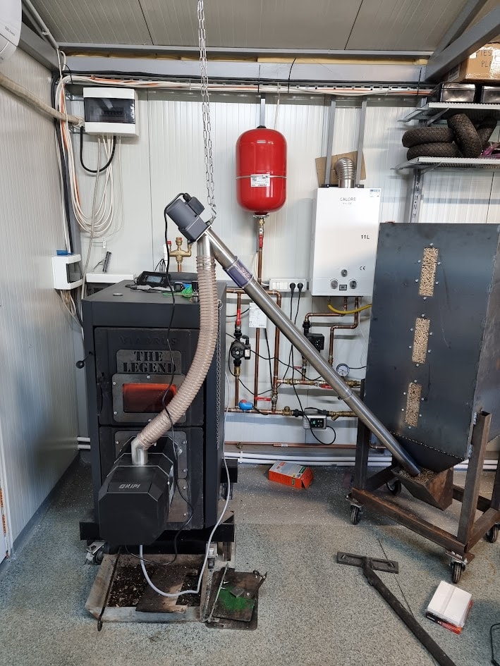

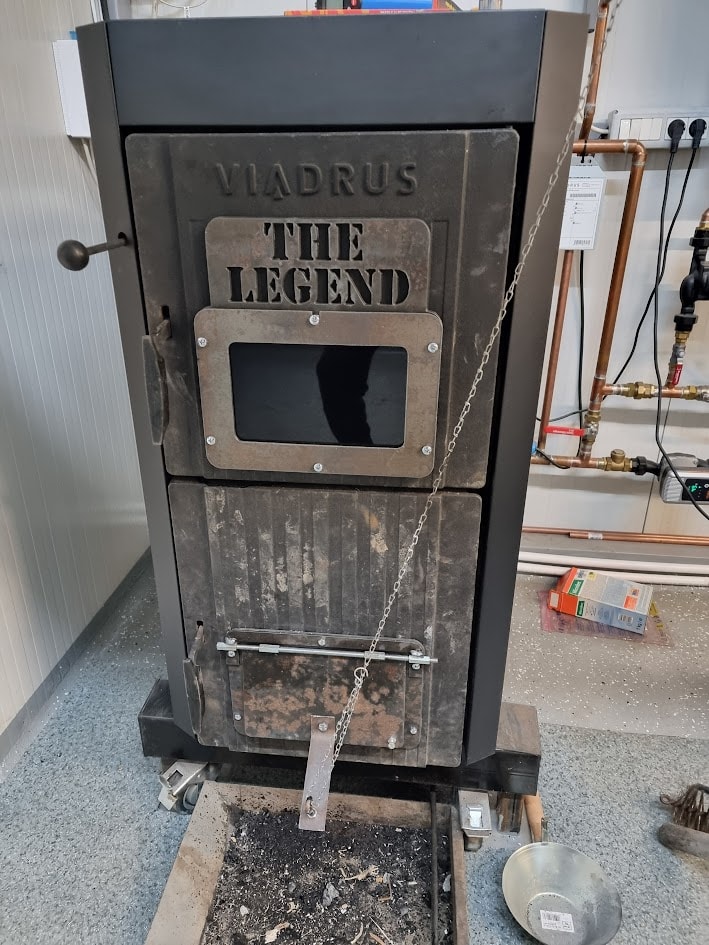

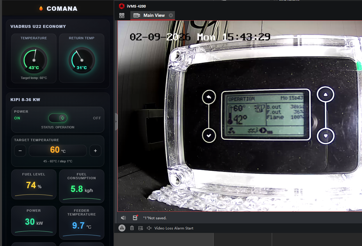

  • Raspberry Pi app controls ecoMAX920P1-K via RS485
    #673 21833846
    razvans
    Hello guys,
    Thank you for all the info on this thread.
    I want to show you a little project I have been working on.
    With the help of https://github.com/denpamusic/PyPlumIO and my knowledge as a programmer I made myself a mobile app that controls my Viadrus U22 Ecomomy + Kipi 8 - 36 kW (ecoMAX920P1-K controller).
    I used a raspberry pi + usb to rs485 (waveshare) and it works very well. It is still work in progress. I will most likely make it opensource once its finished.

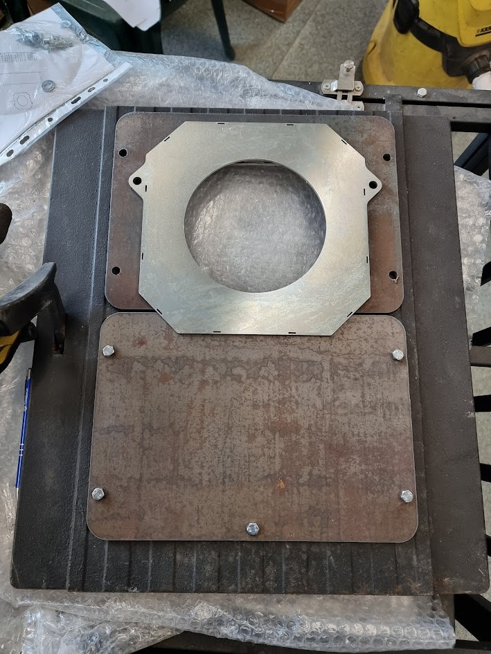

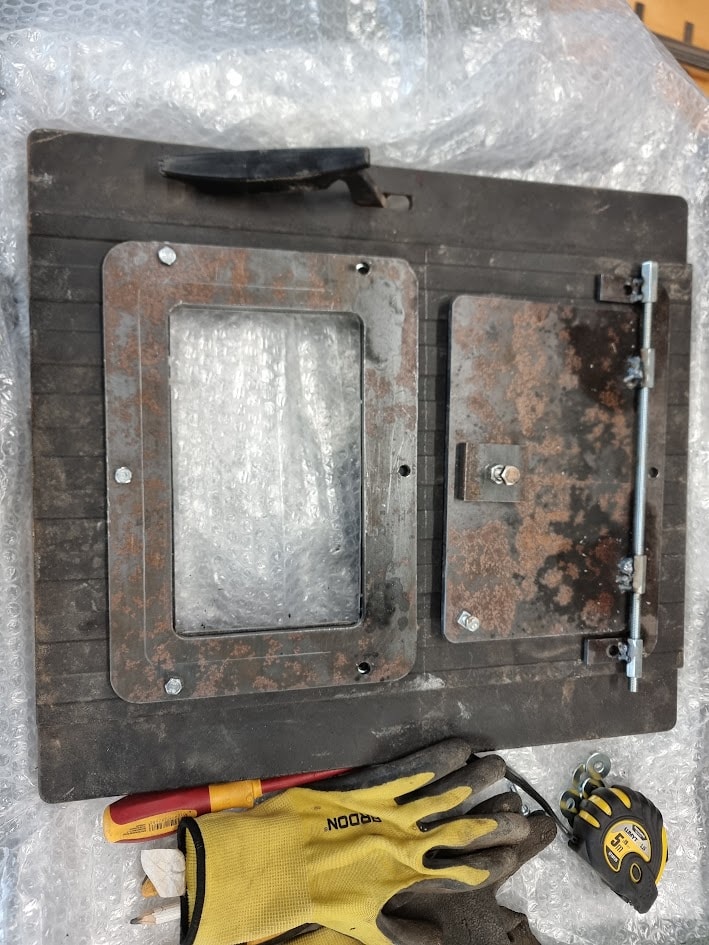

    About the Viadrus U22 Economy, I modified it with the air intake on the bottom door then added the pellet burner.
    In this way I can change from pellets to wood in 10 minutes by changing the flanges.
    • Internet module ecoNet 300 and ecoLINK2 development1.png (219.76 KB) You must be logged in to download this attachment.
    • Internet module ecoNet 300 and ecoLINK2 viadrus5.jpg (186.24 KB) You must be logged in to download this attachment.
    • Internet module ecoNet 300 and ecoLINK2 viadrus3.jpg (216.56 KB) You must be logged in to download this attachment.
    • Internet module ecoNet 300 and ecoLINK2 viadrus4.jpg (163.35 KB) You must be logged in to download this attachment.
    • Internet module ecoNet 300 and ecoLINK2 viadrus2.jpg (189.17 KB) You must be logged in to download this attachment.
    • Internet module ecoNet 300 and ecoLINK2 viadrus1.jpg (172.94 KB) You must be logged in to download this attachment.
    • Internet module ecoNet 300 and ecoLINK2 development.png (934.12 KB) You must be logged in to download this attachment.

  • #675 21836652
    razvans
    thank you.
    here's a very cold start/stop from 35 km away

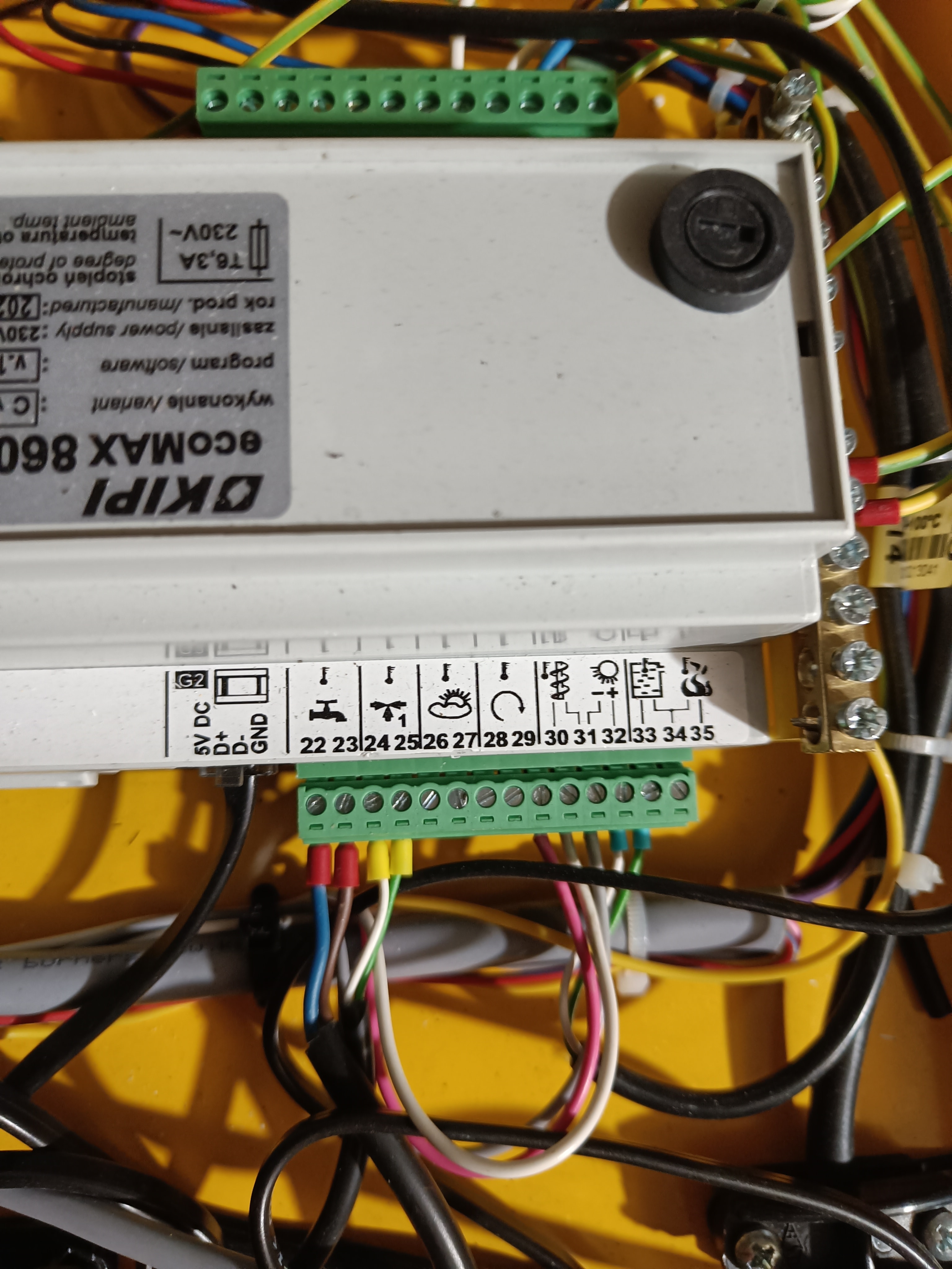

  • ESP32 RS485 sniffing for ecoMAX 850 integration
    #683 21902724
    apollogz1000

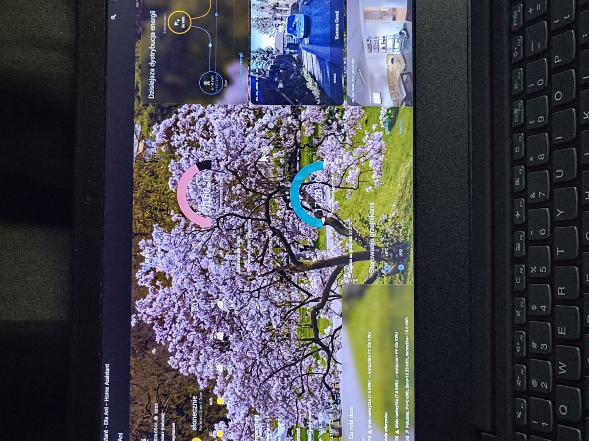

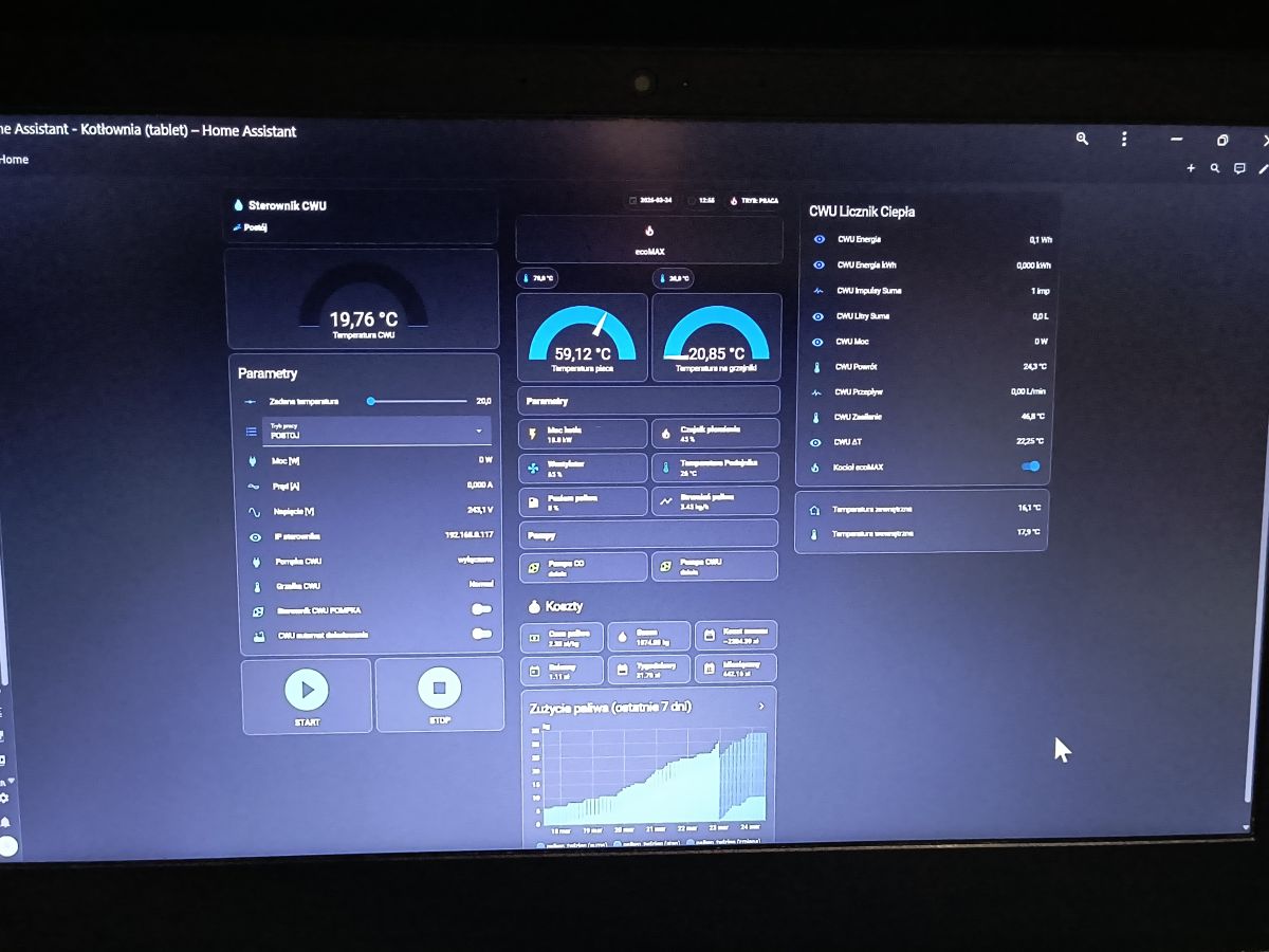

    A year ago I bought a house that had a central heating furnace with a KIPI burner fitted and an ecoMAX 850P2 - C furnace controller. There was a TP-Link router hanging on the cable (original cable) at the controller, but without any Plum markings, so that I don't know if it is the econet 300 original or a regular TP-Link. The login and password for the ecoMax controller was the factory one, ie admin, admin, so I set up my wi-fi and was able to log into the controller locally inside the network. I installed the Plum econet 24 app on my phone but also had a problem such that my device had a locked status. I tried calling Plum and sending emails because I wanted a working device, but without any response from the manufacturer, either by phone or email. Pissed off at Plum, I decided to somehow read the transmission myself, after all I could access the controller via http locally, as I wanted to integrate the ecoMAX 850 into the HA I was installing for myself at home. And I succeeded, I have integrated the furnace controller locally via wi-fi with Home Adjutant and I was able to view the data in real time and control the furnace from the HA locally without internet and without the manufacturer's app, a fantastic thing. But one day the TP-Link died and now I was left with a choice, buy a new econet 300 for £800 or control the appliance by connecting to the RS485 bus. I already have an ESP 32 connected via a Max485 converter to an ecoMAX 850 and I can see some frames, but it's completely different to what I had before and I can see the huge amount of work ahead of me to read what I see on the rs485 bus to restore integration with the HA.
    I would very much appreciate any help to shorten my work. Maybe someone has read frames from the rs485.
    I for my part can help integrate ecoMAX - with HA, I will show how I solved it. My integration showed all the parameters of the burner, CH, DHW temperature, mixer, feeder, fuel consumption, blower operation, flame sensor, pump operation, everything Plum provides. In addition, I was able to control the furnace, i.e. switch the controller on/off, set the desired temperature of the CH, DHW, mixer and all this locally without the manufacturer's cloud. I'm uploading a couple of pics of what it looks like at my place.

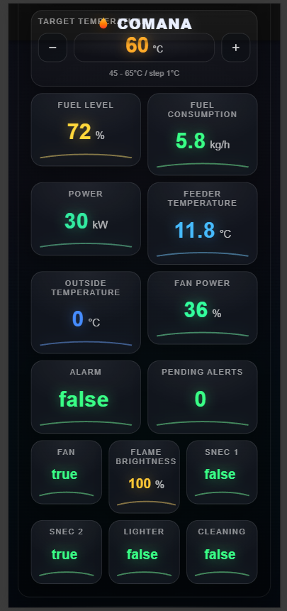

  • Raspberry Pi RS485 link to ecoMAX 860P6
    #686 21928141
    ebol
    Posts: 15
    Rate: 14

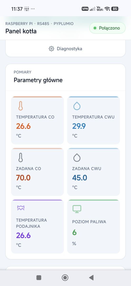

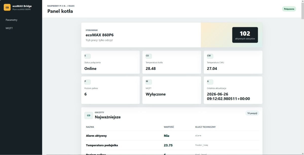

    Hello. As there’s now a light at the end of the tunnel, here’s a quick post on a topic I still need to fine-tune. I’ve managed to get the Raspberry Pi 3 B+ + FTDI USB-RS485 + Plum ecoMAX 860P6 working together. This allows me to view (for now, at least) what I believe to be all the boiler’s parameters locally, and to set up an MQTT bridge to HA or another broker. As soon as I find some more time, I’ll finish the project and post the results.
    Screenshot of the “ecoMAX Bridge” dashboard with tiles showing ecoMAX 860P6 boiler parameters and Connected status

    #688 21929727
    ebol
    Posts: 15
    Rate: 14

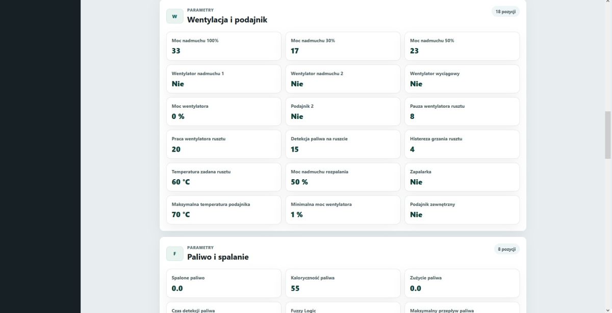

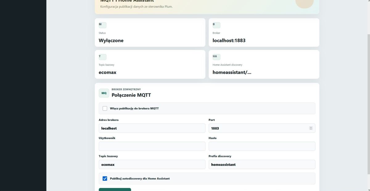

    Hello again. It’s time to publish my ramblings on the Ecomax bridge. The code is based on the Plum.io libraries, so any drivers that work with those libraries should work here too (you’ll just need to make an optional name change in the configuration file). As for the hardware, a standard Raspberry Pi Zero, an OTG adapter and a CH340 should suffice (most of the popular USB/RS485 converters should work, apart from dedicated HATs – those don’t work). As for the control functions, they’re limited to switching the boiler on and off, but they can be expanded fairly easily. The programme was created using Codex and Cursor, so please use it with care, given the damage it could potentially cause. The full manual, including the commands, is included in the package. It would be great if the community could take this little project further.
    • PLUM BRIDGE.zip (40.44 KB) You must be logged in to download this attachment.
