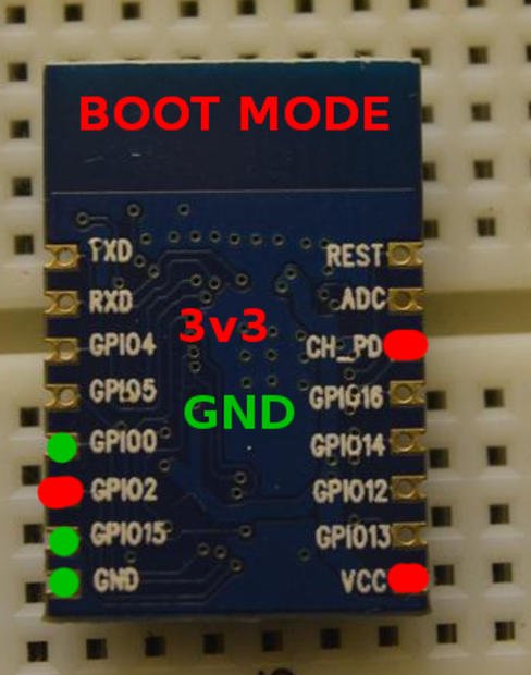

    I have a question about the ESP12-E module and specifically about this one and not another e.g. ESP12.
    How to connect GPIO15 GPIO2 GPIO0 in order to:
    1. to upload the soft to flash
    2. to communicate via the UART from ESplorer
    And what is the baud rate?

    bartosz.tarnowski wrote:
    I have a question about the ESP12-E module and specifically about this module and not another e.g. ESP12.
    They all work in the same way.
    How to connect GPIO15 GPIO2 GPIO0 to:
    1. upload the flash soft
    [ESP8266] How to connect GPIO15, GPIO2, GPIO0 in ESP-12-E for flashing and UART? .
    2. To communicate via UART from ESplorer
    115200

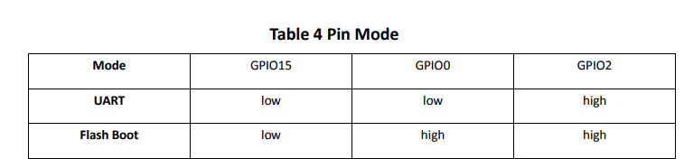

    #3 16611108
    bartosz.tarnowski
    Posts: 418
    Help: 26
    Rate: 30
    but not the other way round?
    Page 9 of the documentation https://www.elecrow.com/download/ESP-12F.pdf
    says something different
    Today I uploaded the nodeMCU twice at 230400 speed.
    After uploading the Baud switched to 74880.
    But apart from the ESP reporting itself after the reset there is no response.
    I am currently unable to flash the ESP.
    Yesterday I had the same, overnight the ESP thought itself and today it was possible to reflash it but only 2 times.
    Can the other GPIOs hang unconnected.
    I am powering from USB so current capacity should be ok.

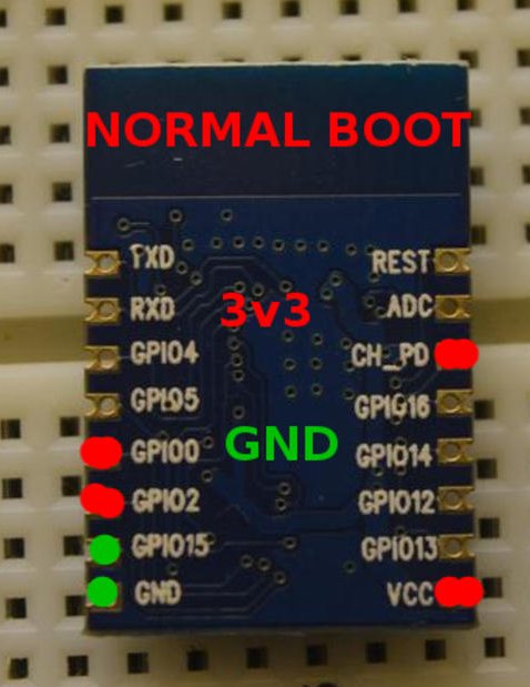

    This is what my circuit looks like [ESP8266] How to connect GPIO15, GPIO2, GPIO0 in ESP-12-E for flashing and UART?
  • #4 16612518
    krzbor
    Posts: 1783
    Help: 42
    Rate: 1072
    Rather not the other way around. "Flash boot" from the table means boot from flash memory, so it corresponds to "normal boot" from the picture above. I always recorded in 115200 and it worked. Note - at startup, ESP always sends information with 74880 (this happens even before the program starts) and then switches to 115200. Of course, the speed can be changed later by software.
