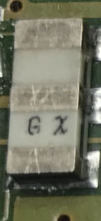

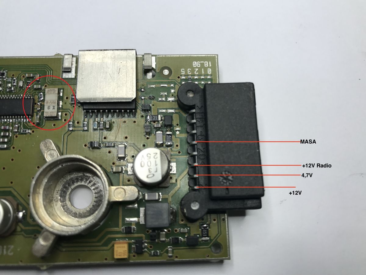

  • Requesting datasheet for unidentified SMD component
    #53 20714263
    zx10norte
    I everyone!!.
    I am afraid I have the same problem, with the remotes only. My Fm works perfect, at the moment....
    When I open my module, I can see a dark zone above a SMD component that I can't identify. Could you help me with the datasheet or any information about it?
    Close-up of an SMD component with GX marking on a circuit board.
    Printed circuit board with marked SMD component with dark area.
    Thank you

    >>20714263
    have you found out what element is this?
  • #59 20828828
    zx10norte
    Sadly not. Any help welcome
