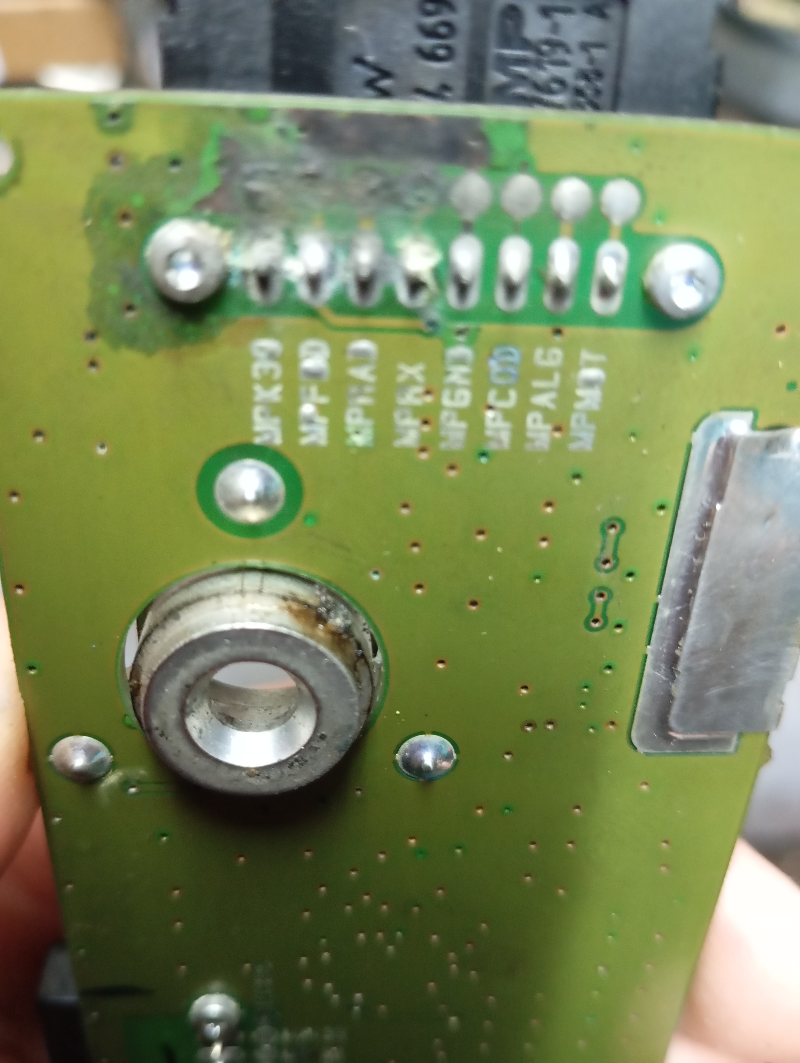

    Posts: 29
    Rate: 13
    Hello, can someone help me by pointing out where to make a bypass for the rotten pins 1, 2, 3 and 4? Many thanks in advance.Close-up of PCB with corroded area near pin headers and labeled signal names Close-up of a damaged green PCB with corrosion near connector and pins
    • DIY Repair Guide: BMW e61 Non-Operating Central Locks - Analyzing TDA 5210 System IMG_20251020_171401.jpg (2.17 MB) You must be logged in to download this attachment.
