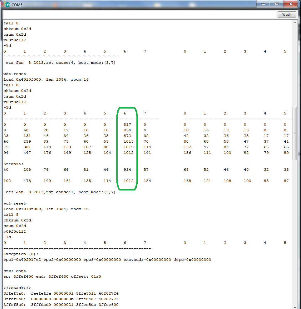

    I have 2 MCP3208 analog-to-digital converters connected to this ESP via SPI and an MCP1501-18E/SN reference voltage source.
    I get errors like this on the UART all the time. The typical "Blink "is working.

    edit: I found something like this:
    ets Jan 8 2013,rst cause:2, boot mode:( 3,7) <-- reboot by reset pin - Mode Flash (boot the sketch)
    I thought that since it's an all-in-one board there was no need to connect the "CH_PD+RST" pin. Unfortunately nothing helps at my place.
    edit2: I think I found the culprit.
    https://techtutorialsx.com/2017/01/21/esp8266-watchdog-functions/
    The ESP has a "watchdog" that when it doesn't receive a signal, it resets the chip. It's software and hardware. Aha, cool. The problem with me is that it resets once immediately, sometimes after a long time. I try to disable it with these commands however unsuccessfully
    Interestingly, the ESP.wdtEnable(1000); function takes a time argument and doesn't use that - Chinese technical thought knocks it down.
    edit3:
    Sometimes it won't fire, I have to reset and plug it in again. But once it has counted on the UART it takes longer. Partial success, because it crashes and resets again. The program is 100% fine without memory leaks, as it worked perfectly on the Arduino. I only changed the pin names to fit under ESP. Then I wanted to add WiFi, but I can't manage it.

    Problem partially solved. I simply don't put the module all the way onto the contact plate, only half way up. Everything contacts and works. Apparently some stress (?) is created. Even re-soldering pins 2.54 didn't help. Strange.
