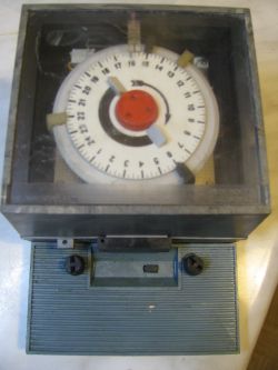

    How about something like this ? :D .

  • #14 16920561
    wnoto
    Posts: 3634
    Help: 58
    Rate: 744
    Board Language: polish
    How much does this miracle cost .... and how much can it fit in?

    The power of the 5 lamps will not exceed 50W. I was also thinking about such a mini detector which I could build in one of the lamps, except that the maximum range is 6m and the elevation is 20m. And converting each of the lamps is not an option.
    Such a mechanical timer can be drawn from a timer plugged into a socket :D .
