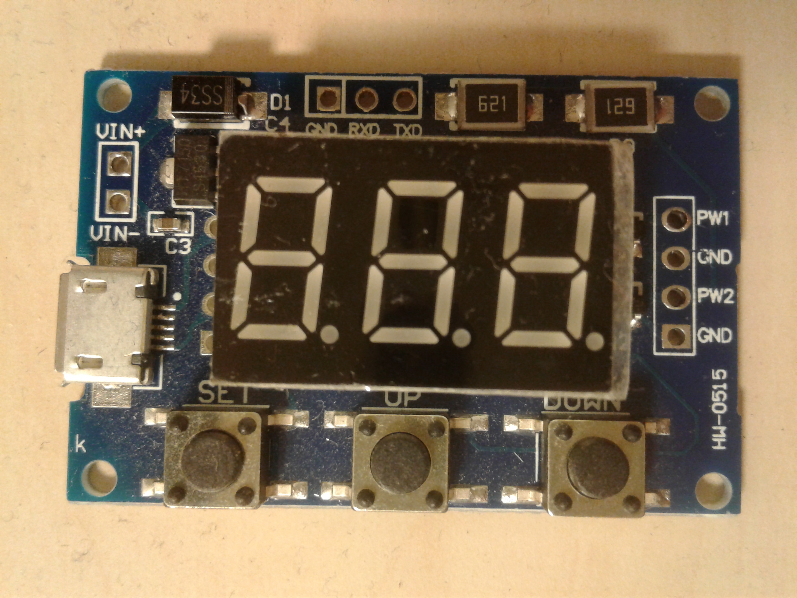

  • Hello.
    Below I present to you a description of a cheap two-channel rectangular signal generator with adjustable filling.
    Description of the two-channel square wave signal generator with LED display Description of the two-channel square wave signal generator with LED display
    Prices in China start from about $ 1.7 with shipping, in Poland from about PLN 29 with shipping.
    The system is sold as a ready-made set, but you would have to solder the goldpin pins to be able to use it without any problems.
    The generator has a 3-digit, seven-segment display, thanks to which you can set both the frequency from 1Hz to 150kHzm and the duty cycle from 0-100% using three buttons ("SET", "UP", "DOWN").
    The generator can be powered in two ways - by means of a cable with a micro USB type B plug with voltage of 5V or by means of pins on the board described as VIN +, VIN-. According to the manufacturer's information, the module can be powered with a voltage from 5 to 30VDC, but on the board we can find the HT7150 stabilizer, where, according to the documentation, its maximum input voltage is 24V, so I do not advise you to power the VIN + and VIN- pins with a higher voltage, as this may damage the system. The generator's maximum output current is 30mA.
    The manufacturer states that the accuracy is +/- 2% and it actually agrees - it can be seen that the higher the frequency, the greater the error, but it does not exceed the declared value.
    The amplitude at the output is 5V, regardless of whether the module is powered from 5V or 24V.
    Most likely, this generator is based on some kind of microcontroller. There is an integrated circuit in the SOP20 housing under the display.
    Both generator channels work simultaneously. The frequency and pitch of both channels are set using the three buttons as follows.

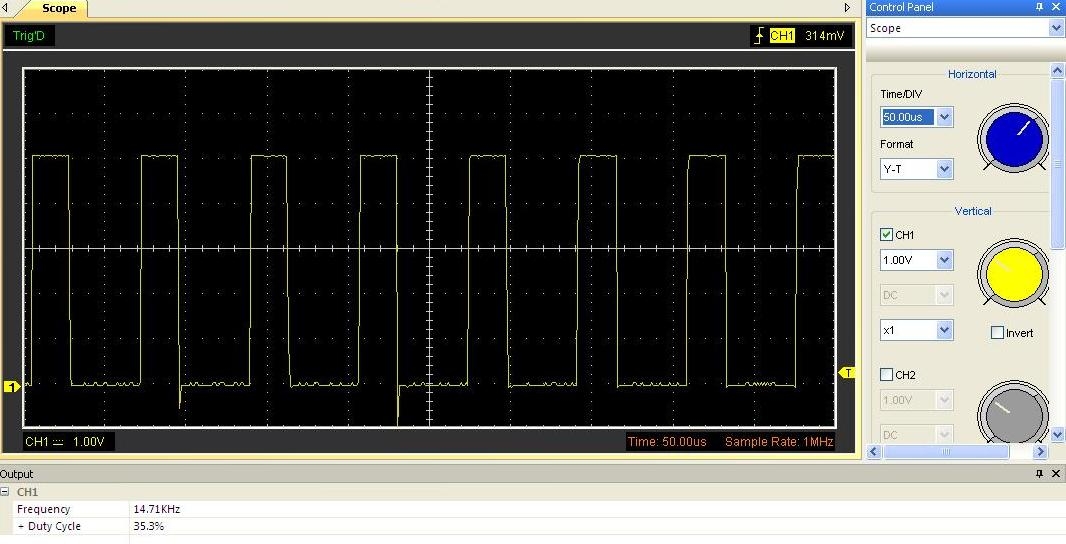

    Below are some waveforms from this generator.

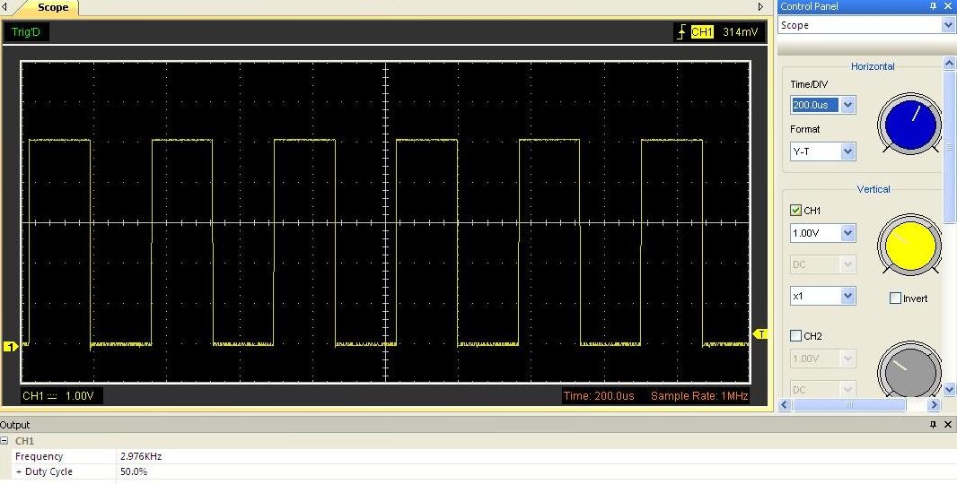

    3kHz, 50%

    15kHz, 35%

    Above 1kHz the generated signal starts to be distorted, which can be seen in the above waveforms. Both channels are affected by this problem.

    Dimensions: 44 x 29 x 9mm.

    With which program / snap-in were the uploaded waveforms collected?
  • #5 16987751
    grala1
    VAG group specialist
    Posts: 9816
    Help: 1495
    Rate: 5049
    Hantek 6022.
