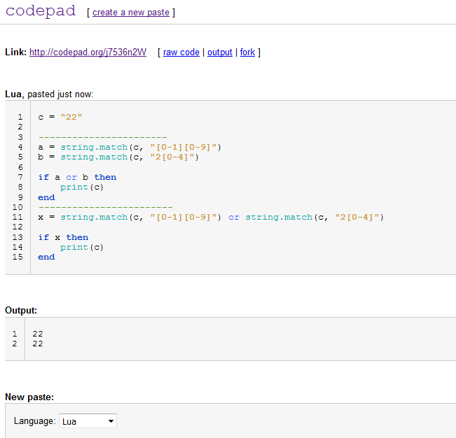

In Lua, you cannot use a single POSIX-style regex alternation for this, so you need to test the hour with two separate patterns. Use `[0-1][0-9]` for 00–19 and `[2][0-3]` for 20–23, then combine them with `string.match(c, reg1) or string.match(c, reg2)` [#16983853] If you only want to validate the hour part, remove the `:[0-5][0-9]` minute portion from the pattern, because that example was also checking minutes [#16983472][#16983585]

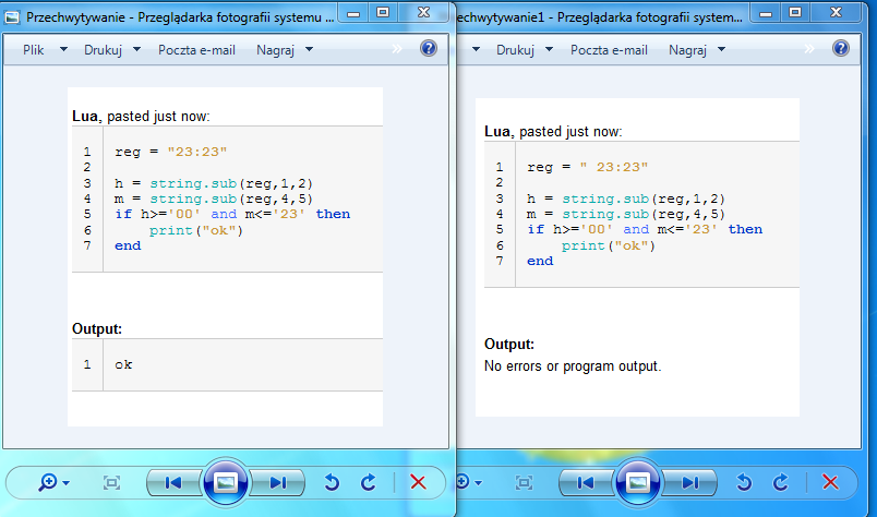

    I am looking for the simplest method to check if the first two digits correspond to the 24 hour time format. At the moment I check the first two digits this way, but I would like to do it more simply. Is it possible to do the same with just a regex expression?
    Code: Lua

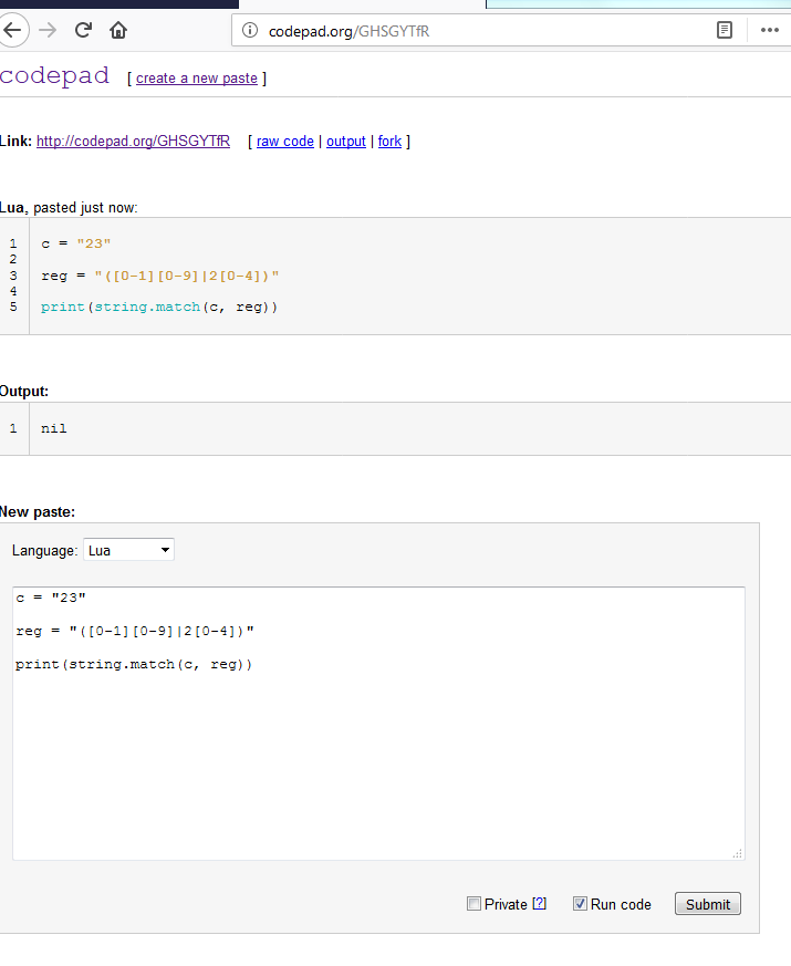

    drobok wrote:
    ([0-1][0-9]|2[0-4]):[0-5][0-9]
    In the code tester it does not want to work.

    drobok wrote:
    Because note that there you are also testing if the minutes
    This is also what I did in the example above, but it doesn't work.
    #6 16983853
  • #7 16984779
    czasnagli
    Posts: 684
    Help: 19
    Rate: 105
    drobok , now works thank you for your help.

    I sympathise with 'non-regex' solutions in many situations.
    (a) firstly, sometimes the cost of regexes can't be ignored. It's fun to write, but the library has a lot of work to do. Regular expressions are popular, but 'simplest' is not always the most efficient.
    (b) secondly, often the second phase is to use the data, and sooner or later some form of parsing the data WITHIN the data comes up. E.g. whether <24 and <59. One can work oneself up to the elbows for pure sport (it is possible to write such an expression - it will be huge, who knows how to preserve it).
    Often a mini-parser is the correct solution, and many of them cost a minimal amount of CPU and very often no RAM at all. It does two things: it confirms correctness and uses the data.

    JacekCz wrote:
    My personal version would go like this
    Thank you for the suggested solution, but in my case a regular expression would work better as the start of the hour may have a different position in the string.
