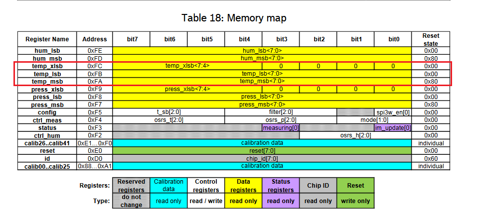

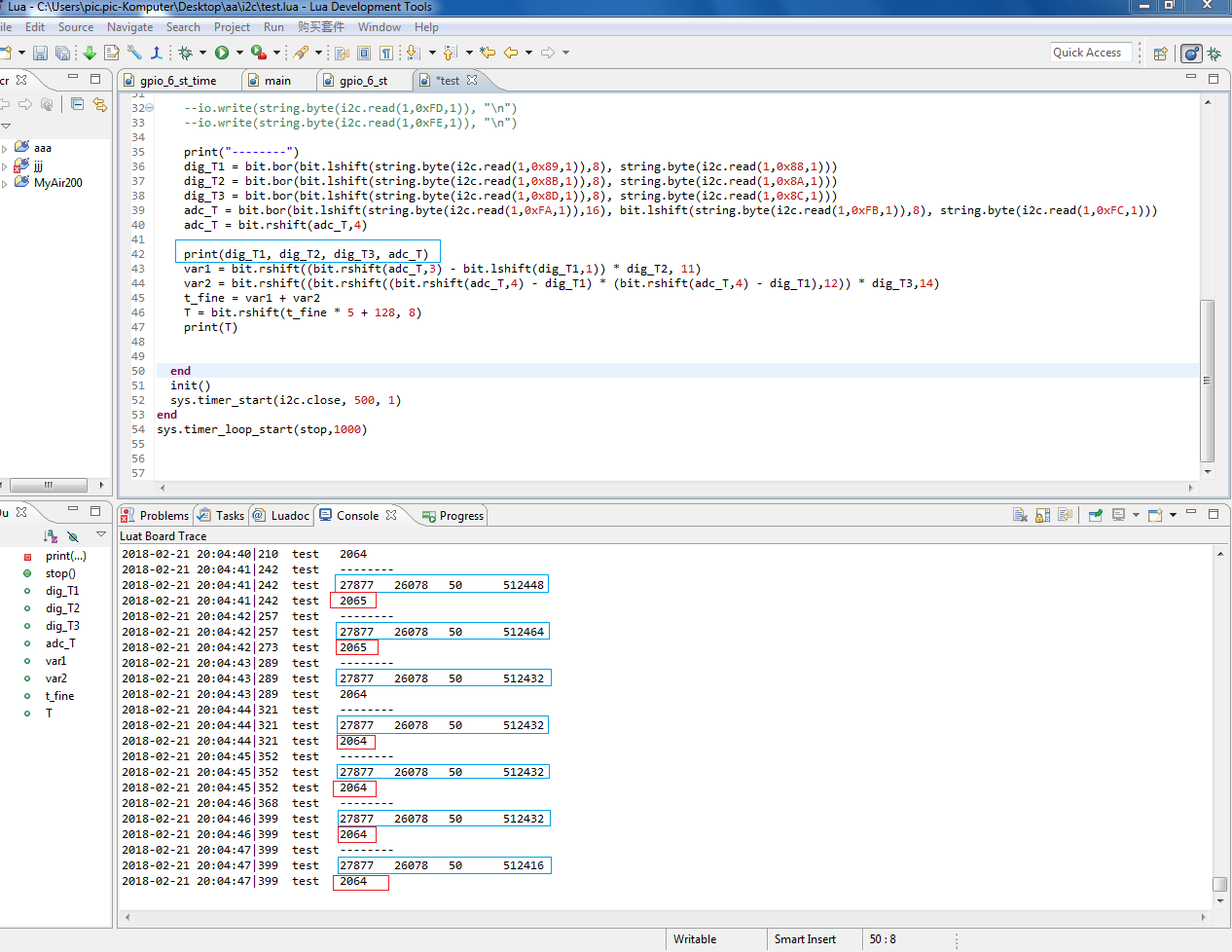

    I want to read the temperature from the BME280 in a lua script. In datasheets I read that the temperature is stored at 0xFA , 0xFB and 0xFC .
    [lua] BME280 - How to correctly read the temperature from registers 0xFA-0xFC? .
    After reading these addresses with the command
    Code: Lua
    I received 128 , 0 and 0 respectively.
    Code: Lua
    I know that the read value 128 is not the temperature. I therefore have a question. How is the temperature read out?

    And do you specify the device address somewhere in your code ? As a rule, the BME280 can have two different addresses (0x77 and 0x76) depending on the configuration. Although in most cases "Chinese" boards with this module are prepared in such a way that they have the address 0x76 probably
    Added after 3 [minutes]:
    Also, I can't remember exactly but I think you have to write something to one of the config registers before the first read to determine the sensor mode. Check the documentation...

    chemik22 , I set the bits like you and I can already read the temperature from address 0xFA and 0xFB . From address 0xFC the temperature reading is always 0.
    Furthermore, I noticed that the BME280 shows a temperature of 123 . This is as much as 7°C less than the temperature read at the same time from the room thermometer (19°C). Should the temperature reading 123 from 0xFA be corrected or converted to °C? If I touch the sensor on the BME280 with my hand the temperature rises, but very slowly. From this I conclude that the thermometer is working, but the value of the temperature reading is not correct.

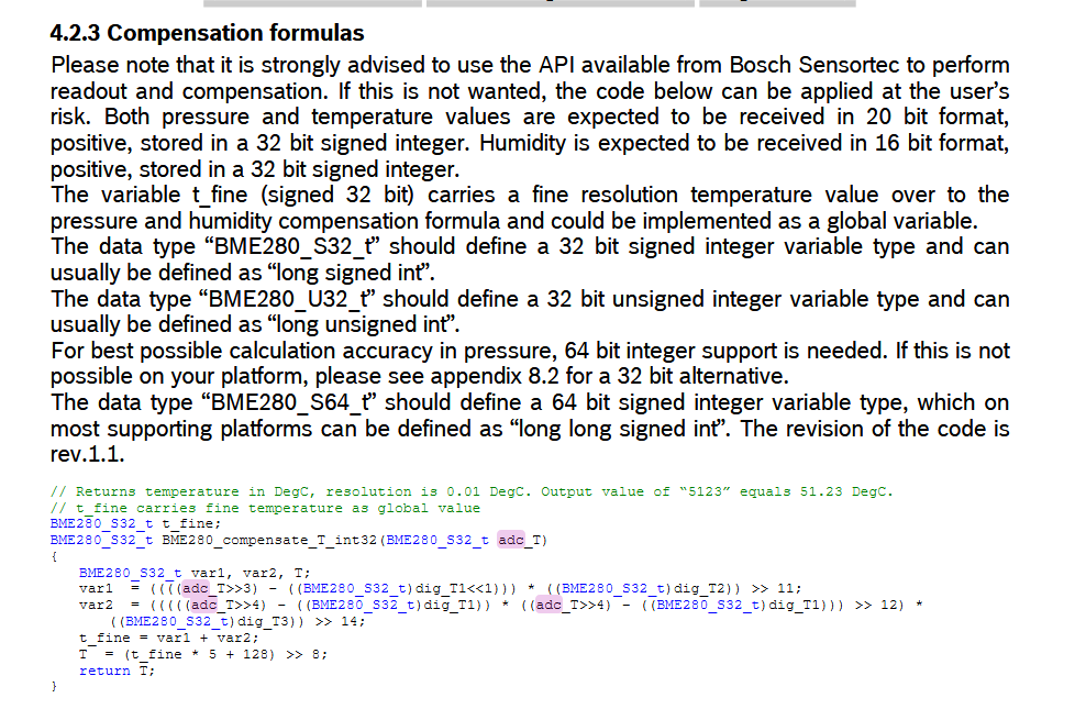

    chemik22 wrote:
    You have the entire algorithm in the documentation: https://cdn-shop.adafruit.com/datasheets/BST-BME280 DS001-10.pdf
    On page 23 it says how to convert it.
    I will then use the example on page 23 to calculate the temperature. The temperature dig_T1 , dig_T2 and dig_T3 I read from the addresses:
    - dig_T1 = 0x88/0x89,
    - dig_T2 = 0x8A/0x8B,
    - dig_T3 = 0x8C/0x8D
    You will also need the value adc_T for the calculation. Can you suggest where to read the value adc_T ?

    The adc_T is your value read from the 0xFA-FC registers but written together as a 24bit number. I'll give you here a snippet of my old code I found that implemented these equations for the AVR. I think you should find it relatively easy to make a translation for your needs:
    Code: C / C++
    Added after 6 [minutes]:
    And one more thing. These dig_T1 etc values are calibration data. You can safely read them once in the terminal and enter them openly. They are set once at the production stage of the device and do not change. I even remember somewhere on the internet that they were stated as "usually".

    Based on what you have written I did as follows. From the address 0x88 and . 0x89 I read the value of dig_T1 .
    Code: Lua
    I then added up the values from address 0x88 and 0x89 .
    Code: Lua
    After summing the value dig_T1 = 11101101 .
    Did I correctly calculate the calibration value dig_T1 ?
    In your example there is also a bit shift <<8 , but I did not do it.
    All the calibration values for temperature that I have read look like this.
    Code: Lua
  • #10 17044031

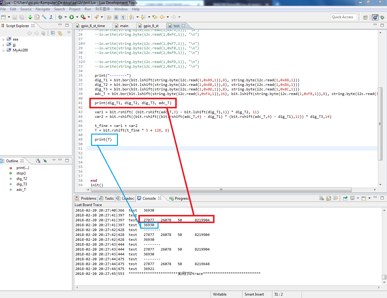

    I have calculated the dig_T1/2/3 values.
    Code: Lua
    Same values from BMP280-Arduino-Library https://github.com/mahfuz195/BMP280-Arduino-Library/blob/master/BMP280.cpp
    Code: Lua
    My readout calibration values for temperature.
    Code: Lua
    Why does my calibration value for dig_T3 (50) differ so much from the dig_T3 = -1000.0 from the arduino library?
    EDIT: .
    Do we combine the read 8 bit temperature values into a 24 bit number in that order?
    Code: Lua

    I have mastered the bit shifts and values dig_T1 , dig_T2 , dig_T3 and adc_T while the programme is running are calculated correctly. However, the calculated temperature value T is not correct (36930). I have marked the temperature T with a blue box. The calculations for var1, var2, t_fine and T I did as shown below.

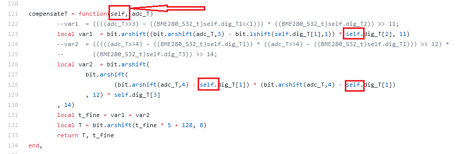

    I found on this page https://github.com/vsky279/BME280/blob/master/bme280.lua that an additional parameter self is used to calculate the temperature in the function. I calculated the final temperature T without using the additional function just based on the actions you see above. In your opinion, is it necessary to use a separate function with additional parament self to calculate the final temperature?
  • #18 17052604
    chemik22
    Posts: 115
    Help: 10
    Rate: 27
    Board Language: polish
    I would risk the extra self parameter. Or even copy what is alive on github. Certain things are such a "black box", perhaps there is a trick there without which you get a meaningless result.

    When calculating the value of adc_T only the reading from address 0xFA is taken into account. The address 0xFB and 0xFC is omitted.
    EDIT1: .
    After I warm up the sensor by hand and then let go of it, the calculated temperature goes from a 4 digit value to a 3 digit value and finally a 5 digit value. Doesn't any of the registers need to be cleared before or after reading the temperature?

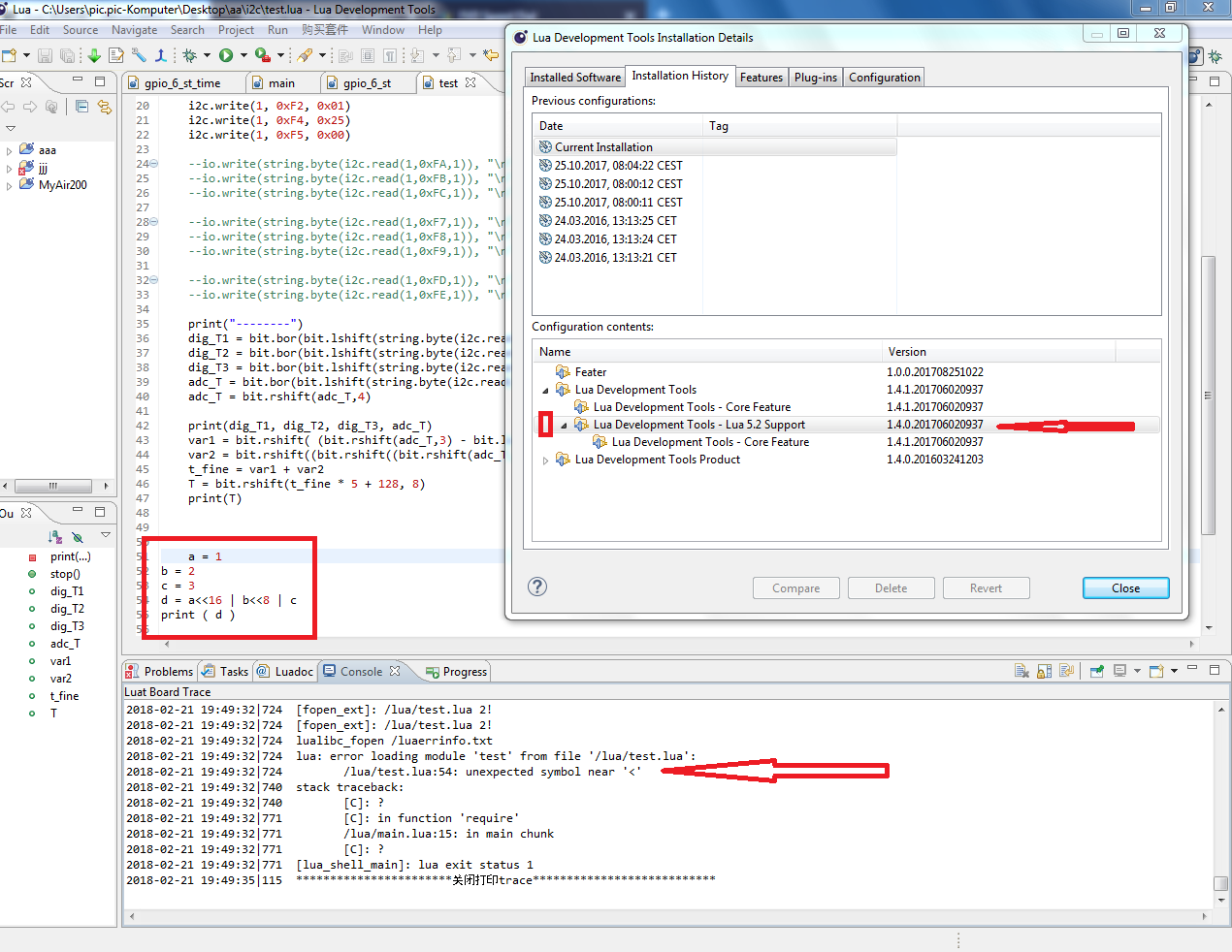

    I've done my homework.
    Code: Lua
    of which the result is
    which translates to
    Maybe let's not doctor ourselves on something that language has always provided. I'm a bit surprised that a library is being used for shifting.
    I'm rooting for it, but juz I can't read myself in this thread. It's hard to get results when nothing including arithmetic is certain
    Aha, that's the result from a PC. Lua 5.3 .
    In this version, the integer type appears (as opposed to the default numeric type usually implemented as double)
    #23 17053453

    The fact that they are zeros is hard for me to say if it matters but I certainly wouldn't assume it's just for the pressure measurement. Maybe it just hasn't come together for you yet so that there is something other than a zero there.
    One issue is that when you put the number together from temp_msb, temp_lsb, temp_xlsb, into a whole then you shift everything 4 bits to the right so that you get the correct value. Remember that the first four bits in temp_xlsb are always zeros and they don't change whereas you need to do this:
    BME_temp = ((BME_temp_MSB<<16) | (BME_temp_LSB<<8) | BME_temp_XLSB);
    BME_temp = (BME_temp>>4);
    BME_temp_int = (uint32_t)BME_temp;
    I am referring to this second line! You have to make it. It is very important to move everything together by:
    >> 4, I don't seem to see this offset in your code and it was in my post #8
    Alternatively you could also do:
    BME_temp = ((BME_temp_MSB<<12) | (BME_temp_LSB<<4) | BME_temp_XLSB >>4);
    This resulting number is a uint32_t i.e. without sign and this is your adc_T.... maybe from that you get results from space that you didn't shift >>4 ?

    JacekCz wrote:
    I am a bit surprised that a library is used for shifting.
    I have lua version 5.2 and your way does not work for me.

    You're right this offset I didn't do before because I didn't notice in post #8 the slider that hid outside the monitor. Because of this, I didn't notice the code that was below. After I added the offset >> 4 then the temperature reading is correct. Thank you very much for your help. :) .

    czasnagli wrote:
    JacekCz wrote:
    I'm a bit surprised that a library is used for shifting.
    I have lua version 5.2 and your way doesn't work for me.
    Aaaa, something would add up.
    I don't think there are offset operators in the official documentation in 5.2. I was under the mistaken impression that they had "always been there".
    Officially, the functions given are
    bit32.lshift (x, disp) and similar
    My fragment on PC-based Lua 5.2
    Code: Lua
    The result is the same.
  • #26 17055021
    chemik22
    Posts: 115
    Help: 10
    Rate: 27
    czasnagli wrote:
    You're right this offset I didn't do before because I didn't notice in post #8 the slider that hid outside the monitor. For this reason, I didn't weigh the code below. After I added the offset >> 4 then the temperature reading is correct. Thank you very much for your help.
    Most of my errors consist of forgetting something "small" ;) . Glad to see that in the end everything works as you wanted ;) .

    I am now taking a pressure reading. The values dig_P1/dig_P9 and adc_P I have calculated the identically as dig_T1/dig_T1 and adc_T , but this time already with a bit shift > 4 . In view of this, I have these questions.
    Should I configure the registers before reading the pressure? Or leave it as it is now? At the moment I have the configuration you gave in post #4.
  • #28 17056027
    chemik22
    Posts: 115
    Help: 10
    Rate: 27
    As I stated in post #4 is cool for T/P/H reading without oversampling. Nothing else needs to be set up. You should get the pressure after the conversions. Unfortunately here the algorithm is a bit more elaborate because a lot of these parameters dig_ P 1-9
    Added after 2 [minutes]: .
    Well, and remember that for the pressure conversion you use the t_fine value and not the final temperature T
  • #29 17057894
    czasnagli
    Posts: 679
    Help: 16
    Rate: 101

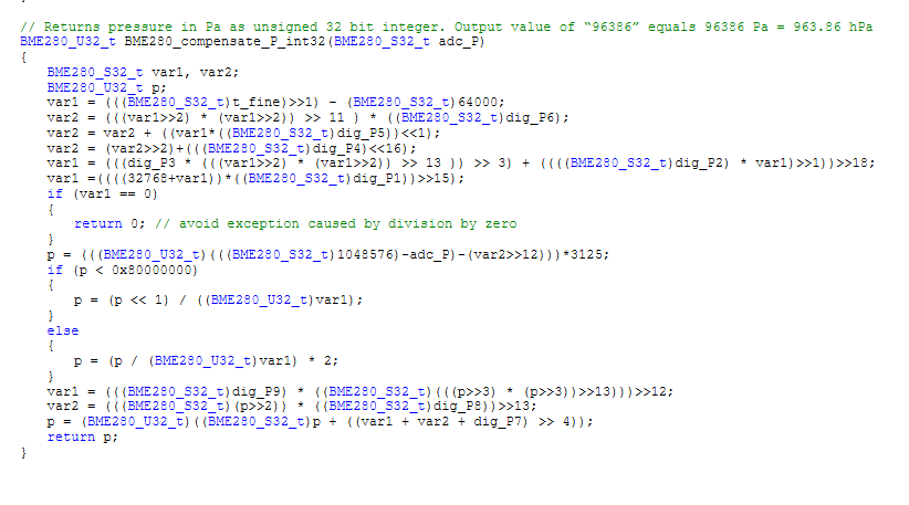

    With the pressure I also get an incorrect result (about 740 hPa). I did the calculation on 32 bit variables ( BME280_S32_t and BME280_U32_t ).
    Code: Lua
    EDIT: .
    The moisture reading is also wrong and brings " 0 ". I checked that the value v_x1_u32r is a negative number -548524057 .
    EDIT: .
    I have removed unnecessary ballast from the post as the humidity reading is already working correctly.

    czasnagli wrote:
    I have checked that the value of v_x1_u32r is a negative number -548524057.
    This looks to me like some kind of overrun of the allowed value of the variable. Note that some parameters are even 64 bit some are u_int and others are int and maybe something is wrong with it that you are writing e.g. a u_int value to a variable declared as int or vice versa. Study the datasheet and see if you are sure you have the "variable ranges" as they should be....
