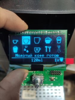

  • #211 18325448
    VovaSova1980
    Rate: 7
    So I put together a display. Thanks Amigos.

  • #214 18331378
    Smoczy
    Level 20  
    Posts: 436
    Help: 26
    Rate: 67
    NIVONA Caferomatica 830 Coffee Machine: Damaged Display Repair, AliExpress Replacement NIVONA Caferomatica 830 Coffee Machine: Damaged Display Repair, AliExpress Replacement NIVONA Caferomatica 830 Coffee Machine: Damaged Display Repair, AliExpress Replacement NIVONA Caferomatica 830 Coffee Machine: Damaged Display Repair, AliExpress Replacement NIVONA Caferomatica 830 Coffee Machine: Damaged Display Repair, AliExpress Replacement NIVONA Caferomatica 830 Coffee Machine: Damaged Display Repair, AliExpress Replacement
    This is my solution. There is no problem with jumping lines. In the event that this problem occurs, there is the signal delay / WR option.
    If anyone is interested, I have some redundant tiles.
    Regards, Łukasz
    PS Sorry for the not very aesthetic background of photos :)

  • #216 18331484
    Smoczy
    Level 20  
    Posts: 436
    Help: 26
    Rate: 67
    39VF512 with a modified content so that you can "pass" the /WR signal through it.
    My solution only requires:
    1. After removing the housing, unsolder the display board from the pins
    2. Raise the plastic strip on the IDC pins to about half the height
    3. Solder the plate to the goldpins according to the picture, slide the plastic strip as low as possible
    4. undercut one of the display pins so that it misses the added board
    5. Replace the display on the original board
    6. Cut off the D0 pin (7th pin counting from the power supply side) so that it does not get to the display board. It has to be connected to the module.
    7. Solder the display board
    8. Connect the square pad from the module with a cable instead of the cut off D0 pin (there are two next to each other, oval and square).
    9. Check operation, if there is a problem with errors on the display, you should also connect the /WR signal through the module (round pad from the module).
    The whole work takes no more than 15 minutes, with average skill in soldering.
    The board on which I made the project is one-sided (for this reason, one jumper was necessary, visible in the picture)
    Further questions, please write.
    Regards, Luke
