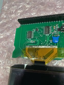

    Txx112
    Diode is not shorting. Replaced three times all IC-s. Mesured that nothing beneth ICs not shorting. No result, still reverted. One possibility, that I ordered wrong pcb from post 172 (untitled_ok_5_new_SSDzFCP_Gerber.zip). Also soldered second pcb with all components, still reverted.
  • #253 18490466

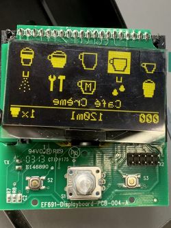

    jackmc
    As suggested by Amigos, I smeared with flux and soldered TPS. The effect - as can be seen.
    Thank you very much for help.
    Electronic display showing various beverage icons and details about Latte Macchiato.

    Printed circuit board with highlighted area around IC3.

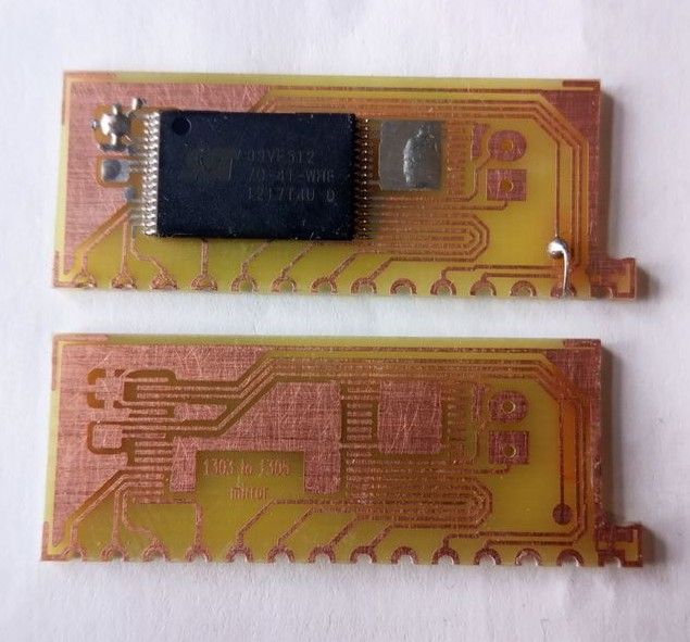

    Smoczy
    Level 20  
    Posts: 436
    Help: 26
    Rate: 67
    My project has resumed the tile, now you do not need to remove the plastic pin under the display. If anyone is interested, I have several more. We solder, cut off one pin and connect it with a wire to a square solder point on the board and that's it. You do not need to change anything except the display.

    Rate: 67
    Correction is the IC displacement and making an undercut under the dowel so that the plate does not interfere with the mounting of the frame under the display.

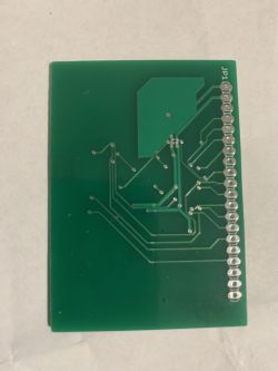

    Rate: 103
    If anyone was interested, I redesigned the SSD1305 display adapter board (according to the diagram on CD4071 and CD4078).
    NIVONA Caferomatica 830 Coffee Machine: Damaged Display Repair, AliExpress Replacement

    No revelation. Finally something professionally done. Are you ready to share your project or are you just selling ready-made tiles? I don't need it right now, but I'd like to look through the documentation with the project. What did you design it for? I like this performance and it may be useful one day ;)
  • #265 18507781
    j4rek
    Level 19  
    Posts: 370
    Help: 8
    Rate: 103
    The diagram below. I didn't order tiles - I can throw gerberas and if anyone is willing, they can order pcb to test it. The project was made in Altium.

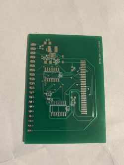

    This is what the tile looks like now, version without sm.
    Two printed circuit boards, one with a mounted integrated circuit, the other circuit is empty.
