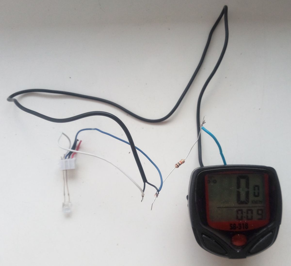

  • A cheap bicycle computer was turned into an optical wattmeter that measures instantaneous power and watt-hours using a phototransistor and a resistor.
  • The modification removes the battery, bypasses the reed switch, and reads the energy meter's LED through the phototransistor circuit.
  • It uses a Shenn SB-318 counter, an FT06-M phototransistor, a 10kΩ resistor, and an energy meter rated at 2,500 pulses per kilowatt hour.
  • With a 4,000 mm wheel circumference, 21.1 km/h corresponds to 2,110 W, but the meter does not show speeds below about 3 km/h, or 300 W.
  • Modified SB-318 bike computer with connected wires, a phototransistor and a resistor .
    I prove that it is possible to measure instantaneous power and watt-hours consumed with the cheapest bicycle meter, a phototransistor and a resistor :)
    You only need to:

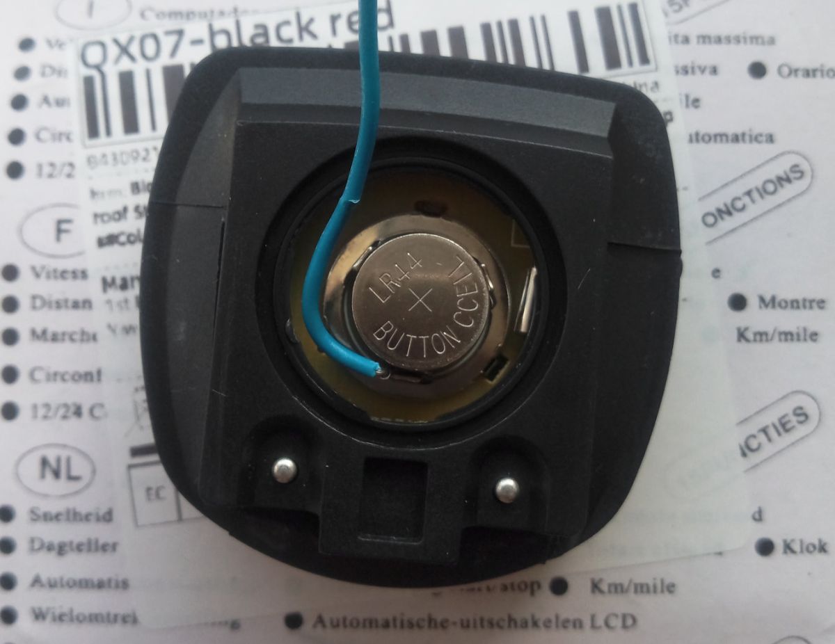

    - take the plus battery out of the meter
    - cut the reed switch from the cable and identify which of the two wires is the minus of the battery
    - connect the emitter of the phototransistor to minus and the collector to the return wire
    - connect a resistor between the positive and the collector of the photo transistor
    - connect the phototransistor to the LED in the energy meter
    I used a Shenb SB-318 counter ($2), a FT06-M phototransistor (PLN1.20) and a 10kΩ resistor.

    And here's a video showing how it works when an approximately two-kilowatt kettle finishes boiling water:
    The energy meter does 2,500 pulses per kilowatt hour, so I've set a circle circumference of 4,000 mm, so the result of 21.1 km/h means an intake of 2110 W.
    You can see that with each pulse, 4 metres of distance is gained, and the 1,580 km gained is 0.158 kWh.
    Unfortunately, the bike meter does not show speeds of less than ~3 km/h, which translates to 300 W. An energy meter doing more imp/kWh would have been better suited.

  • Wheel circumference calibration for wattmeter scaling
    #11 21600682
    Sam Sung
    Posts: 2031
    Help: 227
    Rate: 605
    mipix wrote:
    You just forgot to add that these bike counters require you to enter the circumference of the wheel according to which they change their speed and distance travelled readings.
    I did not forget:
    Sam Sung wrote:
    I set a wheel circumference of 4000 mm
    mipix wrote:
    Have you thought about calibrating this somehow with the frequency of the light blinking?
    I calibrate it so that the kilometres correspond to a decimal multiple of the watts. The electric meter just happens to have 2500 imp/kWh. So I set wheel circumference = 4000 mm, which when multiplied gives 2500 imp/kWh * 4000 mm/imp = 10000000 mm/kWh = 10 km/kWh. From this, the meter shows 21.1 km/h (as in the video) when the power consumption is 2.11 kW and the distance of 1.58 km corresponds to 0.158 kWh. I could set myself a 400 mm circumference and then 1 km/h would correspond to as much as 1 kW. For measuring power this would be poor, but for counting energy consumed perhaps better.
    Worse if the meter has, for example, 6400 imp/kWh, because the fractional (1562.5 mm) circumference of the wheel cannot be set.
    By the way: when will you publish the access point resetter/restarter project you promised 20 years ago? :) .
    mipix wrote:
    full project coming soon

A low-cost optical wattmeter concept uses a bicycle speedometer, a phototransistor (FT06-M), and a resistor (10kΩ) to measure instantaneous power and energy consumption by detecting LED pulses from an electric energy meter. The phototransistor is connected to the meter's reed switch wires after removing the battery, with the resistor polarizing the phototransistor. The bicycle meter interprets pulse frequency as speed, which is calibrated to correspond to power (watts) by adjusting the wheel circumference parameter to match the energy meter's impulse rate (e.g., 2500 imp/kWh). This setup allows the meter to display power in hundreds of watts and energy in kilowatt-hours. Limitations include the bicycle meter's quartz oscillator accuracy affecting instantaneous power measurement, but energy consumption measurement remains accurate as it counts pulses. The approach is considered a creative, indirect power measurement method rather than a true wattmeter, with some debate on its precision and practical utility compared to commercial energy meters or clamp meters. Calibration challenges arise with different impulse rates (e.g., 6400 imp/kWh) and wheel circumference settings. Alternative suggestions include using WiFi-enabled modules (e.g., ESP8266) for enhanced functionality. The method is recognized as an inventive, low-cost solution for approximate power and energy monitoring using common components.
