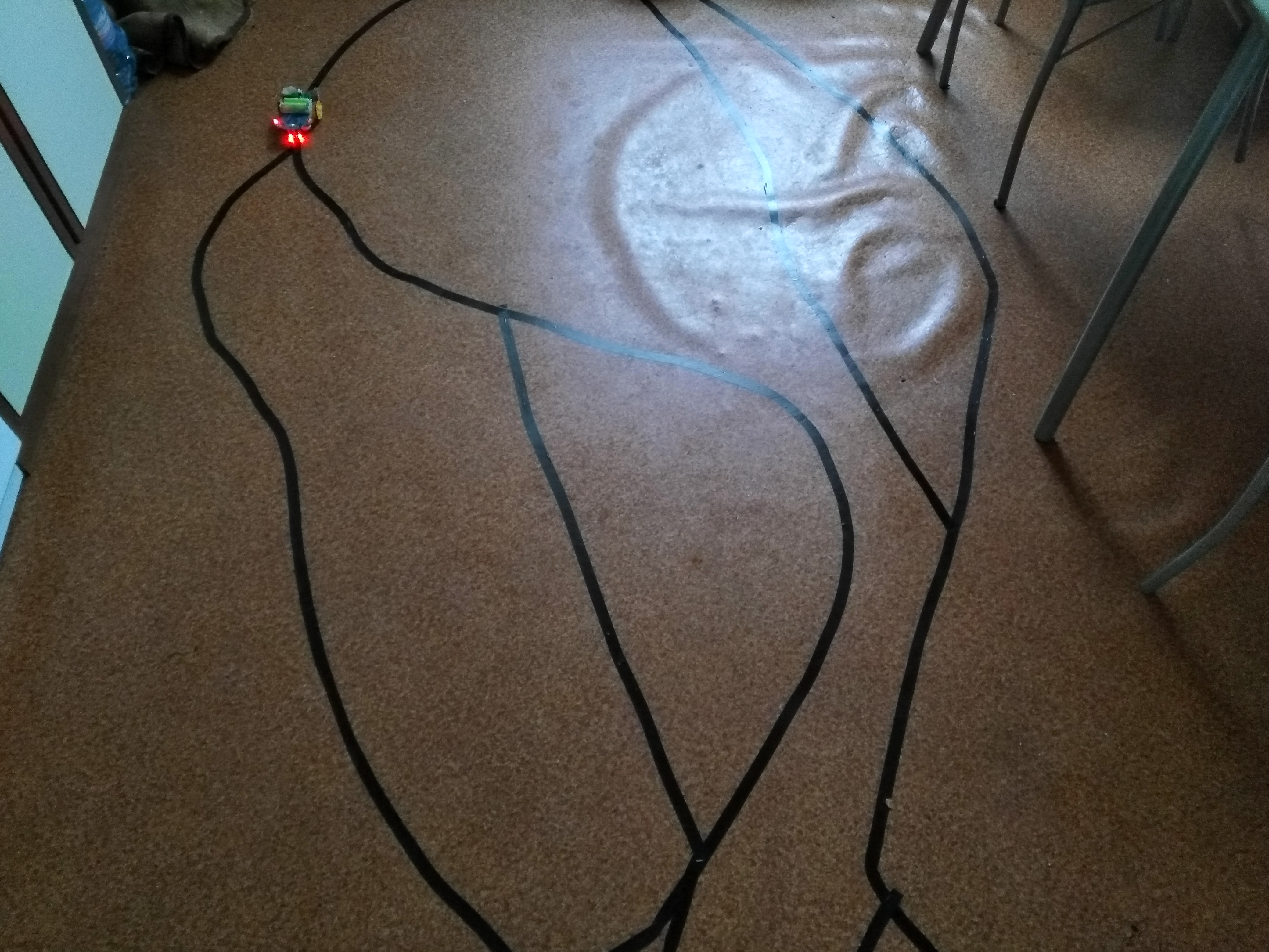

  • It draws 35mA at 3V and works well enough to make people laugh, though the third wheel is only a screw and feels weak.

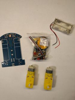

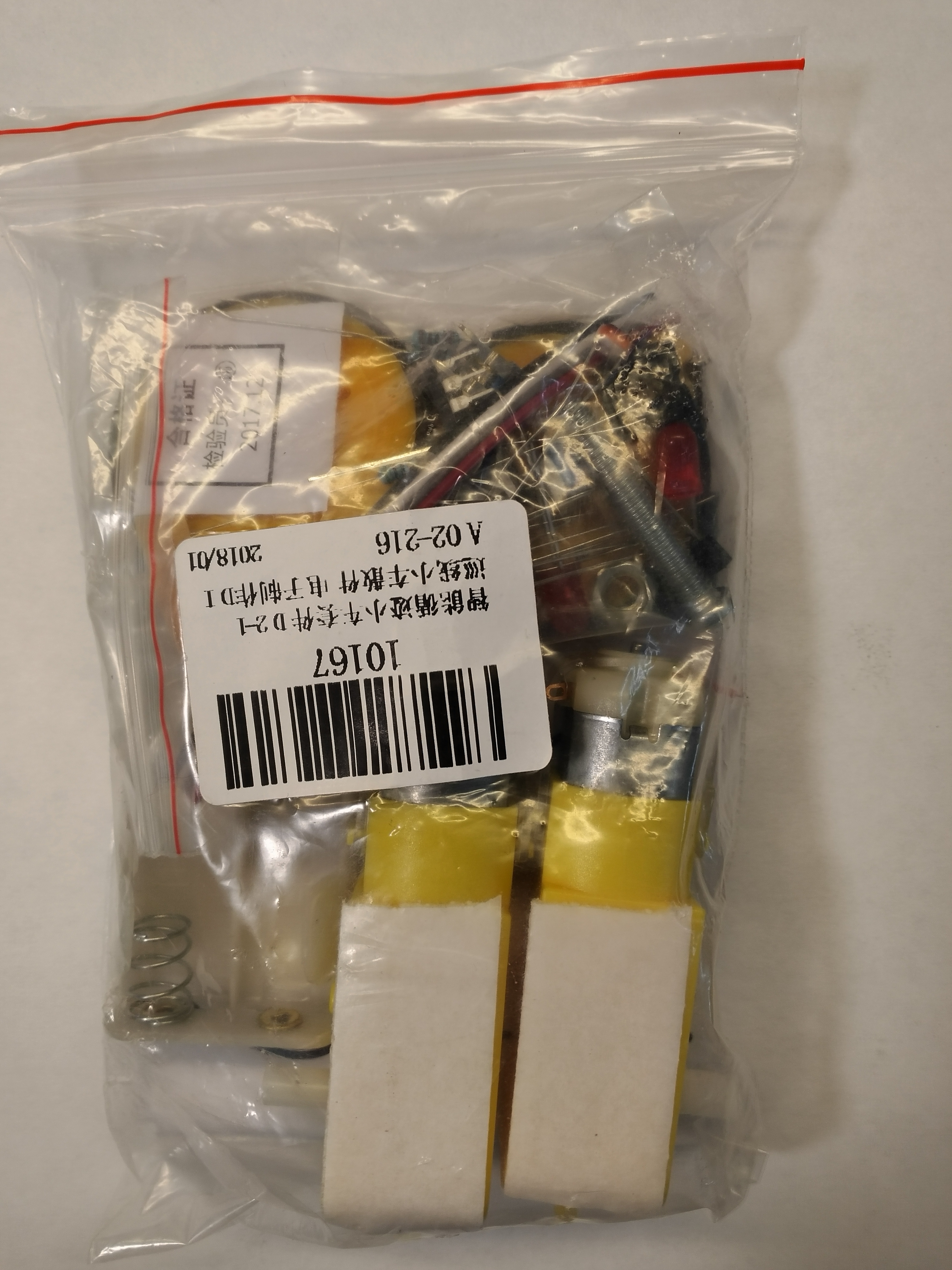

    What we get in the set, you can see in the photos below:

    The set includes:
    1. Two geared motors. They are glued with double-sided foam tape, which allows them to be quickly mounted to the PCB.
    2. Two wheels, with "tires", and screws to screw them to the axles of the motors.
    3. LM393 double operational amplifier and a socket for it.
    4. Basket for two AA batteries. Stuck with double-sided adhesive tape.
    5. Switch button S1.

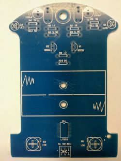

    6. The PCB which is also the supporting structure of the whole "robot".
    7. Two bright red LEDs in transparent housings. Cooperating with photoresistors.
    8. Two red LEDs in diffusion casings. Facilitating system adjustment.
    9. Two photoresistors. Acting in conjunction with bright LEDs, functions of sensors.
    10. Two 10kOhm mounting potentiometers. To adjust the system.
    11. Two 8550 transistors as drivers for the motors.
    12. Ten resistors with different values.
    13. Two electrolytic capacitors 100uF / 25V

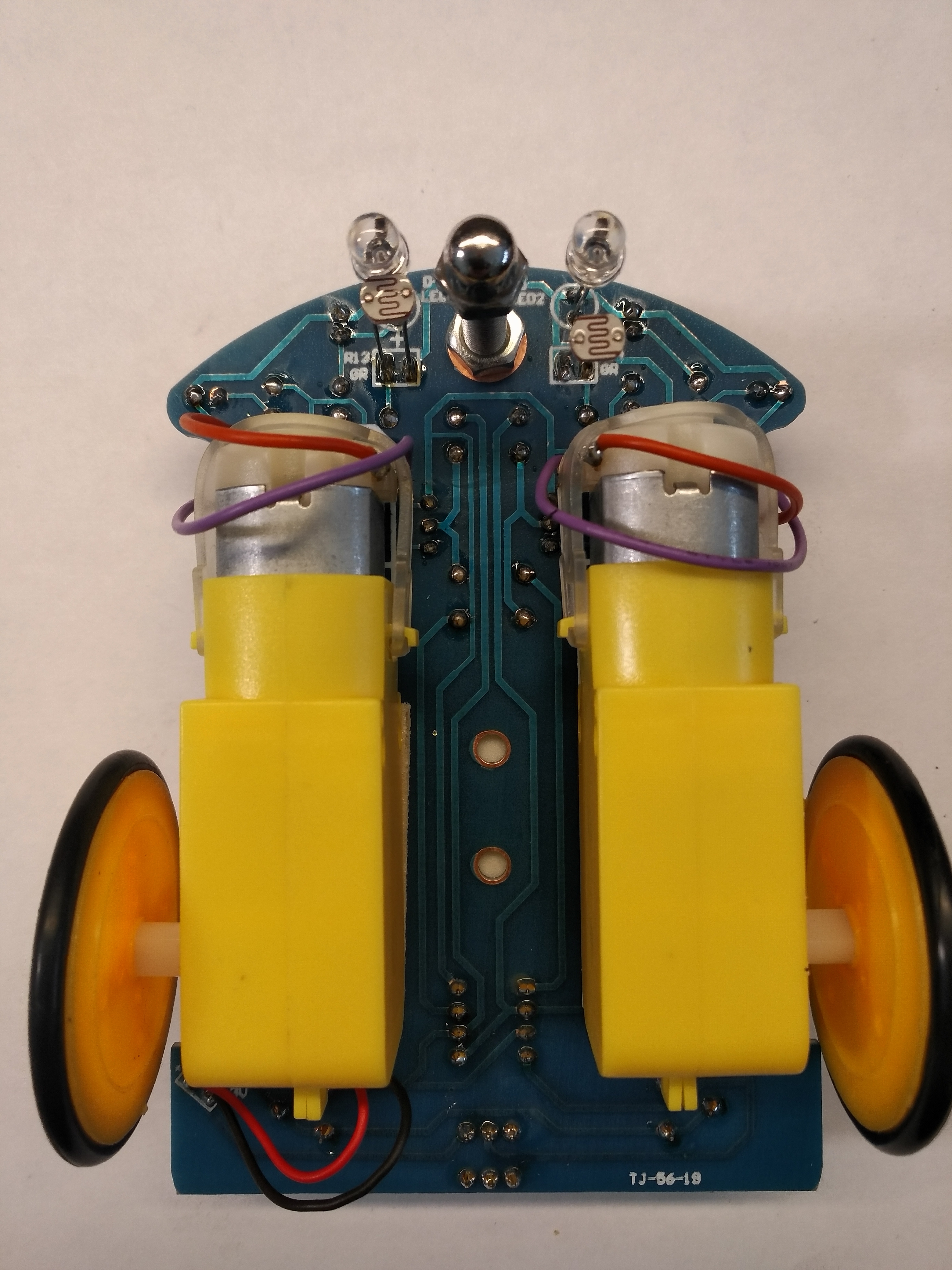

    14. M4 screw with a decorative nut, with a rounded head. It functions as a third wheel, and that is a very weak solution.
    The system consumes 35mA at a voltage of 3V.

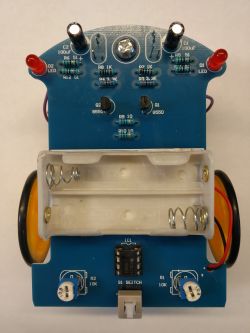

    The system is very easy to assemble. As always, start with the lowest elements. It also suggests that you solder the wires to the pins on the motors before sticking everything together with double-sided tape.
    I must say that with this DIY Kit, I am very pleased. This is a gadget that can really teach you a lot and show that you can do something interesting on discrete components (apart from the integrated op-amp), without using the ubiquitous microcontrollers.
    The attached diagram will allow even very beginner electronics to understand the principle of operation of this gadget. Those slightly more advanced should understand it without even looking at this banal pattern.

    it does not have any microcontroller in its structure. And yet, it is very good at moving along the designated line.
    Maybe that's why? Comparator based circuit I suppose? I did something similar once (also) for entertainment purposes. Somewhere else it lies in the junk ...
    As for marking the route with tape - I suspect that the demand for black electrical tape will increase sharply and ... for floor cleaning agents using residual glue and (if the tape runs out) felt-tip pens ...
    As for the ways to improve - maybe the third (trailing) wheel?

    This nut is a failure, when the insulation on the bends wrinkles, it gets stuck in these places. That's why in the video it's weighed down with stones (I stole from a flower). I think that if you reversed the direction of the motors so that this screw was in the role of the drag wheel, it would be better.
    I have no idea where to get such a small dragging wheel.

    A no-nonsense idea may be ... A LEGO brick circle. Back in the day, in the SYSTEM series with aircraft, they were used as landing gear for aircraft. All you need to do is get a 'spin' block - I don't know what to name it :D . 2x2x1 / 3 where the base moved regardless of the top.

    I have this kit and I confirm, a small simple thing, and it enjoys. As for the screw, the more "professional" LineFollower designs use support balls, e.g .:
