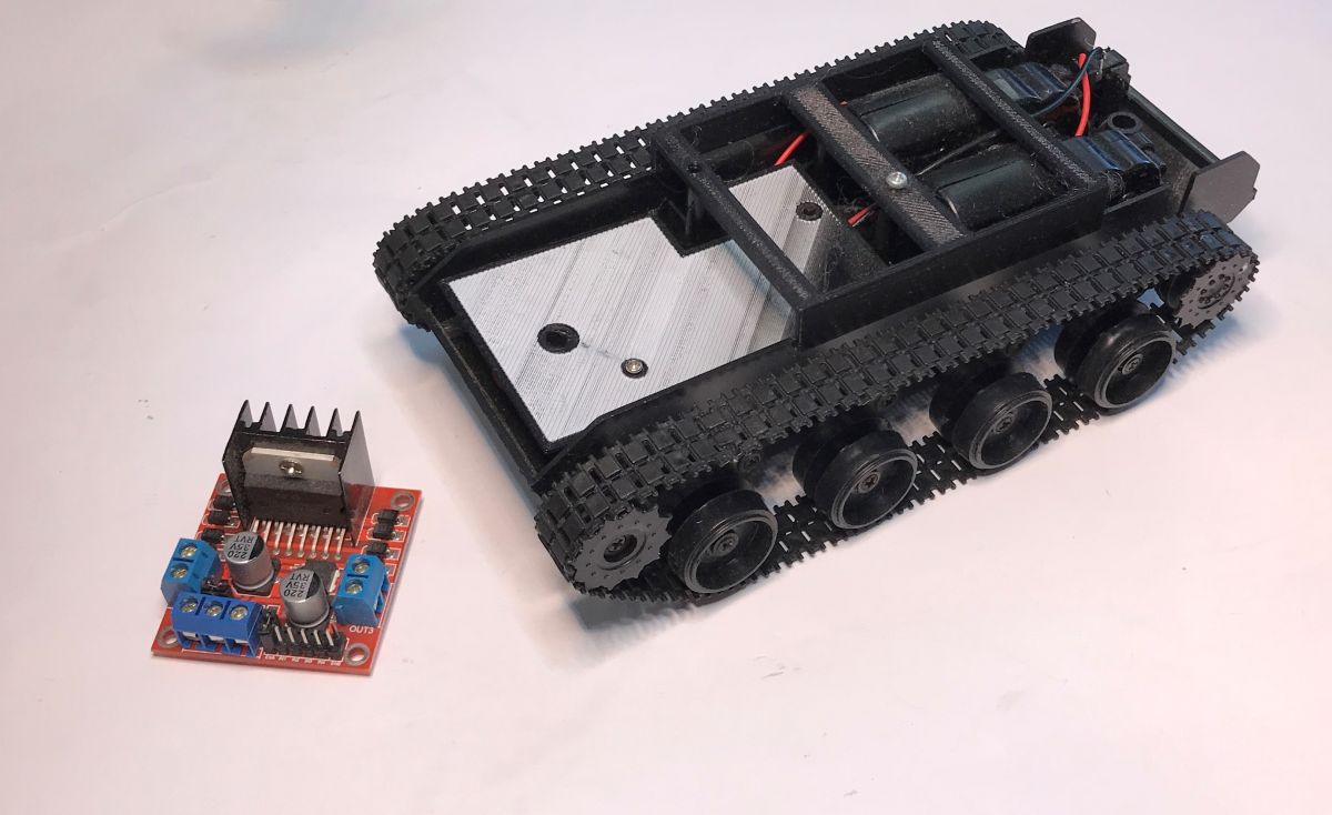

  • Tracked robot model next to L298 module. .
    How to build a robot on a NodeMCU, L298 and two motors? Here is a short mini-project - part one. We are running a remote controlled "tank" with two tracks. By the way, we will see how to connect the L298 to the motors, how to operate it with PlatformIO/Arduino and how it can be controlled via WiFi. The method shown here, however, will also be able to work just as well for the typical 2wd robot chassis available to buy online....
    Robot chassis module with two yellow motors and attached wheels. .
    I will show the whole thing step by step so that a beginner can follow what I was running and how. In addition, I will try to simplify so that the project is not too demanding and complicated. The project will be divided into at least several parts, where I will gradually present the progress, solutions and problems encountered.
    At this stage, I'm assuming that this is a toy that is, to put it jokingly, 'not going out' or 'home' - that is, it will work with our WiFi and will pair with it via WiFiManager. At a later stage I may change this assumption too.

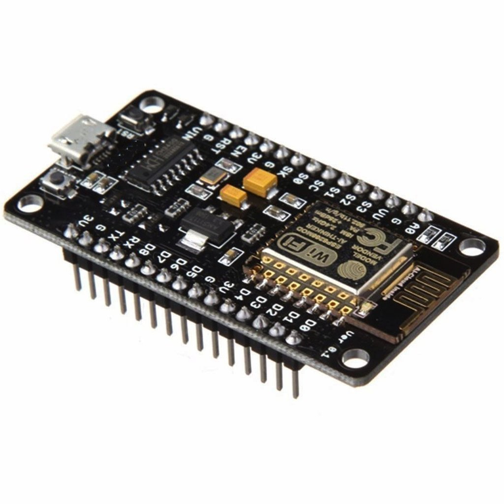

    NodeMCU .
    NodeMCU is such an "Arduino of the new times" for me. Cheap, useful, convenient, supported by many libraries. The NodeMCU is based on the ESP8266 and offers, among other things, connectivity via WiFi.
    NodeMCU board with ESP8266 microcontroller. .
    In addition, there is a USB to UART converter on board to facilitate easy wired programming (although you can also change the batch over WiFi) and a 3.3V LDO regulator to ensure a stable 3.3V for the ESP with 5V from USB.

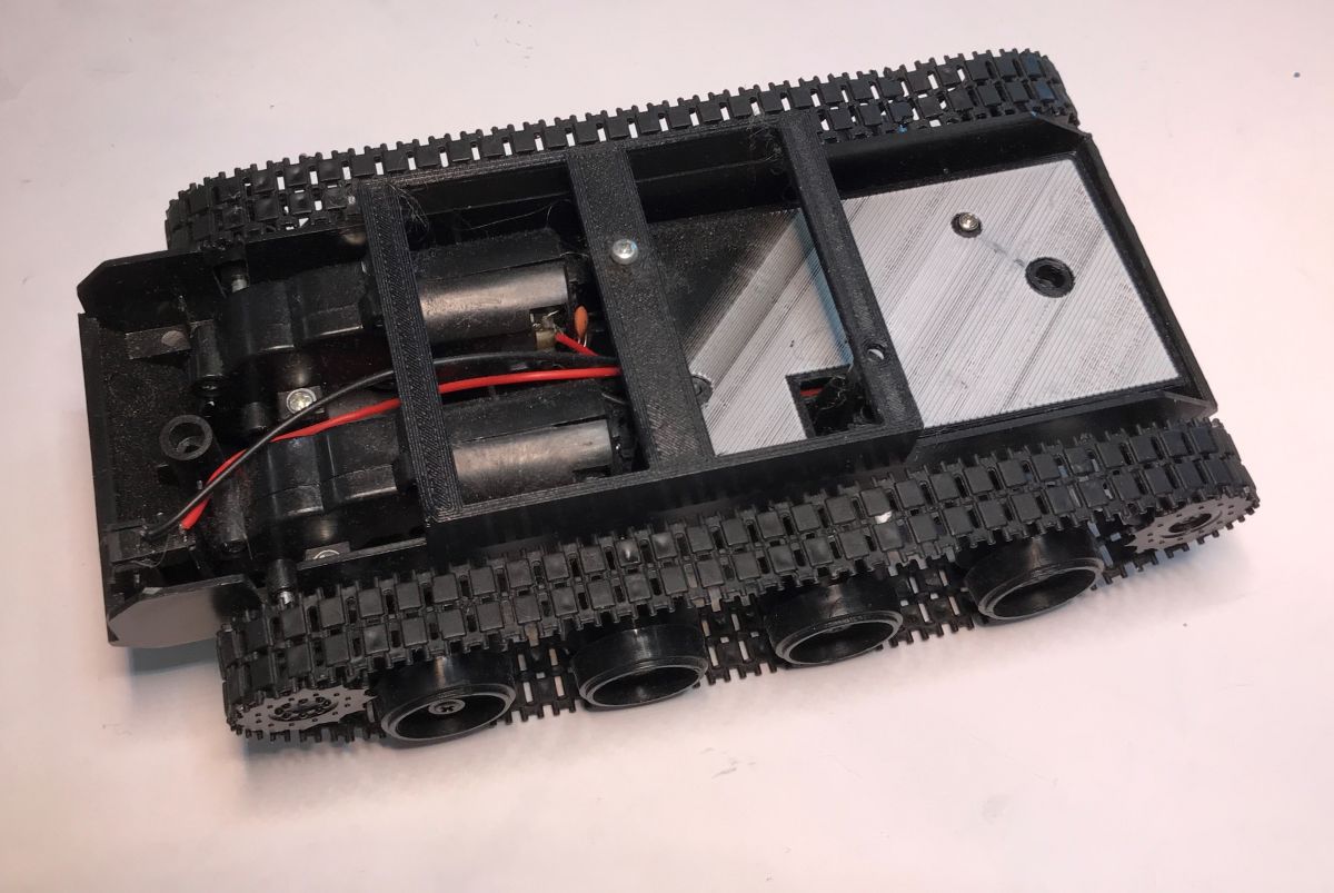

    Chassis module .
    I bought the chassis module in China. I'm not sure if it has a model name by which it can be found, but basically the whole tutorial can be done on any module with tracks, or even with regular wheels. It's just important to choose the right module to control the motors - you need to respect the maximum operating voltage and current.
    Robot chassis with tracks and two motors. .

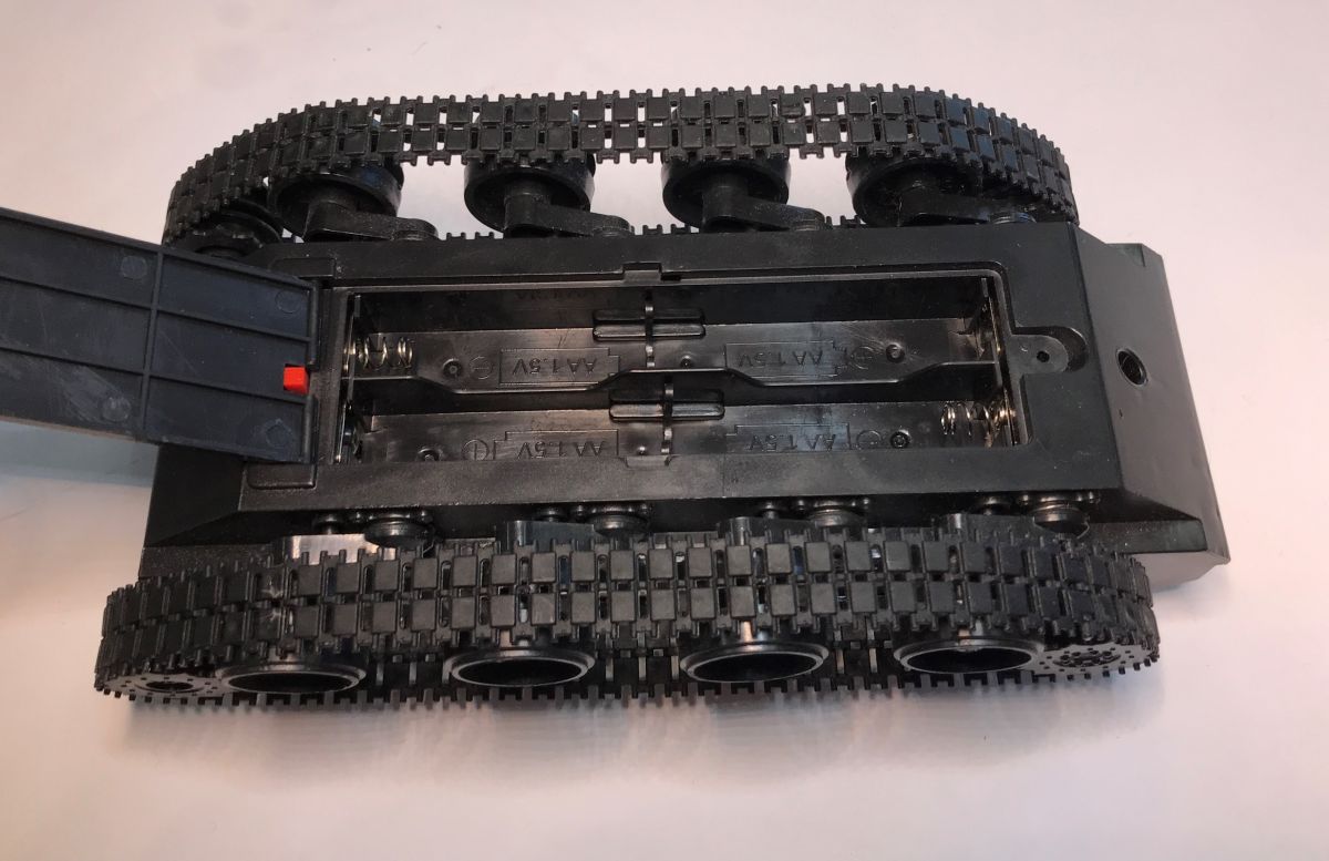

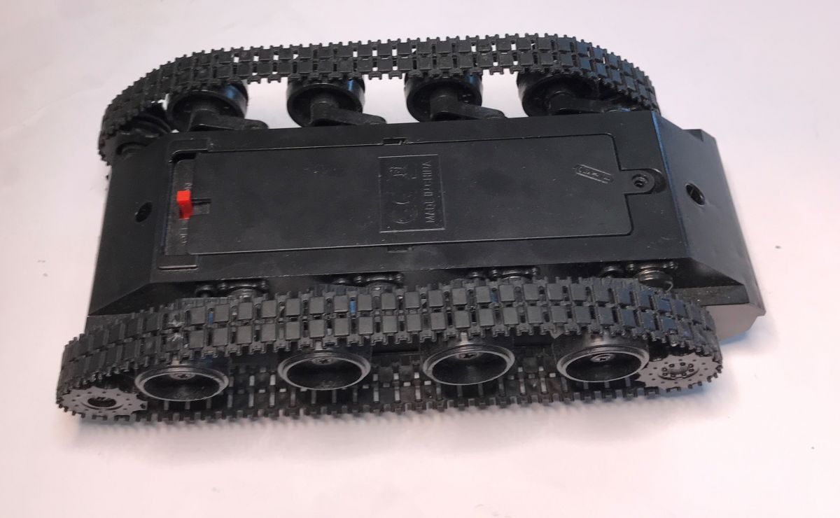

    My module has space for 4 AA batteries on the bottom:
    Robot chassis with tracks and battery compartment .
    View of a robot chassis with tracks and AA battery compartment. .
    These batteries are nominally 1.5V, so 4*1.5V = 6V, but in practice as they discharge the voltage will drop. This is something to watch out for, because if we power a NodeMCU from them with an LDO AMS1117-3.3V regulator on board, the voltage at its input must be at least around 4.6V (according to the datasheet note) to get a stable output....

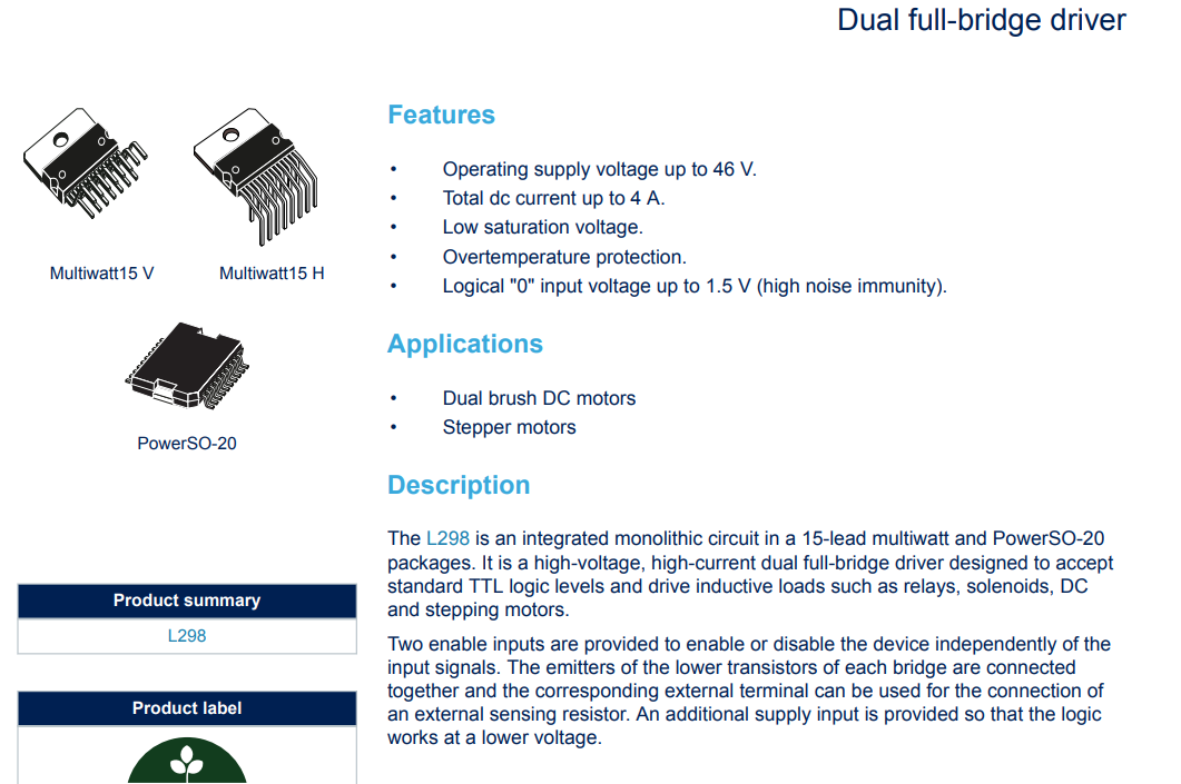

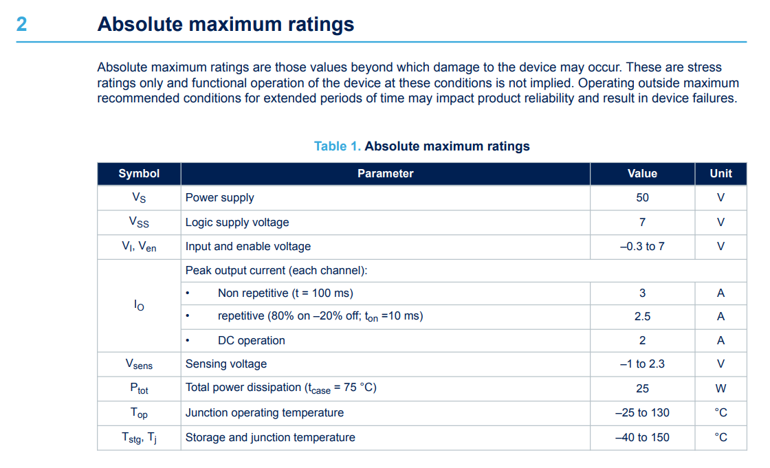

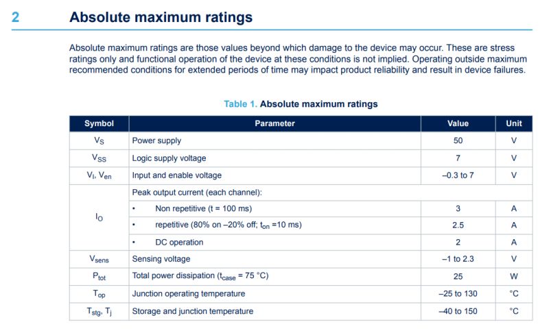

    The L298N is a dual motor controller operating at up to 46V and up to 4A current. Two motors can be connected to it, each motor being controlled independently.
    Technical specification page for the L298 chip with package drawings and list of features. .
    There are 3 control pins per motor, one enable pin and two in. In addition, two supply voltages are applied separately to L298N, one for the motors (up to 46V) and the other up to 7V (logic):
    Table with maximum ratings for L298 parameters. .

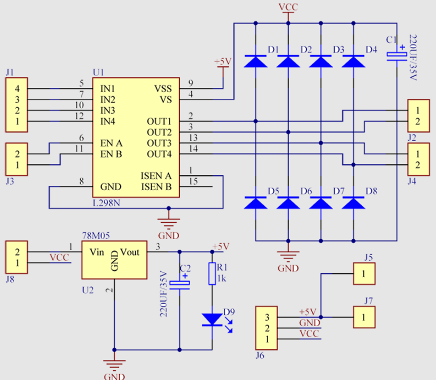

    The commercially available L298 module is essentially L298 + 5V stabiliser. In this situation, we can specify with a jumper whether we want to give, for example, 9V inputs of our own and draw current from the 5V, or whether the stabiliser can be switched off. This is determined by the schematic:
    L298N wiring schematic with motors. .
    There are two potential pitfalls here, however:
    - The 7805 has slightly lower maximum input voltages than the L298N, plus it heats up at higher voltages, so in such situations consider using, for example, an external step-down converter
    - if we give 5V to the input, the 7805 will not switch on (at least when I tested it, it gave 0.5V at the output...) so then you can power both sides, the motors and the logic one with 5V

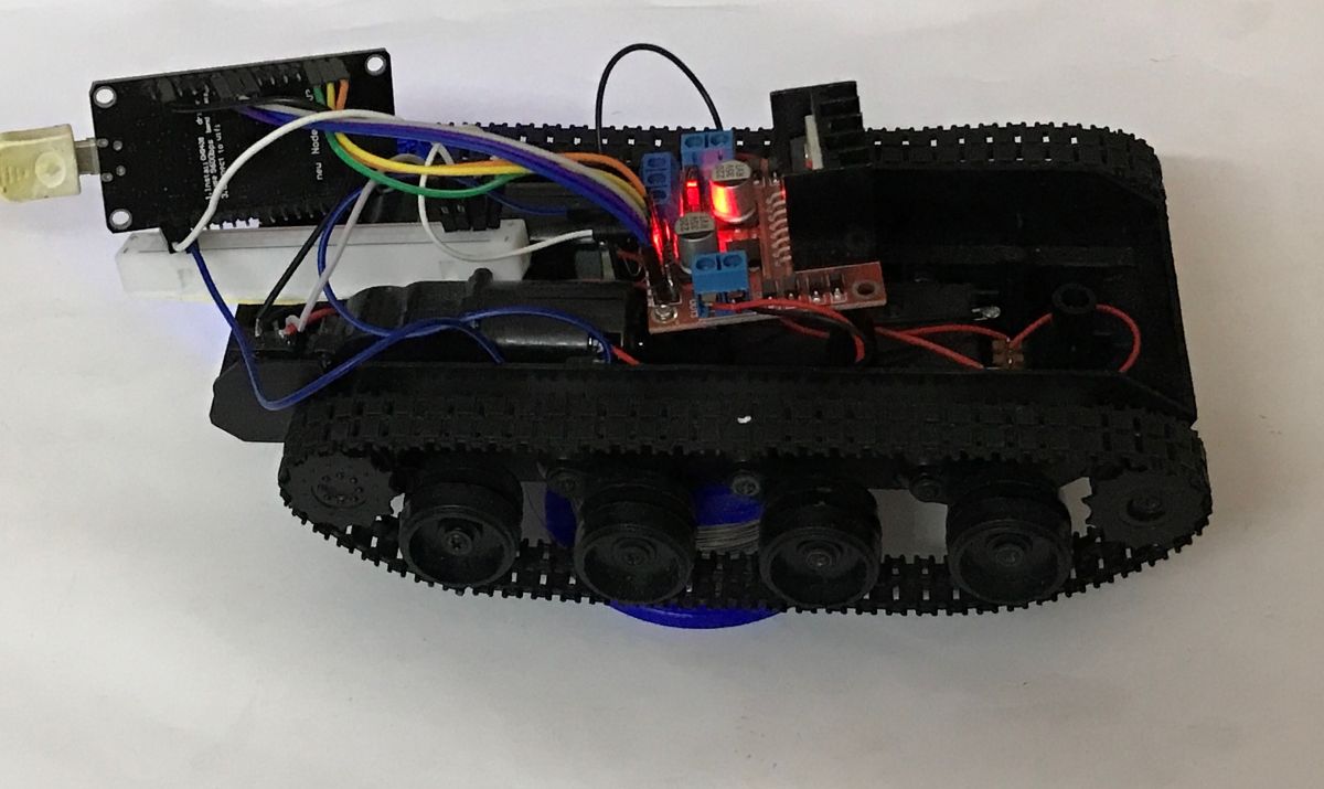

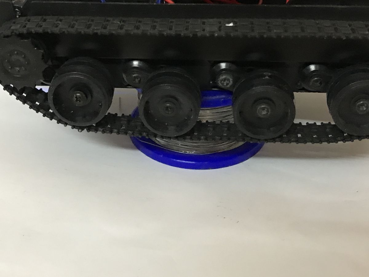

    In the end, I opted for absolute minimalism. I connect the batteries directly to the L298 module and additionally on Vin from the NodeMCU, as their voltage is within the operating range of the AMS1117-3.3V present on this board. The 7805 on L298 is omitted, with power being routed to both sides from Vin.
    In addition, as a test, I put the whole thing on a spool from the solder joint so that the tracks do not touch the ground, so the vehicle will not run away while I am writing the programme.
    Tank-style robot built on a NodeMCU platform with a track chassis. .
    Robot chassis with tracks on a spool. .

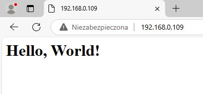

    Add a server (to receive commands) .
    Let's start with communication. The easiest way is to add a simple HTTP server. Admittedly, TCP is connection-intensive and can introduce minor delays when a packet retransmission occurs, but that is negligible here.
    The creation of the server comes down to the use of the ESP8266WebServer class, or more precisely to the creation of an object of this class, where the only argument of the constructor is the port we are listening on. Then, using the "on" function, we set the functions that handle the given resource from the server, in my case there is only one, the "hello world" page. Then we start the server (function begin):
    Code: C / C++
    Result:
    Screenshot of a webpage at IP address 192.168.0.109 displaying the text Hello, World! .

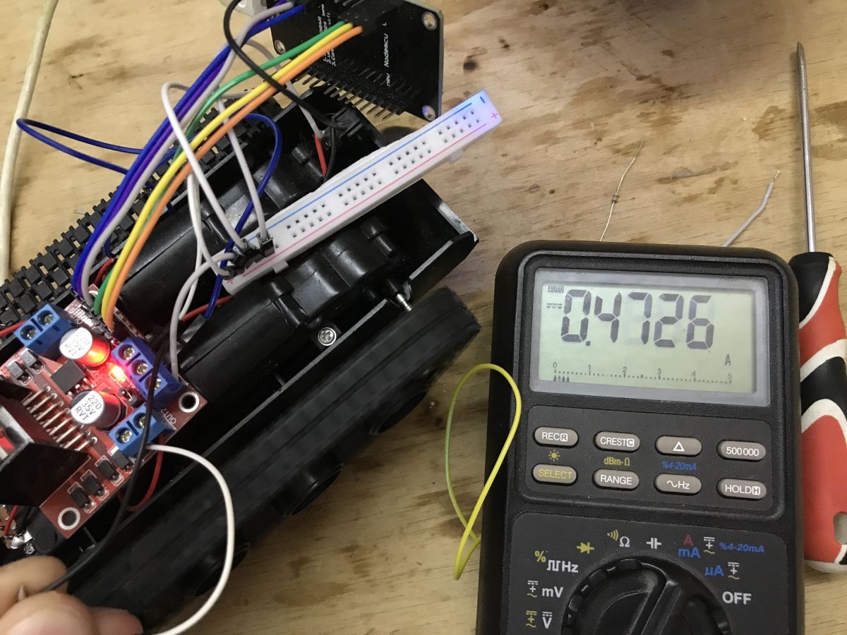

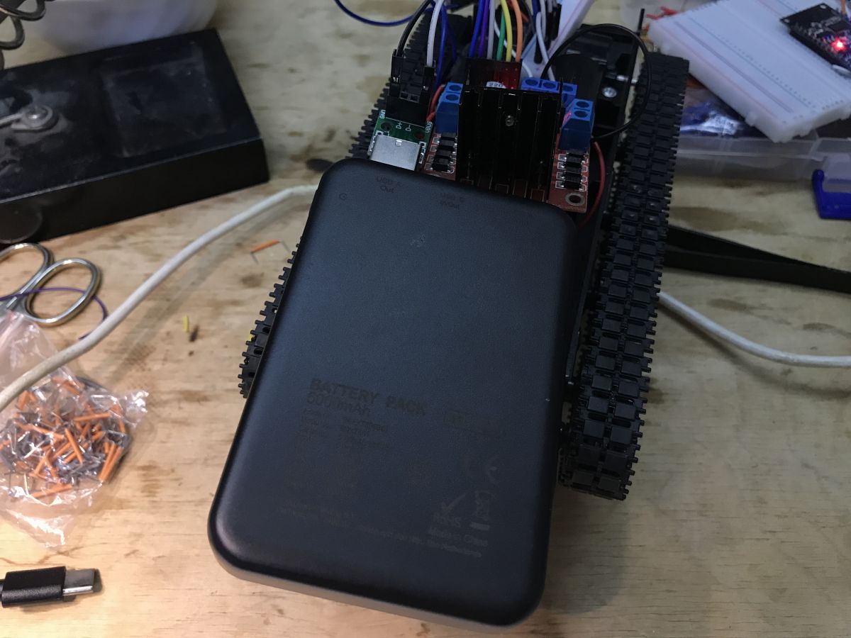

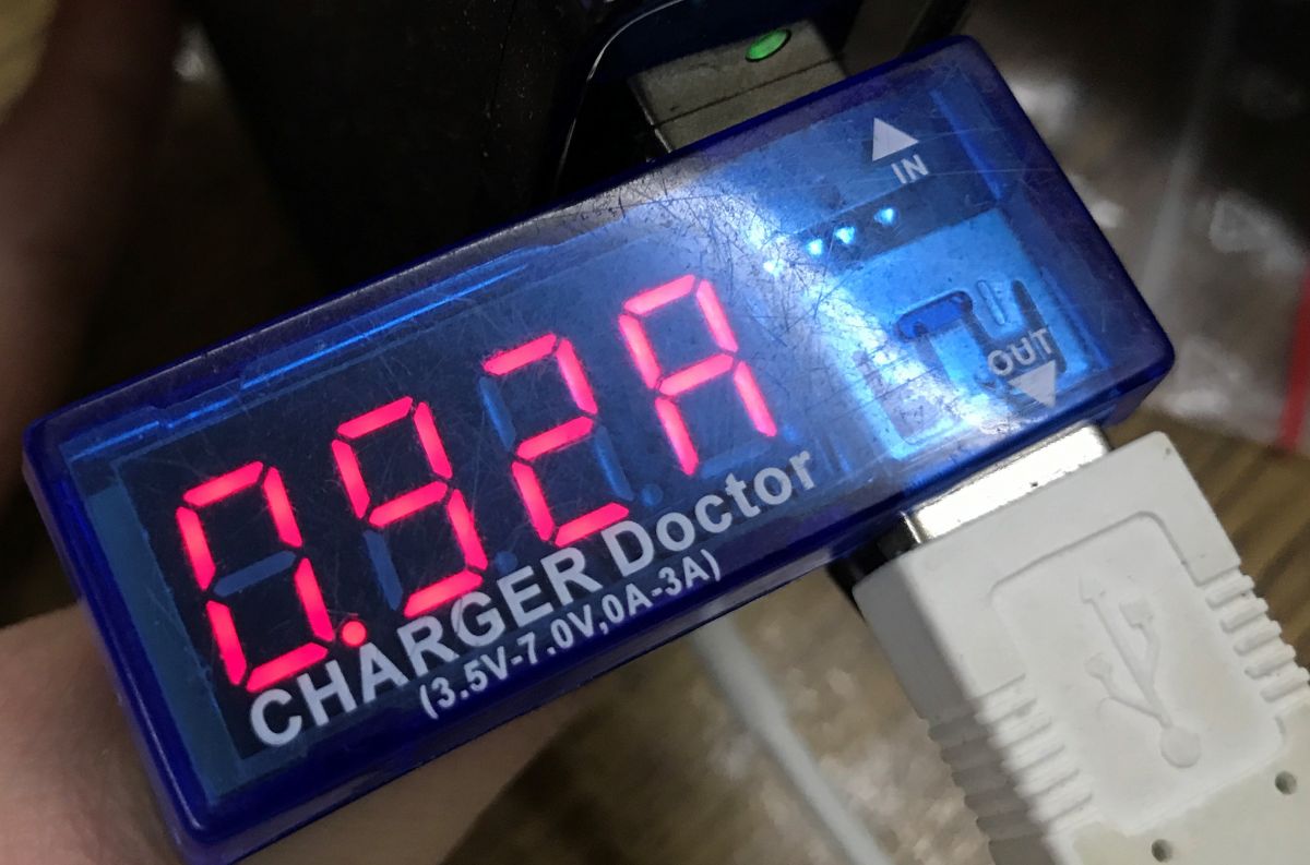

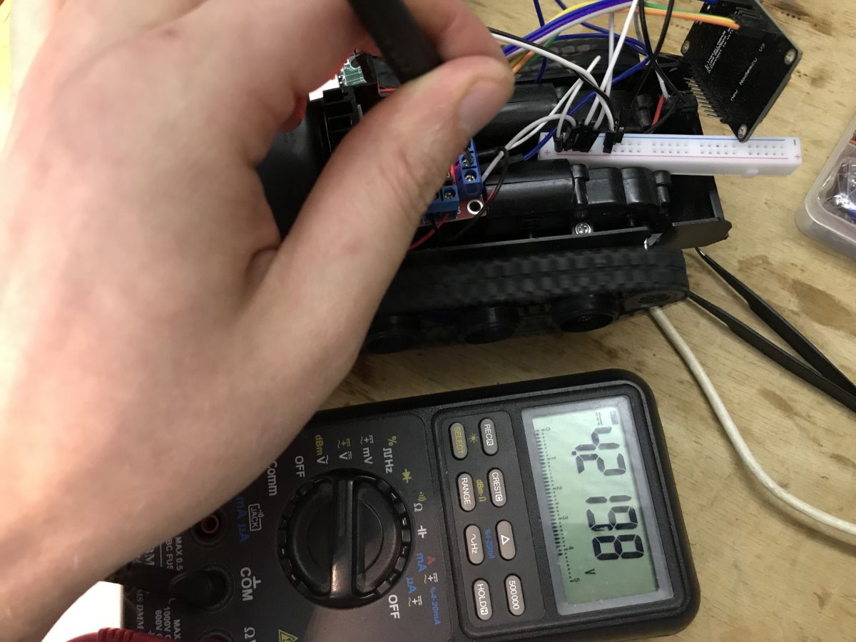

    The chassis works, but rides rather sluggishly in places. I measured the current consumption, first of one motor and then of the whole (NodeMCU + 2 motors) when powered by USB:
    Current measurement in a robot built with L298 and NodeMCU modules .
    Display of a measuring device showing 0.92 A. .
    In addition, I saw that even with the USB wired power supply the voltage drop is noticeable - with one motor it is able to drop to almost 4V, and with both even lower.
    I tested the option with a powerbank for this reason:
    Tracked vehicle with electronic components and a power bank. .
    It is better - with both motors at full power it drops to 4.2V:
    Hand measuring voltage with multimeter on track robot .
    The ride is better:
    I'm staying with the powerbank for the moment.

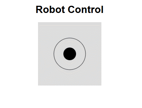

    For this reason, I will introduce a virtual joypad in the next section:
    Robot control interface with virtual joystick. .

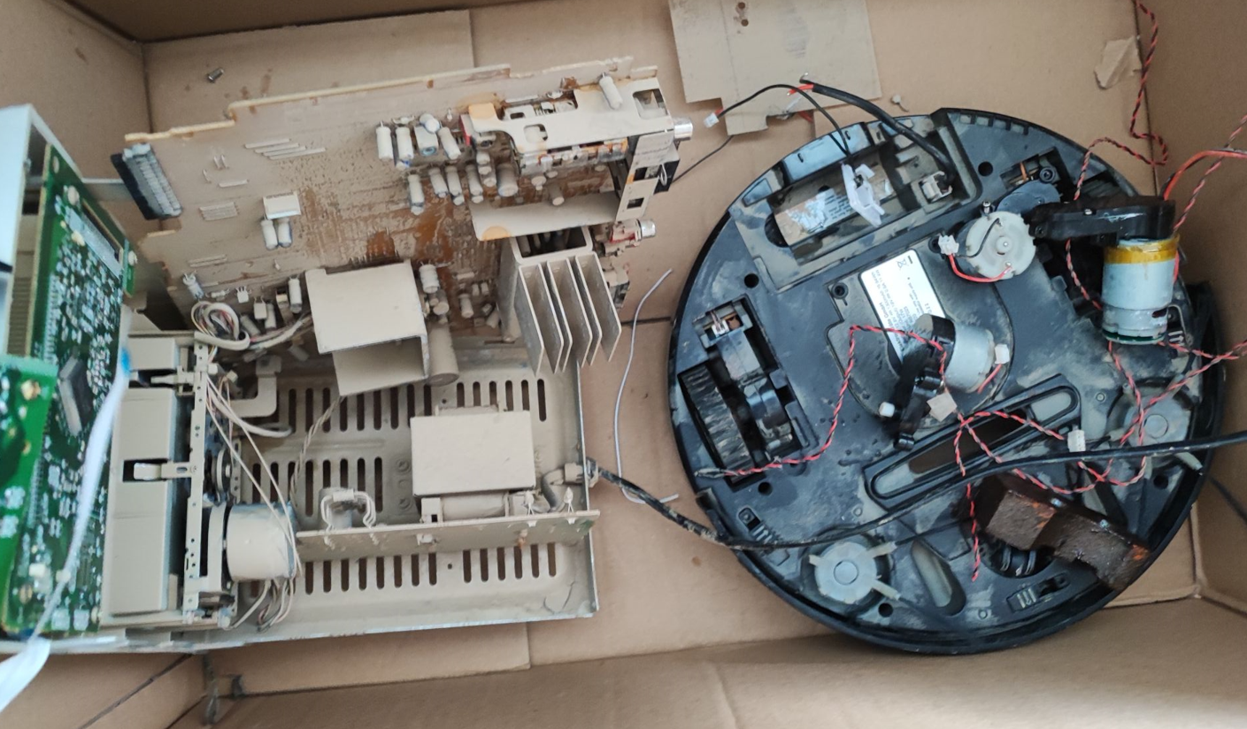

    Last year I was thinking of redoing the cleaning robot, maybe replacing its 'brain' with a Raspberry, and I already had two robots set aside.... but unfortunately they both drowned in the flood and all I had left was just this toy tank chassis, because unfortunately after losing a couple of rooms I was forced with, I estimate, 100kg of mucked up hardware.... only the photo remains:
    Toy tank chassis and electronic components in a cardboard box. .
    But maybe in which part I will think about a charging station.

  • Using an HTML virtual touch gamepad for control
    #6 21450909
    Posts: 14762
    Rate: 12892
    Very cool ideas, thanks for your comments.
    @TechEkspert I was thinking about this option, although I haven't delved into it yet. I've seen that interesting ready-made modules can be imported from China. I think I'll look for some off-the-shelf to integrate with this powerbank for simplicity, just whether such charging despite losses would make sense....
    Maybe I'll try it out on this "tank" from the topic
    @XMarian I think I even have these particular modules bought for a few years. I used to make a joypad of my own:
    USB/HID gamepad on PIC18F45K50 (with additional mouse mode and CDC) .
    By the way, he seems to have "drowned" in the flood too....
    Except that this particular project what I am presenting here I would like to keep it relatively simple, so that a beginner can do it too. For this reason, for the moment, I'll be using a virtual touch gamepad made in HTML, available on the device's website.

    It looks like you are right about this PWM - the right setting of analogWriteFreq helps, only now you have to choose the best value.
    In the meantime, I'm upgrading the virtual touch pad and I have to say that it controls quite well. I think I'll just change the logic a bit so that my HTML pad sends control every change and if there is no change every e.g. 0.1 seconds, and the tank would stop the motors when no packet arrives for e.g. 0.3 seconds. This would ensure that in the event of control problems it would not "run away".

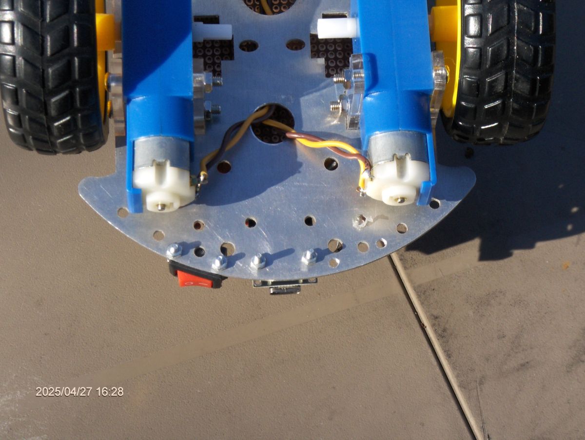

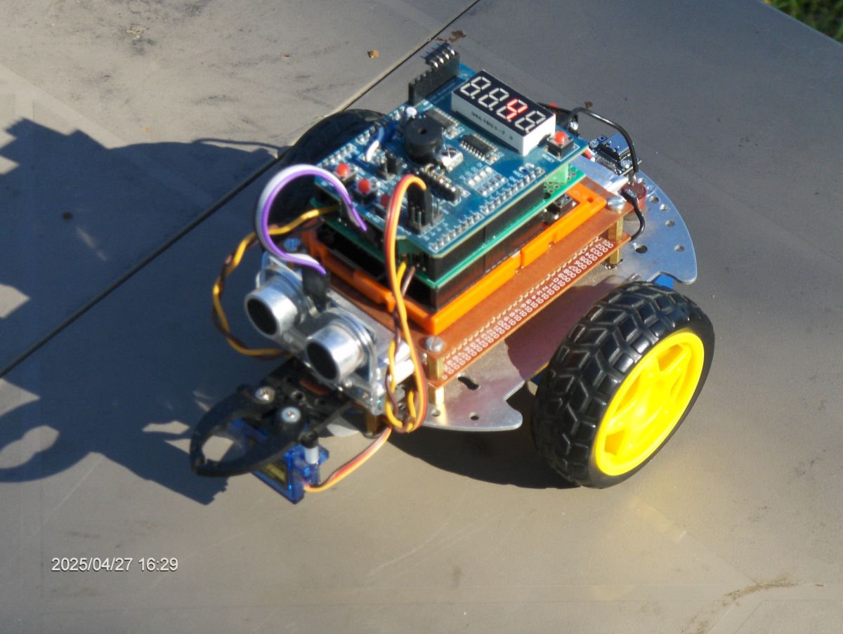

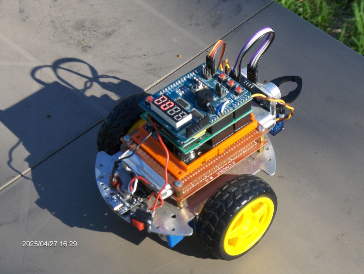

    I also made myself a toy on ESP32 and UNO boards.
    A robot built with ESP32 and UNO boards, mounted on a metal chassis with yellow wheels and an ultrasonic sensor in front. .
    These UNO boards are all wraparound and so the display has to be reprogrammed to display wraparound.
    Small robot built on a wheeled platform with ESP32 and UNO boards, with LED display and visible wires. .
    Don't buy these drives as pictured because these white axles are howling because they are mounted on metal axles in the form of a rod.
    Close-up of a robot chassis with a metal base, black-and-yellow wheels, and two motors with visible white axles.
