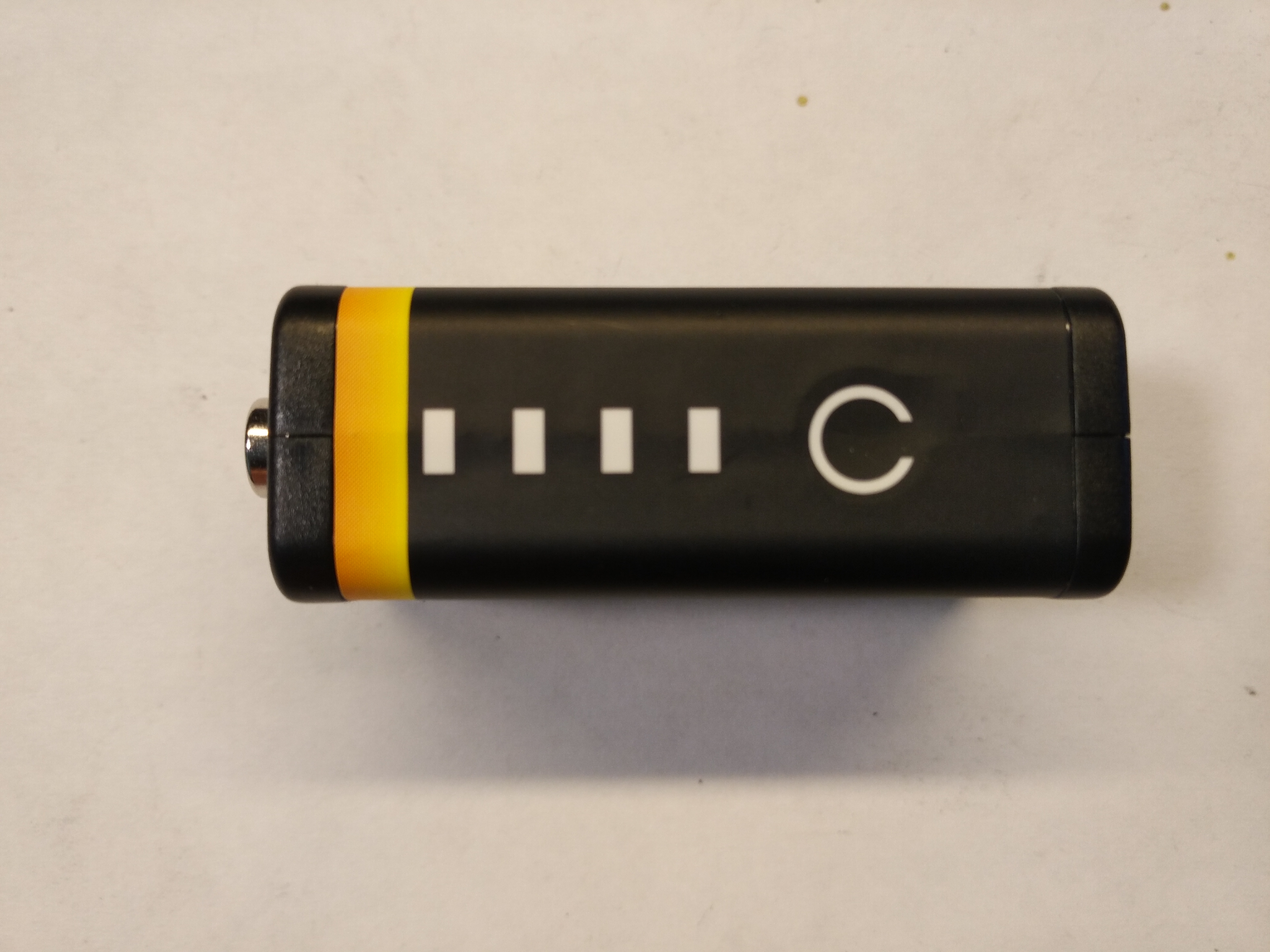

  • In today's article I will test for you a Chinese, 9V reusable battery, charged via USB.
    I have described it once tricked charger with the function of charging the 6F22 battery, the popular "nine-volt" , actually without this feature.
    Several colleagues recommended the purchase of 9V Li-Ion batteries with a built-in inverter and charger inside. Just connect to any 5V charger with a micro USB plug to charge it.
    I was tempted and ordered one piece for a trial.

    Now a few pics:
    Battery 6F22 OKcell JRGK 800mAh 9V USB in Li-Ion version with built-in converter Battery 6F22 OKcell JRGK 800mAh 9V USB in Li-Ion version with built-in converter Battery 6F22 OKcell JRGK 800mAh 9V USB in Li-Ion version with built-in converter Battery 6F22 OKcell JRGK 800mAh 9V USB in Li-Ion version with built-in converter
    The battery is very light, weighs only 24.5g, which, despite the use of a plastic housing, suggests that we will not find too much of this lithium inside.
    As we can see, the battery is equipped with a charge indicator, unfortunately it is completely useless, but more on that.

    Everything looks beautiful so far. Let's move on to checking how much truth there is in this.
    When I took the battery out of the packaging, I pressed the tester button and saw three LEDs on, four of which were possible, I did not think to measure the voltage at the battery terminals, but immediately connected it to the charger. It was lying for over an hour and a half, so if anything, it had to be fully charged. After "allegedly charging", I measured the voltage on the terminals and found that it was only 8.4V, so I connected it for 30 minutes, but the voltage did not increase any more.
    This is the first time I am dealing with this type of invention, so I decided that it may be like that and that's it.
    So we connect it, to an artificial load. Unfortunately, I do not know at what voltage the protection will work and turn off the inverter, but I know from experience that most devices work properly up to about 7.8V.
    Yes, I know that they are still good at 5V, but I omit them. Average multimeter, or, for example, my pyrometer, featured here below 7.8V, they no longer give reliable measurement results.
    For these reasons, I set the discharge voltage to just 7.8V on the artificial load.
    Here I was very disappointed:

    After the test, it turned out that the capacity actually contains the number 8, and there are even two eights ...
    However, it is not as beautiful as it may seem, because the comma is in the wrong place.
    And so I present to you the measurement result, voltage from 8.4V to 7.8V, current 200mA. Result expressed in Ah:
    Yes, you can see the result is 0.088Ah.
    I have already started a dispute and I am counting on a refund, because while with the real capacity of, say, 400mAh, I would be reconciled, or even happy, because it is still twice as much as the "normal 6F22 battery", the difference in the form of ten times the declared value is not acceptable.
    I just hope that I just found a faulty copy and the seller will send a new one or return the money, and I will buy it again and test it. The very idea of Li-Ion cells built with the necessary converters / controllers in the 6F22 battery housing is very good, provided that it is done properly.

    EDIT 2018-06-07 17:11:
    The Chinese wrote that the battery should be charged for five hours before the first use. As for me, this is just selling a client. The battery was plugged into the charger all night (I'll give her a shot :) ). At 7:30 am it had a voltage of 8.40V. I re-measured when I got with her to the company, it was 9:28, which is two hours after unplugging from the charger. I was a bit surprised, because it only had 8.37V, to be sure I checked it with two multimeters, the result was identical.
    This time the capacity measurement looked different. The current was still set to 200mA, because in the case of capacitance measurement, it is impossible to set less in this load.
    I set the lower threshold to 5.80V, i.e. 2.9V has a cell. I wasn't watching the readings all the time, but the last voltage I saw was 6.21V, when I looked the next time the battery was 0.0V (i.e. the protection was working) and the capacity meter showed 449mAh.
    Nevertheless, after pressing the "test" button, one LED was on on the indicator.

    Gentlemen, everything is clear, the capacity indicated on the battery is its capacity of 4.2V and at 9V the capacity will be known to be at least two times smaller, the whole capacity puzzle :) but anyway I am very happy with this battery, I will never buy normal batteries again, and if it dies, it is more profitable to have the battery from inside replace nothing with the usual buy :D
    It rather has 2 cells in series and no boost converter at the output, hence the voltage at the output is max. 2x4.2 = 8.4V and it drops as it discharges. If you had an inverter there, it would hold the voltage rigidly until reaching the UVLO at the input, after which the output would cut off.
    Boosta probably has a USB to charge the cells ...
    You're right.
    Interesting fact, I came across an auction today with the same battery, which had a voltage range of 8.2V-9V.
