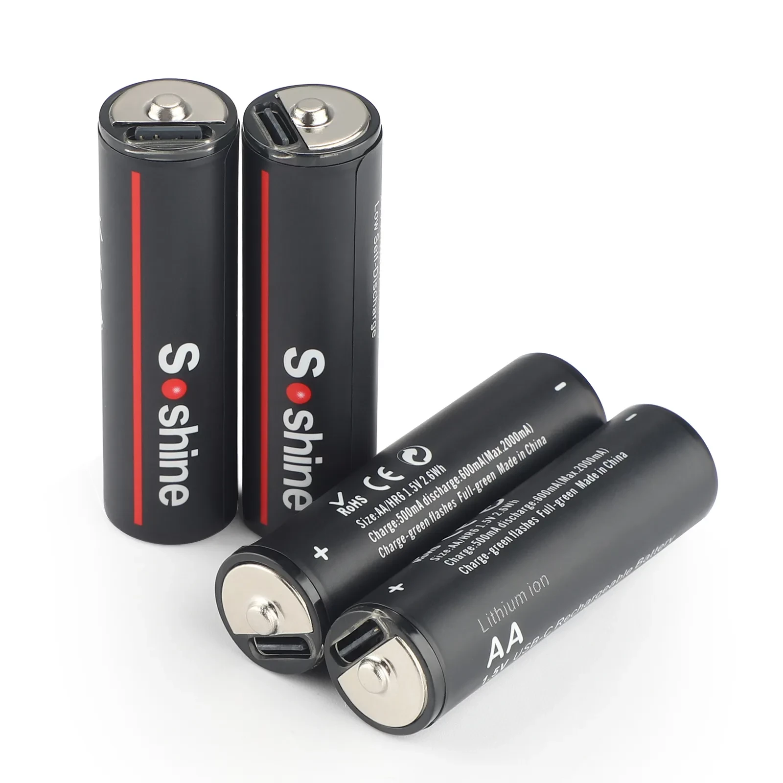

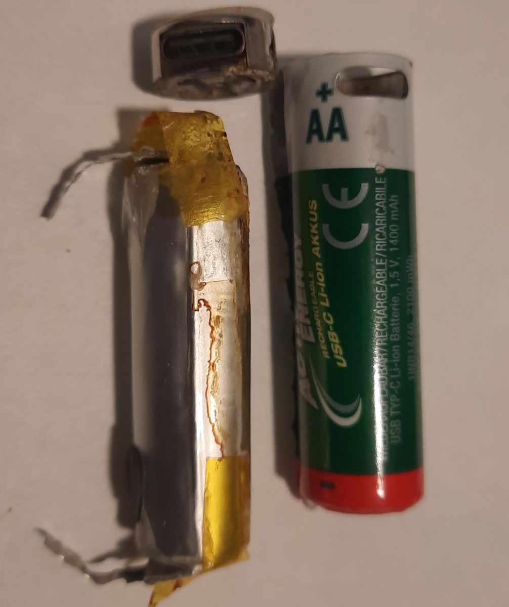

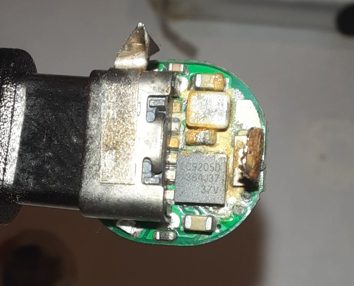

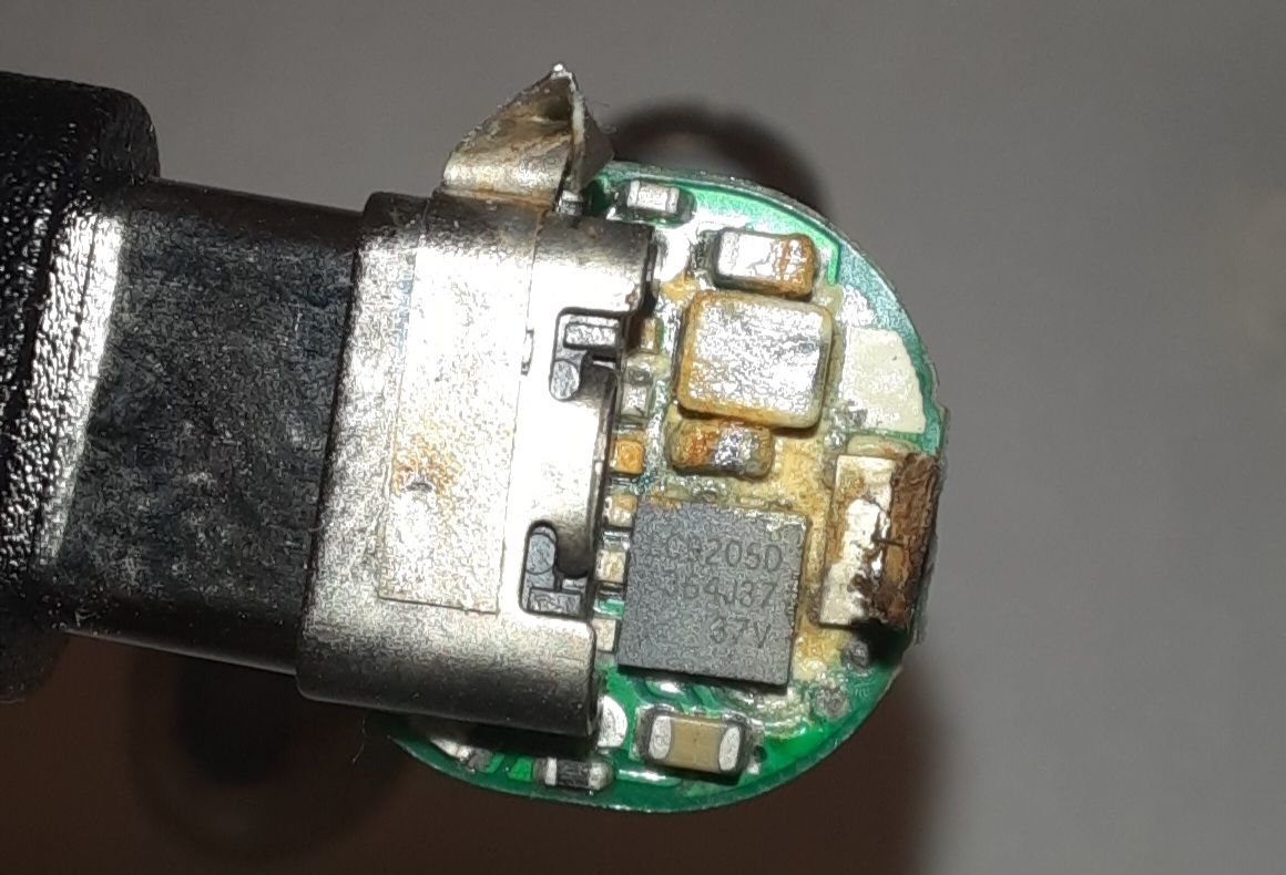

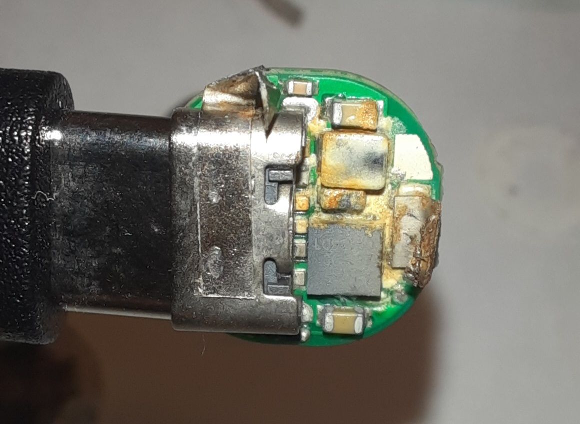

  • Teardown of a USB-C rechargeable AA lithium-ion battery reveals a hidden LC9205D converter inside.
  • The LC9205D handles charging, discharging, and protection for a 3.7V-to-1.5V lithium dry battery with only two capacitors, one resistor, and one inductor.

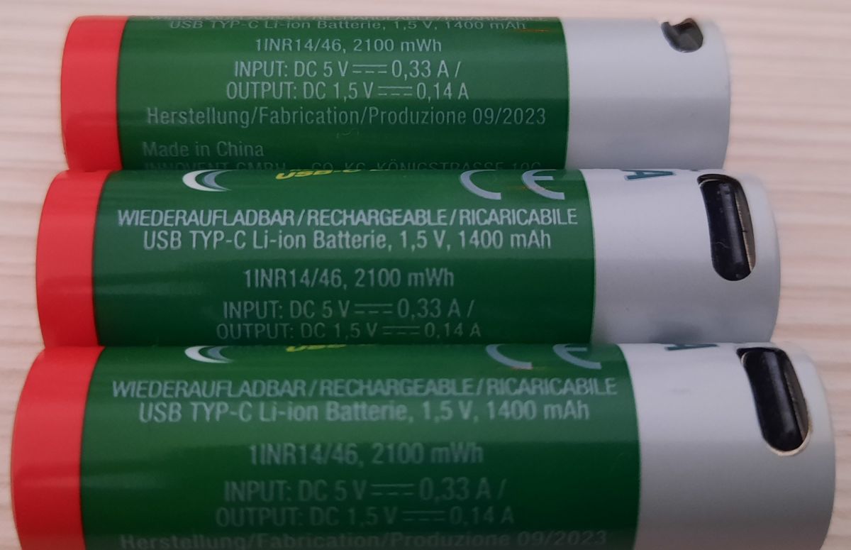

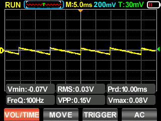

  • The label states 140mA, and the measured output is 1.51V with almost imperceptible ripple.

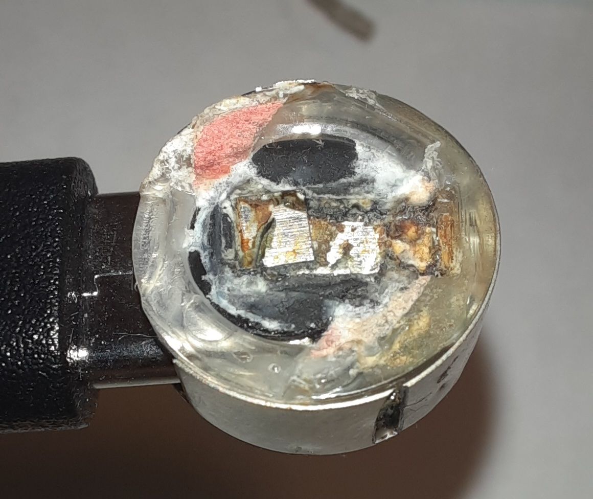

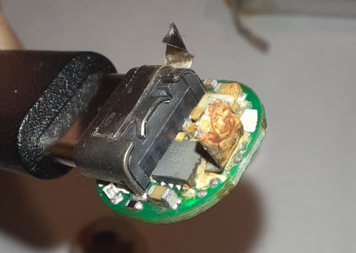

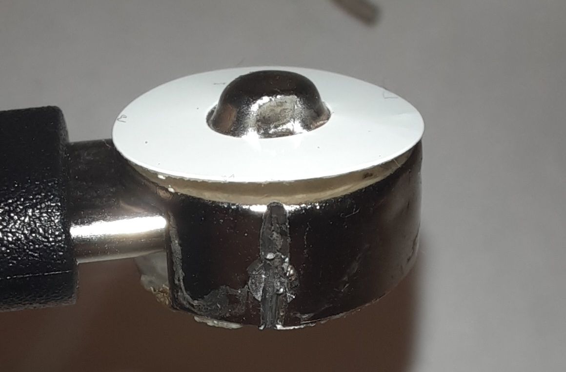

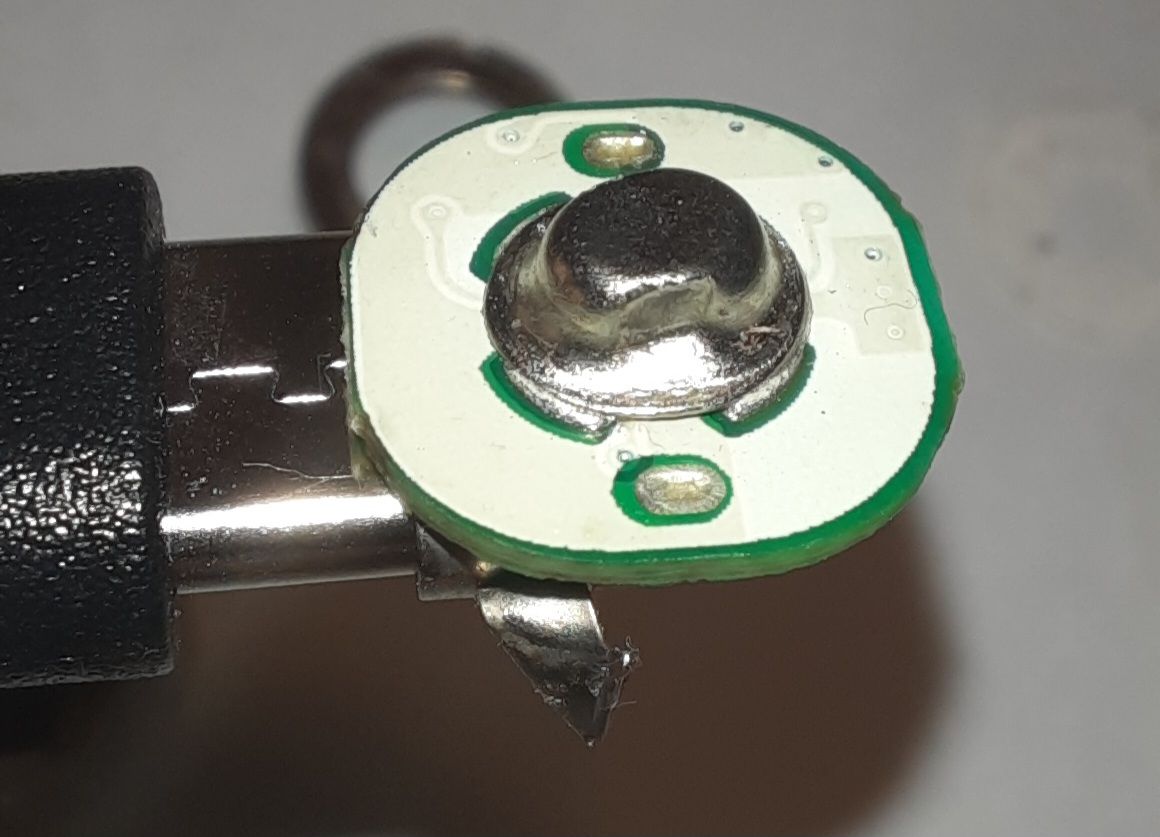

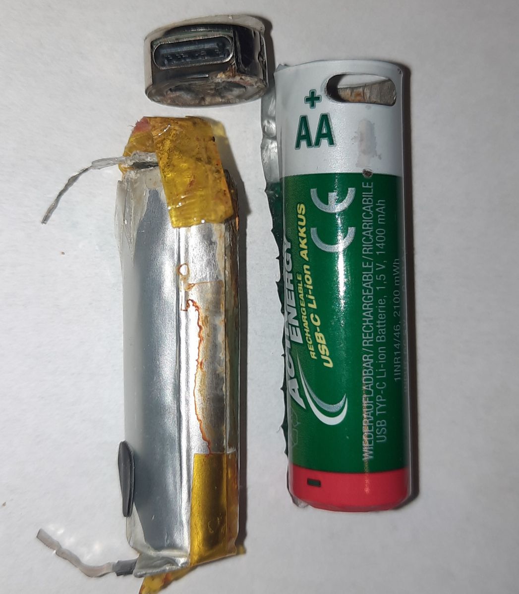

  • Charging failed on the sample, spilling electrolyte and corroding the connections, but the electronics still seem functional for clocks, remotes, and watches.
  • Packaging of four AA Li-ion USB-C 1.5 V batteries with a charger.
    Below are photos of the inside of an AA battery with a lithium-ion cell. The link itself has no visible marking. There was a problem with charging from new, so the whole thing was dismantled. As you can see, the electrolyte was spilled and the connections were corroded. The electronics themselves seem to be functional and may be used in a wall clock with an 18650 cell.
    Inside there is an LC9205D converter. According to the description on the label, the current capacity is 140mA.
    Close-up of a battery interior with visible electronic components and corrosion. Interior of an AA battery with damaged electronics and corrosion. Image of the interior of an AA battery with a visible lithium-ion cell and LC9205D converter. Close-up view of the corroded interior of an AA battery with a lithium-ion cell. Close-up of the interior of an AA battery showing electronics and a converter. Close-up of corroded connection in AA lithium-ion battery. Interior of corroded AA battery with leaking electrolyte. Disassembled AA battery with visible damage and corrosion. View of the inside of an AA battery with a damaged lithium-ion cell. Three green AA lithium-ion batteries with multilingual labels, lying on a light background. Three green AA Li-ion USB-C batteries with red ends. Three AA batteries side by side with visible positive terminals. Three AA rechargeable batteries with USB-C port. Packaging of AA lithium-ion battery with labels and instructions. Description from the Chinese website:

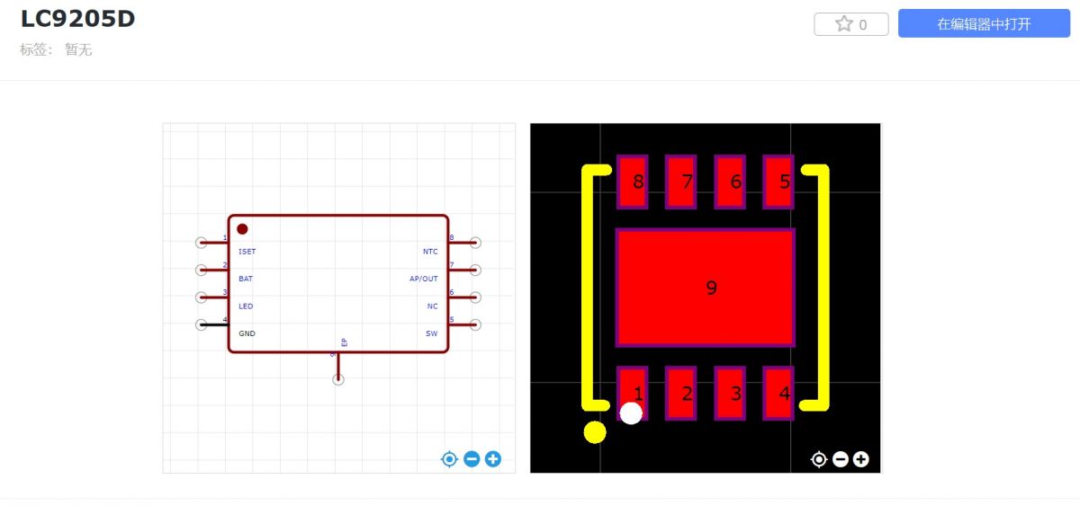

    LC9205D is a three-in-one integrated chip used in 3.7V to 1.5V lithium dry battery. Mainly intended to replace traditional AA alkaline batteries and 1.2V AA nickel-metal hydride batteries.
    The LC9205D chip achieves a high degree of integration. One chip completes the charging, discharging and protection functions of a lithium battery.

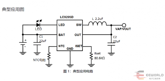

    The peripheral circuit requires only two capacitors, one resistor and one inductor.
    1. Highly integrated, three in one;
    2. High reliability, under voltage, overcharge, short circuit, overheating and lithium battery protection;
    3. Very low self-discharge, less than 6uA;
    4. With NTC temperature control to better protect the battery;
    5. Supports maximum discharge of 3.5A to meet high power discharge requirements;
    6. Streamline peripherals Total production cost is reduced by up to 50%
    Chinese specification for LC9205D converter. Circuit diagram with LC9205D converter Wiring diagram and layout of LC9205D converter.
    The measured output voltage is 1.51V with almost imperceptible ripple.
    Screenshot of an oscilloscope graph showing a voltage waveform. Close-up of a damaged AA battery interior with a USB display showing 1.3 W.
    The other three work. Due to the low output current, they can be used in remote controls and watches. Electric toys with motors have not been tested, so it is not known whether the system has any overcurrent protection.

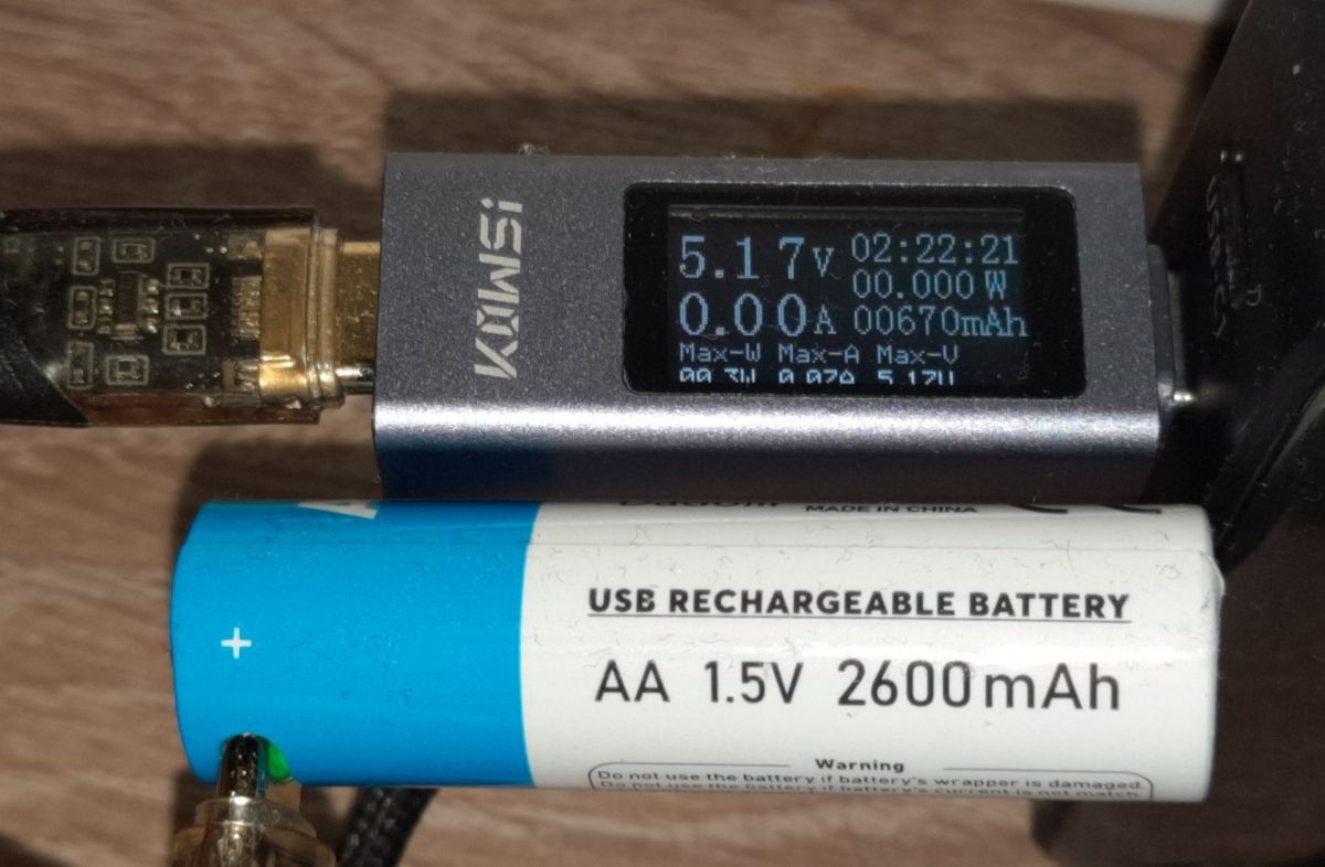

    These types of AA sticks are advertised as follows:
    AA Li-Ion battery charged with USB-C
    Which suggests keeping the voltage at 1.5V for cut-off.
    The 100% charge signal is only visible when 5V is connected via USB, then the indicator light is on continuously.
    Charging is indicated by slow flashing.
    In my case, the light flashed very quickly - this condition is not described on the packaging, but it signals a cell failure - open circuit.

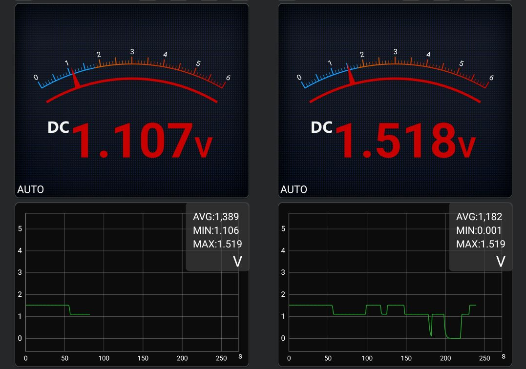

    Measurements have shown that below the voltage of 3.15V on the cell, the output voltage is suddenly reduced to 1.1V. The power supply is cut off at 2.8V on the cell.
    Output voltage of two AA batteries displayed on a screen.
    When charging at the output instead 1.5V Is 5V , which makes it impossible to charge and use the "battery" at the same time.

    I`ve written this before, but I`ll say it again:
    In the cell voltage range of 4.20 V ... 3.15 V, the converter output is 1.51 V
    In the cell voltage range of 3.14 V ... 2.80 V, the converter output is 1.10 V
    Below the voltage of 2.80 V on the cell, the converter output is 0 V

  • Measured converter output drops below 3.14 V cell voltage
    #12 20914718
    kuncy7
    Posts: 34
    Thanks!
    I have something like this, only in the R20 version in a gas heater, just yesterday
    the diode in the stove started flashing, indicating that the power supply voltage was too low.
    This surprised me because I thought it would work until it completely failed.
    This is how a toothbrush works, it turns off without warning.

  • Cheap AA USB-C cells have only about 700 mAh
    #16 20915496
    mipix
    Posts: 4069
    Help: 495
    Rate: 1483

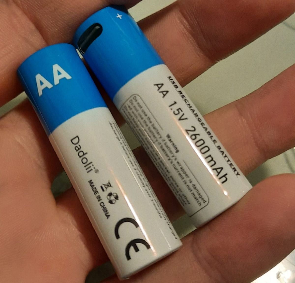

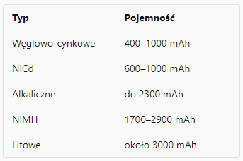

    When it comes to capacity, it`s not entirely true. Approximate capacity in size AA
    Table showing the approximate capacities of different types of AA batteries.

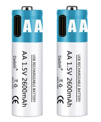

    As for durability, time will tell. As you can see in the first message, it is different, because the cell with a production date of December 2023 (a month old) had a defect. Nevertheless, I ordered 2 pieces of the cheapest ones for testing in the wall clock. According to the buyers` description, they have about 700 mAh instead of 2600 mAh, but otherwise it was impossible to buy converters from 3.7V to 1.5V. Currently this is the only source. Ultimately, they will be connected to 18650 cells.
    Two AA Dadoli USB rechargeable batteries with 2600 mAh capacity.
    I also use a 9V substitute in a multimeter. An interesting fact is that on a regular battery or NiMH accumulator, the meter works normally, but on the Chinese invention it makes a squeaking sound. It`s the fault of the converter in the battery. Declared capacity taken from the ceiling.
    There are also those that promise not to "noise", but I`m not going to test it.

    I have a new cell straight from Ali. A customs fee has been added to the shipment, to be paid upon receipt at the post office. As a result, the package stayed there for about a week. Delivery time equal to one month. Final price 1 pc. it`s PLN 13.50.
    Two AA batteries in a hand, one with visible markings Dadolii and specification 1.5V 2600mAh. USB tester displaying charging parameters and a 1.5V 2600mAh AA battery.
    The manufacturer did not provide the output current.
    I discharged it with a flashlight to cut off the power to the cell electronics.
    Charging via USB with 5V is 670mAh. (670mAh × 5V)/1000 = 3.35Wh. Here it is about 2233mAh after conversion to 1.5V.
    An AA alkaline cell is approximately 3.75Wh, which corresponds to 2500mAh.
    I`m not sure if I calculated the capacity correctly.

    mipix wrote:
    USB tester displaying charging parameters and a 1.5V 2600mAh AA battery. [img-1]
    Is this result for charging from 5V?
    5V*0.67Ah=3.35Wh
    3.35Wh/1.5V=2.3Ah
    If so, it is quite possible to recover approximately 1800-2000mA at 1.5V, because the converter reduces the voltage impulsively when charging, but does not emit heat, and then reduces it again in impulses from 3-4V, so it had to be checked at 1.5V how much current it will give...
    Do you see what the catch is?

    mipix
    Posts: 4069
    Help: 495
    Rate: 1483
    Yes. Unfortunately, my charger with a discharge and measurement function does not respond to this invention.
  • 10 Ω load gives 150 mA discharge test
    This converter gives a stable 1.5V until the very end. Connect a 10R 0.5W resistor and you will have 150mA power consumption.
    after 10 hours, measure the voltage, it will be 1500mAh and after 14 hours 1900mAh.
    Unless you have a watch with a 1.5V battery, connect it :)
    you will see when it stops and its power consumption is negligible compared to 150mA :)
