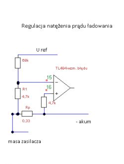

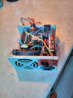

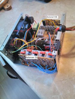

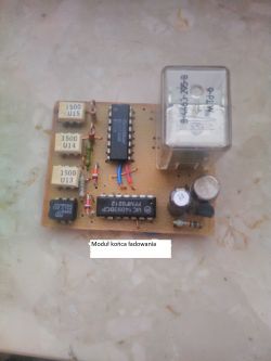

    Hello, I wanted to present one more project using an ATX power supply and in my case AT. I made him a battery charger. Li-ion up to and including 5S. I looked at Interk a little and did not find anything similar, so I think it is my project, so to speak. I used it to automatically turn on the fan so that it does not make unnecessary noise, and the module to detect a charged battery pack and of course the balancer http://www.zajic.cz/omezovac/omezovac.htm. To power the fan control module and the charging module I used a LED bulb power supply giving 22V, lowered it to 12V. The rotary switch controls the power supply voltage by selecting the RX resistor and including it in the appropriate balancer sections. I also used a second error amplifier in the TL494 circuit to regulate the charging current, and after charging the charge module connects 4.7k in parallel to R1 4.7 resistors reducing the current to a very small value. The project is practically checked.

    Current efficiency is high, it is known that a computer power supply has, as I wrote, I used a second error amplifier to set the current at 1A. the other amplifier in a typical power supply is blocked. Without it I couldn't connect the batteries directly because I would have cooked them. It was possible to set the charging current with a resistor but I decided to do it professionally.

    I don't know what you mean. As I wrote on the second error amplifier, I made adjustments to the charging current, I set the current to 1A, I could have set it to a different value. I could also install a potentiometer for current regulation but I found it unnecessary.

    You have no idea. In my case there is no such thing as balancer current regulation. The balancer is used to charge individual cells to the same value, and prevents overcharging a cell, which is dangerous in this case.

    The charger loads the package and balances. In addition, I write that the charge detection system monitors 2, 3, or 4 cells. I gave up monitoring 5 cells so as not to complicate the system because if you charge 5 cells, you can let go of one of them.

    I wrote about it in the project description. I used a second error amplifier in the TL system to set the charging current ... which is blocked in a typical power supply. at
    I set the current at 1A using a resistance divider. At the end of charging, the current drops slightly. Charging takes quite a short time did not measure time, it also depends on the level of accu discharge. You can also if someone is in a hurry to set a larger current or make two quick and slow charges selected with a switch. [/ Img]
