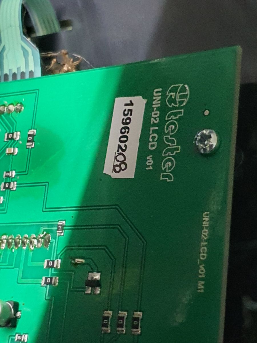

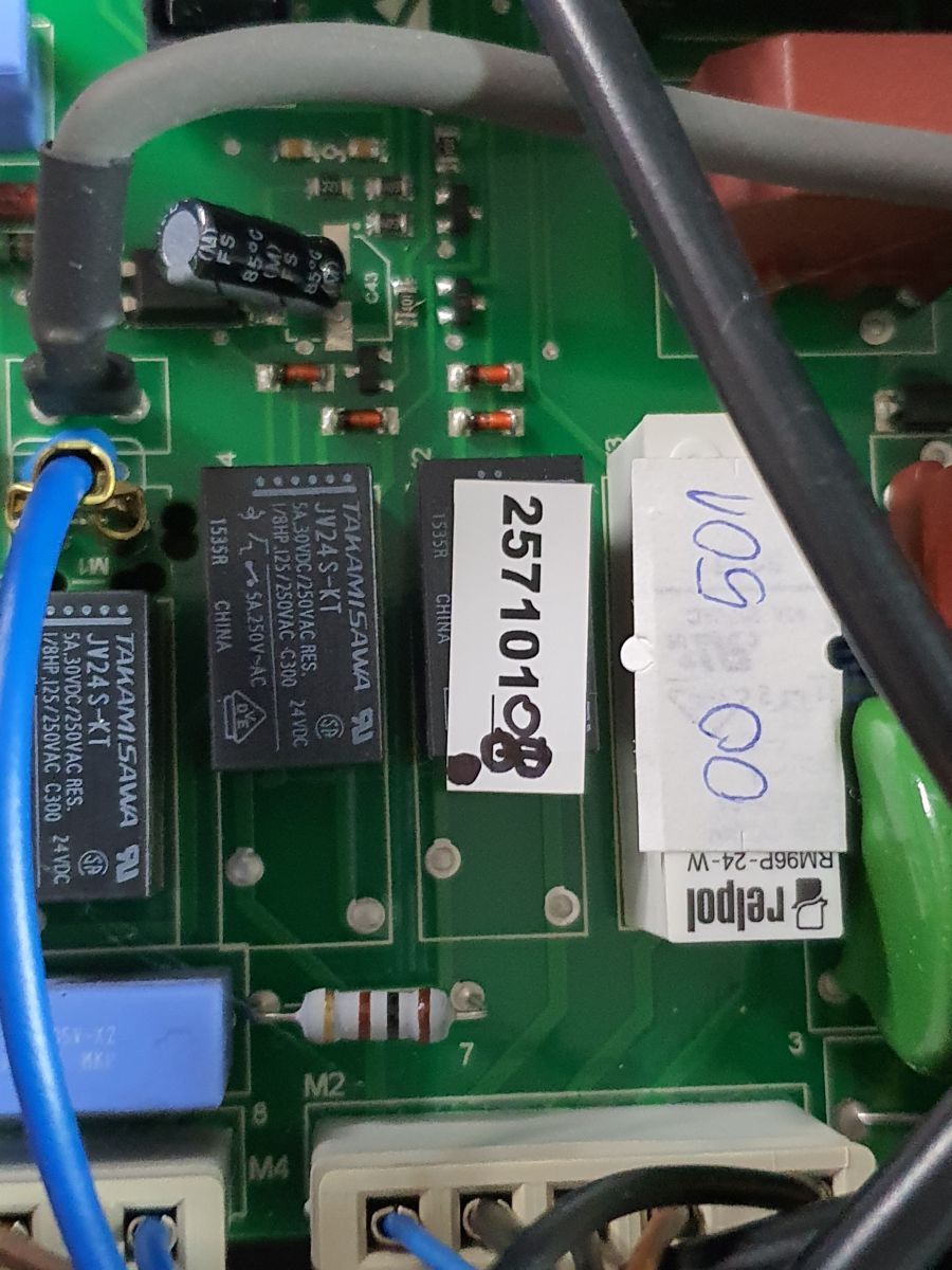

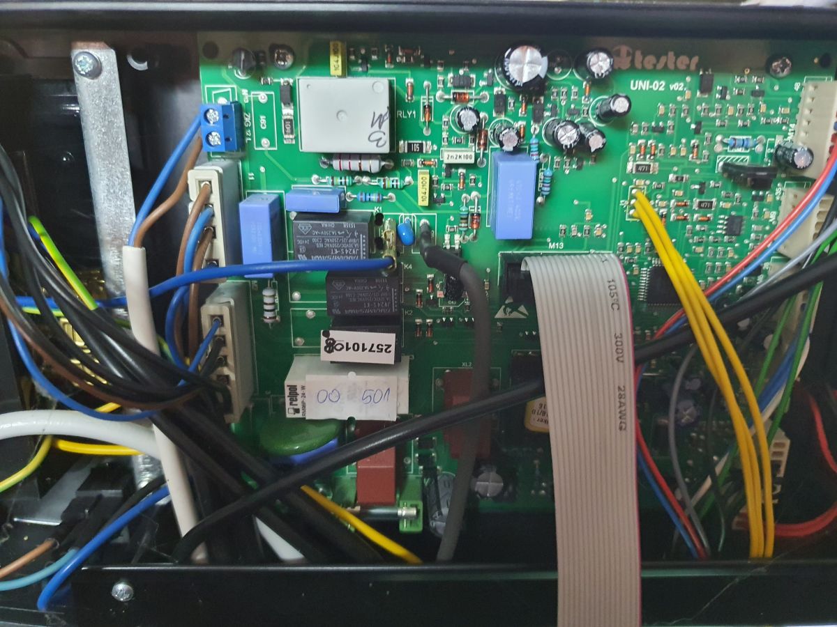

    inwestycjebudowlane8
    Posts: 7
    Hi!
    I have an ecocondens plus gold 35KW boiler, which one should I buy, do I need a controller for this furnace?
    Apparently, older models (mine is from 2017) do not support it.
    I'm looking for something similar to ST 2801, it doesn't have to be connected to WiFi.
    So that it can communicate with my stove as best as possible and have a touch screen.
    I would like to ask for some suggestions and advice.
    Yak Close-up of a circuit board with various electronic components such as capacitors and resistors. Close-up of a boiler's main board with visible electronic components and labels. Nameplate of the boiler control panel Warranty card for Ecocondens 35 Gold Plus boiler. Close-up of a circuit board with components like capacitors, resistors, and relays. Close-up of a circuit board labeled Tester UNI-02 LCD v01. Close-up of the internal electronics of an Ecocondens Plus Gold 35 kW boiler.
  • #245 20748032

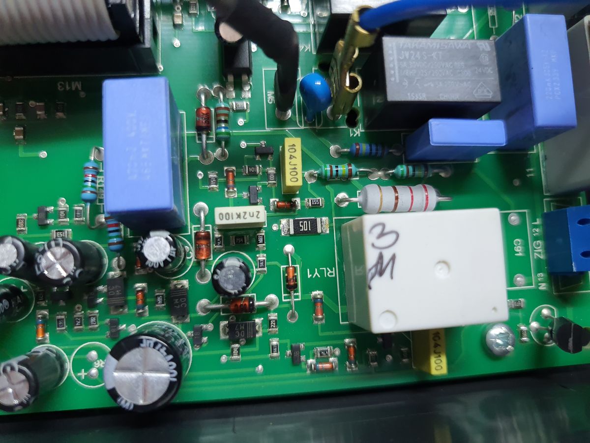

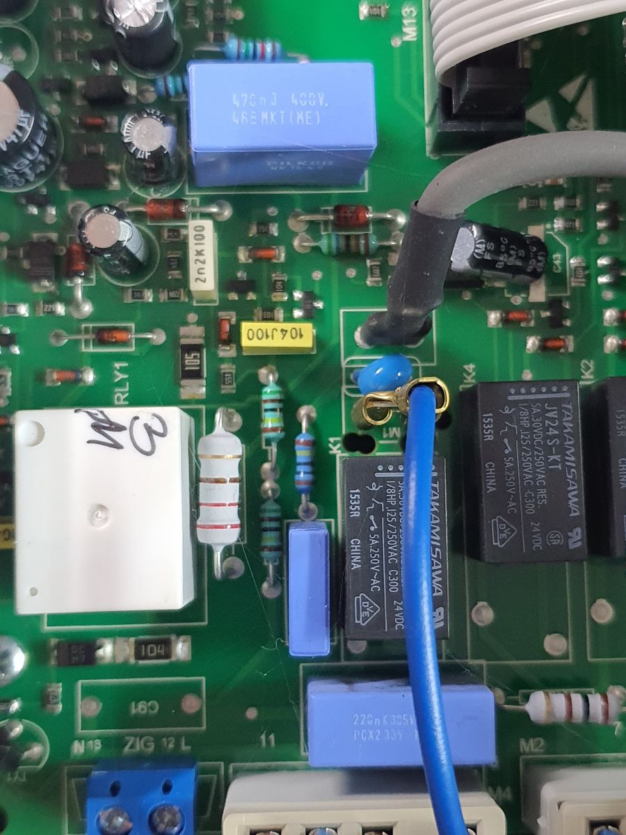

    pawlik118
    Posts: 2420
    Help: 202
    Rate: 606
    When I see how this board is designed, I am discouraged from buying this stove.
  • #246 20754305
    maliniak80
    Posts: 287
    Rate: 377
    So buy a Scottish product, you will have a better plate.
    ViSSmann tiles are not better either. Three processors, quartz far from the processor, capacitors too. Only the lengths of the insulation gaps seem to be maintained correctly
