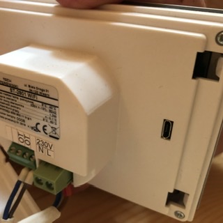

    In the oven, I changed the board to have b14, but fortunately under warranty. In the room controller I wrote and got the update file - ver. 1.1.1. In the attachment I am sending - You need to upload to the flash drive and connect to the controller for min. USB Turn off and on and load itself. It shows modulation very rarely - I don't know why - you have to ask in Tech.
    However, I would like the service to be up to date with b14 if someone had it because it uses the old one from 2016
    • st12sw.bin (2.71 MB) You must be logged in to download this attachment.

    Everything is nice, but I don't have a USB socket, is it hidden somewhere?
    You have 2801 on peno?

  • #83 18266875
    dacher
    Posts: 14
    I also have WiFi. The nest is on the side, you have to find. The service code is easy to guess because it is: 1111 ? - there is almost nothing there.
  • #84 18266964
    lasekd
    Posts: 90
    Rate: 18
    No, I'm not blind :)
    It is true that I was looking for a torch yesterday night, because I did not want to wake up my family, but there was no bank. I have this controller dedicated to this boiler with the inscription termet on the front. They only come in black.
    And what is the inscription on the front? When I get home I will be looking, but there is probably nothing like that. There are two versions of these drivers, with the word tech or something on the front and with the word termet
  • #85 18267038
    dacher
    Posts: 14
    Well, I bought a poorer version without the inscription ? but much cheaper?
    You definitely have USB - you need to remove the driver from the latch and on the back wall on the side. Attached picture . But don't get too excited because modulation rarely shows ? - you have to ring a little.
    • Termet ECOCONDENS GOLD PLUS + ROUND with Wi-Fi - Open-Therm - connected incorrec 43248B82-27DD-4F88-BB91-F3760950450C.jpeg (26.11 KB) You must be logged in to download this attachment.
  • #86 18267356
    lasekd
    Posts: 90
    Rate: 18
    Bingo, you deserve a big beer, collect PM because I sent you yesterday
    I know that without the inscription it is cheaper, but I think a dedicated one will work better with my boiler,
    but it's probably just my wishful thinking
    I will eat lunch soon because I have just arrived and I am starting to upload the software
